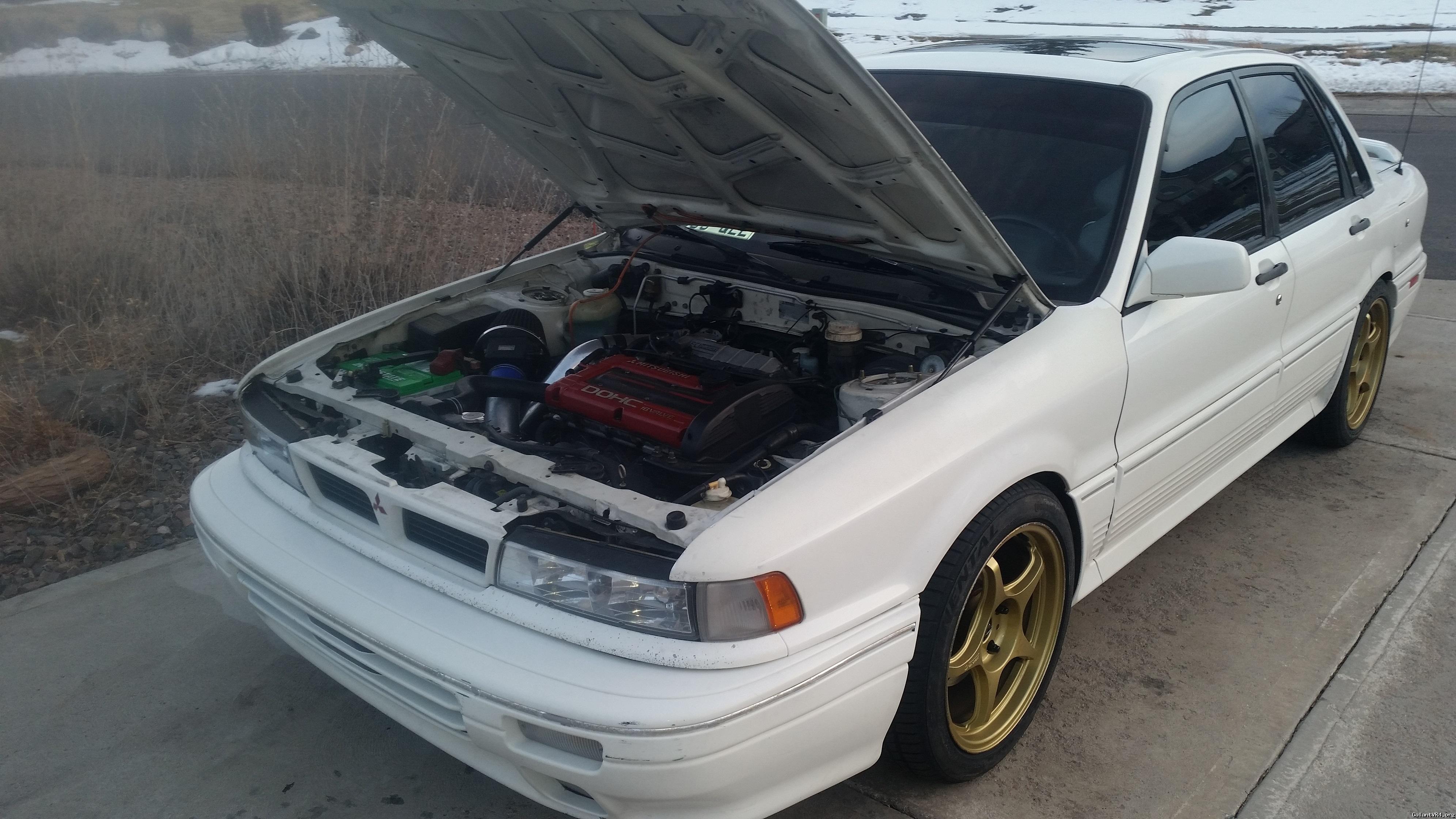

The pictures hide a lot. It's got hail damage on the roof and trunk. The front fenders are faded a nasty yellow color. The hood has some dents.. It's nowhere near as beautiful in person, trust me. Although the interior is very immaculate, the exterior needs serious attention.
