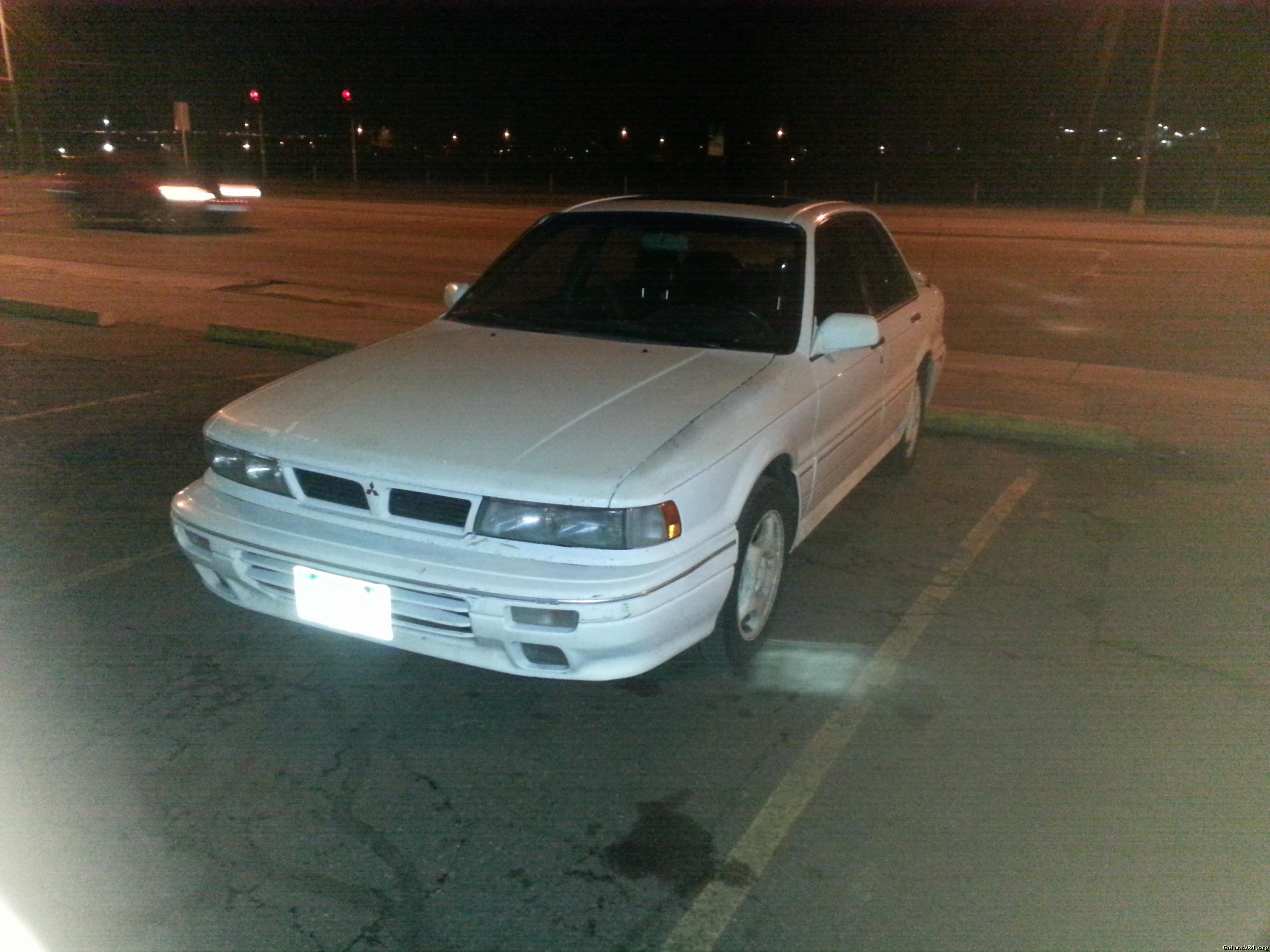

Hello. My name is Kirk, I am 29 and a mechanic 50+ hours a week. I am the very happy new owner of a 92 summit white vr4 with a sunroof. ?/1000. Unfortunately the badge has been removed and the keyfob is long gone. The car is running on a JDM swapped engine and the jdm cyclone manifold has been removed in favor of a usdm vr4/1g piece. Chassis has 177k engine has roughly 100k. I picked up the car last night and had to tow it from Loveland Co to Denver due to a possible bad tranny or clutch issue. Its in decent shape for its age and I am very excited to start digging in to her. The exterior is in good condition minus the peeling clear coat, windshield weather stipping and cracked tail lens. Interior is in need of some serious cleaning. Although the seats look great, steering wheel is haggard, carpets a bit gross and I think there is some petrified Wendy's frosty on the passenger door panel and carpet. Everything but the cruise control, drivers shoulder belt and ac work. It has the original head unit and eq in good working condition. Its completely stock from the air box to the original exhaust except for the swapped long block/2g exh-manifold/B16g. I plan to restore this piece of history to its original glory and then some. I'm going to attempt to post some pics shortly.

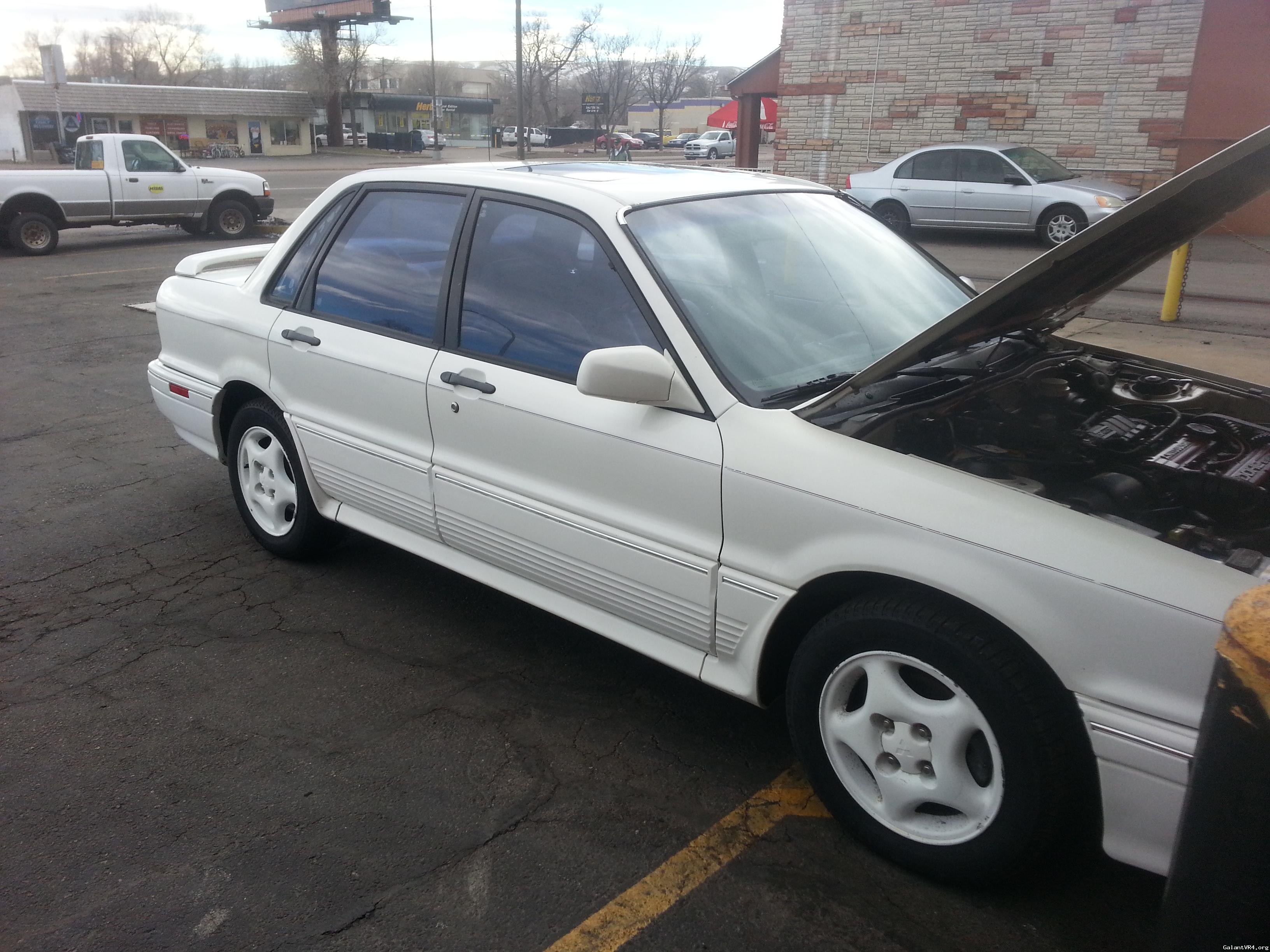

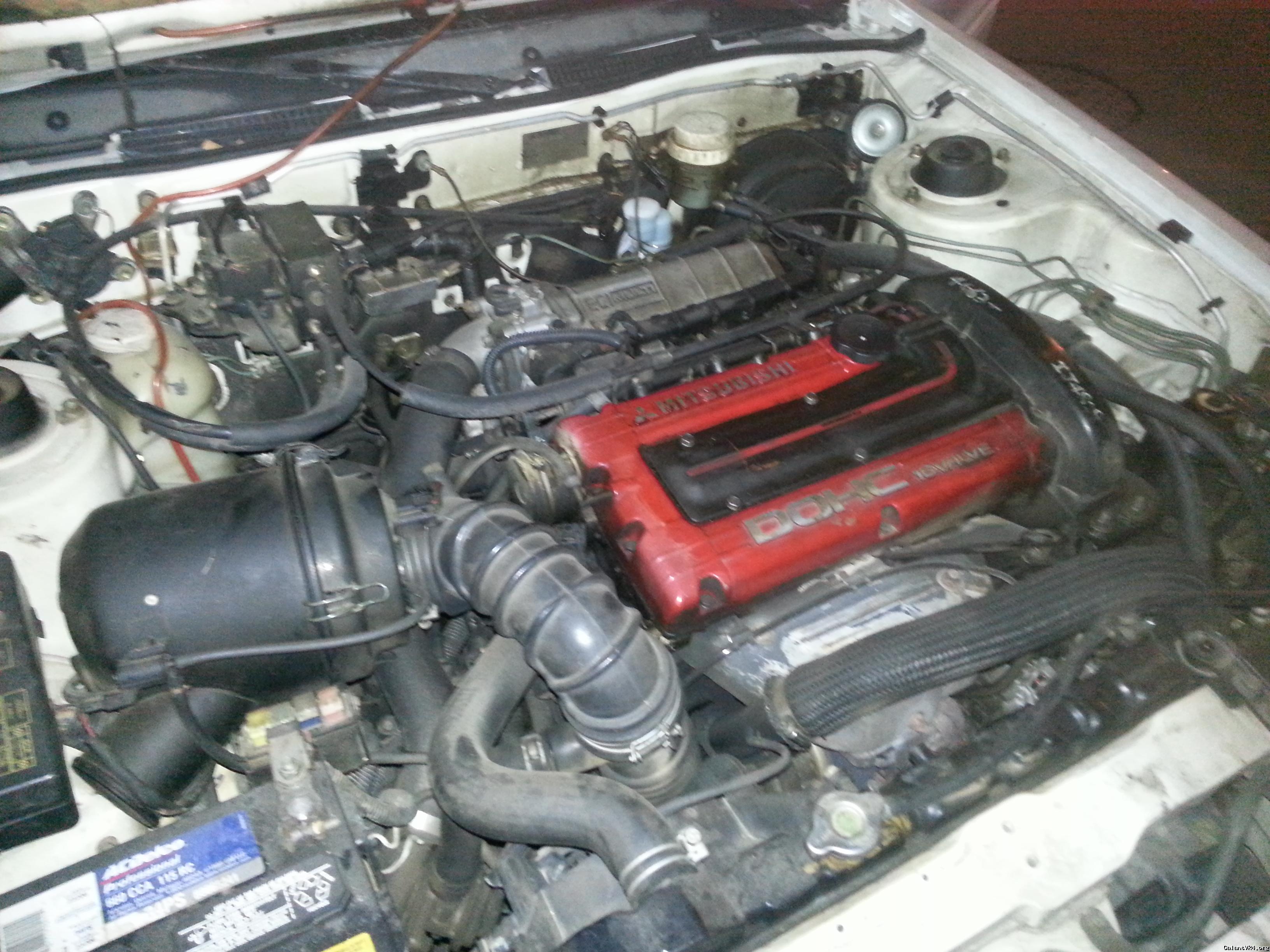

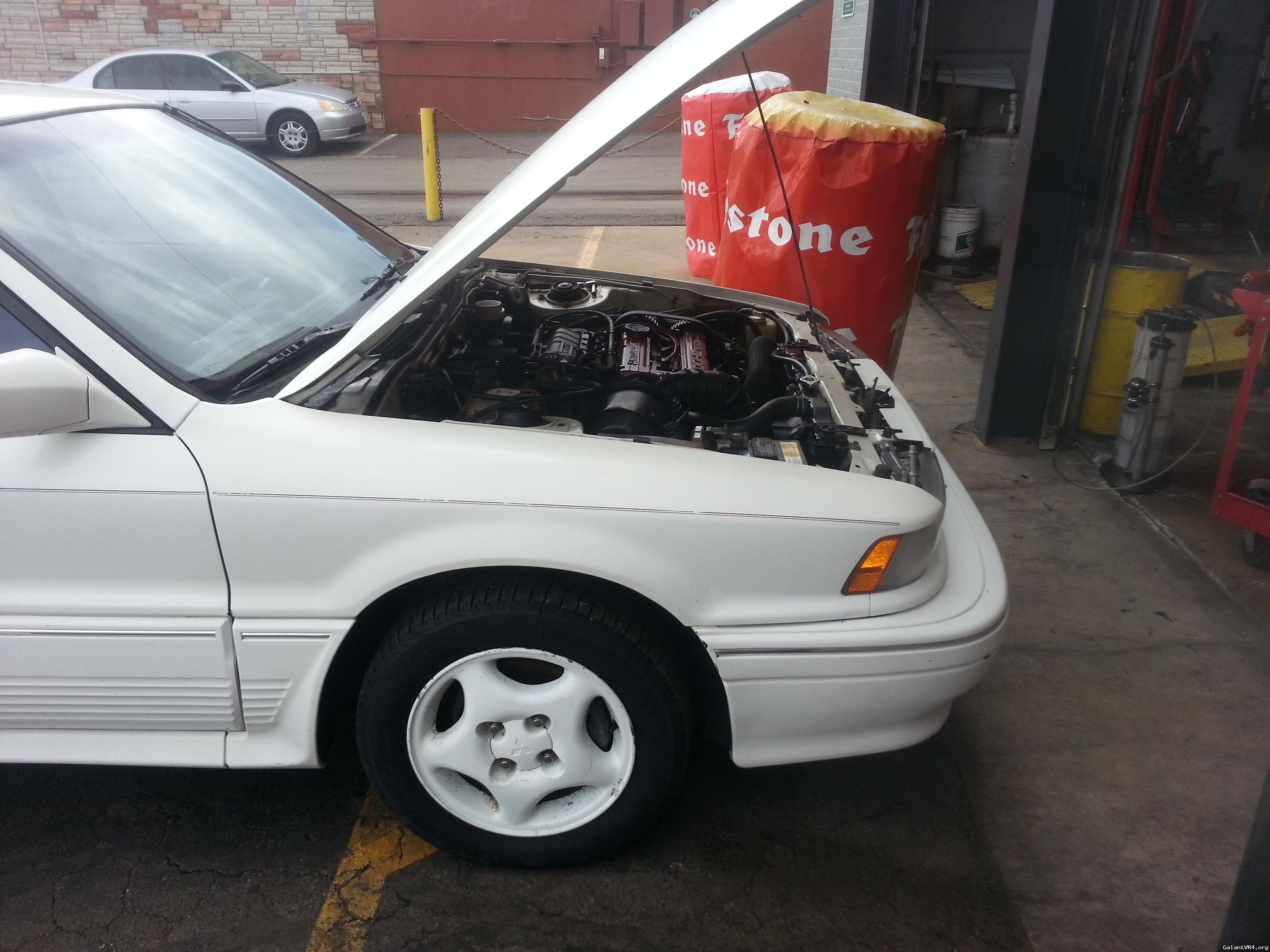

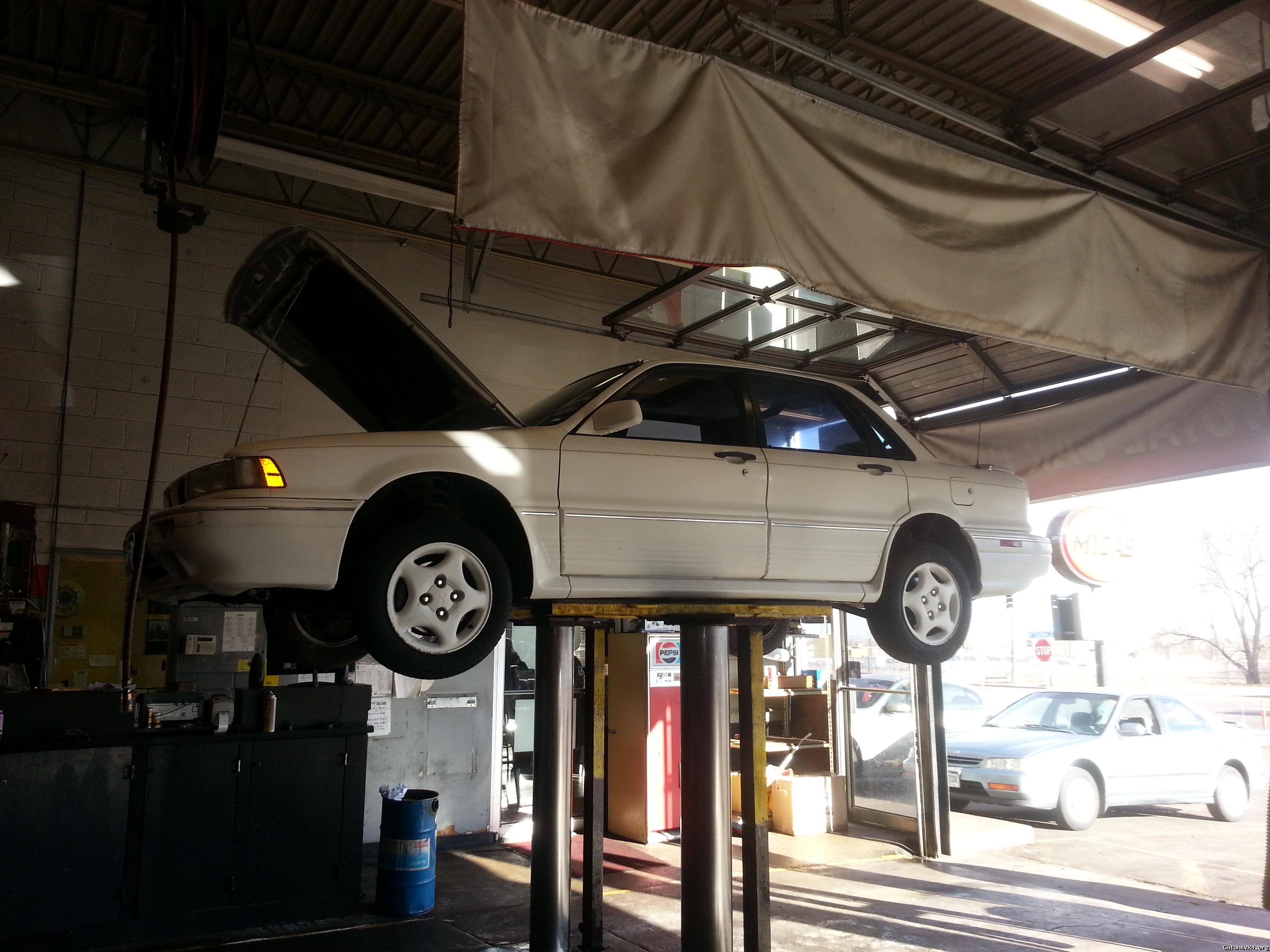

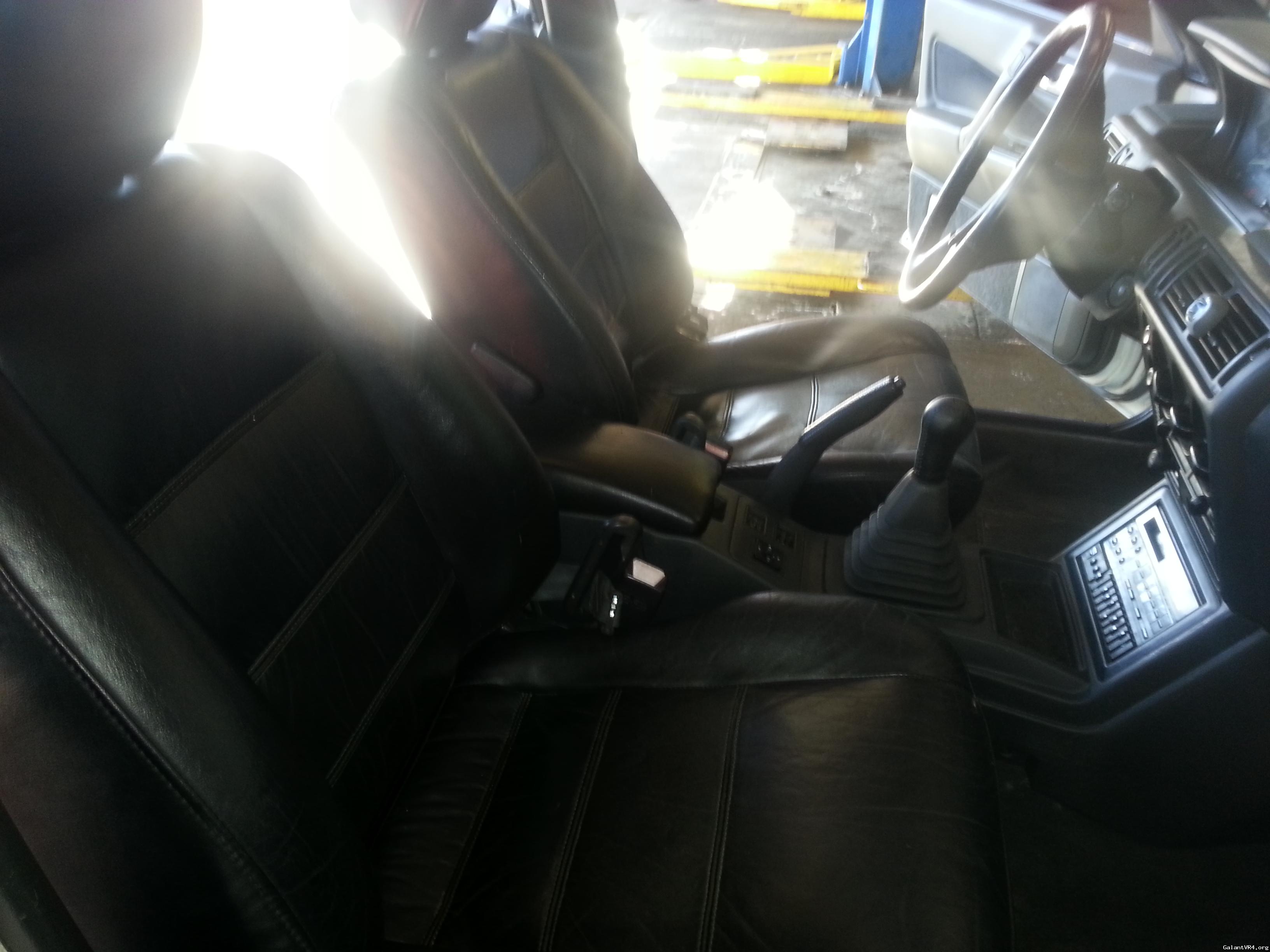

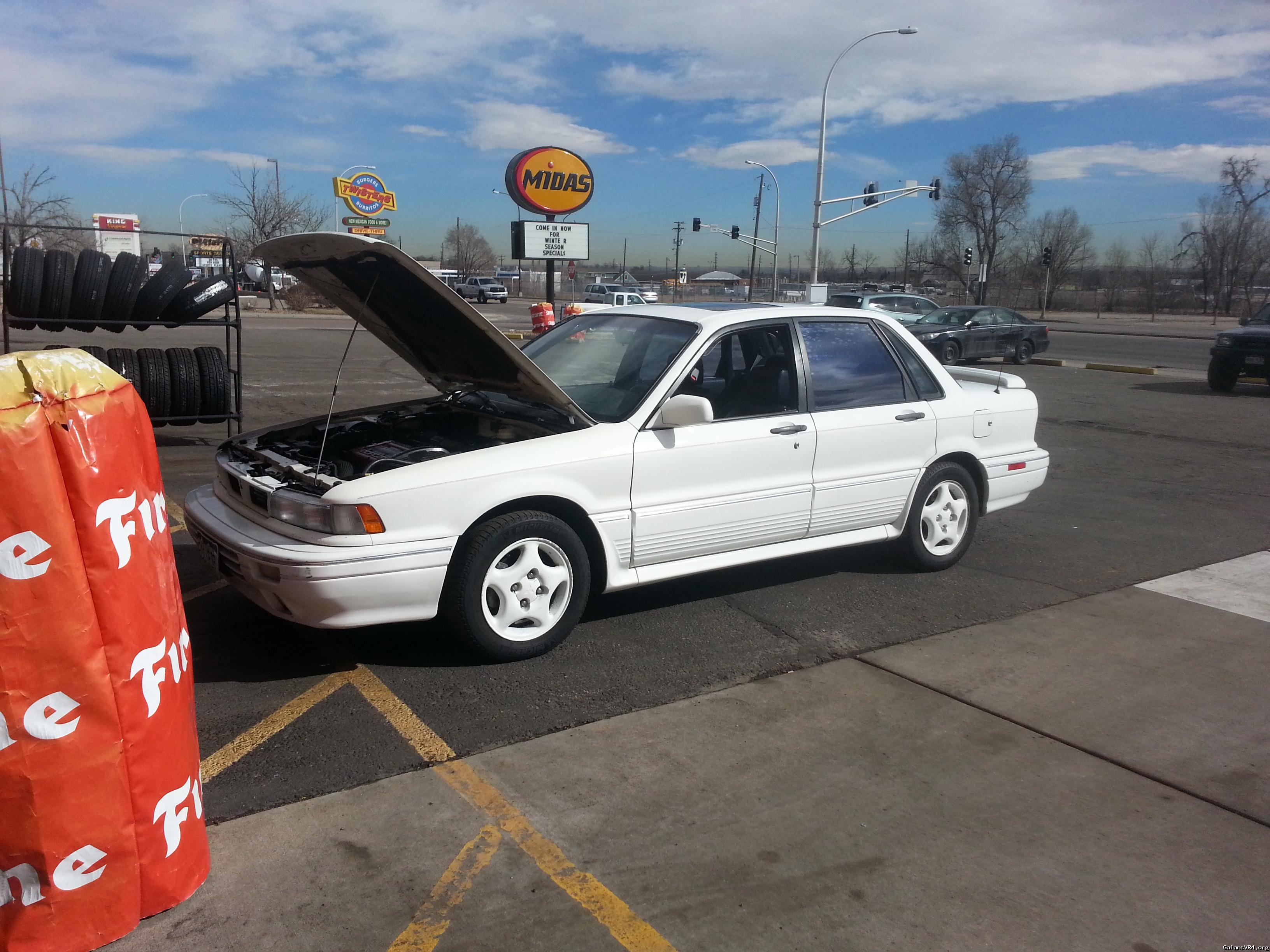

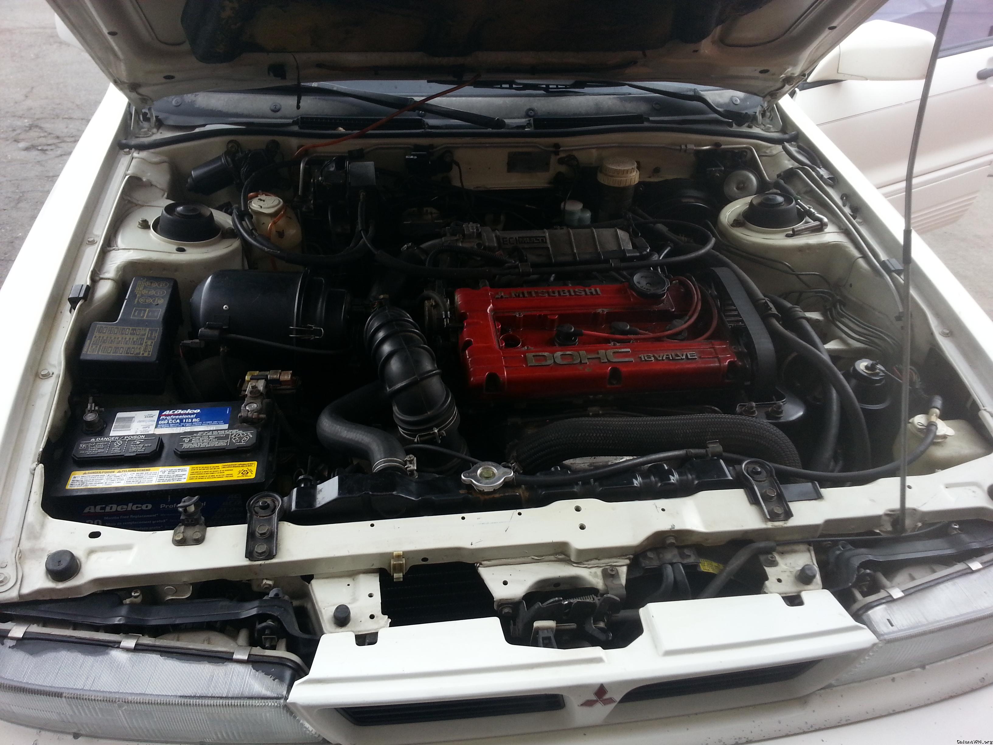

Did a thorough inspection and cleaning to the car today. Found a few issues, ball joints and tie rods are in need of replacement. Timing belt is very aged and cracked. Found my manifold leak to be a stud broken off in the head(un-fixable, 2 broken drill bits in it). Valve cover and oil pan gaskets leaking a bit. Fixed a misfire with a new set of plugs wires also. As I had stated in my original post I had purchased the car with what the previous owner was told was a trans in need of a rebuild. I have driven the car and it seems to be a clutch issue. I inspected the master and slave cylinders and they are in good working condition and the slave extends fully so I assuming the adjustment is correct. It will not go into gear running but if you start the vehicle in gear you can drive it just fine an dandy if your careful without the clutch. Looks like I'm pulling the engine and trans to fix the clutch, install the new timing belt and detail the engine bay etc. Here is a bunch of pics from today after getting her somewhat cleaned up.

Just want to get it out of the way that nothing was swapped.
USDM VR4s never came with a cyclone manifold. Your car is just 100% stock lol

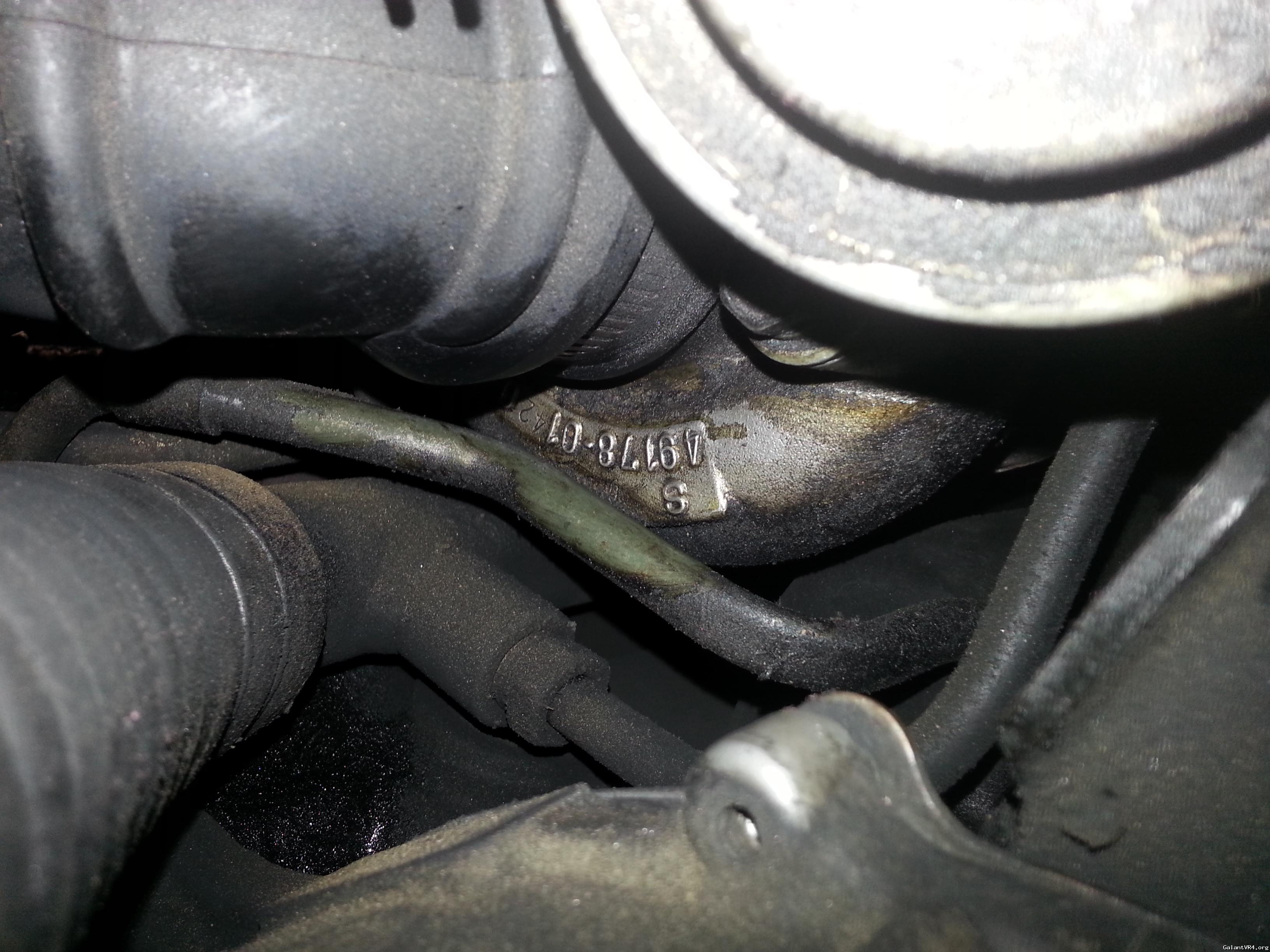

From what I was told about the vehicle it was purchased in 2008 by the po with a spun bearing. He sourced a jdm longblock with the intake manifold and matching turbo and injectors. It supposedly has a b16g and an act 2600. I was told the cyclone manifold was removed basically because whoever was working on it couldn't get it to function properly. We will see when I tear it apart as I cannot read anything on the turbo except tdo5h. Everything was installed by SCR performance in loveland also. The engine does have wierd yellow paint marker numbers on it, like the jdm engines usually do. As of now its a mystery.

Also does anyone know of an injector identification chart or something of the sorts? I'm confused as to what injectors I actually have. All I know is they are blue and possibly the 450cc? stockers.

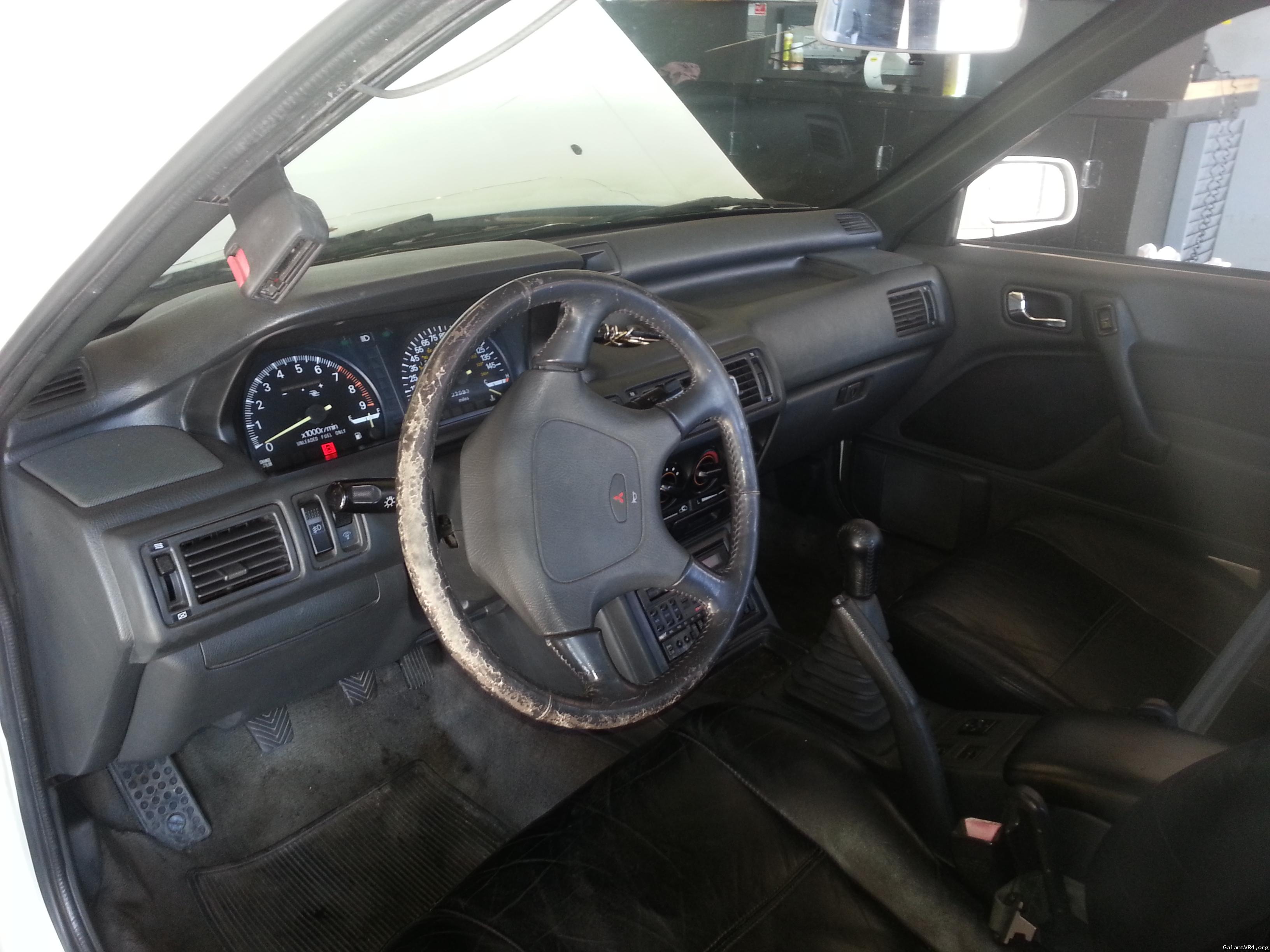

MRmeetooxD, are you saying it is possible to recover the original steering wheel with a different leather?

My wheels center cover is also ruined, its badly warped. I attempted to bend it back and get it looking right the other day and it worked well other than when I turned the ignition on later the horn button was making constant contact! Quite a surprise. If I could re wrap the wheel and replace the cover I may just keep it. I was planning an aftermarket wheel/hub though.

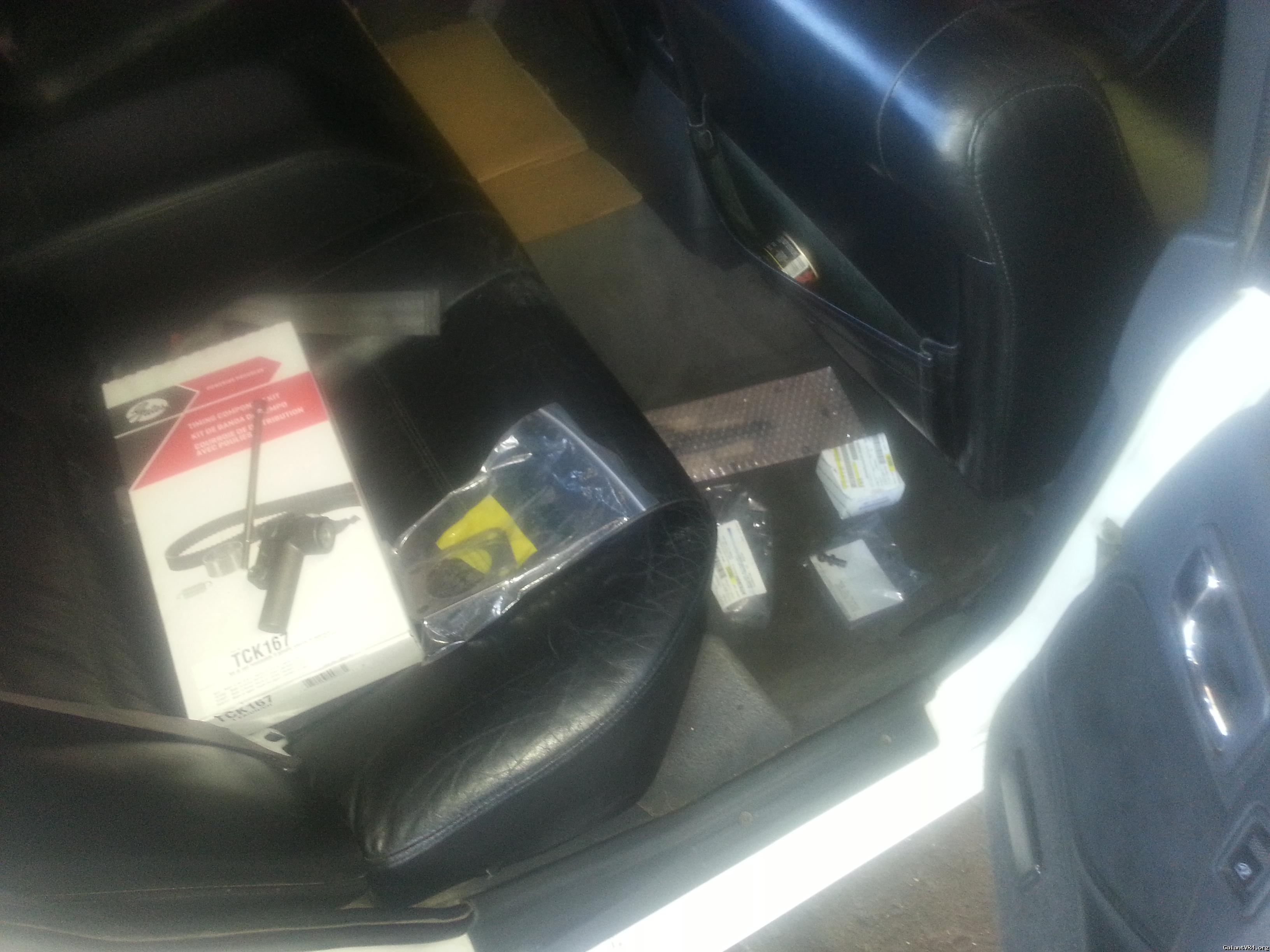

Finally, some of my parts arrived today /ubbthreads/images/graemlins/smile.gif.
New oem pivot ball and fork
New oem throw out and clip
Gates timing belt kit
New hyd tensioner
Turbo flange and manifold gaskets
Jnz tensioner arm tool and belt tension tool.
Still waiting on my water pump, cam seals, oil pan/valve cover gaskets and crush washers for my turbo lines. Wheel bearings, balljoints, and outer tie rods.
Still unsure if I need a clutch. I was able to verify that I do indeed have atleast an act pp installed. Its bright yellow. Im considering a spec stage 1 on an oem flywheel if my act needs replaced. I will know by monday as I plan to take her all apart sunday/monday. Wish me luck!
