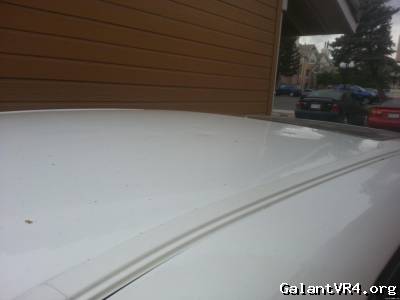

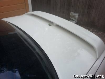

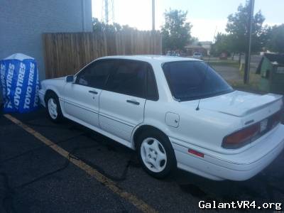

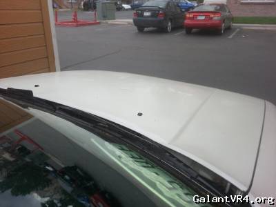

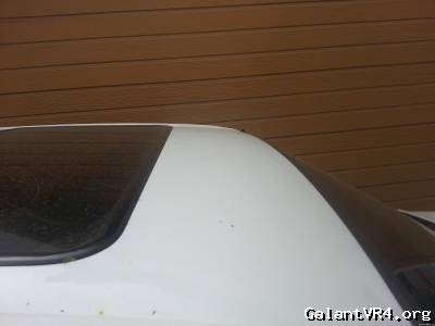

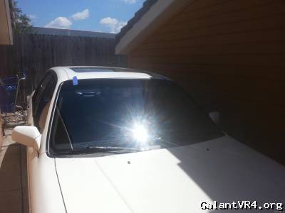

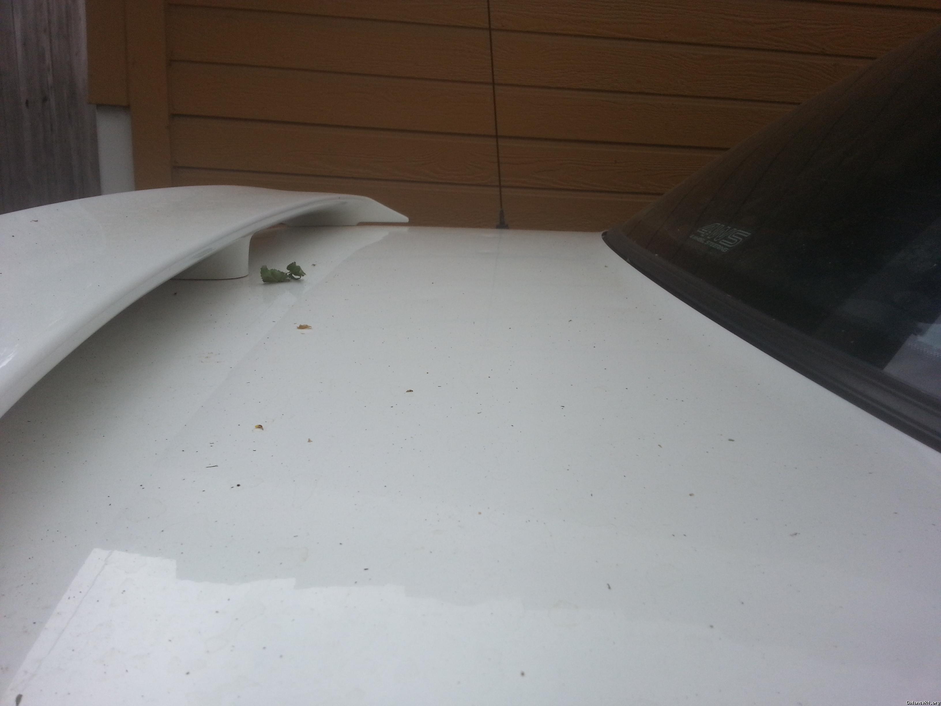

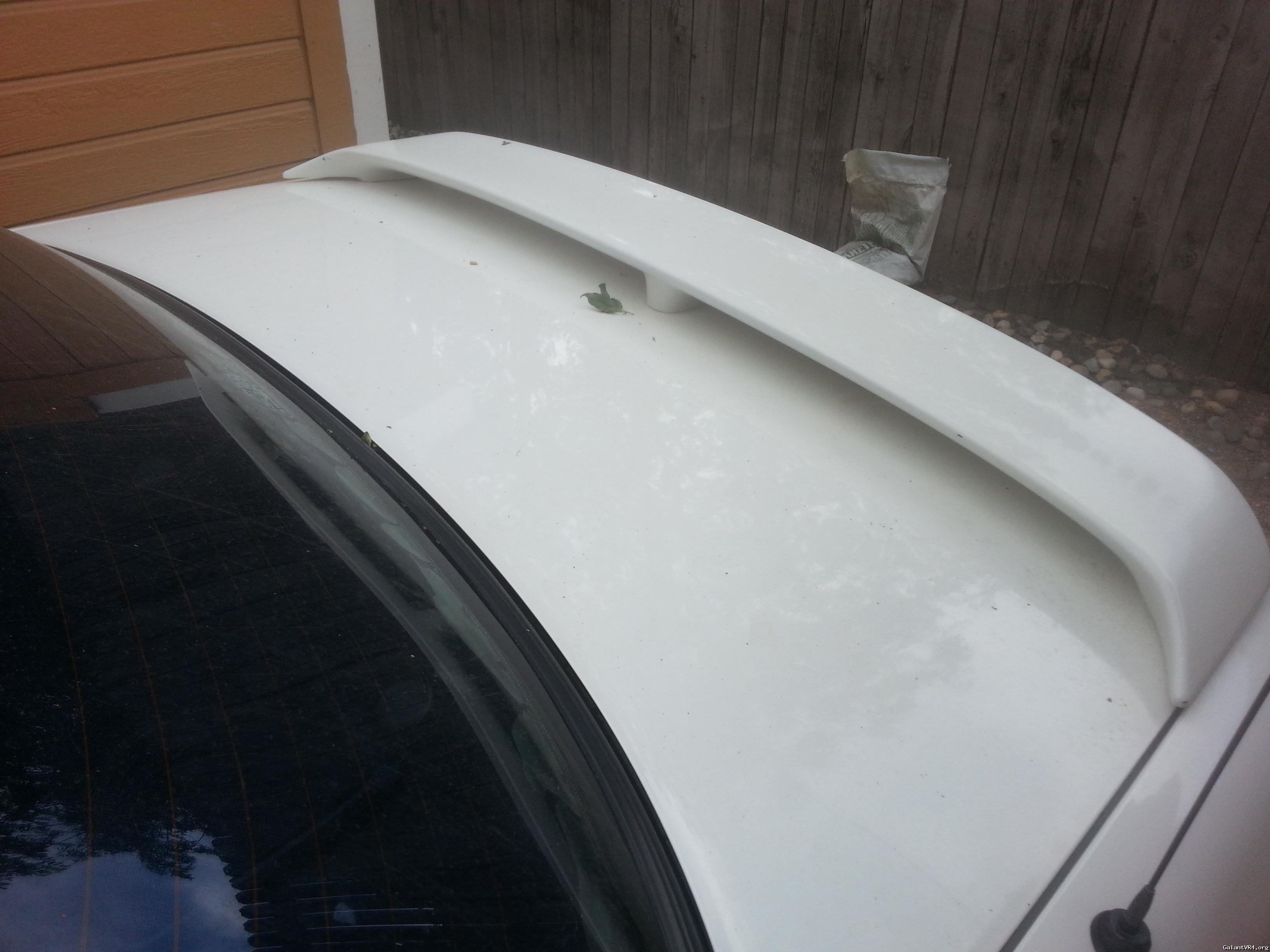

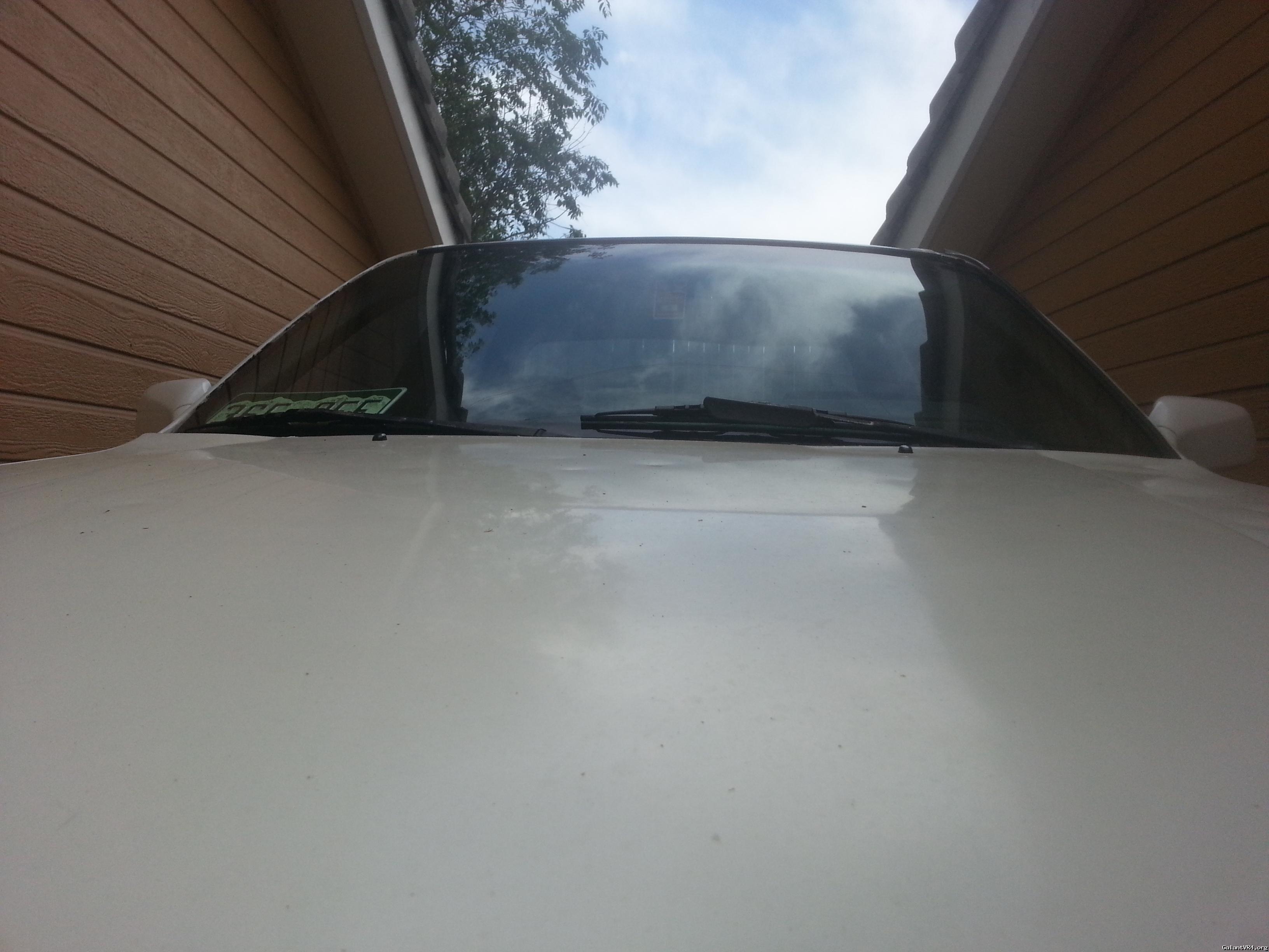

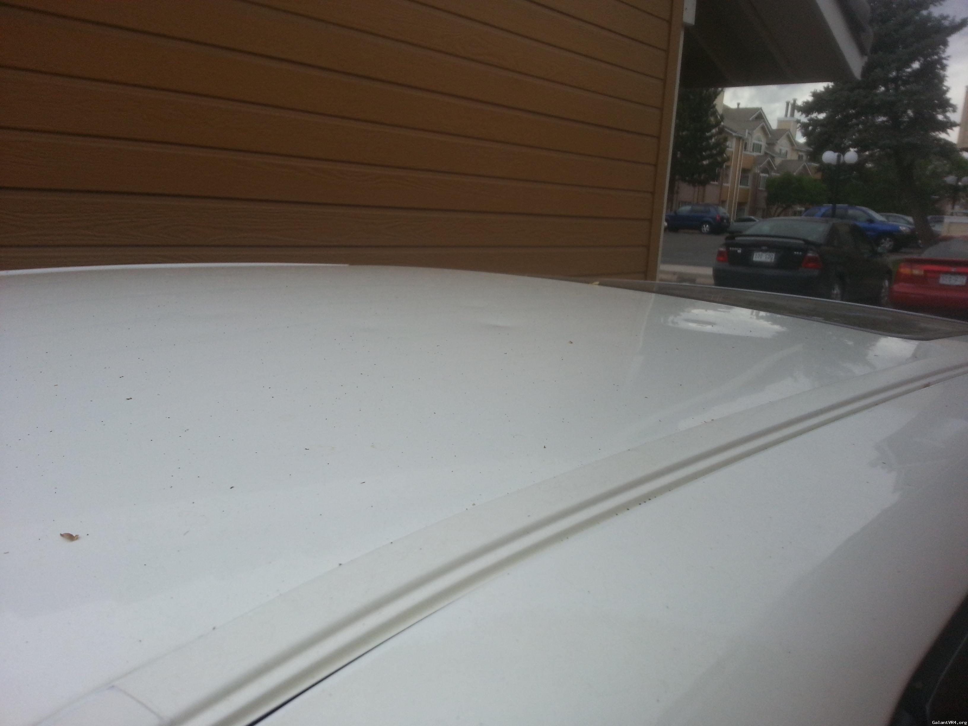

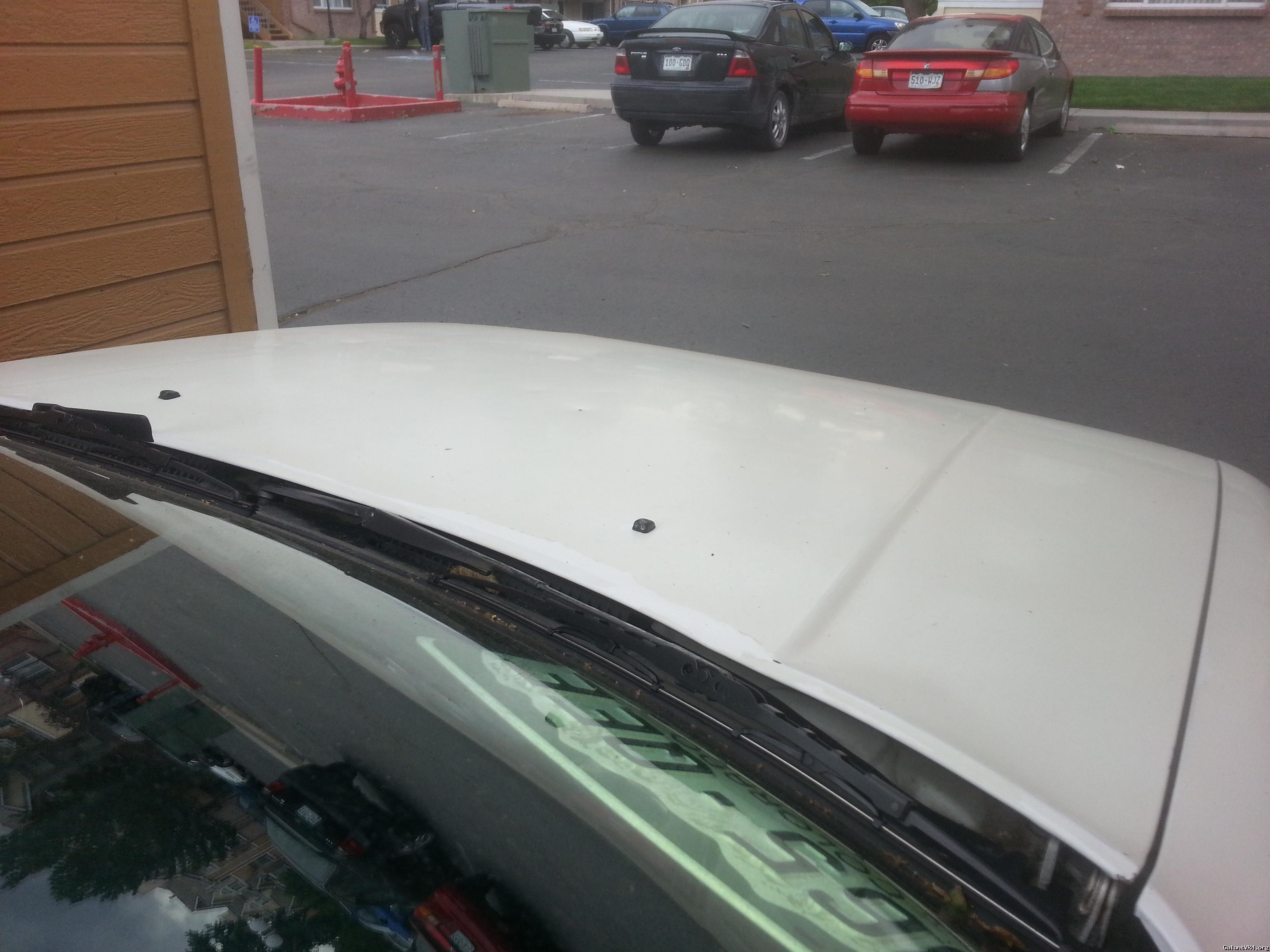

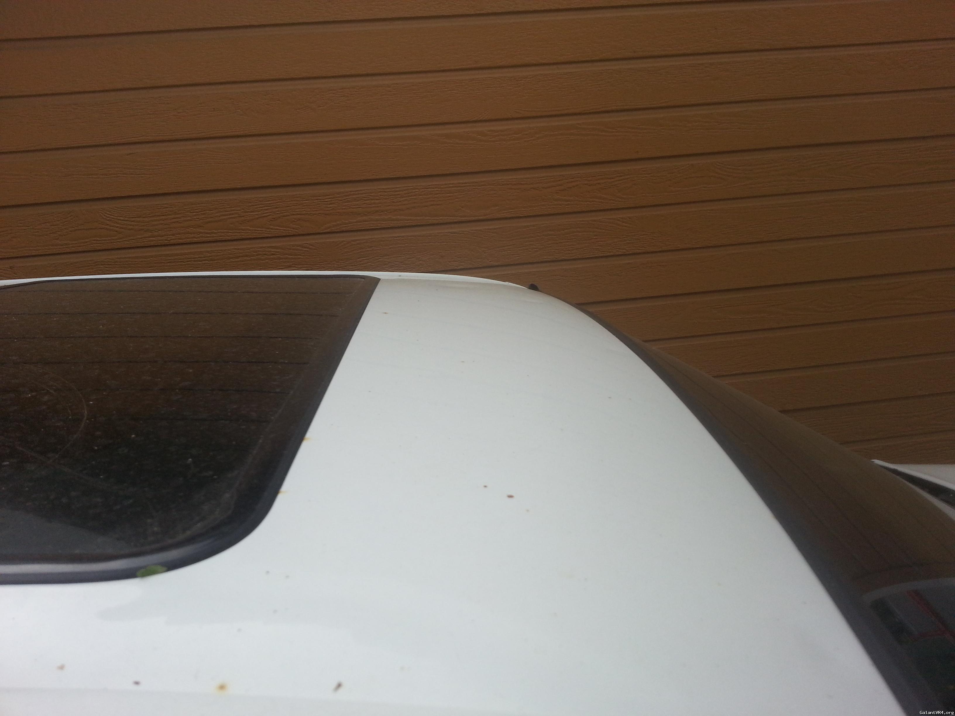

These pics dont make it look very bad. Its much worse in person.

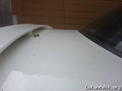

Here is some of the hail. This had been melting for 3 or so hours when I picked it up and stuck it in the freezer.

That sucks man. It happened to me once driving across the country. Luckily I came to an underpass right away and was able to stop until the storm passed. You can get it fixed but you have to research a good dent removal guy. Good meaning someone who does not destroy the inside of the vehicle with excessive drilling of holes etc..............

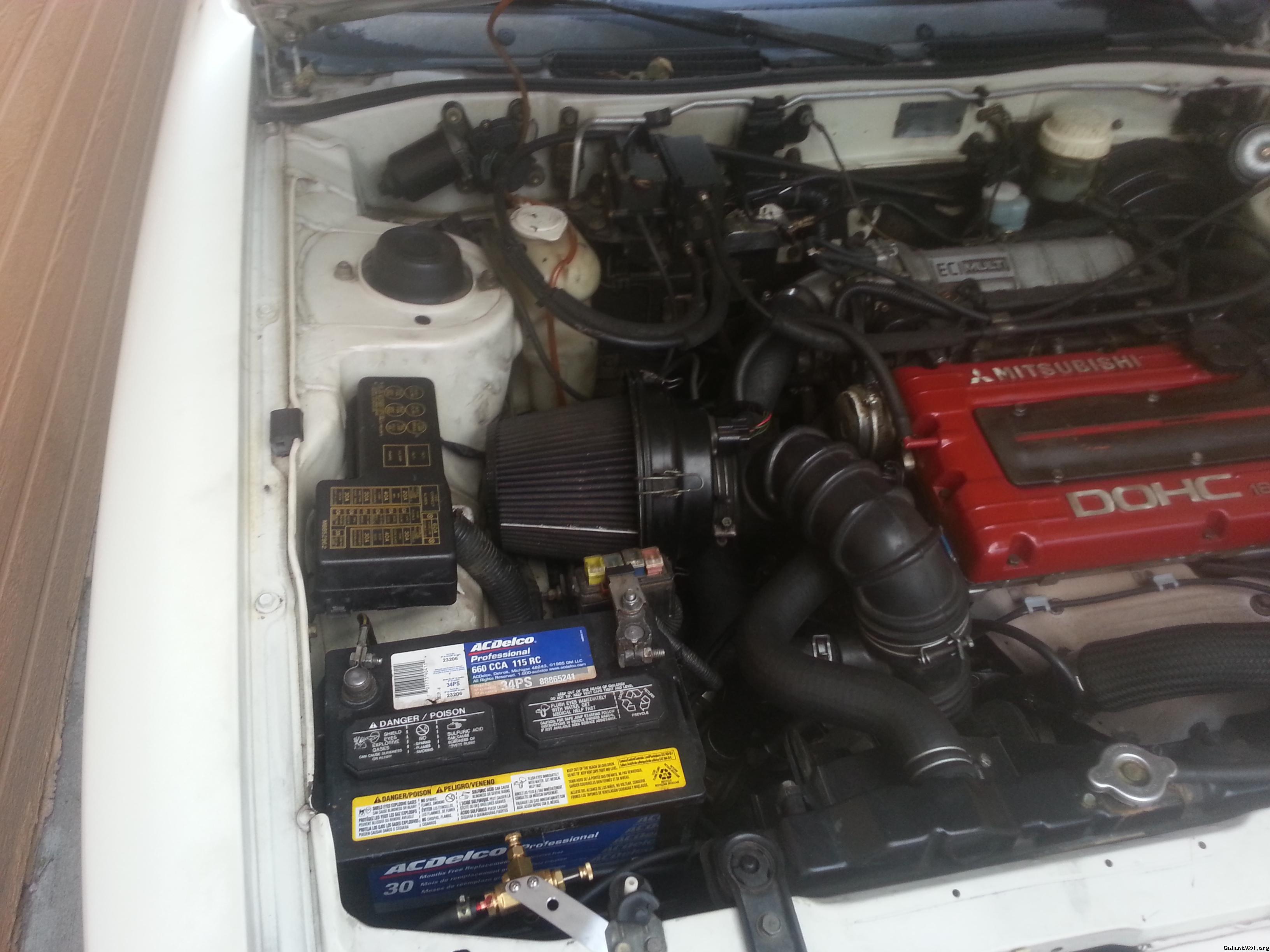

So I have put 1685 miles on it now and its doing great other than a few small issues. I finally figured out my hot start issue. It ended up being injector #3. I have figured out that if I unplug/reconnect the injector a few times on a hot start it will start pulsing properly and I can get where I need to go.
My rear rotors have such a large wear lip on them that it now makes a constant very light yet annoying ringing noise. It drives me nuts and I'm going to replace all the pads and rotors asap.
I have now installed a lower shores mbc and have it set a 12 psi. I also simplified the vacuum routing and hose lengths and re connected all of the pcv/crank case ventilation hoses in the proper factory manor. I now make full boost a few hundred rpms sooner and it just feels more responsive overall.

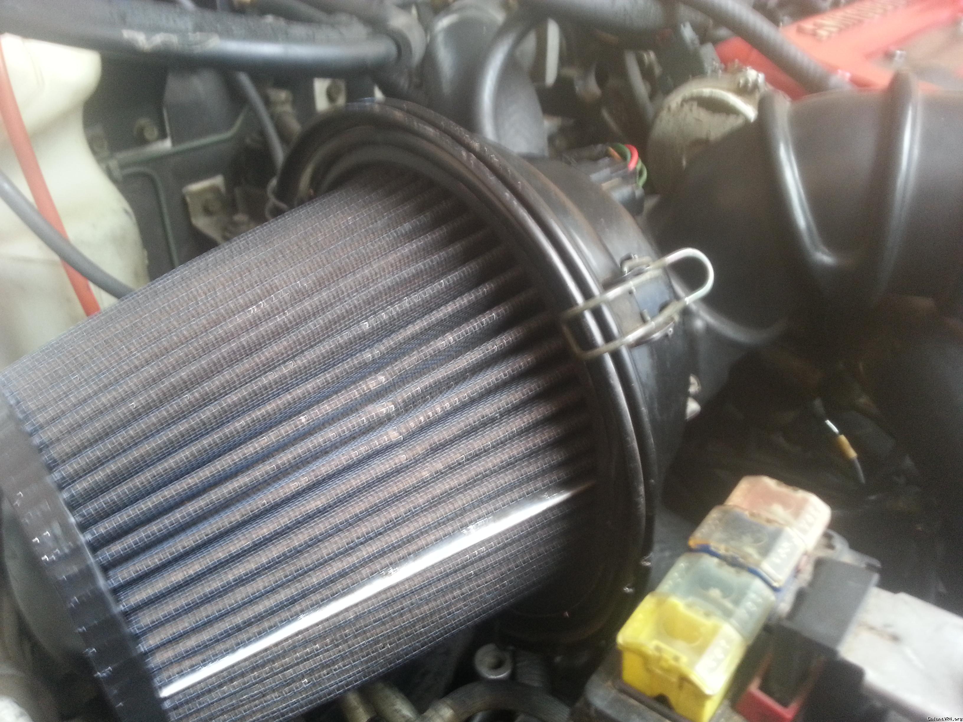

I have installed a new used maf I picked up locally. Its a 1g tel maf that's had the lower honeycomb removed and silencer taken off. My original maf was hacked in the same style but caused an IAT code. I actually didn't even realize that my maf was modified until I was swapping it out for the new one.

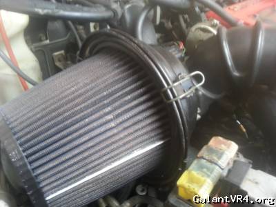

I made a custom ring to eliminate my aircan out of the 1g aircan I acquired. It holds the k&n filter snug against the original vr4 maf/aircan pretty well and I now have what I like to refer to as my super awesome speed whistle noises. You can hear the turbo and bov very well even when just cruising around barely getting into boost. It makes me smile every time it goes pshhh!
Im going to pick up some 550 or larger injectors, install a rewired walbro 255, fpr, 2g maf/pigtail, and get a linkv3 chip/cable as soon as I can. Then I will make myself a custom 3" catted exhaust and get an aftermarket downpipe and make a custom fmic shortly thereafter. Hoping to tune 250whp out of her and then start pondering my clutch and drivetrain mods.
I still have to tend to a few maintenance items. Gotta replace the brakes, brake lines, brake master, rad hoses and heater core hoses, fuel filler hose, harmonic balancer, ps belt and fluid, windshield, filter housing gasket, sway bar end links, rear wheel bearings, struts/springs/tophats and last but not least... the tranny with either a used unit for the time being or go ahead and drive mine down the road to Jack's for a stage 1 rebuild when funds allow.

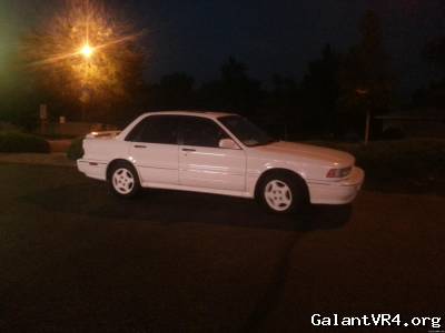

here's for the people who only look at these threads for the pics. .. enjoy!
Still beautiful with hail damage!

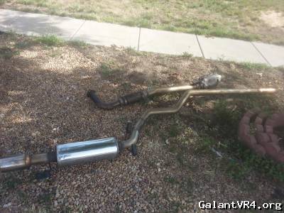

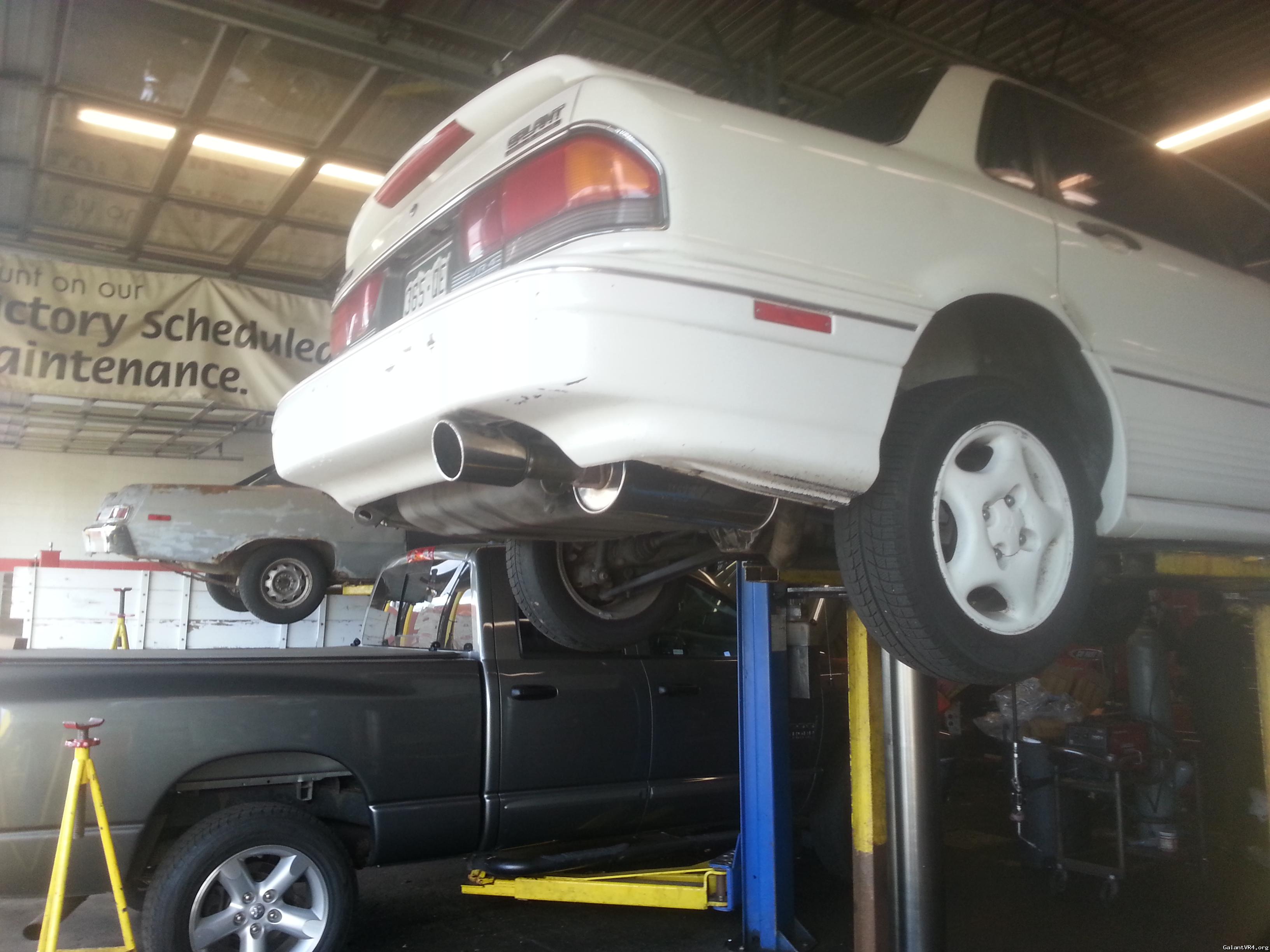

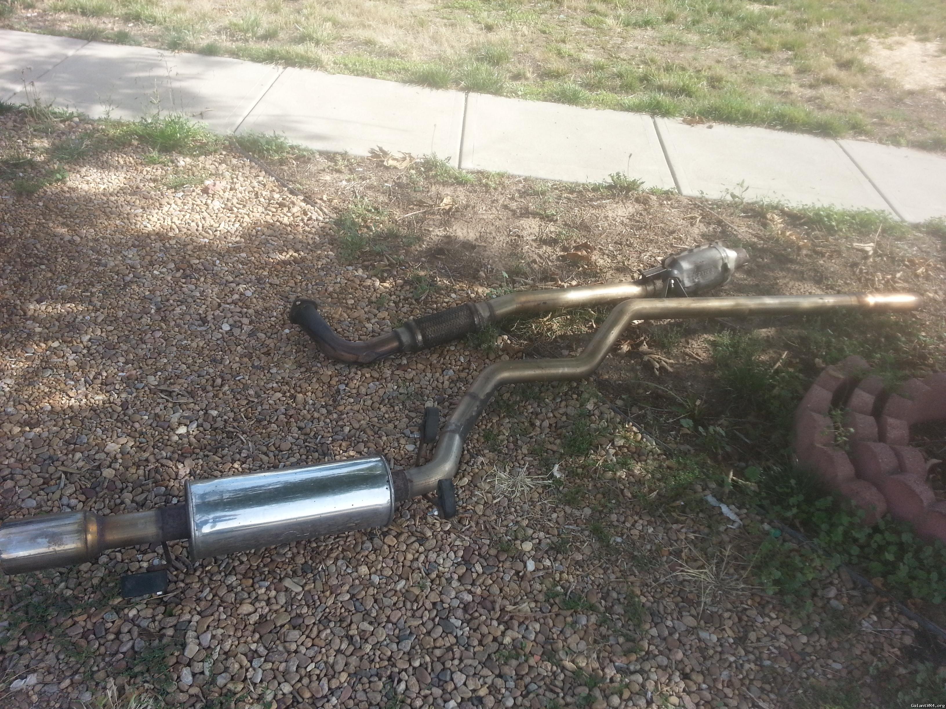

Picked up this stainless 2.5" downpipe and 2.5" exhaust from an org member locally today. Its made for a VR4. Its in pretty good shape and I got a killer deal. Couldn't pass it up. I had to cut it in half to get it home.
Can't wait to bolt it up!

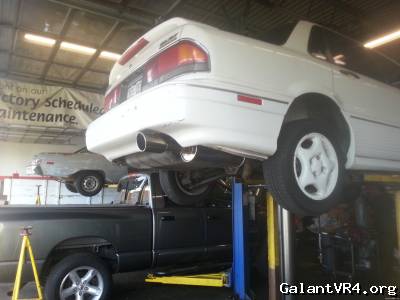

Got my new exhaust installed last week. Had to replace the flex pipe as it was leaking a bit when I applied compressed air to the downpipe. The entire system hung under the vehicle perfectly but, the tip sticks out a bit more than I would like. Im going to shorten it when I get some spare time at the shop.
It sounds so good now. Not to mention it picked up some noticeable power. I immediately had to crank the boost down because it jumped almost 3 psi. It now spikes 13 no matter what and then almost instantly goes back to 10 psi. Im trying to play it safe and keep the boost low till I get the fuel pump in and rewired, 2g maf, injectors and link. Ive just been driving it as nicely as I can back and forth to work, with the occasional wot moment.

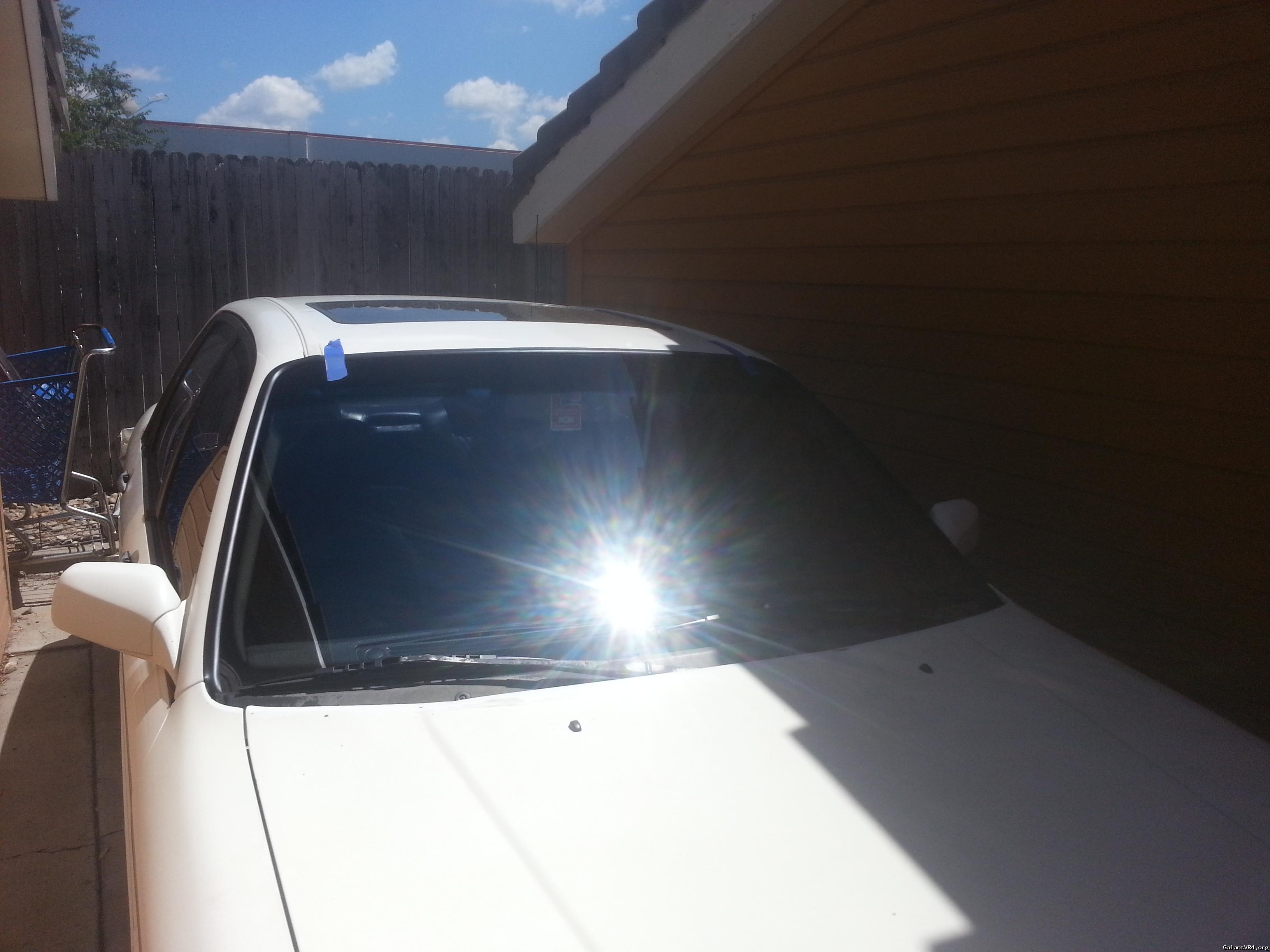

Today she is getting a new windshield around noon. I cannot wait! Driving this car with all the cracks is ridiculous. Ive just been waiting to get pulled over and ticketed. The current windshield looks so terrible you could almost push it in to the cabin by hand. Also I will be getting new windshield trim today. Just universal rubber stuff. I hope it looks alright.

Cracked windshields are very common here unfortunately. When I hop into customers vehicles at my shop about 75% of them are cracked up pretty badly. Hopefully this one lasts me a while.
The new trim looks pretty good to me. I may have this done to the rear window also.

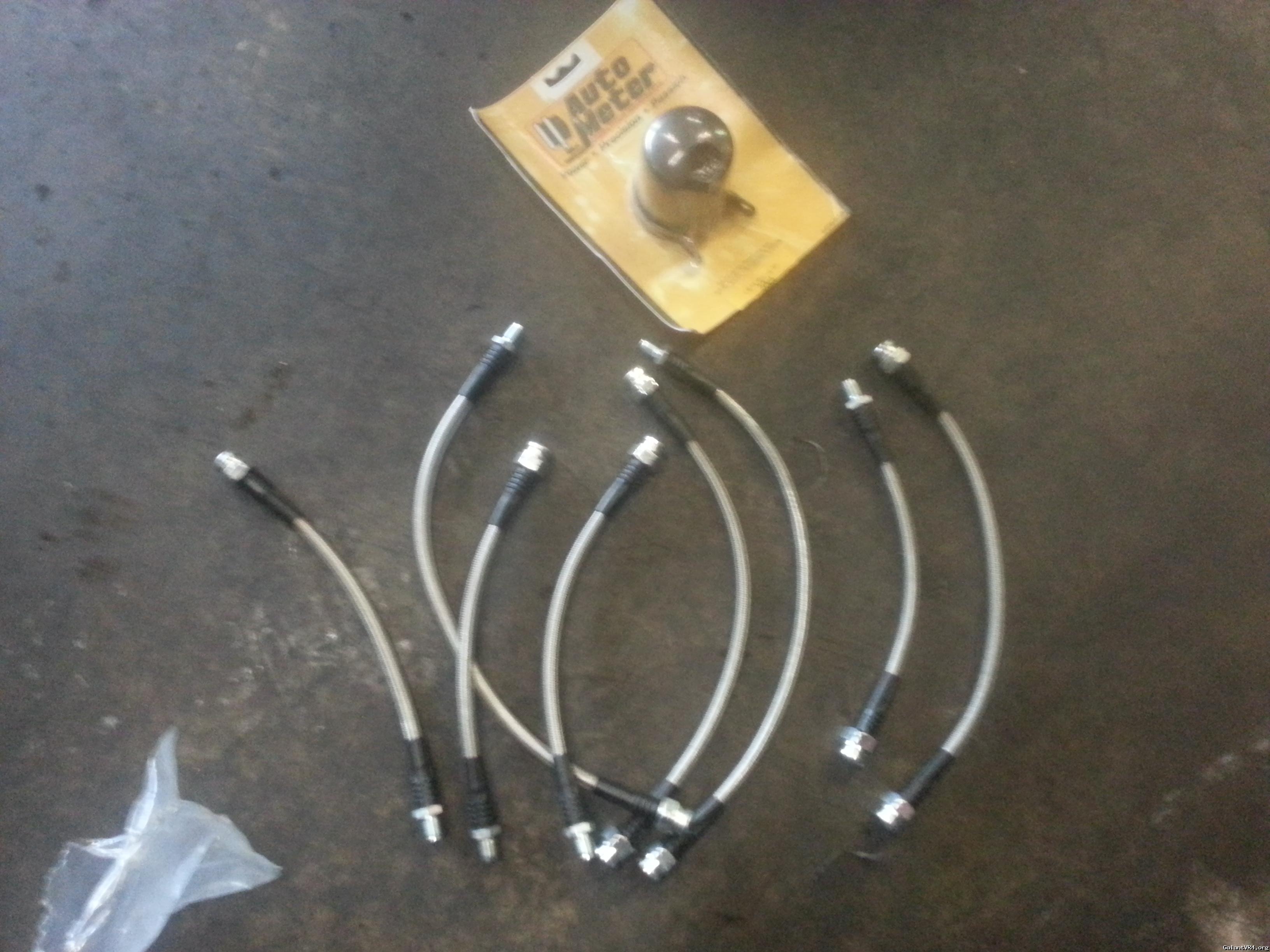

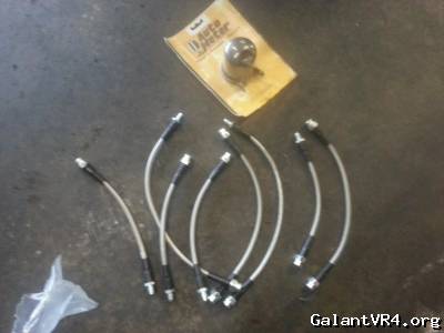

New JNZ braided brake lines arrived along with a gauge cup so I can permanently mount my boost gauge!
I have put 3000 miles on her now. Changed the oil over to Mobil 1 10w/40 fully synthetic high mileage with a can of BG MOA also.
The lifters have started making noise on cold starts within the last 1000 miles. Kinda annoying. Im now considering replacement options. Everyone seems to recommend the 3g lifters so I will probably end up buying a set when funds allow.
