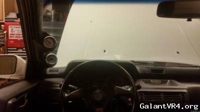

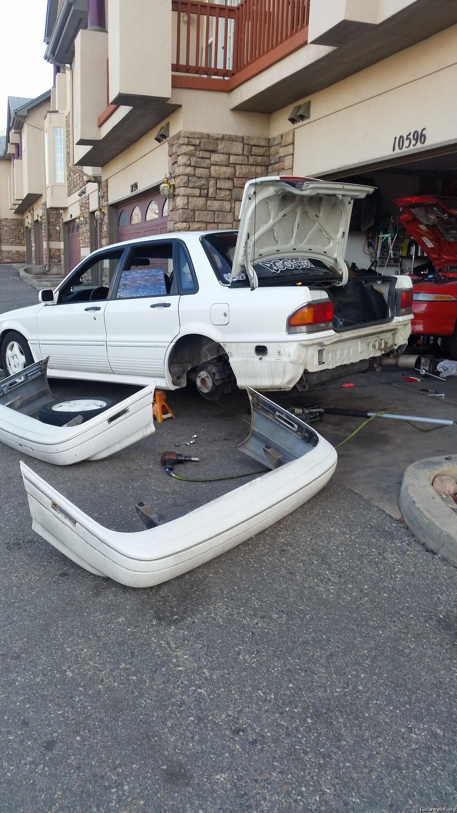

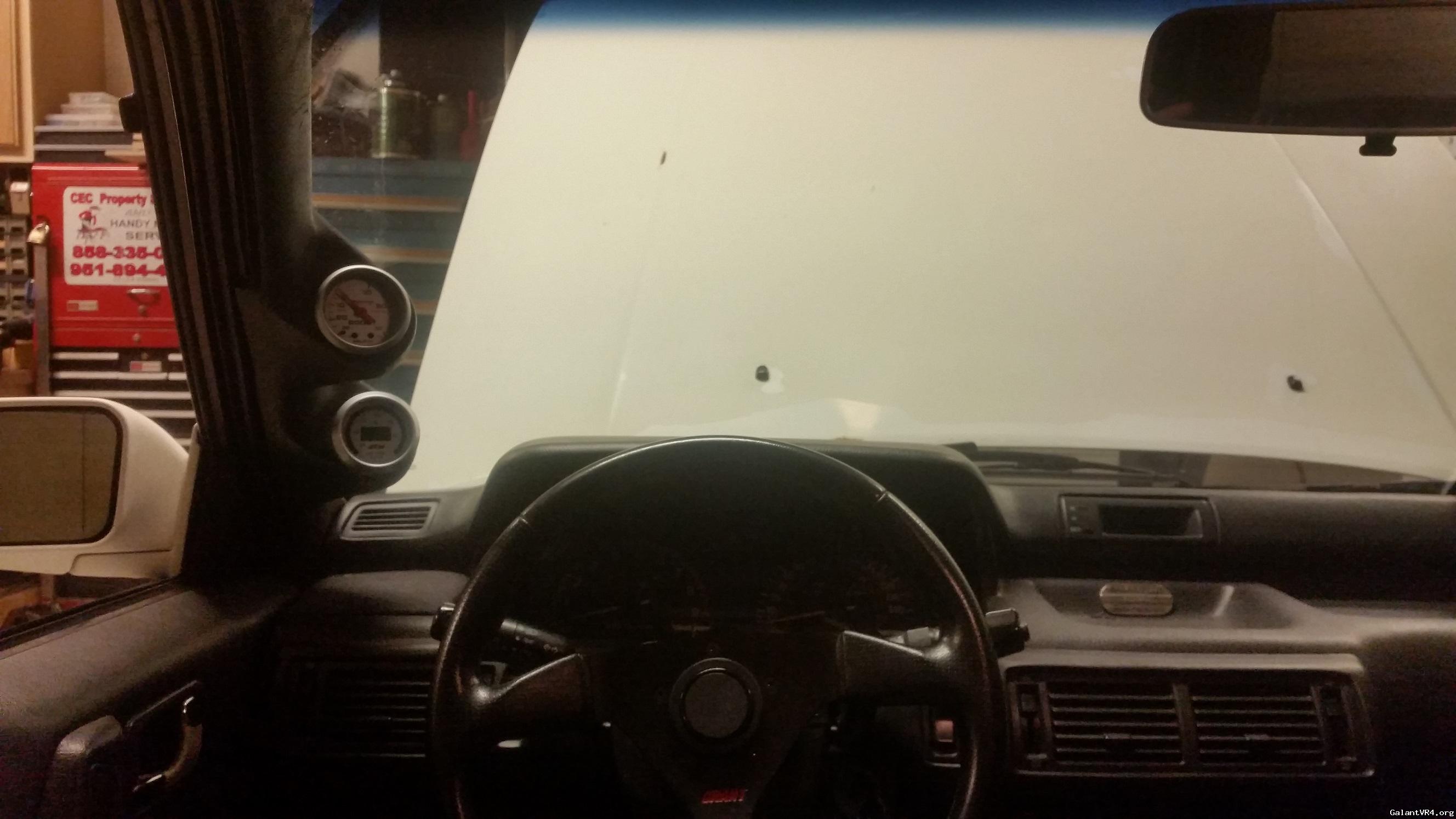

I've installed a new used hood and rear bumper that were in much better condition than the original parts. I've also installed a paulo pillar 2 gauge pod. Looks much better than 2 gauges resting on the driver speaker cover! I put in a very special steering wheel, It came from my very first car. I think its a Grant Formula. I completely removed the charcoal canister and lines. Removed the cruise control as well. Installed a poly front roll stop too.

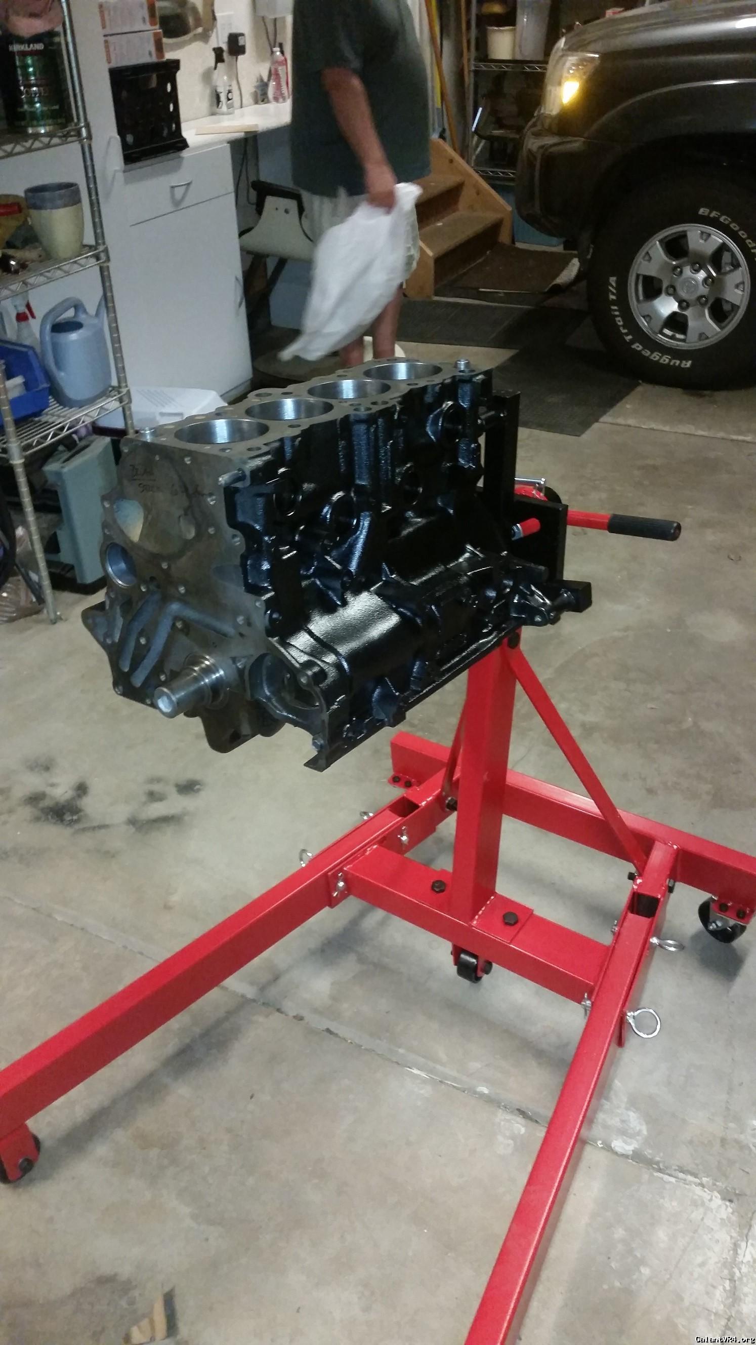

Also I purchased a new rebuilt shortblock.. Assembled with stock pistons, rods and crank. ACL crank and rod bearings and ARP rod bolts. Still need to buy a ton of parts to put it together. Also picked up a used head that I still need to take to the machine shop and see if its use able. Got it very cheap due to a couple cracked guides.

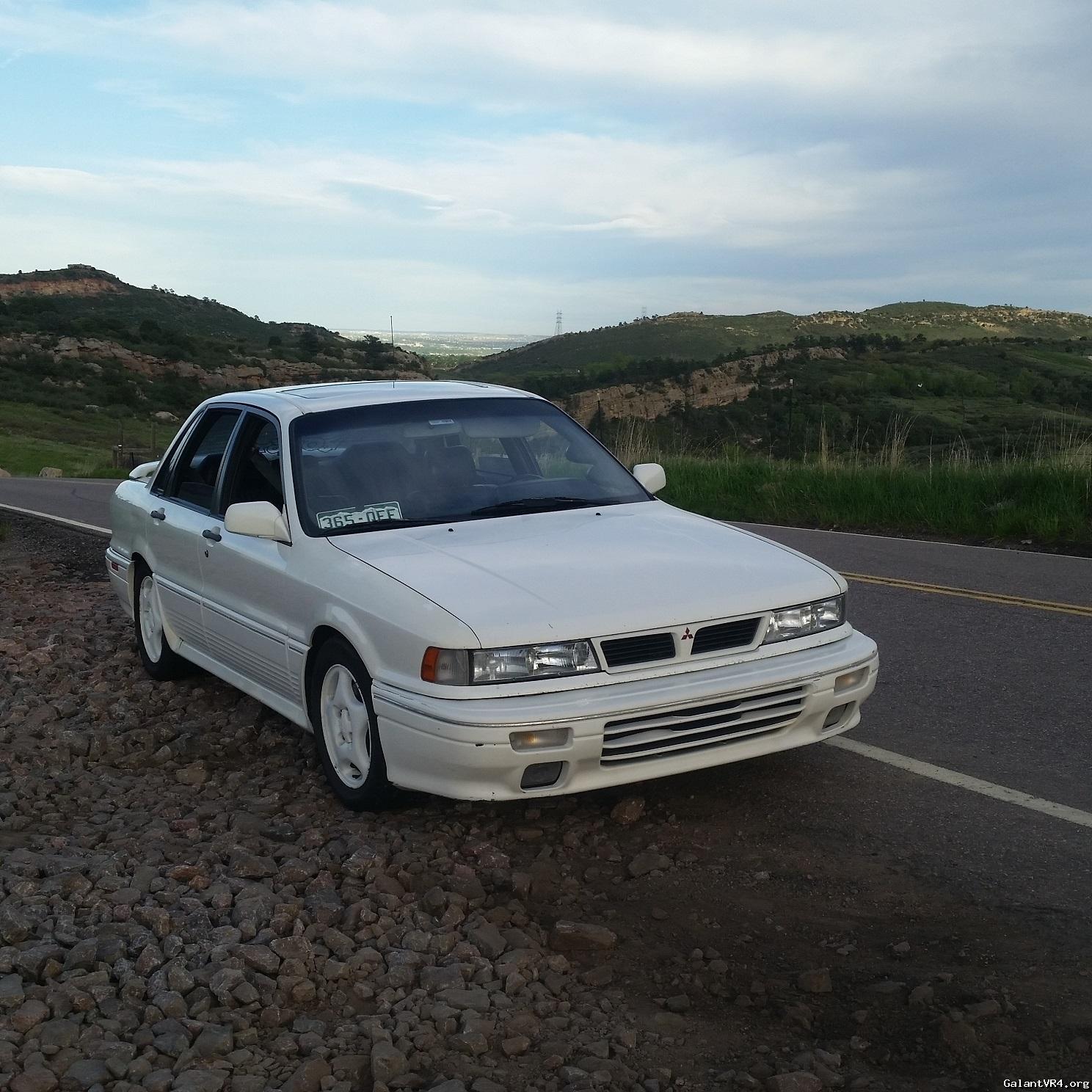

I've really been enjoying the car with the few mods I have done. Its just so enjoyable to drive on the winding mountain roads here. I think it handles fairly well and has just enough power to get myself into trouble! I suppose I'll list the mods as of right now..

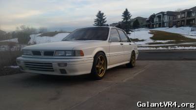

New steering wheel and pillar pod installed
Snowy meet last winter
Not so snowy meet this spring

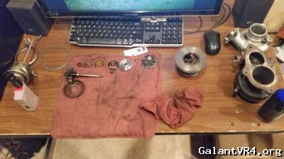

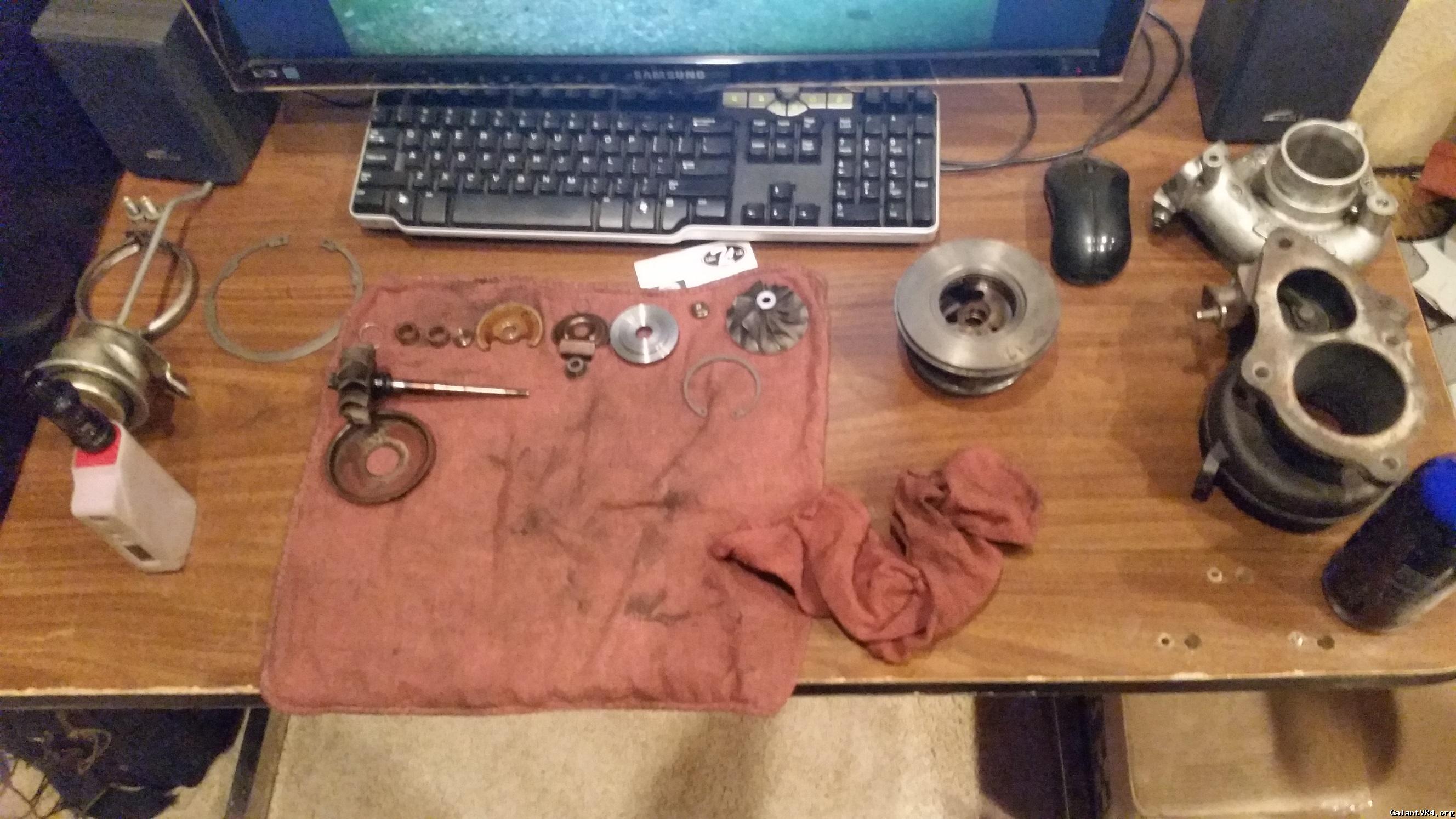

Small 16g getting rebuilt
Finished Small 16g

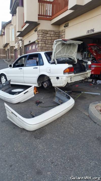

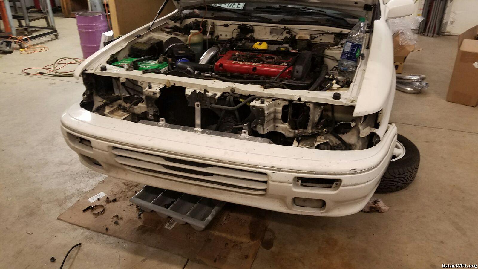

Installing new rear bumper
New shortblock

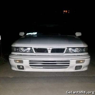

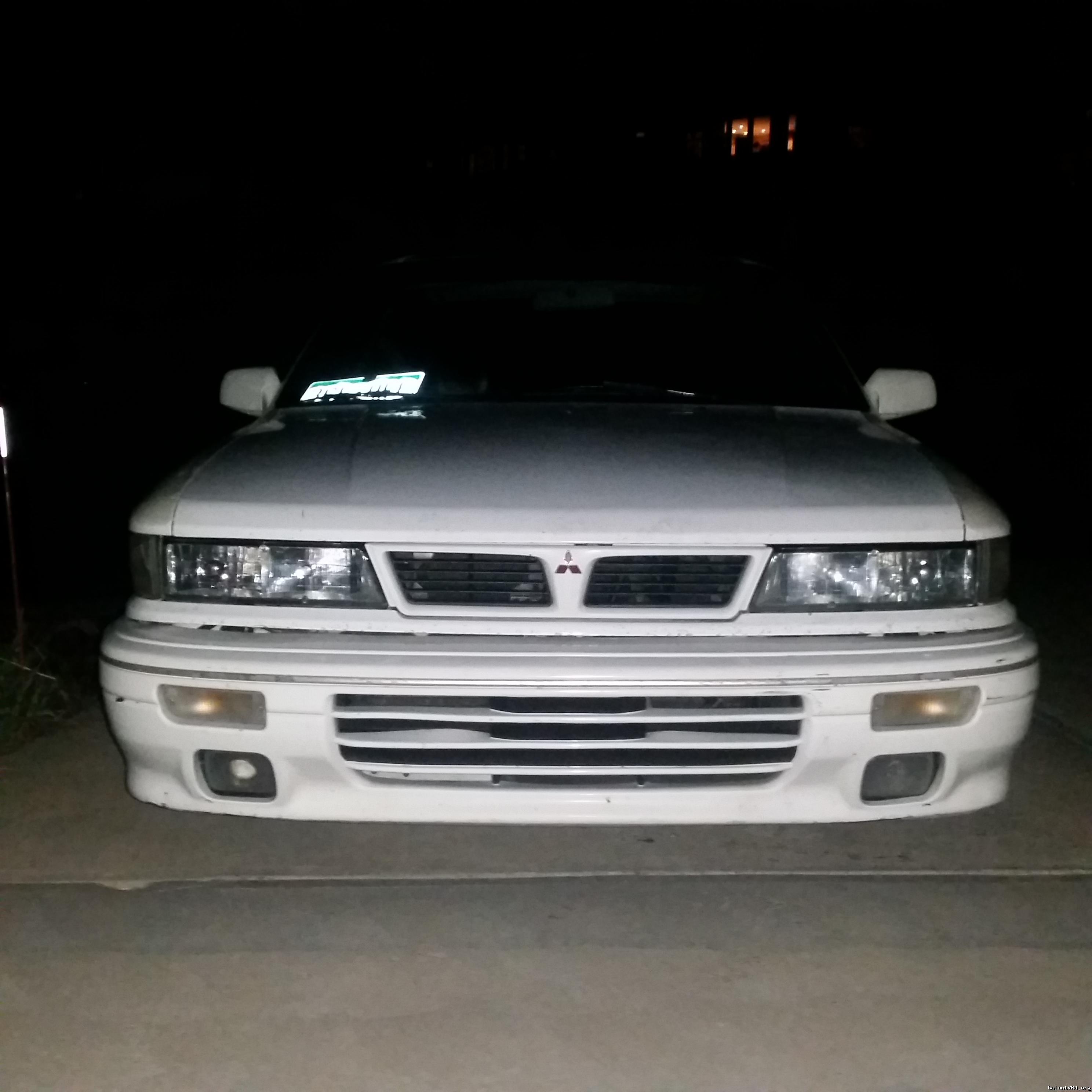

new hood and '93 headlights

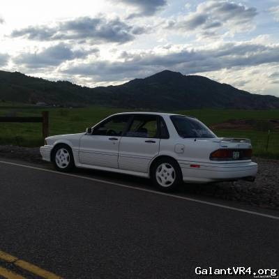

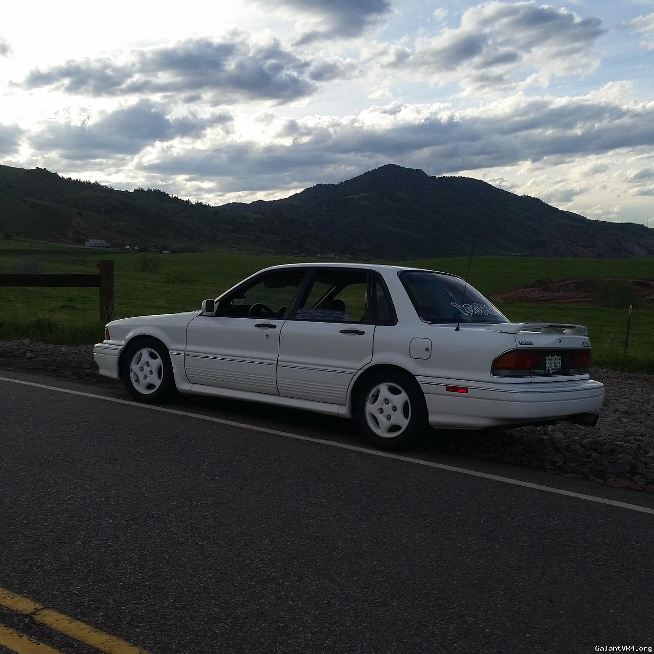

Sideshot with red rocks park in the background

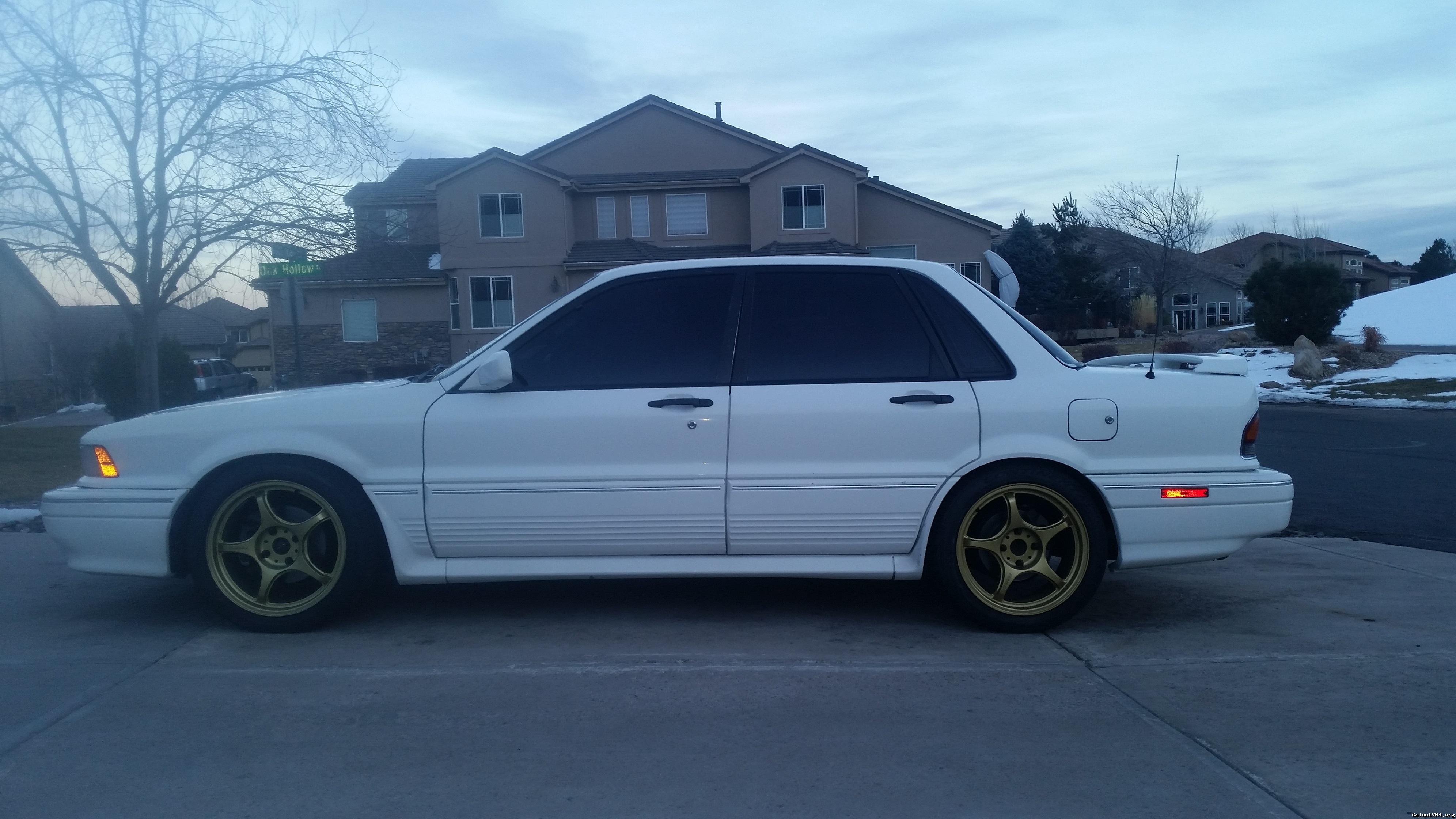

Had the windows re-tinted with 20% all around and a windshield strip done also. Looks pretty darn good. much better than the bubbly 20 year old purple tint it had.

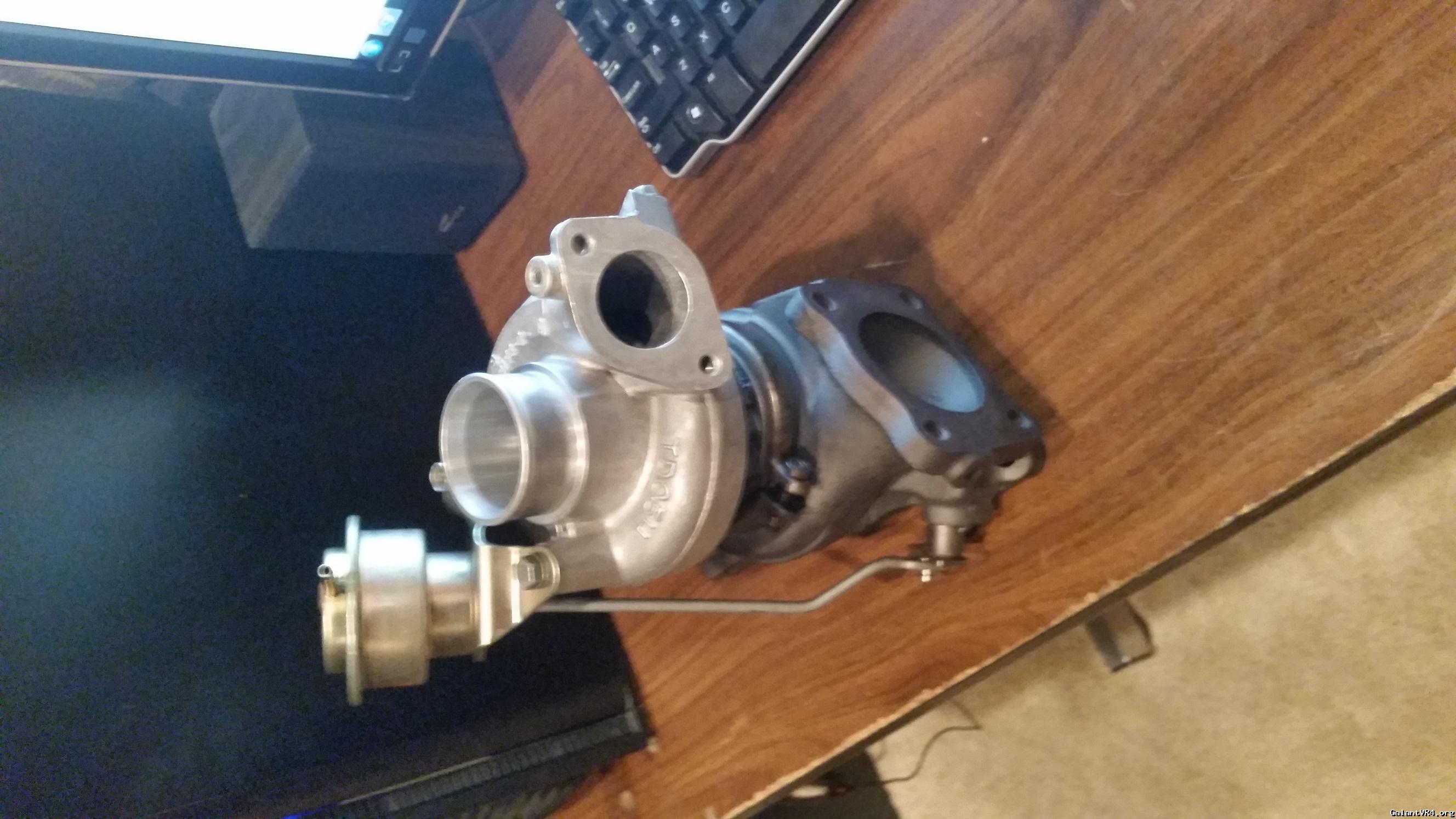

Turned the new rebuilt small 16g into a billet wheel tdo5/20g with an anti-surge cover. I have a few small items to address before I can install it. It will be downfiring so it changes a few things. Not quite sure if its going to clear the waterpipe either. Its going to initially be internally gated but, I plan to externally gate it soon. I will be buying a FP exhaust manifold and a recirculated wastegate o2 housing.

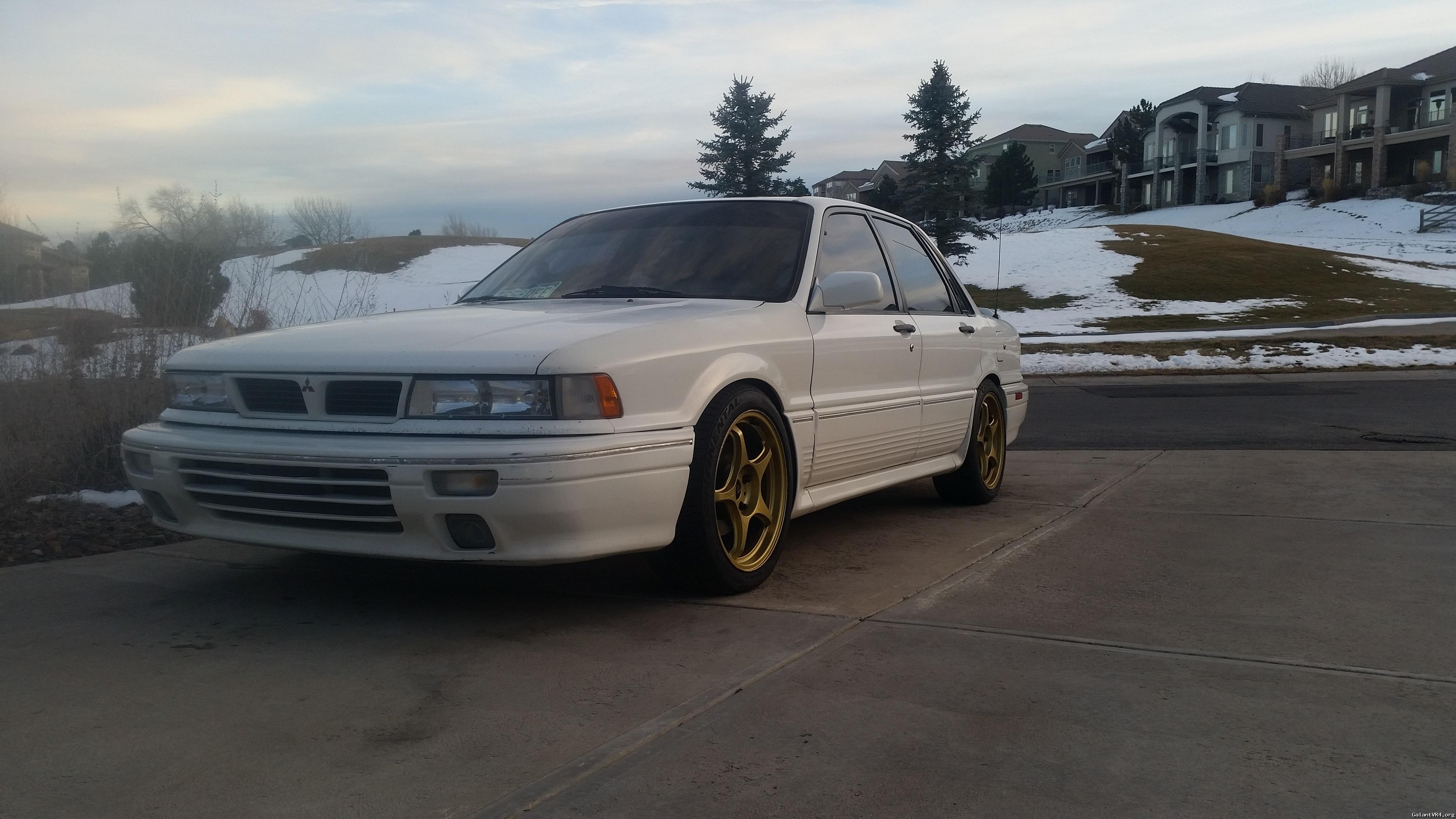

Said goodbye to 677/1k last night. It was so hard letting her go. I had a tough time even walking away from her. Handing over the keys was the hardest part though...
But I'll have her back in a few days with about 200 more HP! Dropped her off with a local fabricator/dsm guru to have all the parts I've been gathering installed! I'm a bit nervous since no one else has ever worked on my car besides myself.
Lots of good stuff is going in.
Big gvr4 specific fmic
All custom made 2.5" piping
Fp manifold
Tdo5 20G w/billet wheel and anti surge comp cover
Tubular o2 with a tial 38mm gate/dump tube
Go fast bits Bov
Custom intake tube keeping stock battery location
I'll post some pics when I get the car back and tuned!
edit: Forgot to mention, I bought a some wheels too. Picked up a set of 5Zigen FNO1R-C hot editions in 17x8 +35's. They have been painted gold and one wheel is bent. For 160 bucks I could not pass them up. Having the bent wheel repaired asap and then trying to figure out what tires I would like to put on them. I'm considering Conti Extreme contacts but I'll be looking into other options as well.

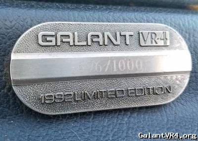

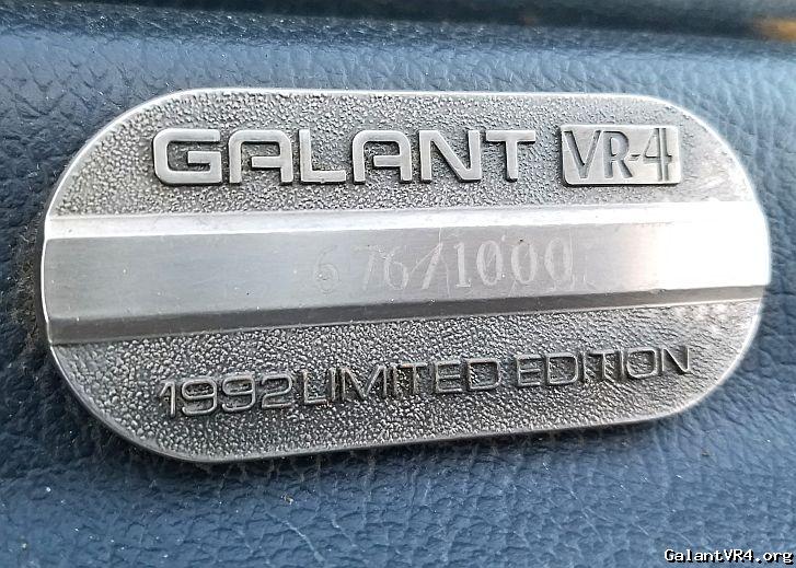

^Awesome man! Too bad mines not actually 677/1k. Still trying to figure out my actual badge number. I do have an extensive history of my car but no one seems to know what the original badge number was. It's a mystery.

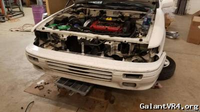

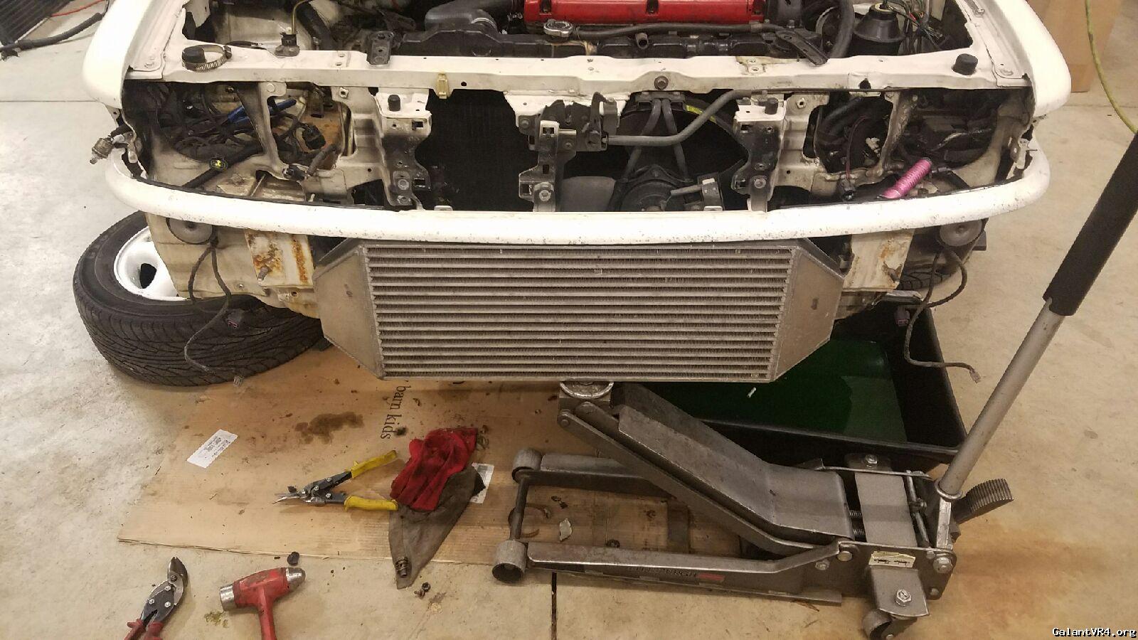

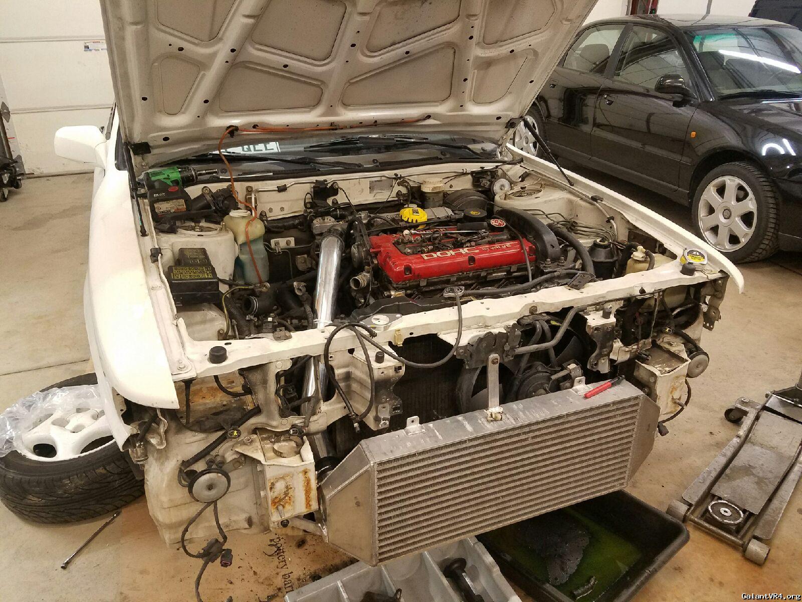

The ETS core tucks oh so nicely behind that uncut bumper... 10" tall with room to spare... 1g 3" core. I ended up having to pick up this intercooler due to a fitment issue with the stock radiator and the GVR4 specific core I had previously purchased, in the middle of the installation process.

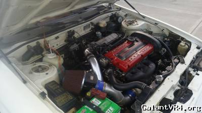

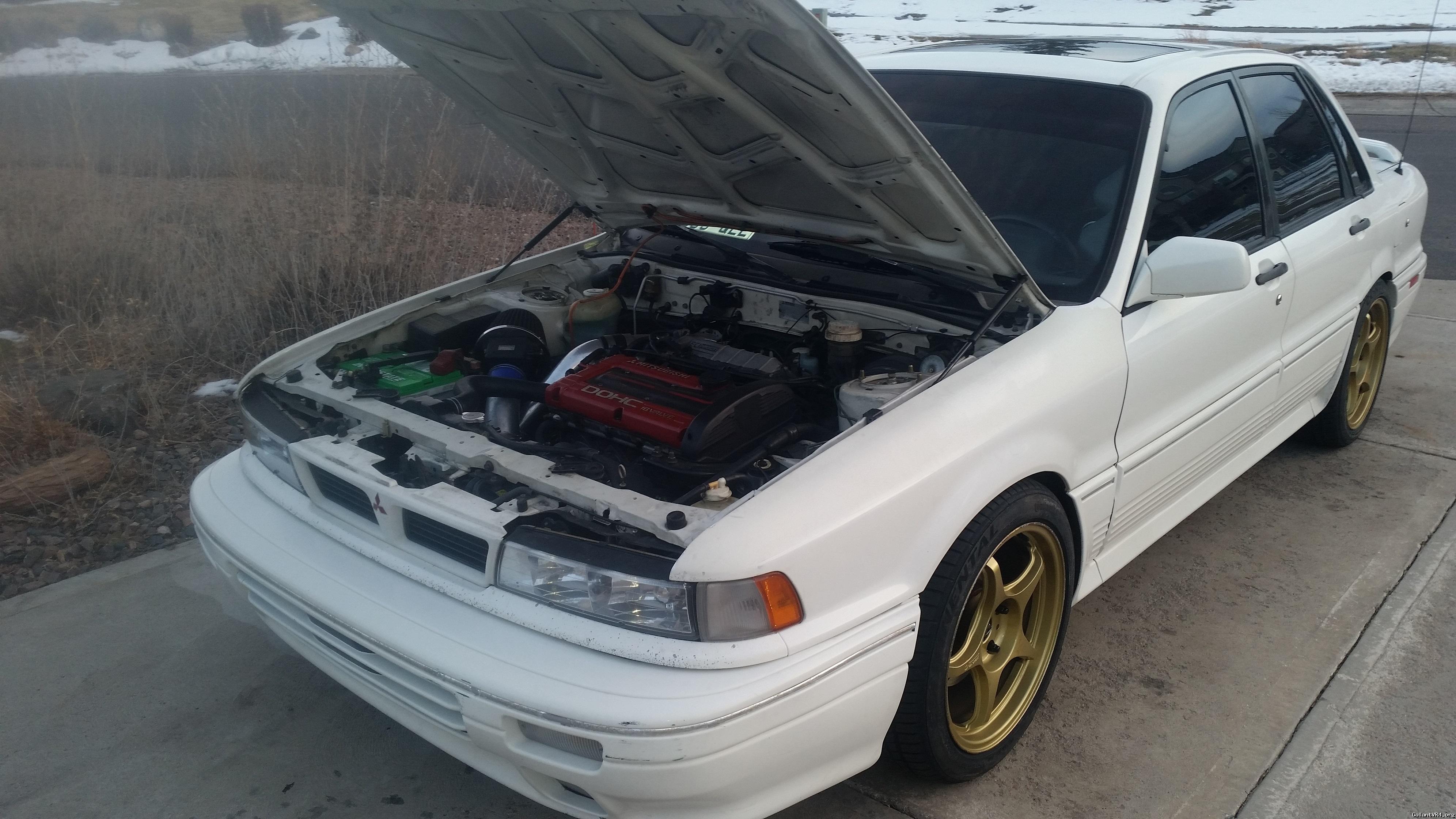

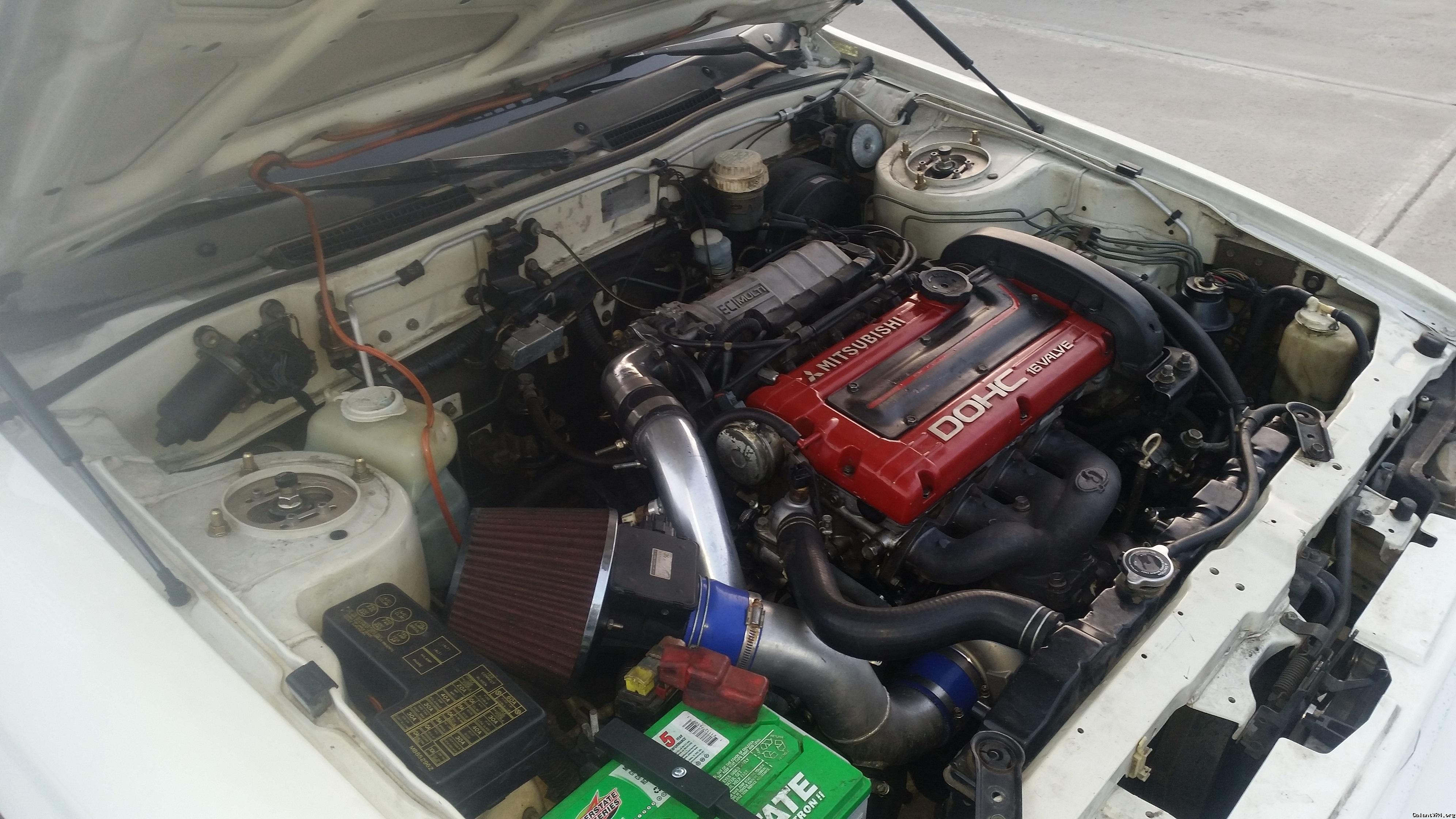

Uploading a few pics since the site is back up....

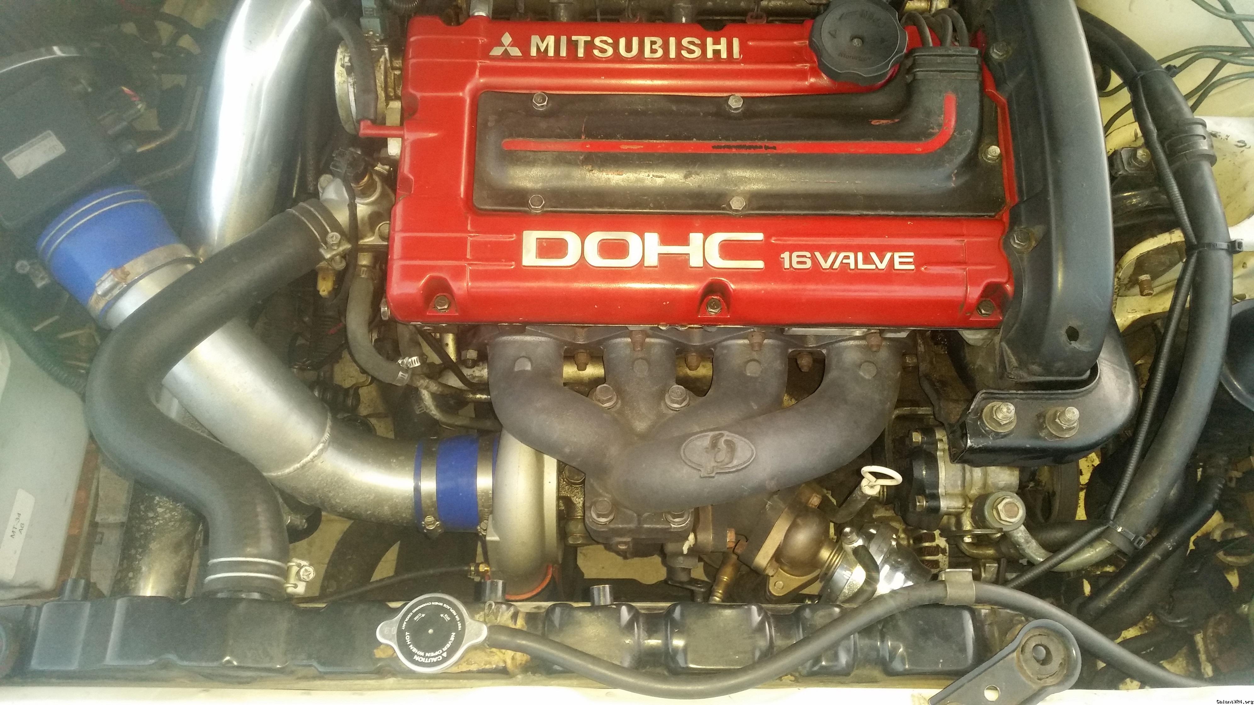

Car is running very well on the new turbo setup. Pulls very hard after getting it tuned.
New setup:
Ecmlimk v3 full- tuned at about 25psi
bastard mhi tdo5h 20g, billet extended tip wheel with anti surge compressor cover and aftermarket .70 A/R hotside
FP race manifold
JMfab o2 housing/Tial F38mm 2 bolt external wastegate and custom dump tube
2 1/2" downpipe and catback with high flow cat/ dynomax muffler
660cc denso injectors
Walbro 255lph using stock fuel pump wiring/37psi base, stock fpr
Ets 1g 3" race intercooler with custom 2 1/2" short route piping
Go fast bits Mach 2 bov recirced
Custom intake pipe
evo 399 maf with Blox Filter

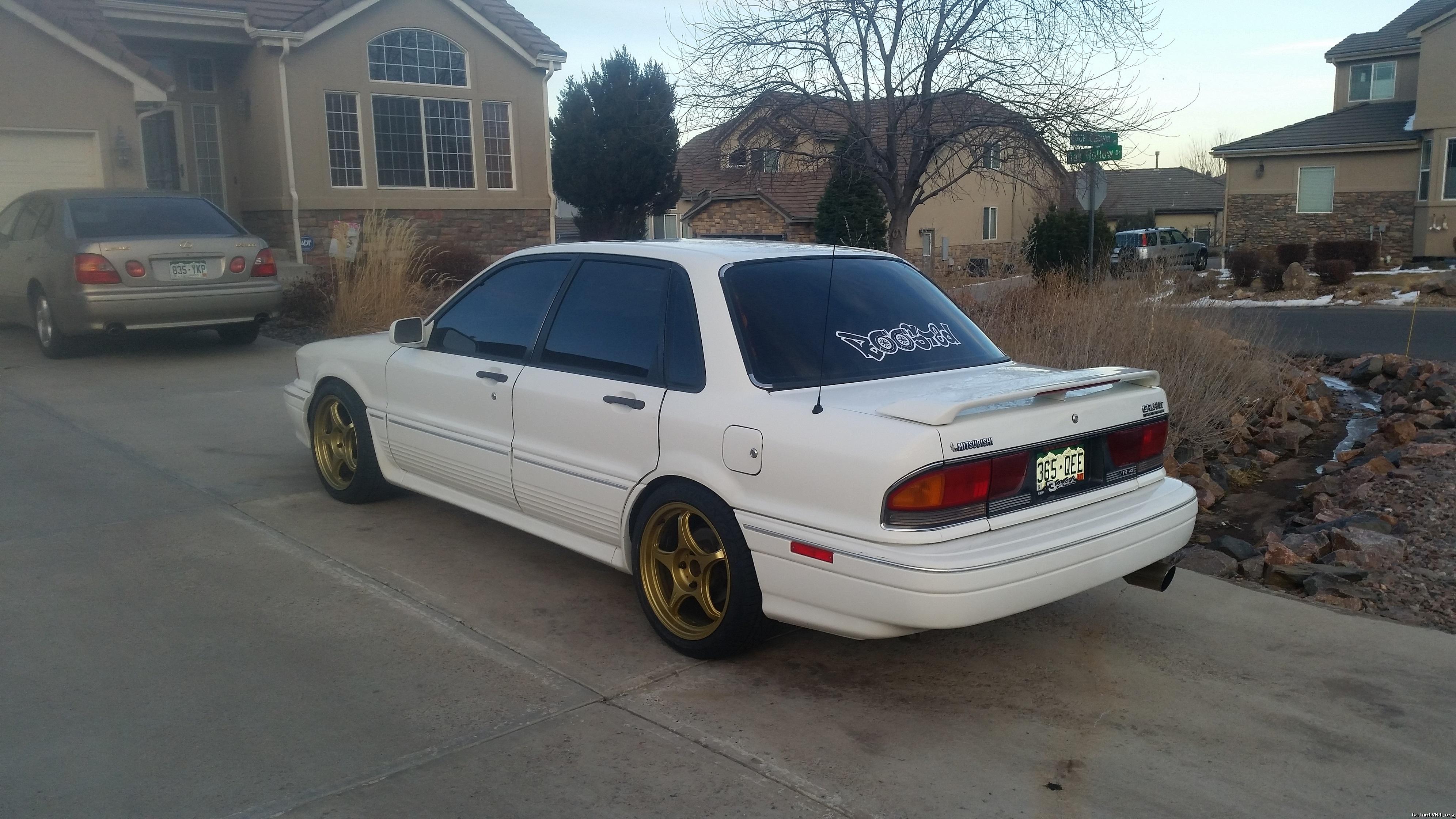

New wheels and tires
5Zigen FN01R-C 17x8 +35 4x114.3
Continental Extreme Contact DWS06 225/45-17
