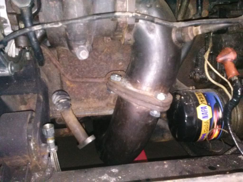

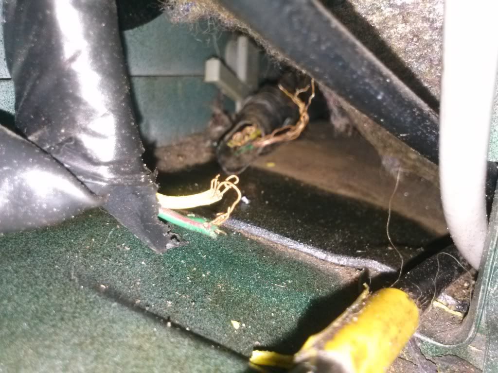

so i get to cleaning ina the trunk last night when i run into this. Hwaaaaaaa, could this be a source of a future melt down? not on my watch!

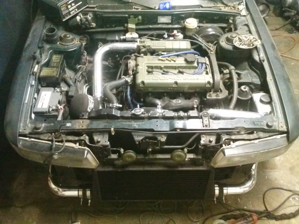

well im at this resurrection's final stages, it started up on an evo8 base tune last weekend but wouldn't idle long. log showed a bad o2(wiring). new o2 ordered, wiring is getting sorted. i also got a knock sensor dtc, replaced the sensor and cleared the code. and lastly i unpluged the evo8 maf and it ran fine!! for a few secs then it starts idle surging.
there's a way to lock the car in closed loop, but im not familiar with v3. i got an sd kit and p&p harness from ecmlink i picked up a while back and decided, i don't need no stinking maf, so a good buddy will be here sunday to tune in speed density. till then i'll sort out all its issues.

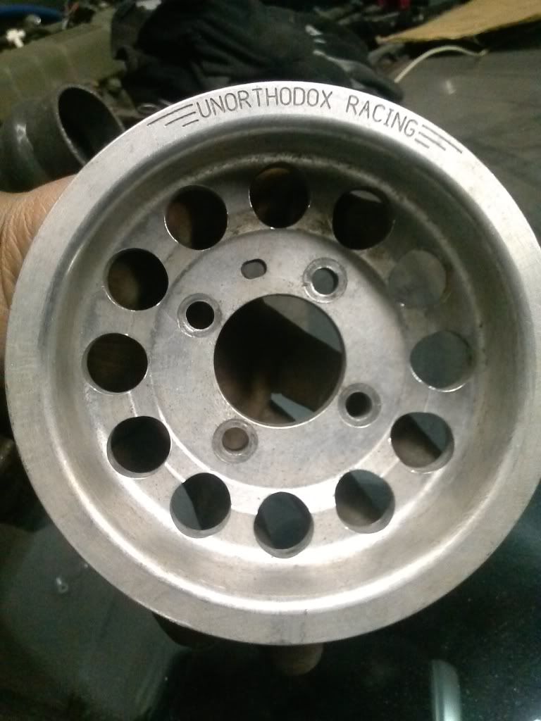

Looks good! I wouldn't run that crank pulley though. Will end up doing more harm than good. Also I would invest in some exhaust wrap for the downpipe and exhaust mani. As well as some reflective material for that upper cold side output next to the exhaust mani.
ade
Aug 16, 2011
303
Paumanok NY

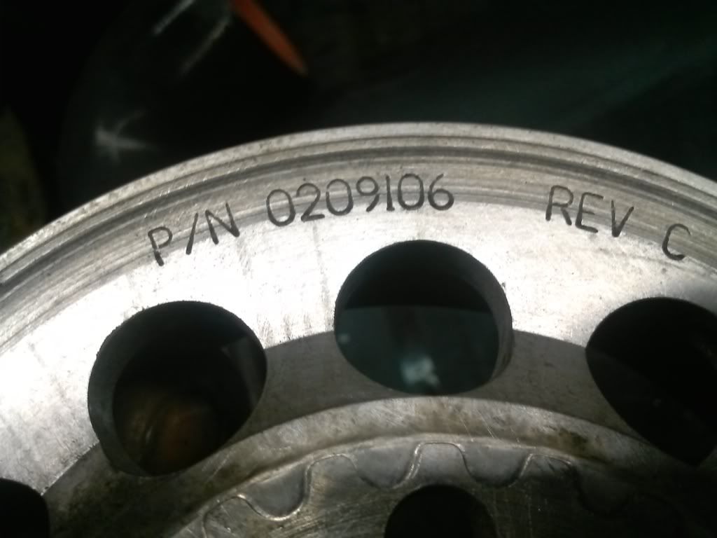

crank pulley came with the car, are there horror stories to running it?
yeah i picked up some reflective material for the piping but wrapping the manifold and downpipe... taking it off.... then putting it back on.... sigh
