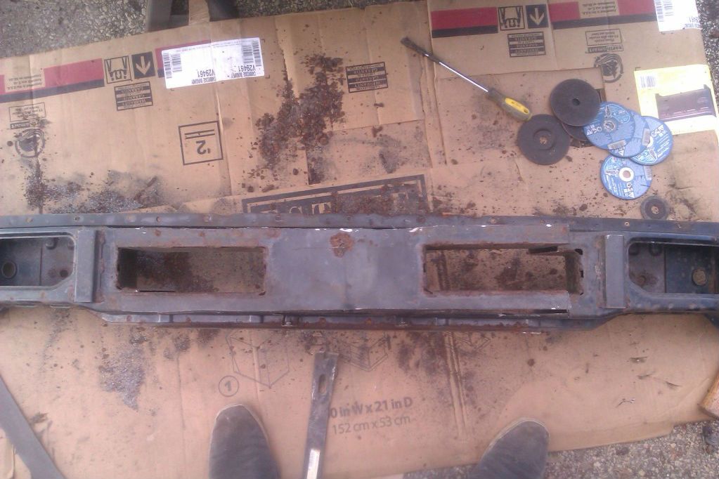

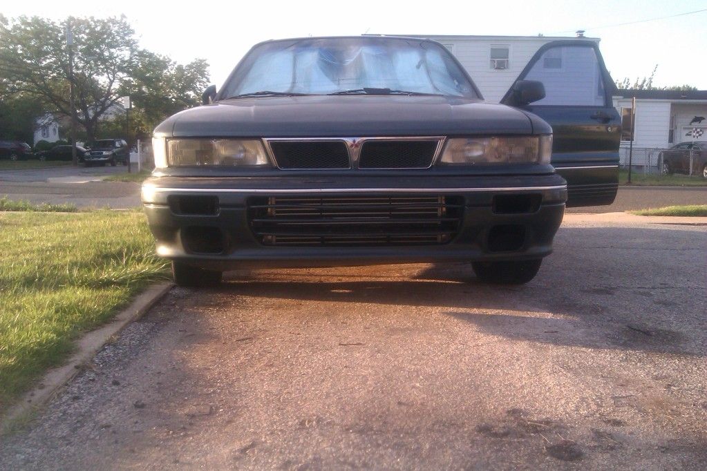

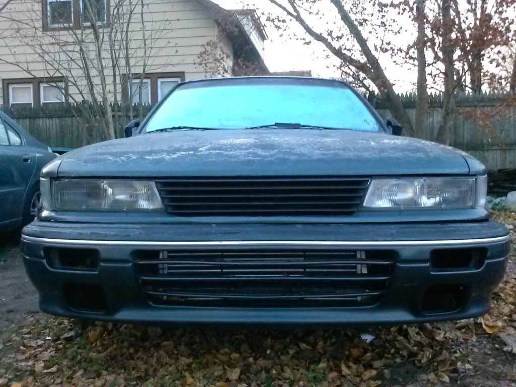

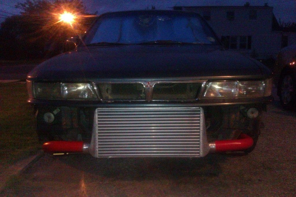

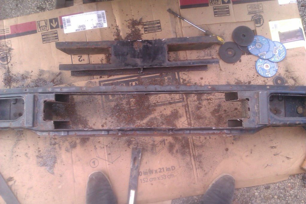

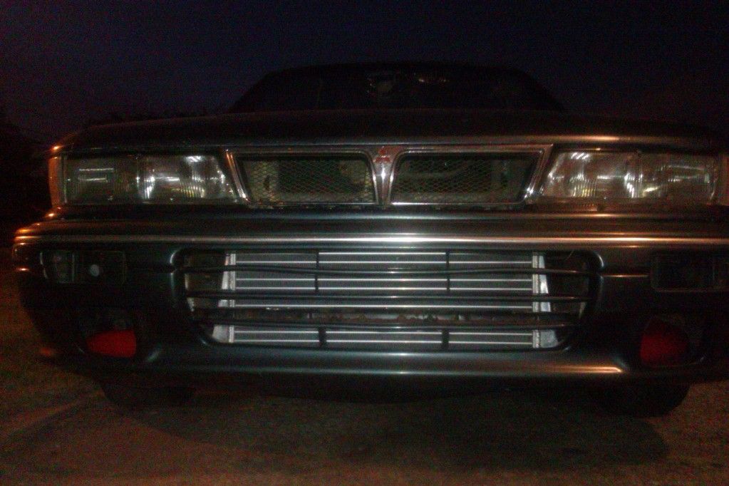

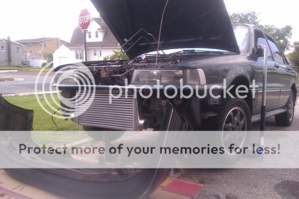

found room for the ic with a bit of remodeling for a better view
me thinks we have room for a set of minty oem fogs, any sellers?
my ic to do list
ic mounting brackets
box up the openings on the rebar or leave and spray bomb /ubbthreads/images/graemlins/dunno.gif
pipe routing

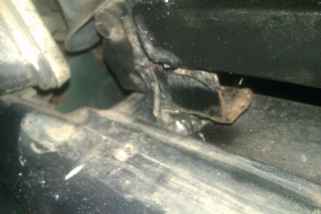

bonnet latch brace
fan relocation
ps cooler rerouting
and then some.

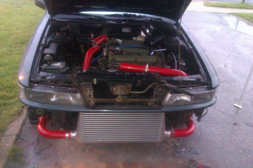

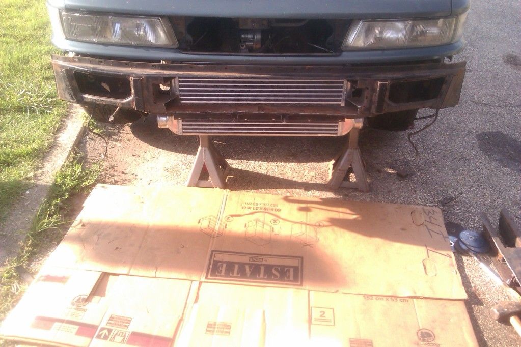

ic is mounted

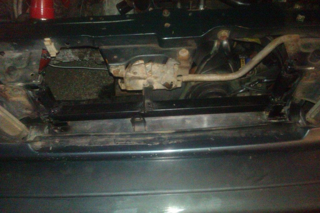

bonnet latch brace made
fan relocation done
ps cooler rerouting done
all thats lefts pipe routing

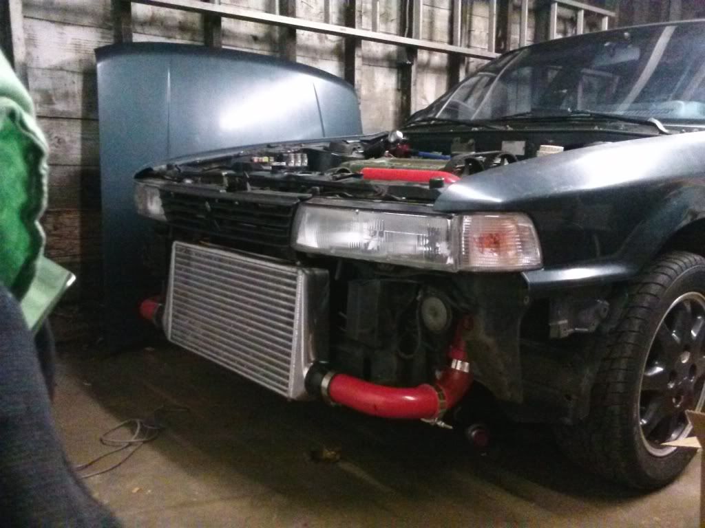

Thanks guys.
32 X 13 X 3.25 full
23.25 X 11" core
3" inlet
as for who made it? it was an off a buddy's dusty shelf, 100 dollar and its yours brand. But i know ebay when i see it.

Looks good! Quick question, how/where did you mount your IC? Did you make custom brackets?

the progress your making is awesome. Do you care to post up some pics of your i/c setup in regards to the piping? Im having a hell of a time trying to figure out a good way to route mine.

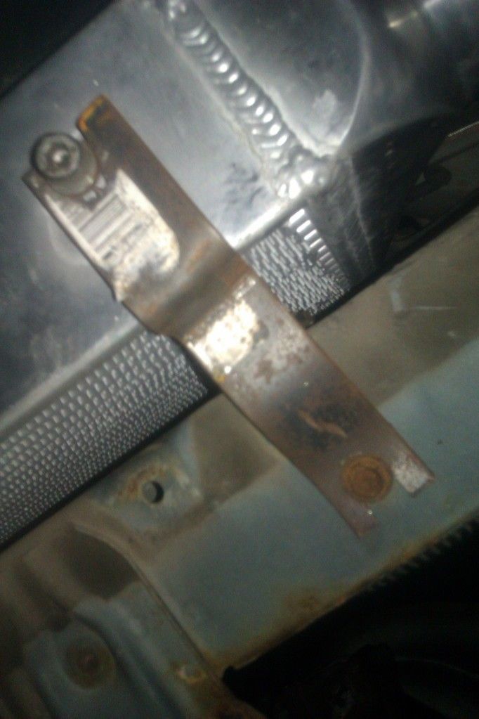

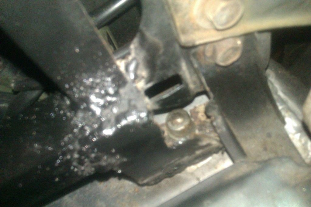

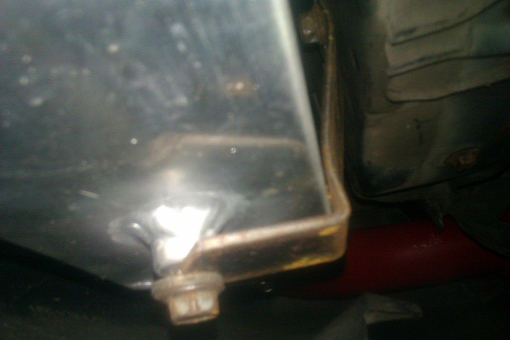

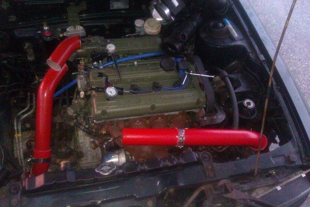

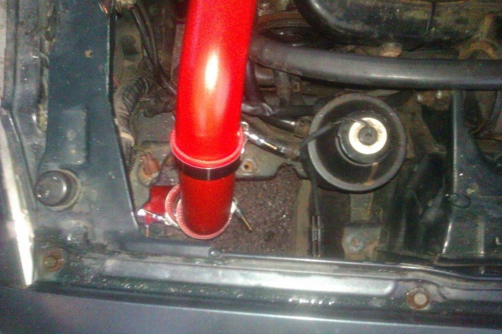

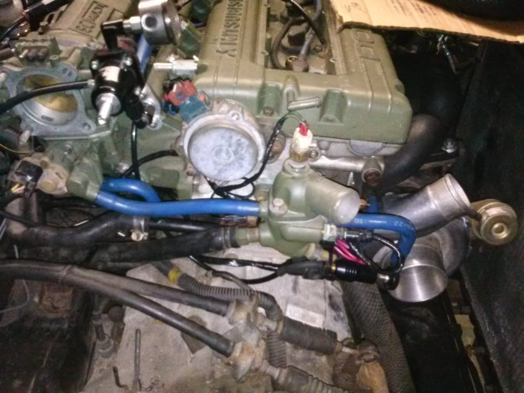

top mounting points are bolted to a frame thats welded to the body. for the bottoms, i bent some steel to work with bolt holes already available. ive got to re adjust for a better bolt hold, use bigger washers then rattle can.
scooped up the goodies on the left ta replace those on the right

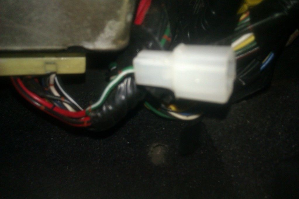

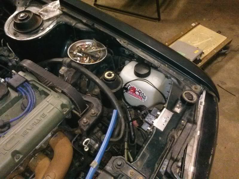

also i found this by the ecu. any1 have an idea what this plug is?

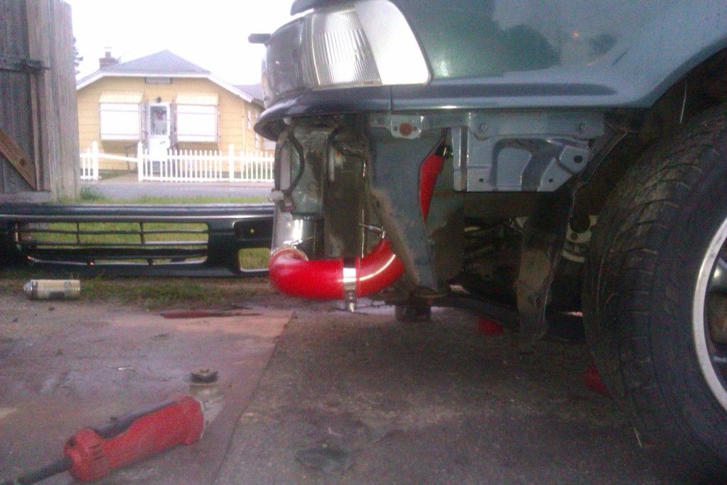

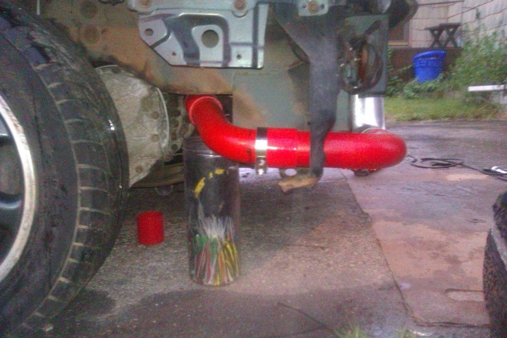

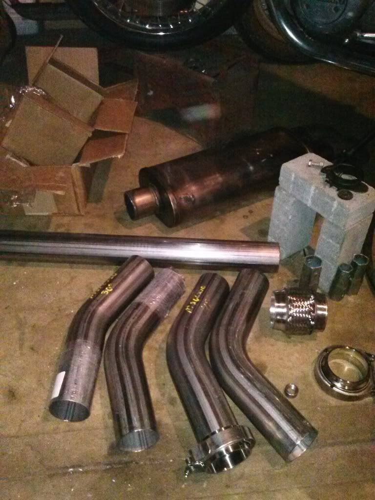

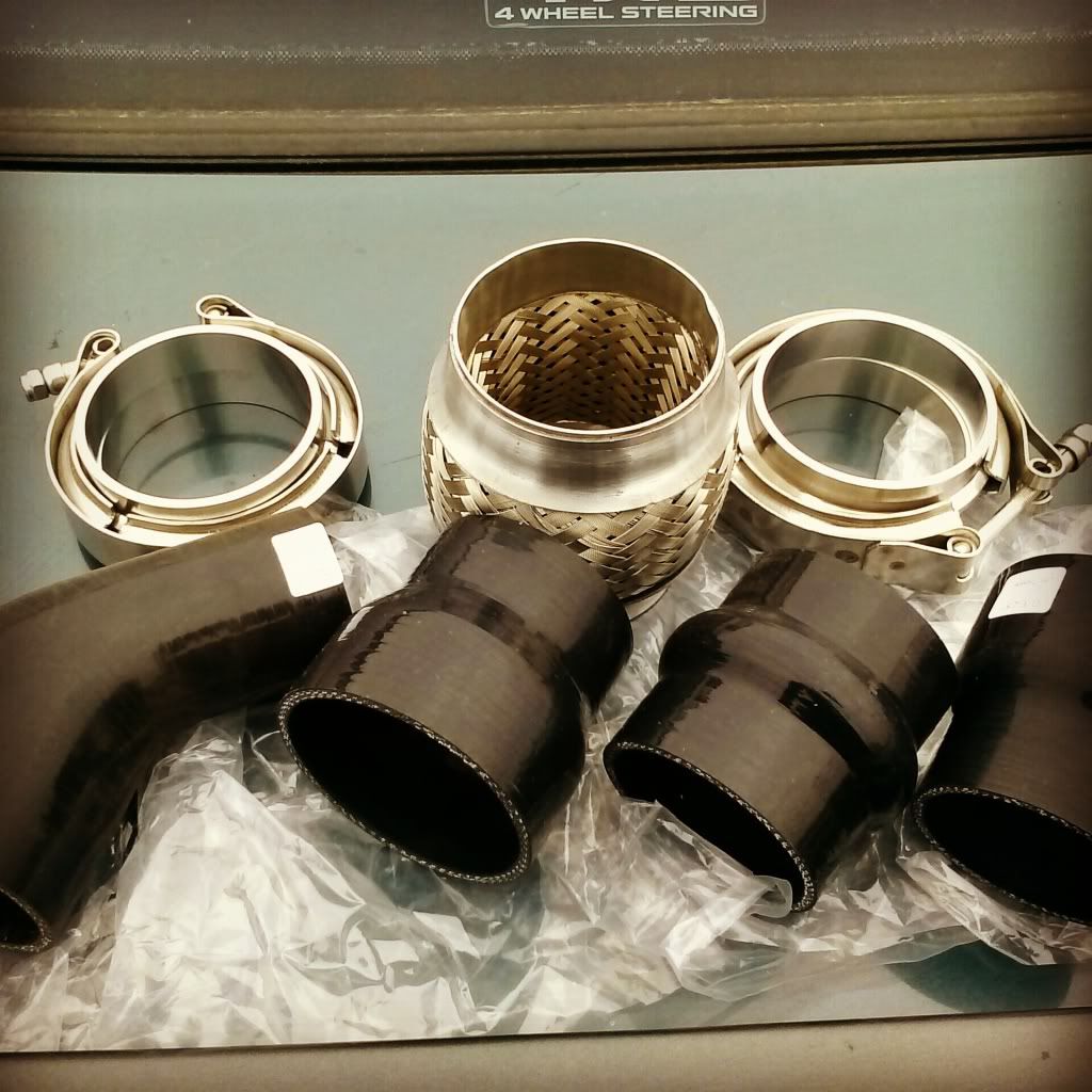

forgot about the pipes
throttle body, cold and hot side pipes are cut fit and ready for weld.
one 1g bpv flange
one 2.5" hump hose
one bending reducer
2 straight reducers 2.5" to 3"
not 100% sure but that should be the o2 voltage output.. you can run a narrowband gauge to it for a reading.

A buddy stopped by today saw the car an said "when u gonna git that thang runnin" so i finished up the hood latch, front bumper & worked on the ic pipe routing a bit. we talked about going halvesies on a aluminum welder, we'll see(getting fed up ov waiting on people)

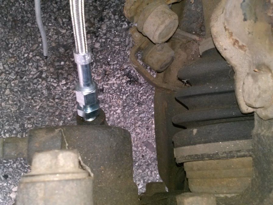

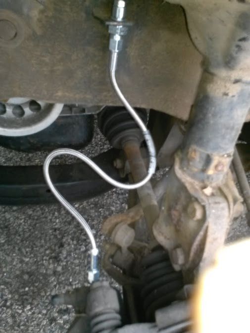

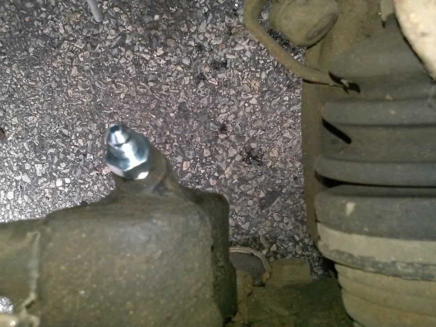

but before the storm, i installed the ss brake lines. i have to order shorter length fronts but the rears are mint.

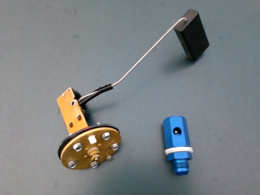

found and installed a fuel gauge sender & tank breather
got in the last few exhaust and ic setup

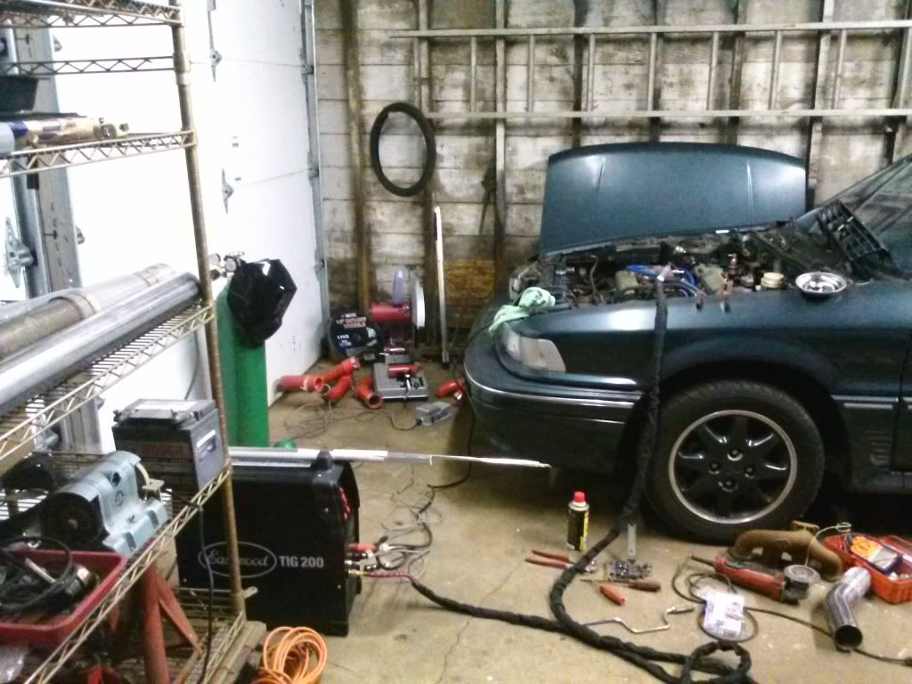

got fed up with vein promises and outrageous prices so i ordered a tig welder, tank and supplies. also moving to my new stay with a nice garage. tune in, there's more coming soon.

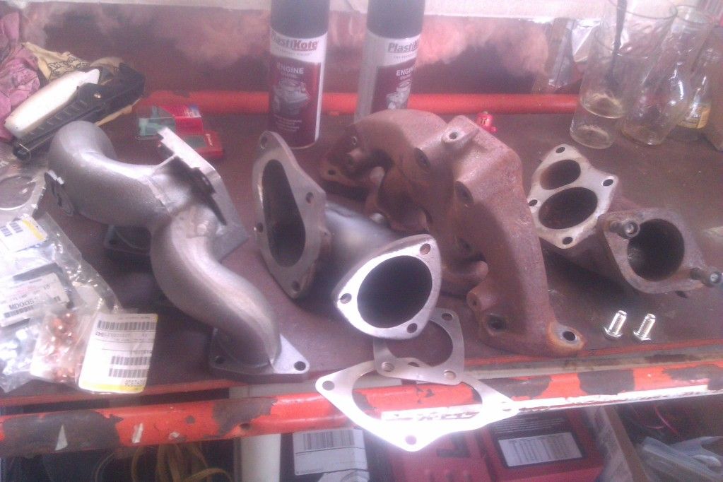

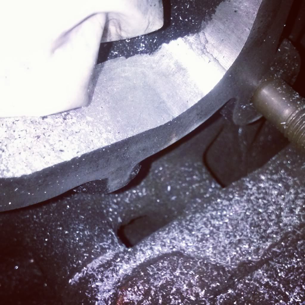

minor port matching

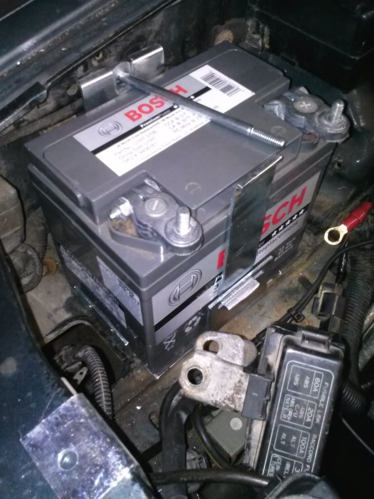

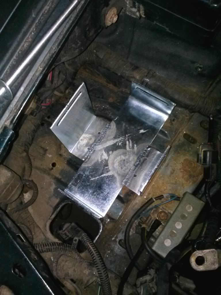

fabricated a box for the miata bosch
