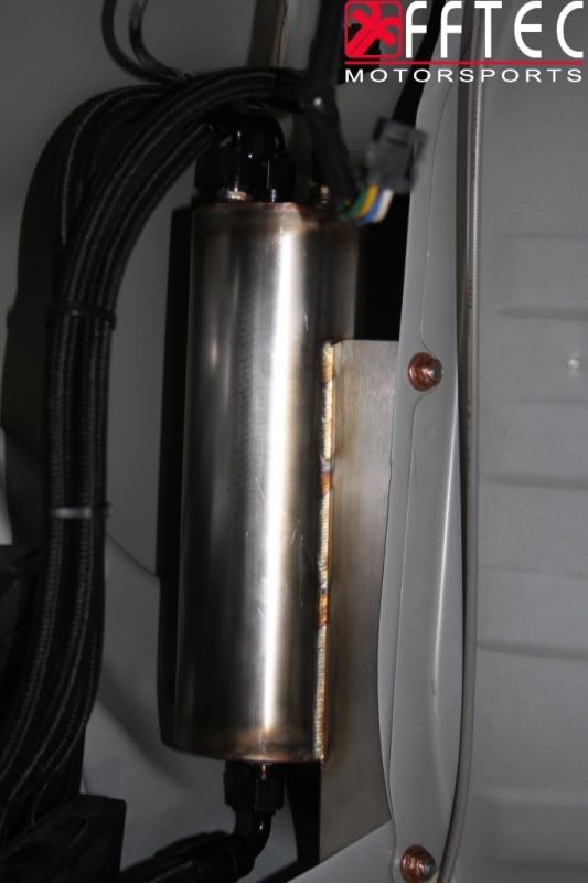

so i looked into surge tanks/swirl pots.
i wanted something like the above but while this help's with my starvation issue, it does nothing for the noise.
so i did a little more digging and found the below.
intergrated engineering submerged 044 billet surge tank
034 motorsport fully enclosed fp34 044 fuel surge tank
now a normal swirl pot/surge tank is fed by an intank fuel pump but this isn't an option in my case so i'll have to go with a hunch and mount the pot lower than my fuel tank which in theory should keep it filled up. that being said i'm leaning towards the 034 unit's fully enclosed and compact design.

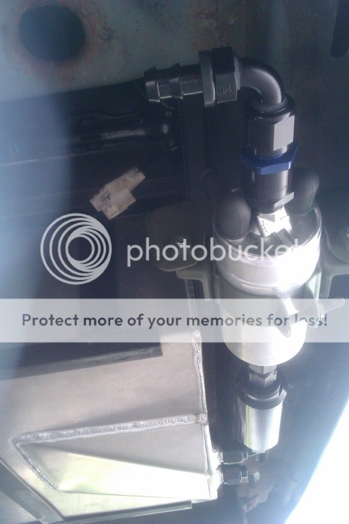

this is what im working with buddy
3,479
That looks nice for a track car or garage queen, but if you plan on driving the car I'm not sure that's a great setup. I'm sure you have your reasons, I just think judging by what you're saying about the noise, you won't ever be able to bring it down to a manageable level.
There's 2 issues with that setup that make it less than ideal for a street car IMO; the first being external fuel pumps by nature are loud. The fuel tank and the liquid within do a lot to muffle the noise. Without them, you would need to insulate the pump somehow to isolate the noise, and I just don't see how that would be possible with the pump in its current location.
The second issue is your entire setup is exposed to the elements, and is in a prime location to get sh*t on by any and everything you drive through. If you plan on ever driving this in the NY winters, those components and electrical connections will need to be extremely weather proofed in order to stay looking pretty and functioning. I think that's the last place I would locate the pump on a street car.
I'm not really sure what your goals for the car are, though. If you're building a weekend toy for the track or something, nothing I said really matters. I just assumed you intended this thing to be fairly streetable when you mentioned the pump noise being annoying. Track cars are pretty much expected to be void of any creature comforts.

thanks guys, its my cool car, it is my track car, my drag car, my street car, my garage queen, my jsballer. i picked it up, knew what i wanted and been building ever since.
your first issue with my setup is my third, external pumps are loud. thats just part of the point to the surge tank. it'll keep the pump submerged, muffle the noise and move the pumps location.
your second issue is further down the line in my issue queue, mostly because exposure to the element hasn't been much of an issue, i drove it daily all winter through brooklyn, queens, long island and manhattan without one breakdown. i have access to a lift and regularly cleaned and inspected my under carriage keeping my electrical connections and components pretty and functioning.
anyway i had planned on making an under panel for the rear but it wasn't gonna happen thanks to the fuel pump location. now that its getting relocated, i can plan on getting it made.
