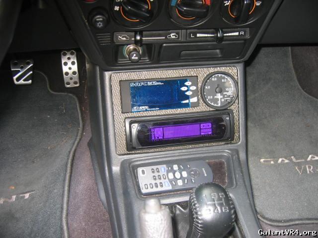

This is about the only thing changed over the past few months. Swapped blacked out EXPLOD radio out of my parted Civic. After, had to paint AFC as it looked funky silver.

Diggin' the blacked out AFC!
What method did you use? Did you just mask off the screen and buttons and rattle can it? I'm thinking I could that to my turbo timer, it's that same dingy silver...

^^^I was actually able to take it apart. Both screen and buttons came free from the case. I just sprayed and reassembled /ubbthreads/images/graemlins/hsugh.gif

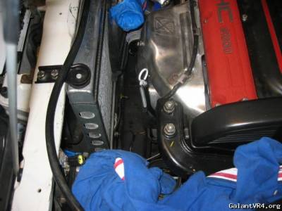

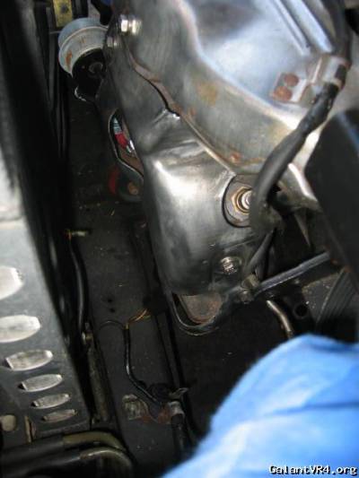

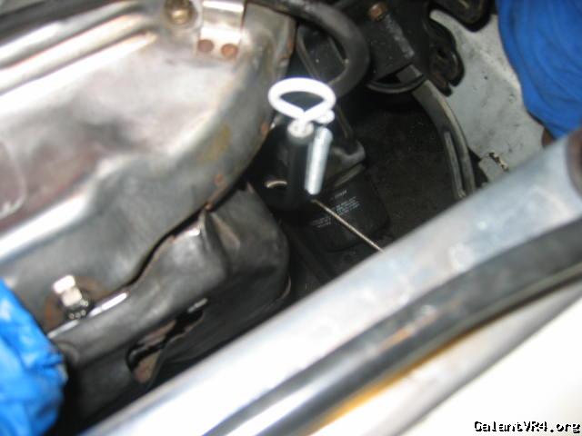

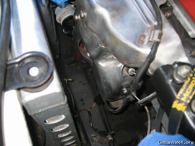

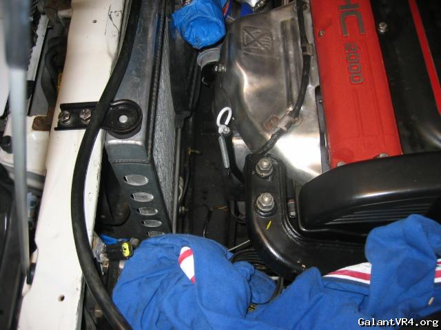

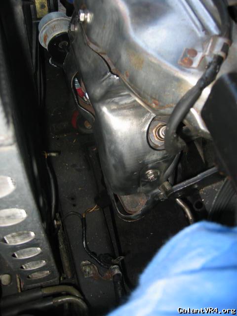

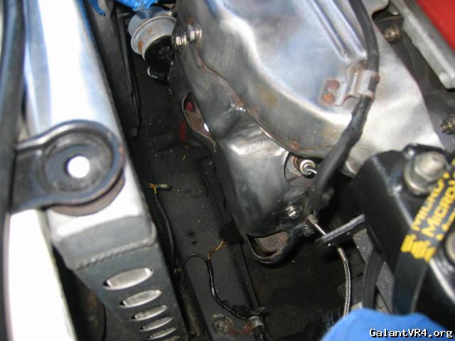

With the extra space, I was able to get on a 2G o2 shield over my EVOIII o2 housing. Ran to my local hardware store for SS hardware. Just had to drill out the EGT probe and trim/re-bow the opening for the W/G actuator arm. Hopefully this will lead to better alt. life for 381!!!

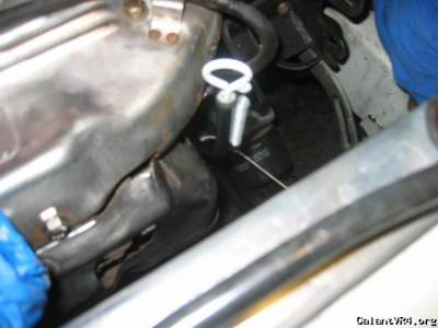

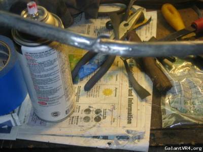

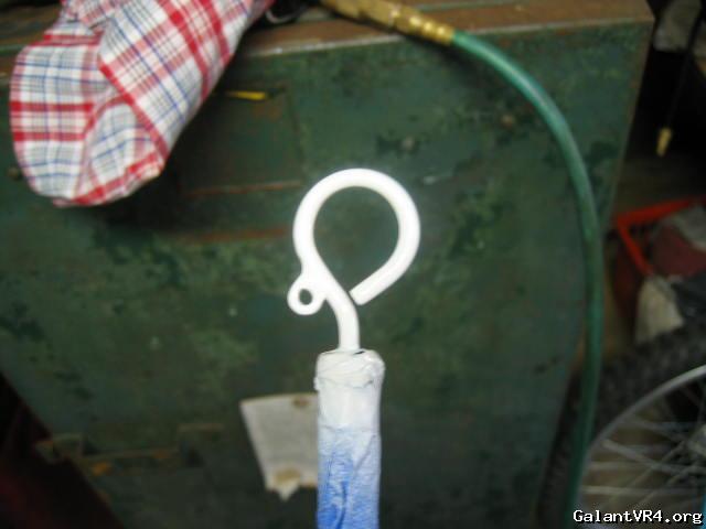

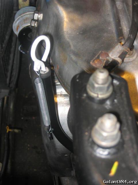

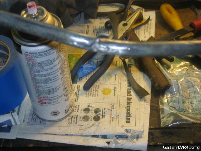

Even though I did buy a NIB OEM dipstick, it still would come up about a 1/16th" after a little beating. I was hesitant about messing with a new DS but like the result. I welded a small nut to the DS. Rounded the corners and drilled the threads out. Welded a hook to the DS tube to make it easy to secure. Played with springs at the hardware store until I found one with the tension I liked.......
Just need the alt. to put back together.

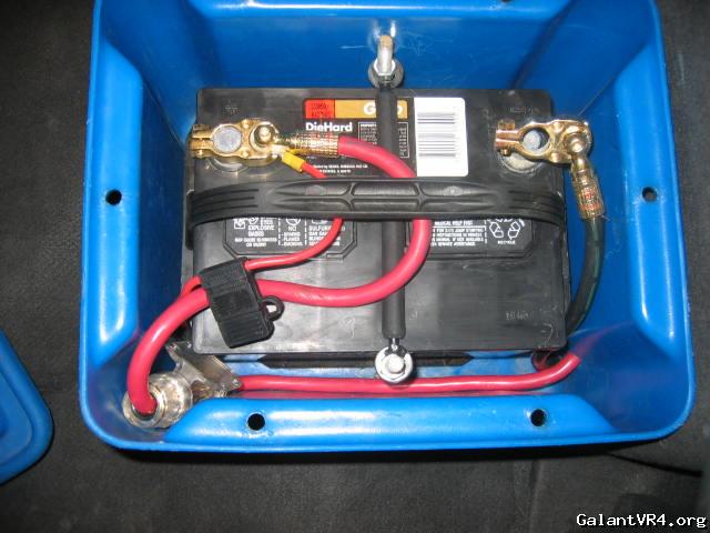

On Sunday I was fiddling in the garage and remembered the battery box situation. I didn't install it but it needed to be cleaned up. First off it had no tie down. Welded one up with a piece of vacuum line to act as a cushion. I spun the box as the POS/NEG were on the side that was visable. Now the wires are on the back side and not visable. Put the fuel pump rewire power thru the bottom and again, not visable. Was able to cut back almost 2FT of POS wire that was just tucked in and sloppy. Had put the ends on when I first picked up the car.
The improved version.....

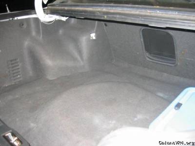

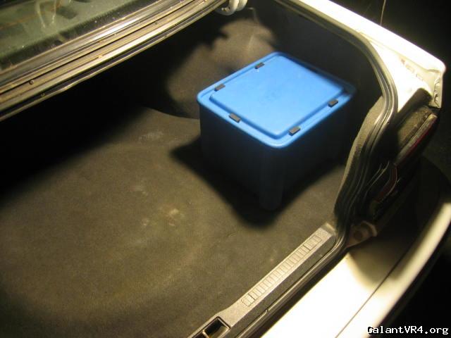

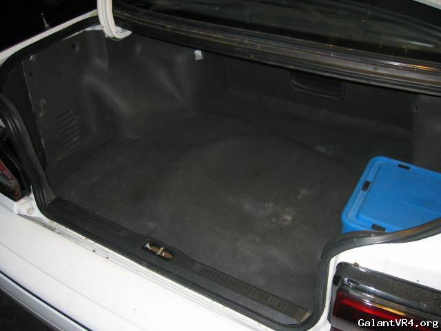

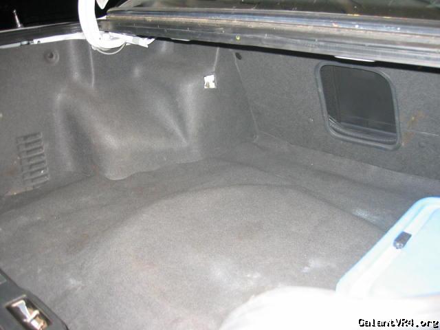

Also on Sunday I started to piece back together all the trunk linings. They were there but not secured. Thru the trunk carpet in the washer and gave it a quick cleaning. Going to try to locate BNIB from a dealer cuz it has several stains. Velcro'd down the trunk floor because it used to slide around under agressive driving......

^^^I made it. Welded a small nut on, rounded it on my bench grinder & drilled out the center. Only pic I took was after I painted it and before removing masking tape.

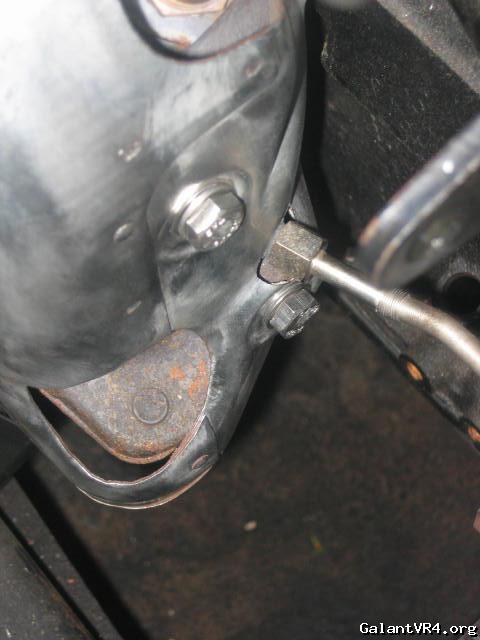

Fixed the fuel line issue. Redid return to FPR and FPR to hardline. Didn't have the 12x1.25 fitting for the fuel filter so I am going to have to order it.
Also found ALT FUSE blown causing electrical issue.

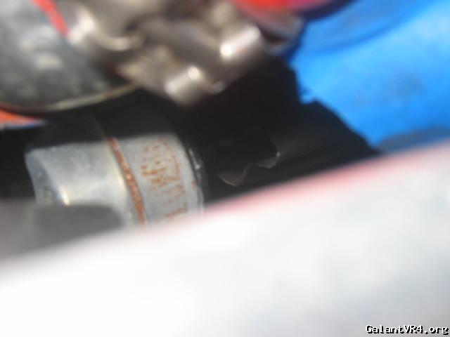

IT OFFICIAL(knock on wood!), #381 is all debugged. I picked up some Redline MT-90 and after draining the tranny I realized the PS axle seal was weeping. Had an extra that Jon(TRE) sent me when I ordered all my trans upgrades so it got replaced. Had Mobil1 for break-in and now she shifts like butter.... Ofcoarse with victory comes loss.... We have had some cold mornings and the other day the antenna coil broke so now my mast continuously winds when I turn the radio on. Also had a slight leak in rear from AWS and found it to be coming from the return. Slid the hose down further, added another clamp and golden /ubbthreads/images/graemlins/grin.gif

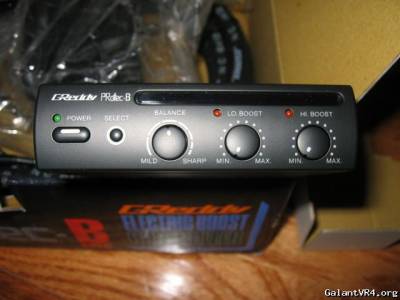

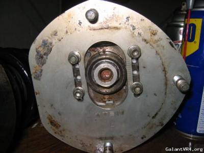

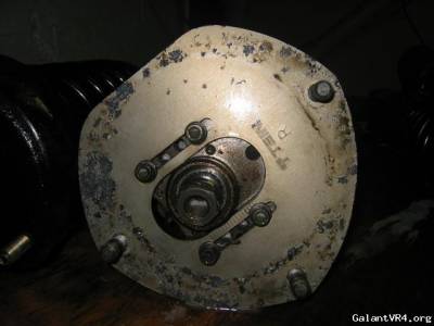

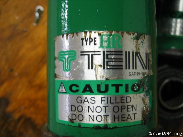

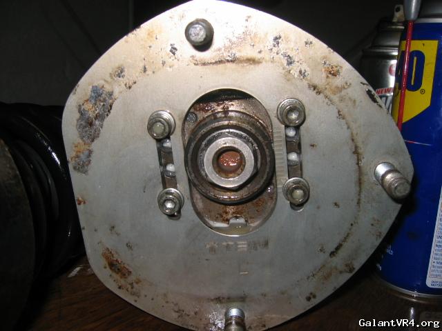

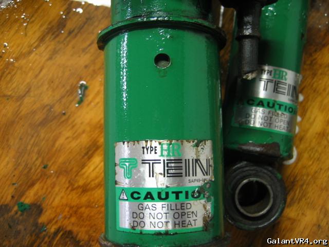

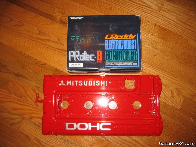

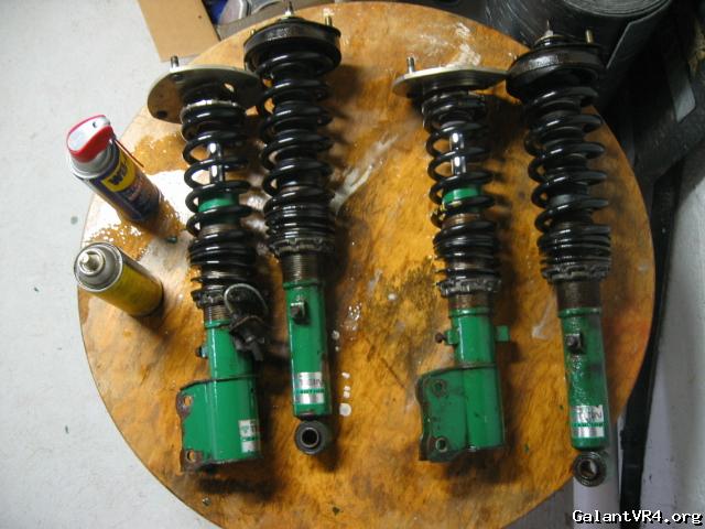

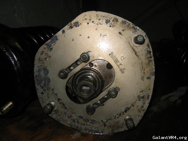

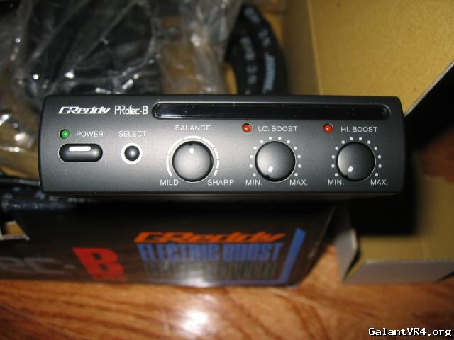

I have been slowing selling parts and buying more parts for the 4. I picked up a brand new Whiteline rear 26mm sway bar, Mistu valve cover, NIB Greddy profec B spec, placed order for 3" ALUMINUM exhaust(Tyler?), DSM strut bars and a used set of E39a Tein HR's with camber plates. The Teins are going to get my "ocd attack". Sandblast body and springs, color matched respray and polished rings(NEED A SET OF SPANNERS). I am still on the hunt for a 24mm Whiteline Front sway bar and located one but was quoted $291 plus s/h?!?!?! Seems really high(?)......
I will post some pics of the progress of the Teins once they are all done. Later -Russ
Blasted them with Liquid Wrench and WD-40 to get them ready for dismantling tomorrow....
Stay Tuned.......
