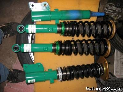

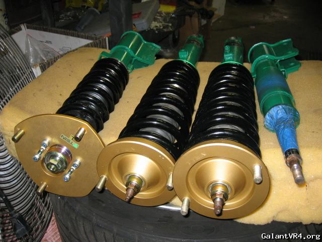

f***er, i wanted those Teins! hope they work well. Your car is coming along nicely.
11,993
They don't look nearly as bad with the WD40 blast. Too bad the rears don't have pillow upper mounts as well.

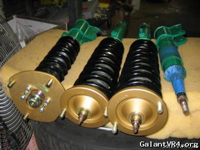

Couple things I want to get apart and check. I also found a local set of spanners and am going to pick those up as soon as I get a call. Then running to Sherwin Williams Auto to have the Tein green mixed. Also need to blast these parts........
11,993
I think the rebuild prices are listed on the TeinUSA website.

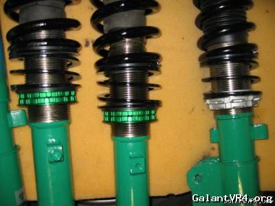

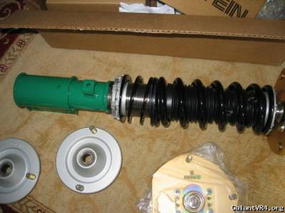

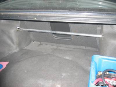

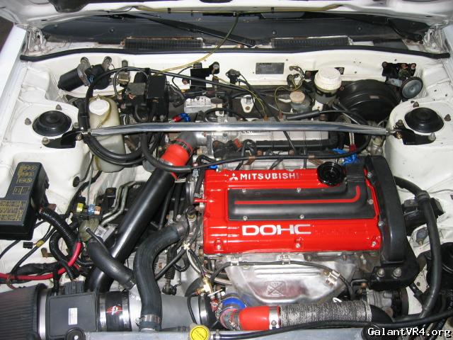

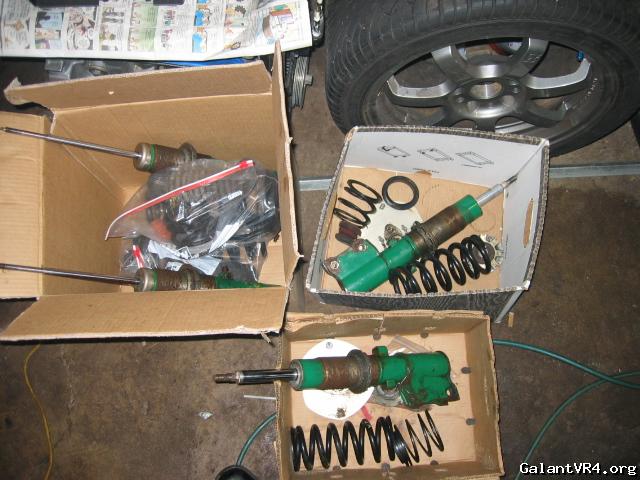

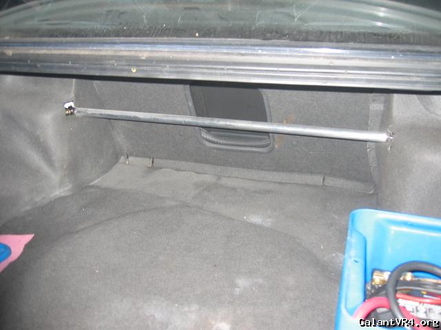

Today I swapped the valve cover and finished up the strut bar installs. I also took apart the Teins to be ready for blasting and picked up a FP intake pipe.
There are two things of concern for me. #1 being that one of the pillow mount nuts was gawled up. It took a bit of force to get it off. I'm going to clean up the treads on the strut and redo the threads inside the nut. Worst case, a call to Tein for a new nut, ABSOLUTE worst case a new piston rod which is $35 on top of the $85 for the rebuild. #2 one of the rear dampers was slow to recover. /ubbthreads/images/graemlins/banghead.gif Again $85 for a rebuild..... Not all that bad for a set over a decade old. You cant get them anymore so atleast I have rebuildable units. I may clean up, redo and save for a set of Hotbits for next year. I fairly pleased either way. Now just to see how they ride.....

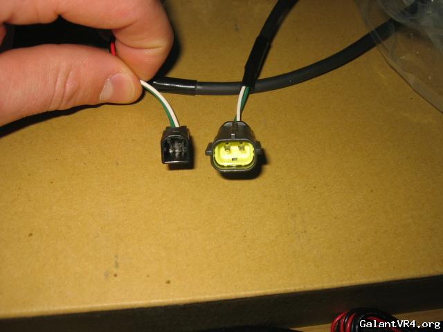

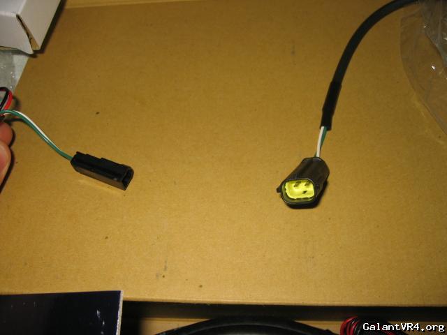

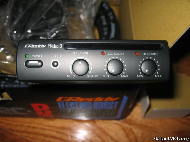

I am still waiting on the rear sway bar and have not heard any update on the Aluminum exhaust. The other thing I need is the harness for the EBC. This week I will take the trip to the computer store with the Profec in hand and decide if cutting this brand new units clips is an option!!!!
Harness or clips anyone??

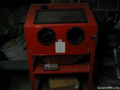

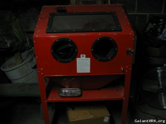

Well my OCD is going to hit a new HIGH!!! The short of it is I had planned on building a blast cabinet and while I was buying the gun, I swindled this brand new unit for $110!!!! It had a broken viewing glass and some dents, all of which I fixed on my way to a 3hr assembly! It came with a fully stuffed sandwich bag of nuts/bolts!

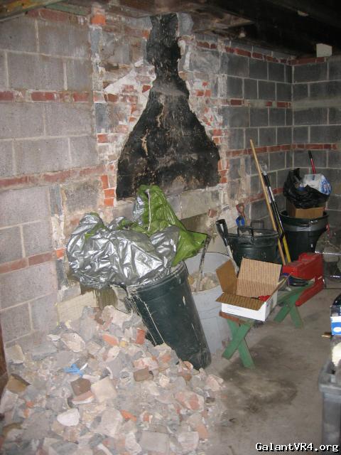

With the large cabinet I had to do something for space! I have been wanting to do this for years and finally got around to it. My garage had an old, out dated fireplace that the chimney had to be removed years ago to meet fire code. My hands and back are F*d but it was worth it! What a disaster at times..... Now just to pour the cement to fill the void. At the end of each day I was black from head to toe, even under my clothes!!!
Before... The big yellow box in front of the VR4 (OLD PICTURE FROM LAST YEAR)
After... Mucho space! It was alot more work than it seems in the pics!!!

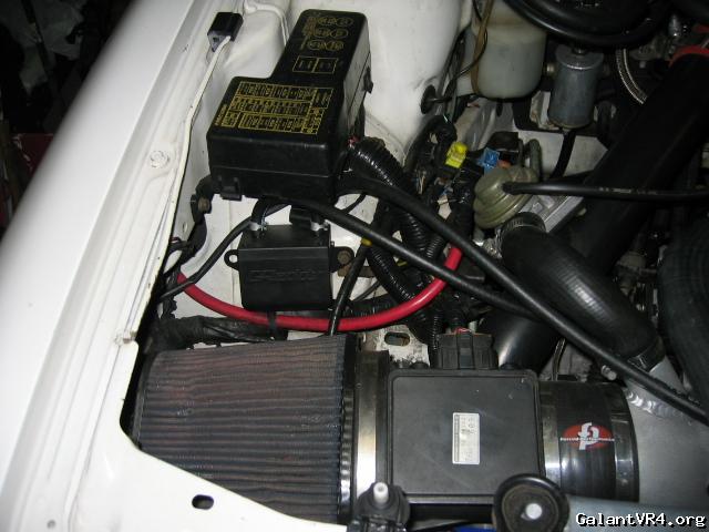

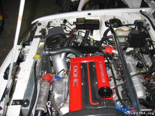

After I emptied the truck this morning with the final load of large debris, I pushed everything forward until I feel like breaking my back again. I them pulled the Galant in for some installs. I got the FP intake pipe on and -6 filter to rail installed(thanks to STEVEB for everything!!!). I need to redo my I/C pipe as it conflicts slightly with the intake pipe.
As you may be able to tell, the FP intake was the first of many things to be glass beaded... /ubbthreads/images/graemlins/cool.gif

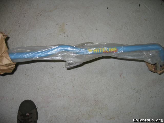

I also got my rear sway bar.....

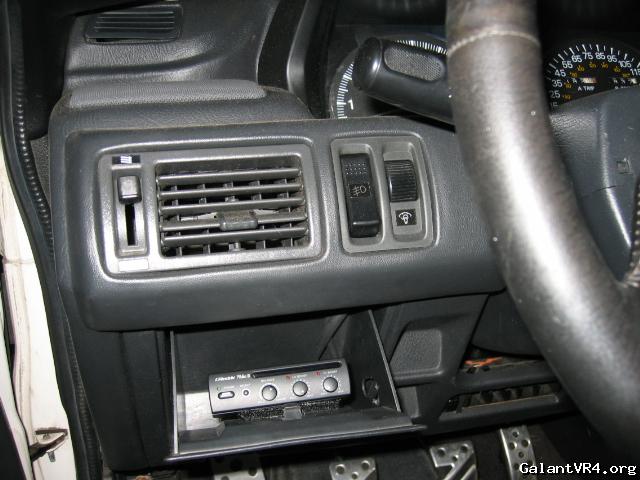

I also got around to installing the Profec B EBC in the 89 pocket.....

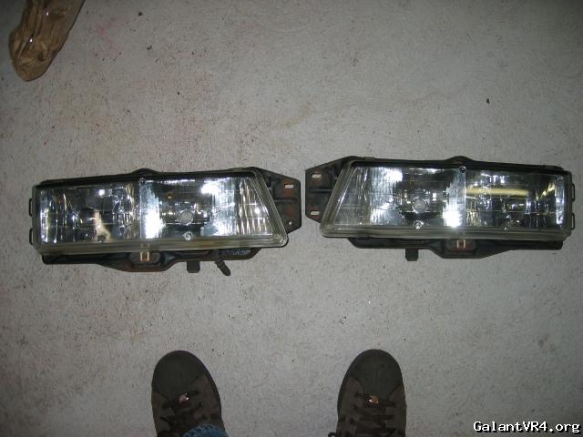

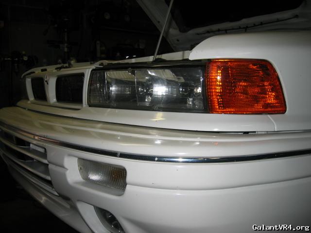

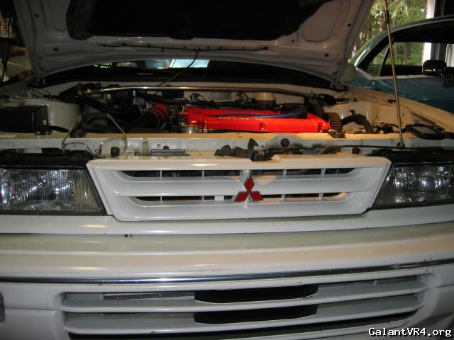

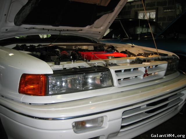

Installed the 93 headlights as the buyer backed out and I got them at the right price. Thanks to Raush for the Corners. Wired in a dual filiment bulb for parking and signal lights.....

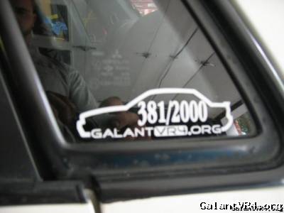

MMC VR4 badges done.....

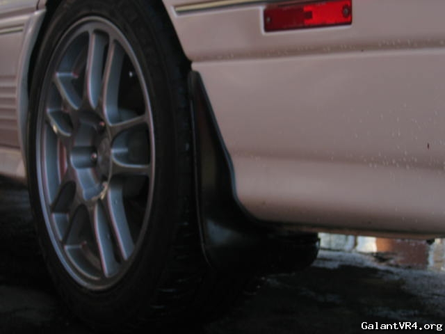

Way to represent! 17x8.0J +38mm offset is a perfect fit. Nice job overall!

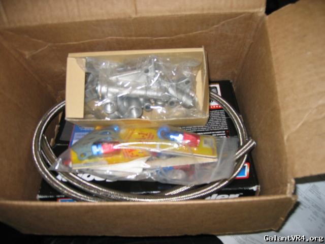

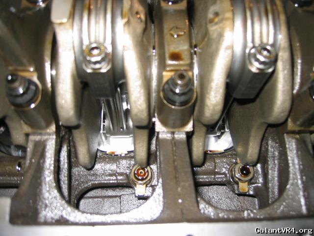

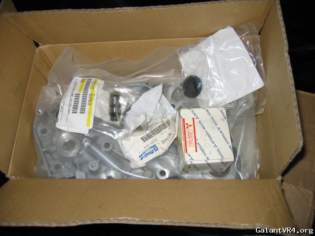

Todays project is an oil pump swap. It was starting to make a very slight rubbing noise. While I have it apart I will also be installing a 90 OFH and oil cooler. I Rite-Stuff'd the pan on so getting it off was fun!
Rare look inside the belly of the beast!
New OEM pump and BSE incase the stubby had something to do with the noise....

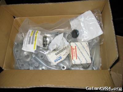

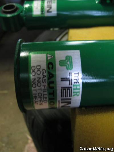

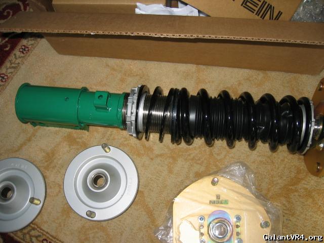

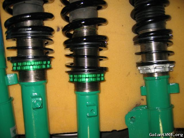

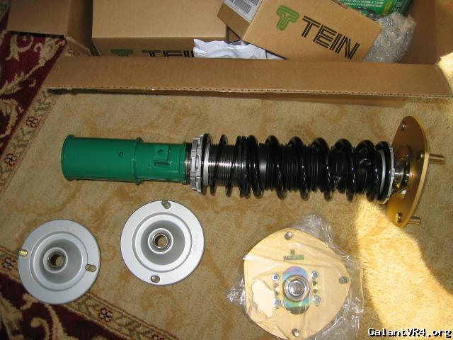

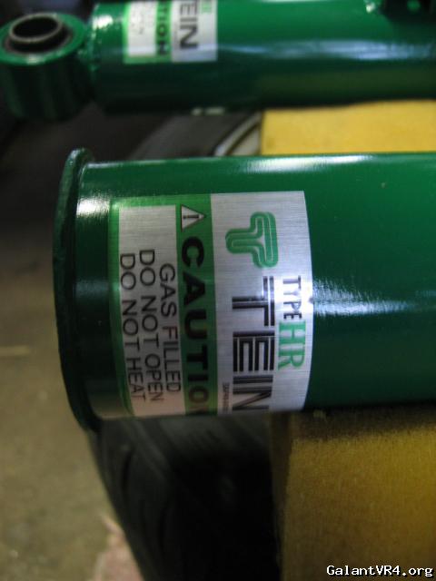

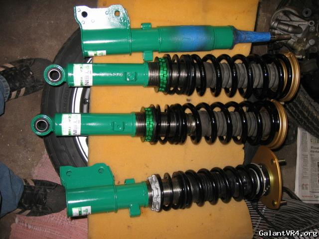

The TEINS are FINALLY almost done! By that I mean that all parts have been painted but more importantly I FINALLY got the parts from TEIN!!!! New parts include camber plates, rear pillow mounts, new dust boots, bump stops, spring seats/lock(frozen) rubber spring perch and hardware. The part numbers have changed but they will continue to build compatible models.
Being installed with these but not pictured are Whiteline 22mm and 26mm sway bars and Ingals adj. rear upper control arms..........
You can see rust pitting under the paint. I wasn't about to fill and sand!!! I just wanted to freshen up a rebuildable coilover....
New decals as old ones were destoyed! Thanks Joe /ubbthreads/images/graemlins/wink.gif

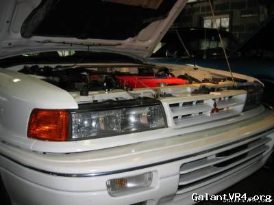

BACK from the dead! With moving to RI Ive left behind my shop and most every car friend I have.

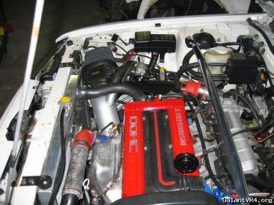

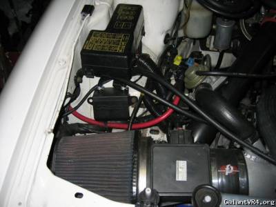

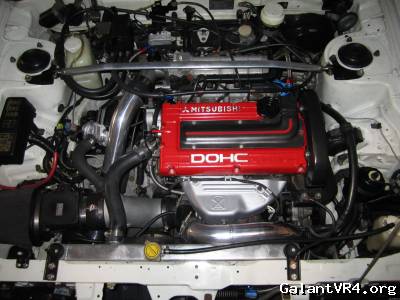

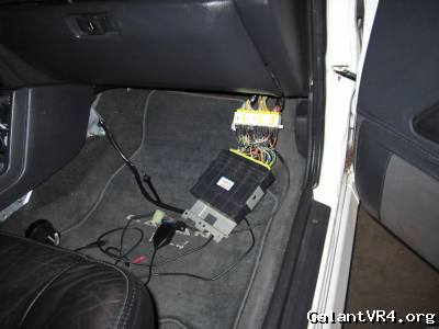

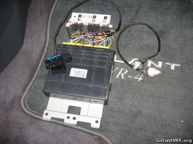

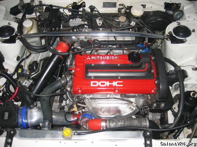

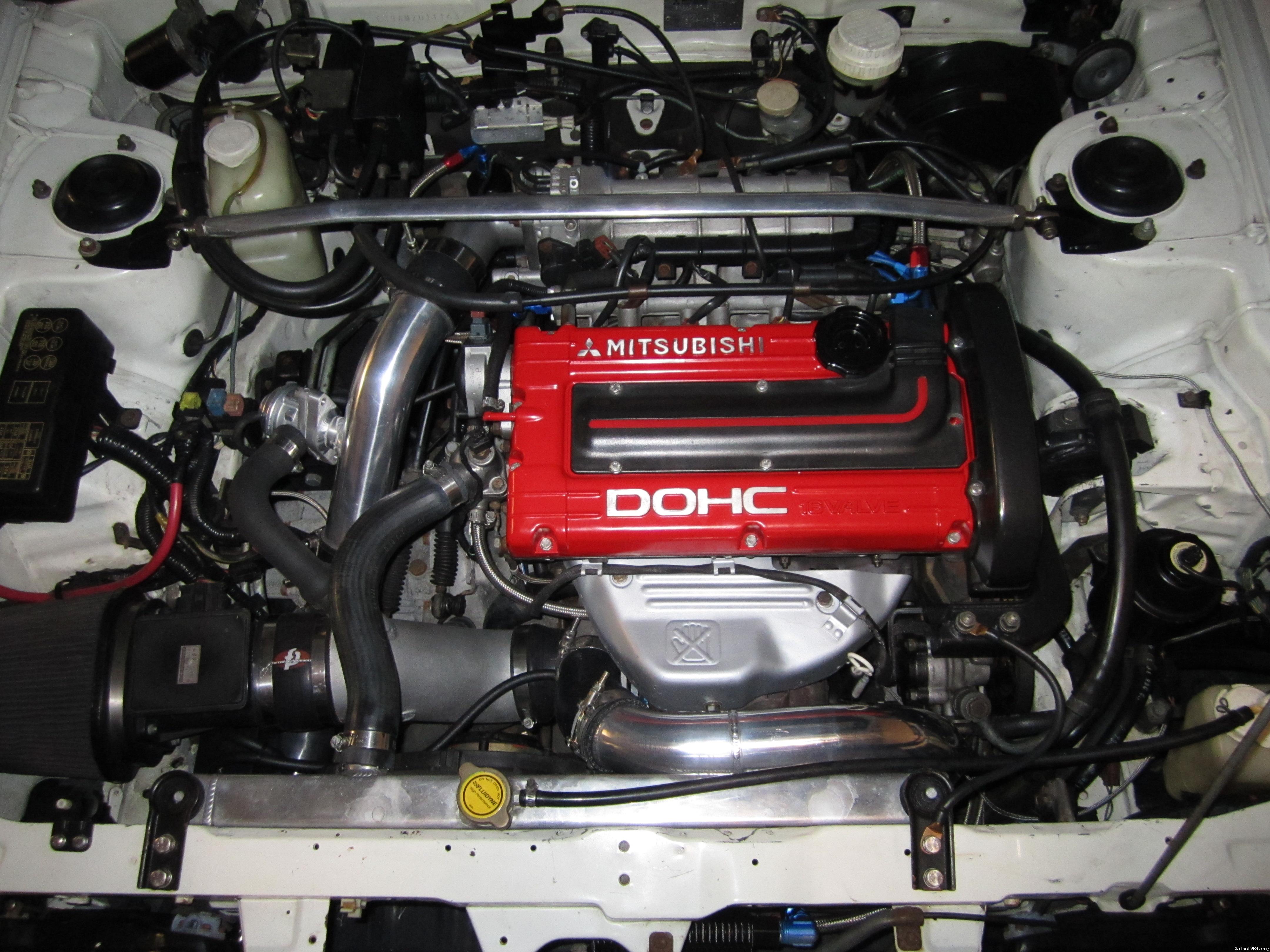

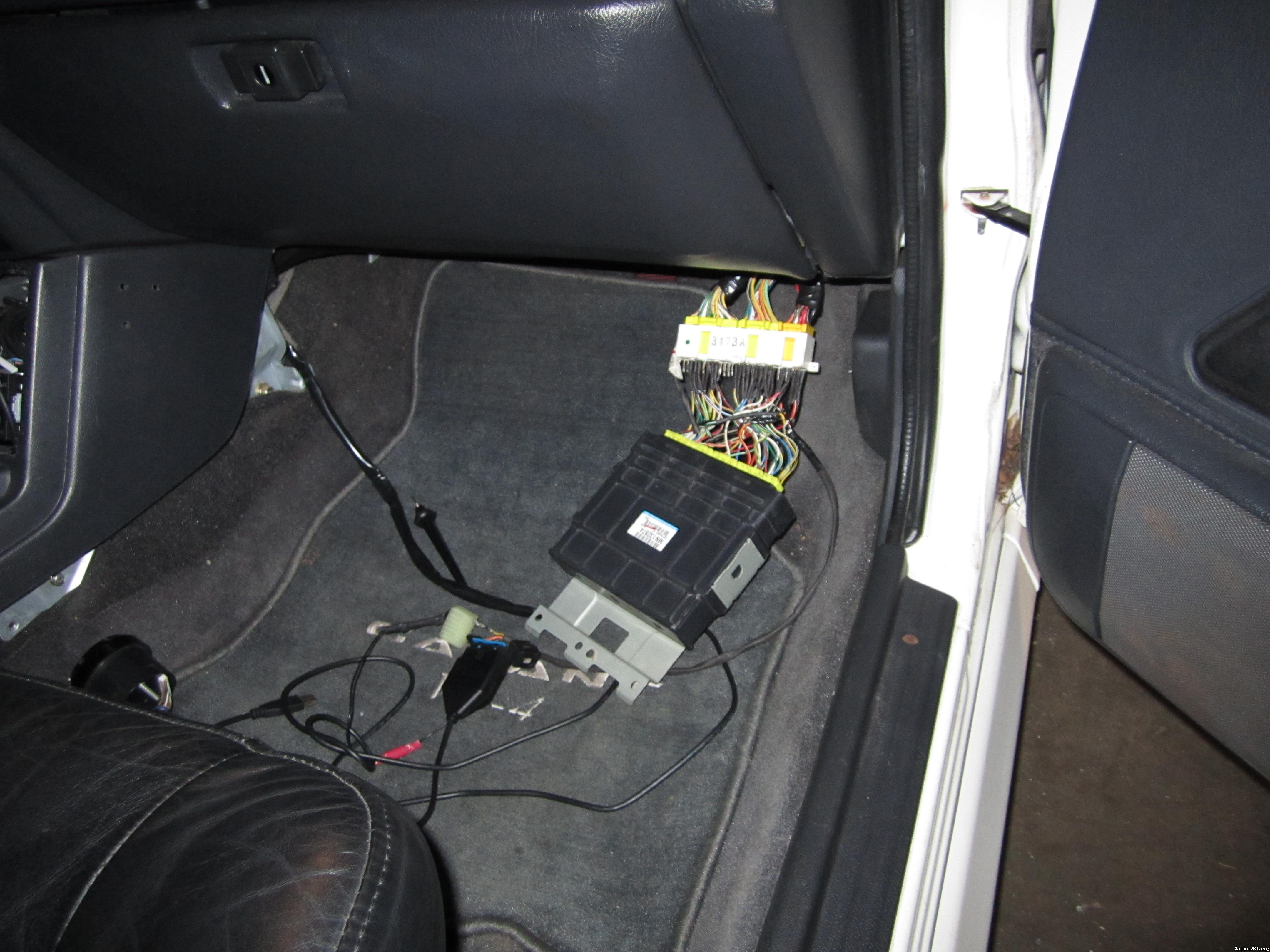

That being said 381 has been pulled from her cave and is at my friends shop going to the next level! EVO ecu is in along with the EVO 8 MAF and she was fired up under MY2005 technology yesterday.
Along with the ECU swap, I'm having Dr.Mario fab up some 2.5" aluminum intercooler piping, install the BLK top CAS and install a NIB 1g BOV. I'll be in CT this weekend for pics. Street tuning next week and once she is back in RI, I'll bring her to work to FINALLY perform the suspension swap and realign her.......
STAY TUNED!

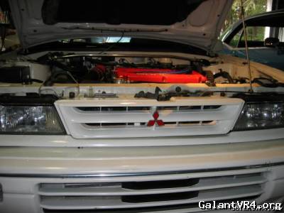

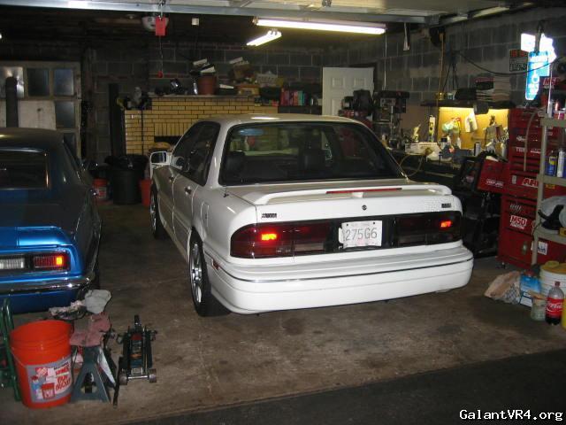

So 381 is finally being finished. Here is a pic of how she looks now from July.....
I dropped her off at Dr.Mario's secret bat cave at the beginning of Sept for some massaging from the Dr. The Evo8 ecu is in and running. The black top CAS is in and timing dialed. We ended up keeping the 2g maf, basically to keep the FP intake without needing a reducer for the Evo maf. She's idling better than ever. The I/C pipes were just finished so street tuning starts next week. I used CXRacing 2.5" aluminum piping and had Mario work his magic. You can also see I bought a NIB 1g BOV and JMF aluminum flange....

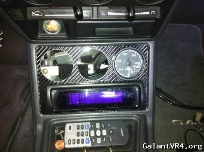

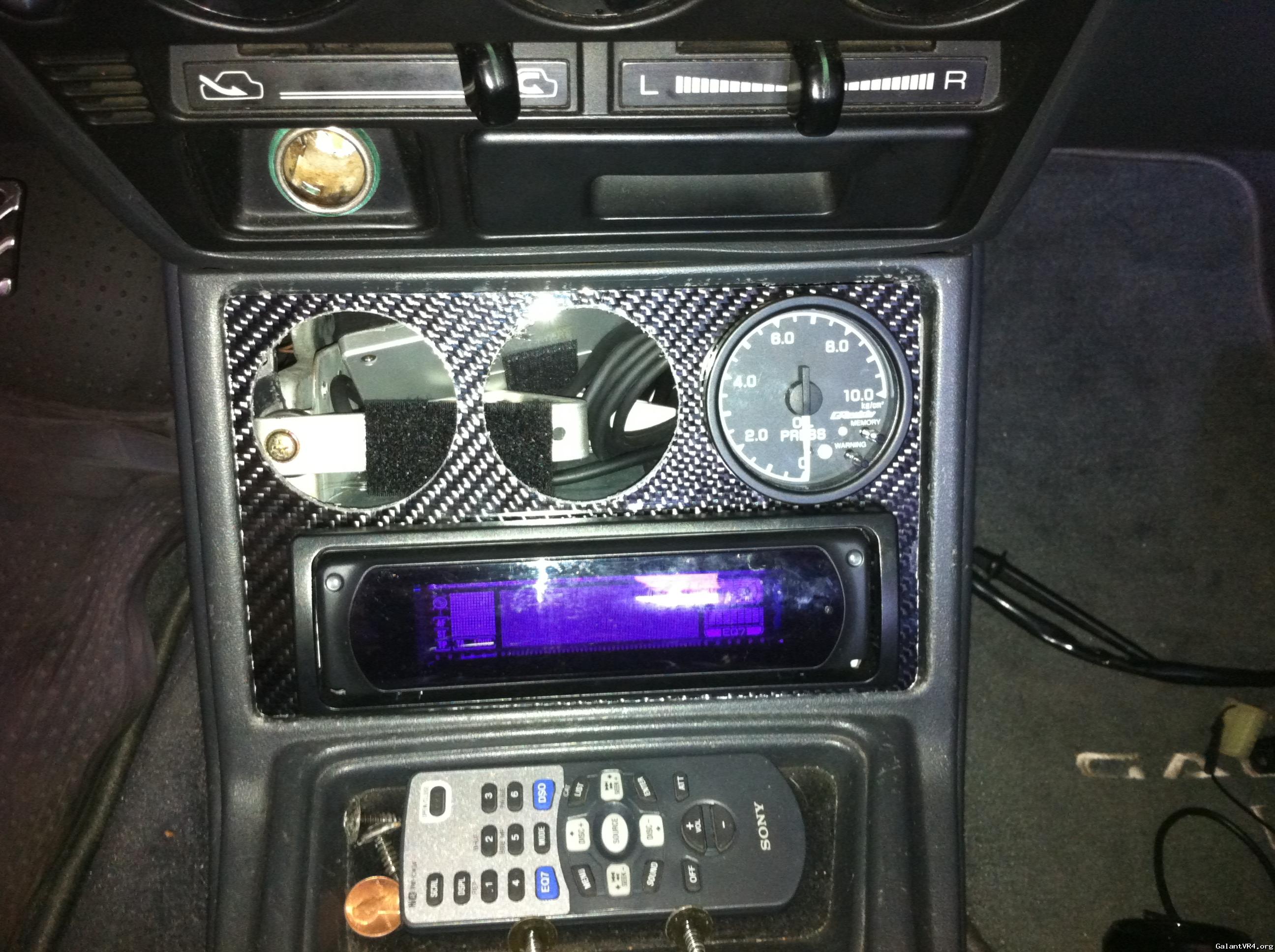

I now can finally get rid of the AFC and move all the gauges to the console instead of having a pillar......
So basically all thats left is removing the AFC, move the gauges and then street tune. Drive her back to RI, install the TEINS and sway bars. Then probably park her for the winter and complete the bodywork in the spring. Then I will be satisfied and consider the car completed!
