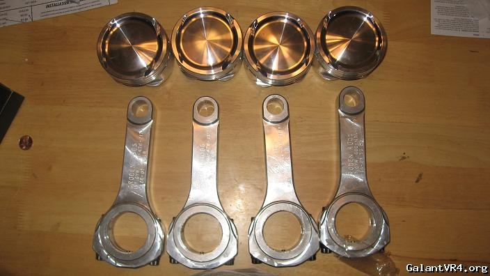

Well got the crank in and torqued up. A few weeks ago. When I went to do the pistons and rods one of the Groden rods had the threads pull right out of it /ubbthreads/images/graemlins/banghead.gif. I was pissed /ubbthreads/images/graemlins/mad.gif. Called groden and was told to kick rocks or my a new set for $575 /ubbthreads/images/graemlins/smirk.gif. No thanks you can keep you crap. So I thought I was going to have to wait a few months tell I had money to buy a new set of R&R or GRP rods. Well a day after the groden crap, Jesse (revolutionmotorsport)texted me and gave me a deal on a set of GRP rods I could not pass up /ubbthreads/images/graemlins/worthy.gif. If it was not for him the car would not be back up and running tell late springs. So a big thanks to Jesse. With his help I will get my 10s pass on the 3052 next year. So now I just need to drop the head off to have it decked. All the rest of my gaskets should be here this coming week. So hoping next weekend I can drop the motor in the car.
Jesse@revolutionmotorsports is the sh*t man. He allways comes through and has killer deals. Any pics of the grp rods? Here come those ten's /ubbthreads/images/graemlins/laugh.gif

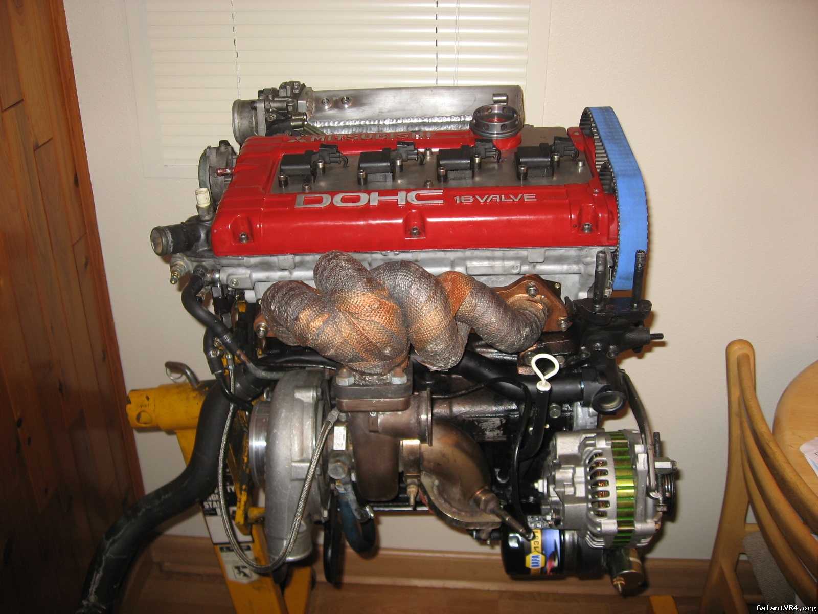

Well the motor is all back together, other than the intake manifold. My new one will be here tomorrow. So after work I will put the manifold on finish putting on the coolant lines. Then add oil and prime the pump. Once that is done I will throw the timing belt on and she should be ready to drop in.
Brianawd
Apr 18, 2005
2,117
Portland OR,
Well motor #2 is now ready to go in. Just waiting on the timing belt covers. Going to drop it in on Friday night and get every thing hooked up. Then on Saturday I will toss the trans in and all the little stuff. Then it will be time to fire it up and go do some brake in miles before putting it away for the winter /ubbthreads/images/graemlins/bawling.gif

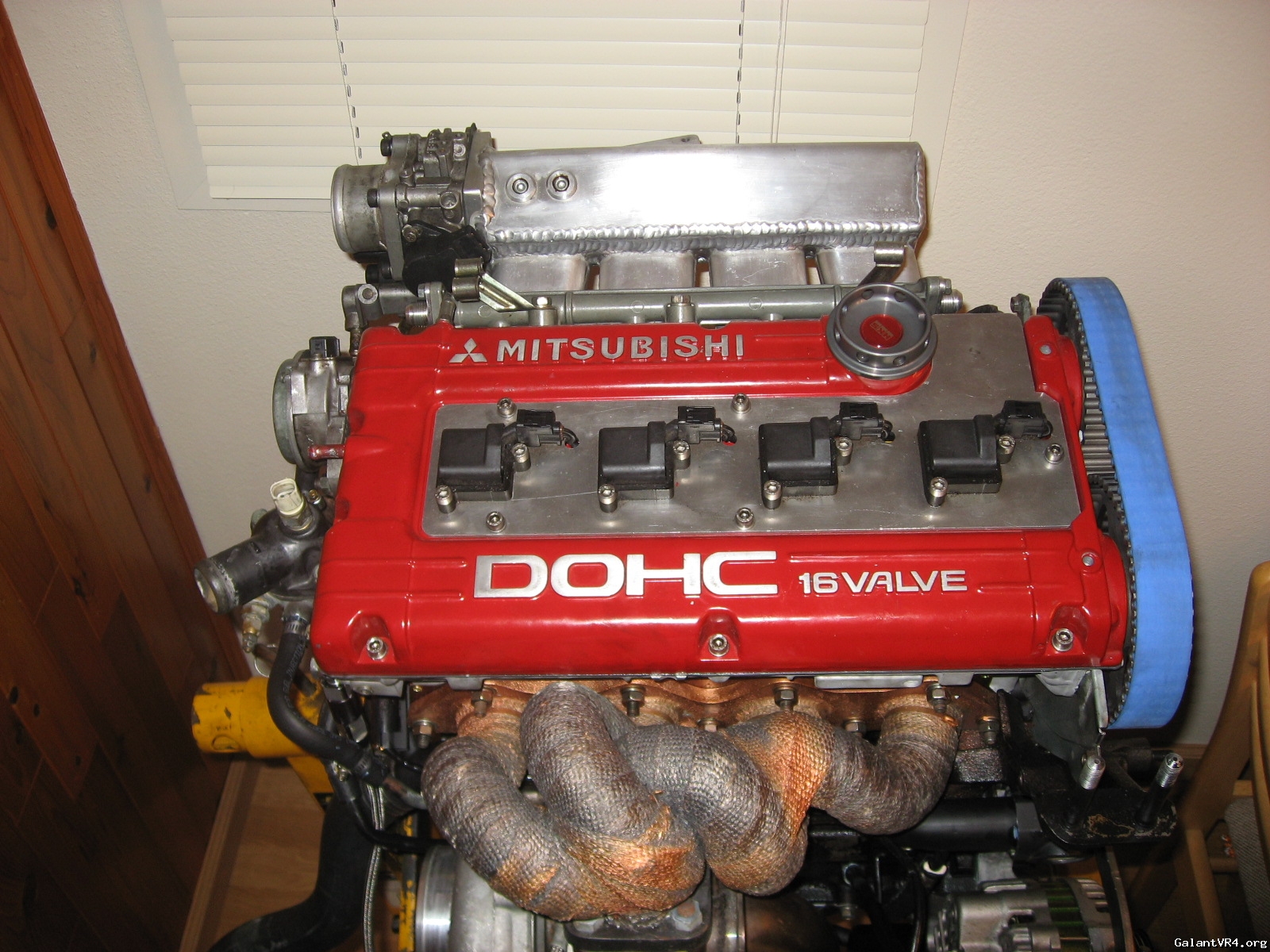

I don't remember what that intake looks like from the side. Are the runners curved or do they just angle upwards to keep the plenum up high like that?
Brianawd
Apr 18, 2005
2,117
Portland OR,
