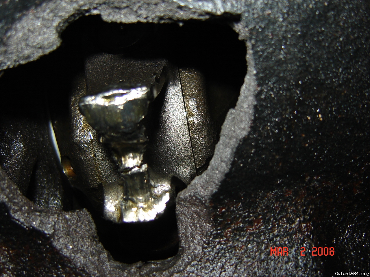

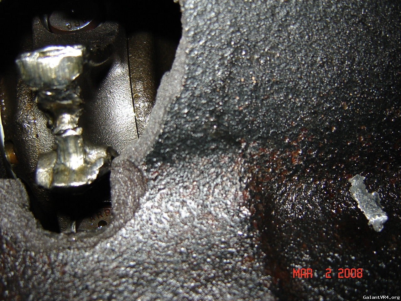

Well I started working on the galant today. Its been sitting in the garage for 7 months now. I will post more pics as I get stuff done.

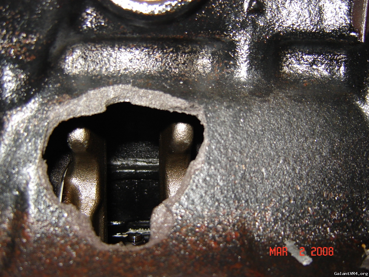

This is the reason for the new build /ubbthreads/images/graemlins/grin.gif

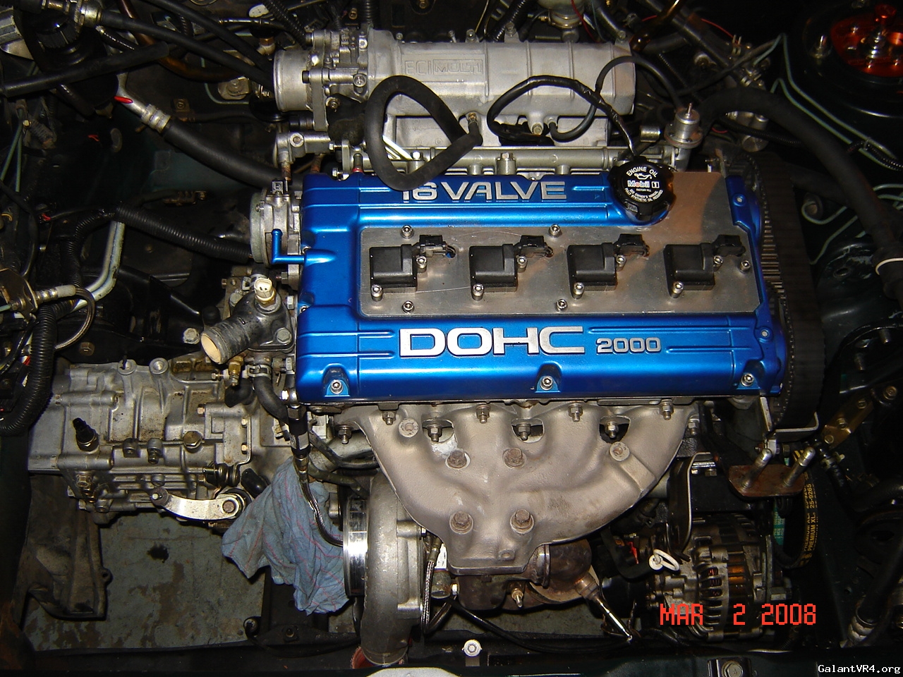

Motor almost ready to pull. I will drop the trans tomorrow and pull the motor.
Once I get the motor pull apart I will post up more pics of the rod /ubbthreads/images/graemlins/hsugh.gif
was that hole by chance behind the AC?
had a block that did that and just wonder the location

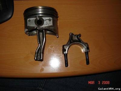

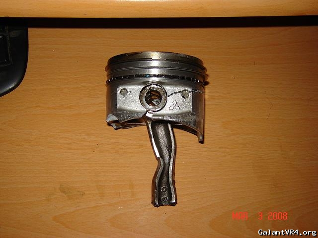

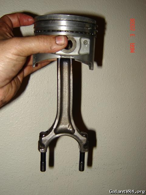

Well got the motor out and pulled apart.

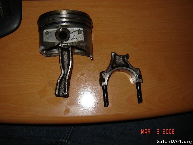

This is cylinder #3

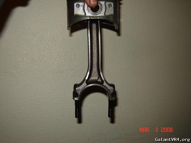

And look what else I found cylinder #2 looks to be a little out of shape /ubbthreads/images/graemlins/grin.gif

Holy hell! How did you manage that!?
I believe I reached the HP limit of my 1g rods. Been beating on those rods for around 5-7 years now. So they have had a hard life.

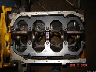

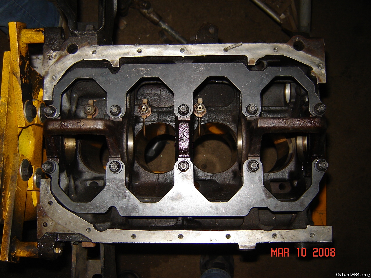

So block goes in on Wednesday. I got the kiggly girdle on and ready for the line bore.
How about a side view of the girdle. I just looked them up I had no idea you could buy one that cheap. I spent a day making the 7 bolt girdle fit looks like yet again the board is helping me spend money. /ubbthreads/images/graemlins/grin.gif

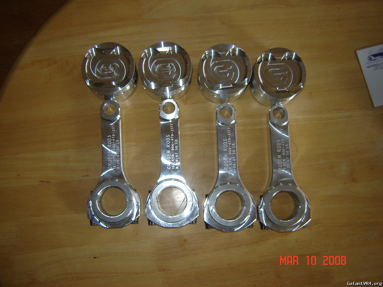

What pistons are those?
Ross/magnus 9.0:1
