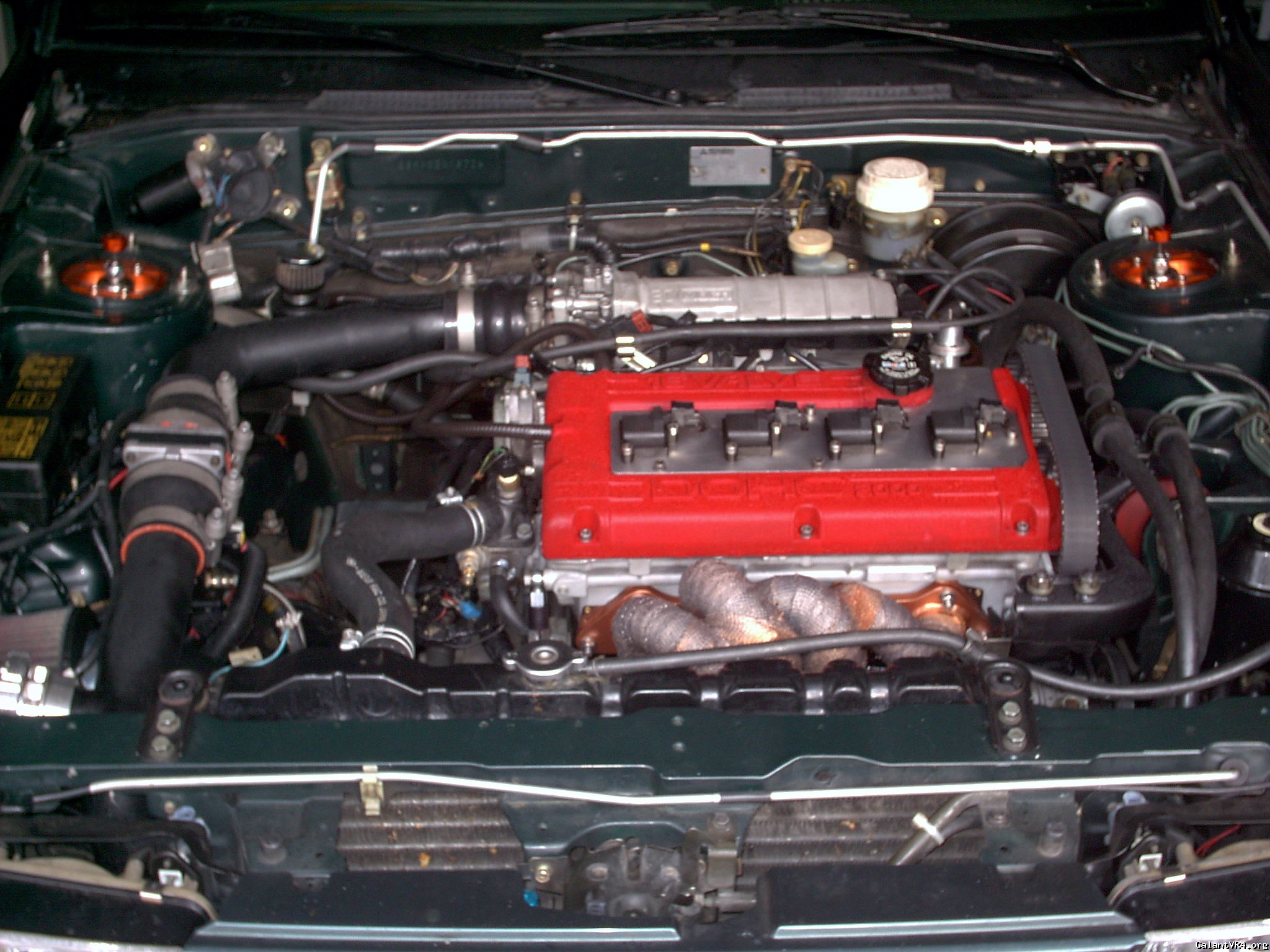

Here is the only pic I have. Its from some gay cam that my girlfriend has.
Car feels really good. With only 15psi boost and 3/4 throttle, all for tires brake loose in 1st and 2nd. I can't wait for 30psi /ubbthreads/images/graemlins/grin.gif
