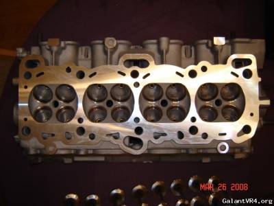

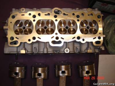

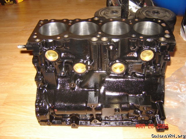

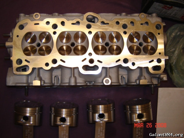

Well got to pick it all up today /ubbthreads/images/graemlins/grin.gif Just need to hand lap the valves and put the head together. So if all goes the way it should the car should be running in the next few weeks.
/ubbthreads/images/graemlins/jawdrop.gif Beautiful engine parts Brian! Thanks for posting the machine shop info.

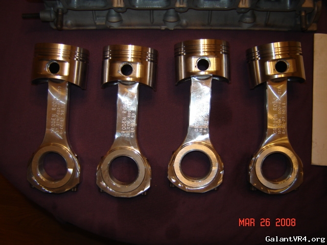

Damn it, Im getting ready to get a forged boot end but your set looks out of this world. I was going to get weisco/eagle combo but ddddddaaaaaaammmmmmmmmnnnnnn.
Luke
Jul 16, 2002
752
San Jose, CA
Wow, aluminium rods ? Not daily, I presume ? Nice build up, btw. Good luck and keep us posted!

I was going to o-ring the block but changed my mind on that. I will just be running a Felpro MLS with standard ARP's. I was going to run L19 but could not get any in time. I should be fine. both the block and head have new surfaces.

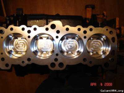

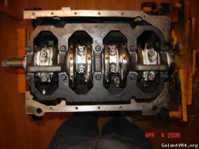

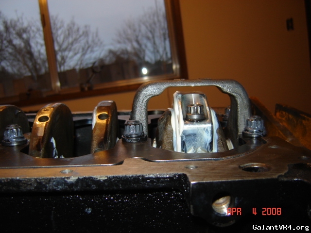

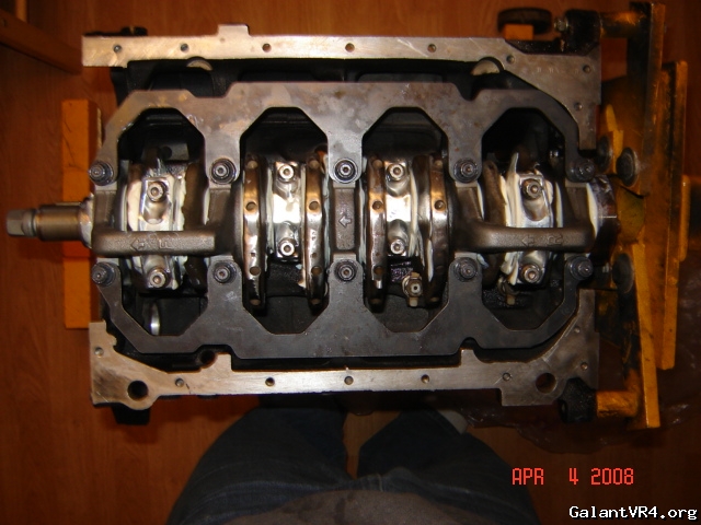

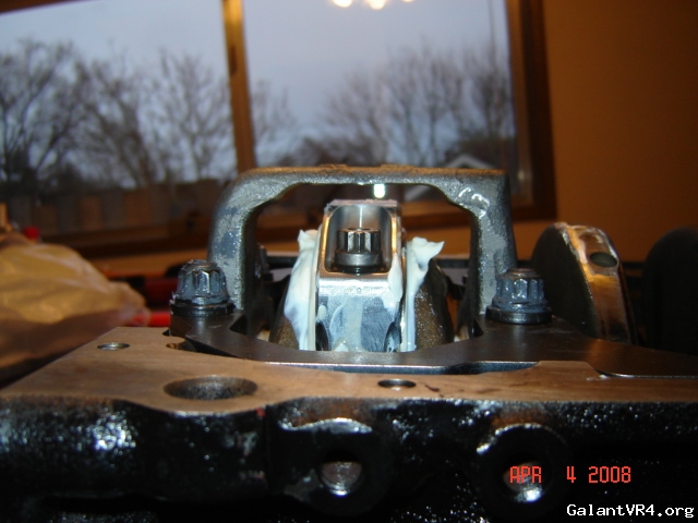

Well got the crank in and all the new rings filed. I set the top gaps to .018 and the bottom gaps to .023. So to night I will drop the rods and pistons in and make sure they all plastagauge out. If all goes well I will post up some pics of the bottom end all put together. Hoping to have the motor in the next weekend and running.

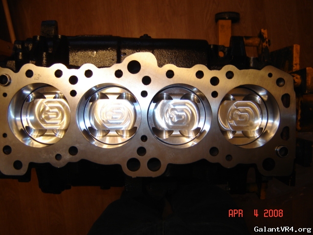

So bottom end is all done. Ever thing came out perfect.
Now all I have to do is get the head put together. Then slap it down and put all the little stuff back on this week and it should be ready by next weekend /ubbthreads/images/graemlins/grin.gif
