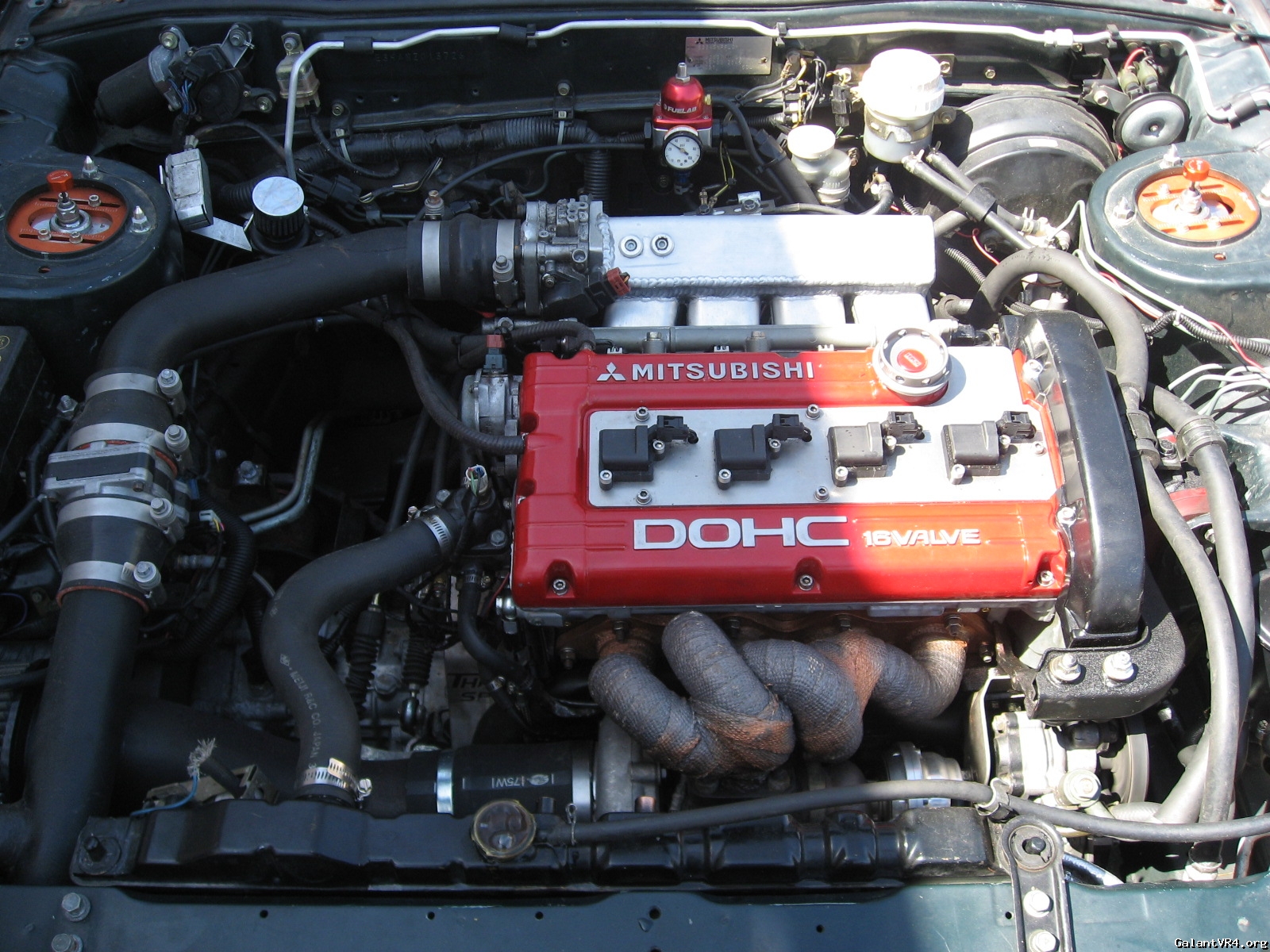

Well here is a pic. Looks the same as last year. Only change is the intake manifold.
Now comes the fun part of cleaning every thing. This winter was hard on the car. So power wash the outside and engine bay. Slap on new fenders and its good to go.

Cap was off because I just filled the cooling system. As for the bracket. I have know idea where its at. I have looked every where.
