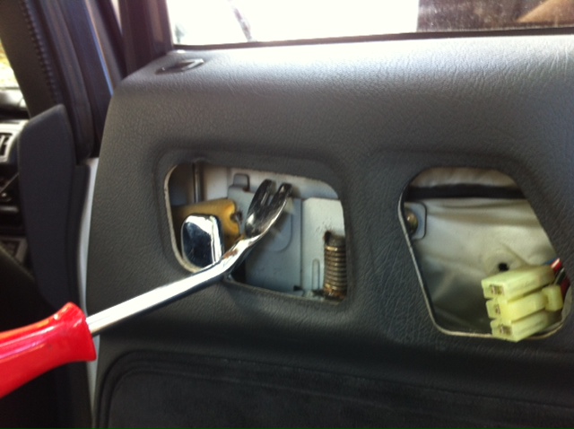

Ok, I got it. I used this thing to pry up on the inside of the top door card and it popped out.
After spraying all the handle mechanisms on the inside with white lithium grease the rears now open easier than the fronts.
