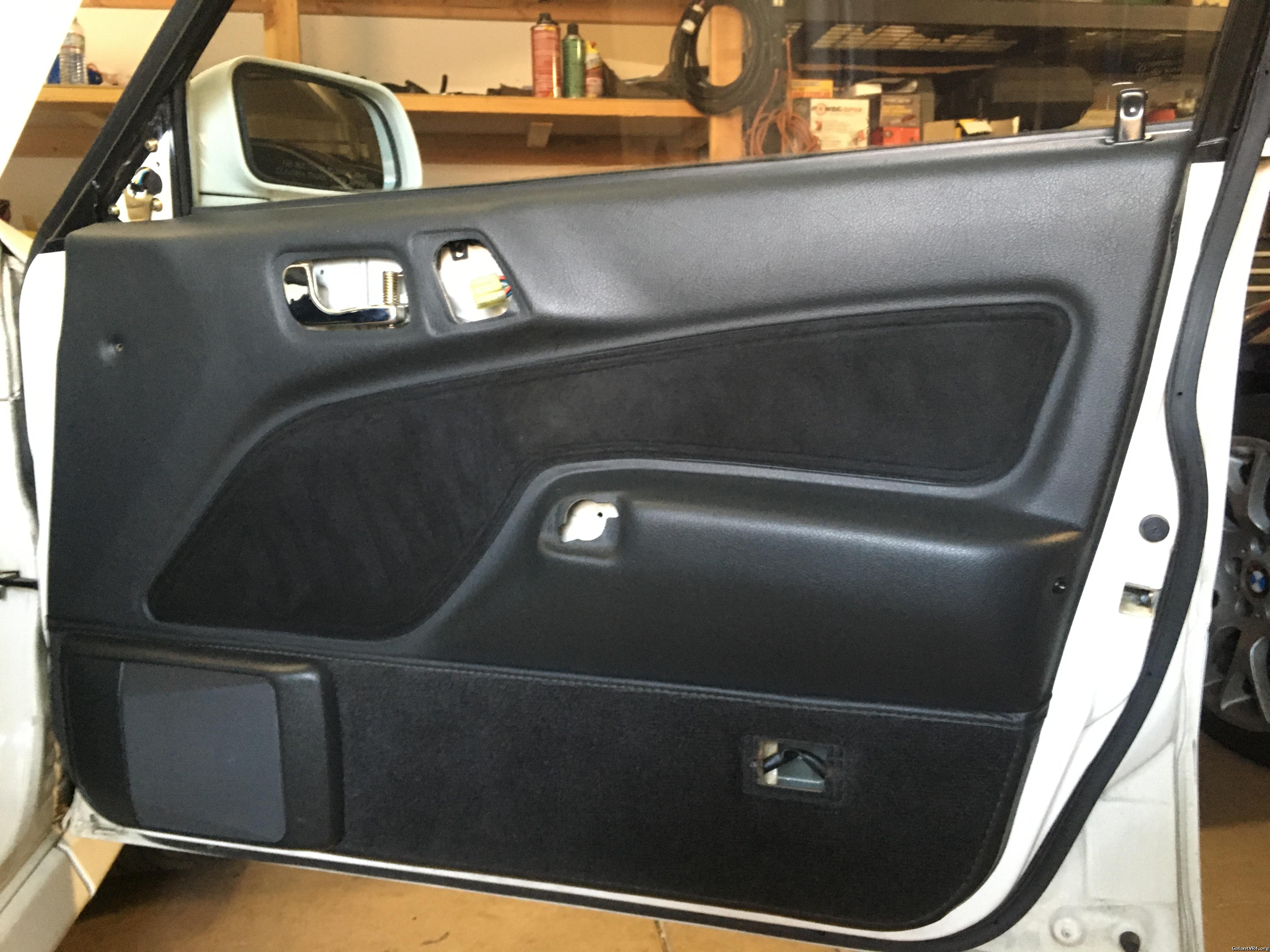

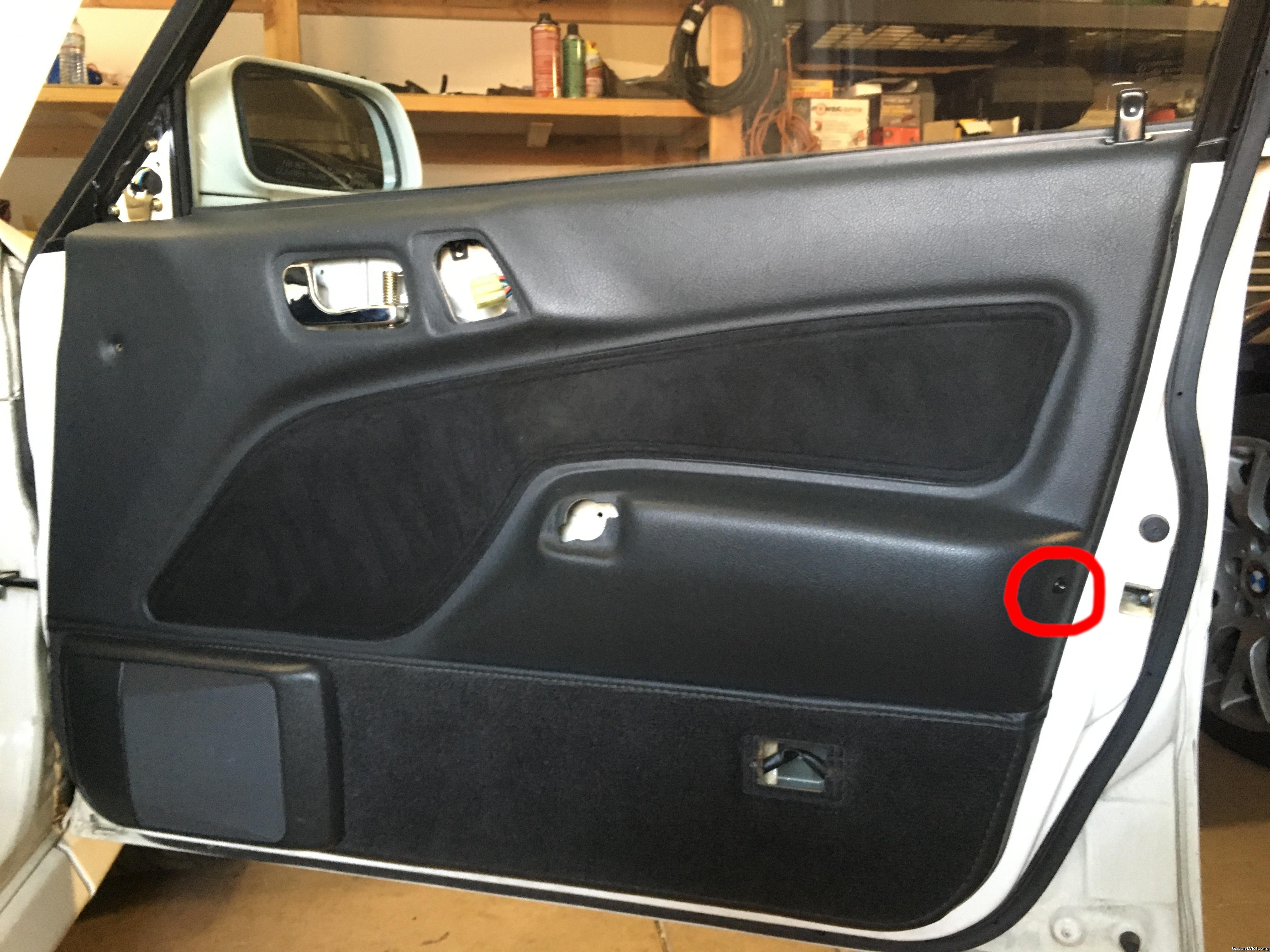

I expected that removing the door card would be pretty straightforward, but I was mistaken.
I have been defeated and am now asking for help. /ubbthreads/images/graemlins/frown.gif
Here's where I'm stuck...
Looking at the picture, I've removed the following:
Triangle/Sail panel
Two screws on the left side of the panel (upper, and lower left of the speaker cover)
Door release cover
Door handle
Lower light
Two screws on the right side of the panel (upper and lower)
I understand there are three hooks/clips along the bottom of the door card and that I need to pull the door card up rather than pry out. This is where the problem lies.
When trying to pull the door card up, there is more upward movement on the lower left and center clips than the lower right. In addition to that, there is no movement along the top of the door card. The silver trim piece along the top of the door does not move.
If I try pushing up from the bottom, the door card begins to bulge out in the center.
I'm hesitant to apply more force than I've already used. In fact, I'm surprised this thirty year old plastic and cardboard hasn't already broken.
I have not yet tried removing the driver side door panel. Once I figure out how to remove the passenger side, I expect that one will likely pop right off with no trouble at all. /ubbthreads/images/graemlins/tongue.gif
Does anyone have any helpful tips to remove this thing before I break something? /ubbthreads/images/graemlins/smile.gif

It's probably been over 20 years since I've taken that off, but I remember it being pretty smooth sailing. It's hard to make out from the pic what that it, but it looks like something might be holding it on.

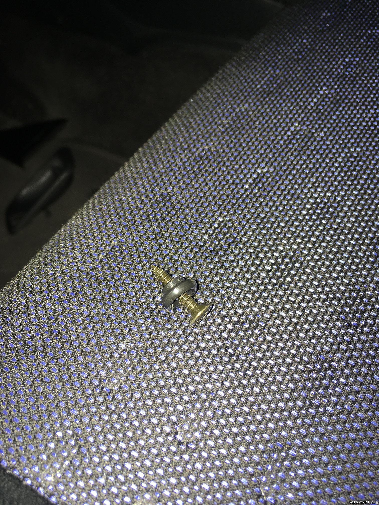

Yeah, the poorly focused old phone just doesn't capture as much detail as I'd like. /ubbthreads/images/graemlins/tongue.gif
That's just a plastic washer that has become one with the panel (like the one above it).
Here's what you spotted ...(minus the screw)
Anyway, gave it another go this morning with no luck.
Decided to move on to the driver's side. Same issue over there. All screws removed. There's nothing holding the panel to the door. The driver's side allows for easier upward movement of the panel with more play than the passenger side. What seems to be holding the door panels on (both sides) is the silver/chrome trim along the top of the door that runs parallel with the window. It doesn't move at all when pushing or pulling up on the panel. When I push/pull the panel up, it begins to bow out in the center since the top of the panel remains secured to the door. I can't figure this one out. It's either some little thing that I've now missed on both sides, or thirty years has fused these pieces together. /ubbthreads/images/graemlins/frown.gif

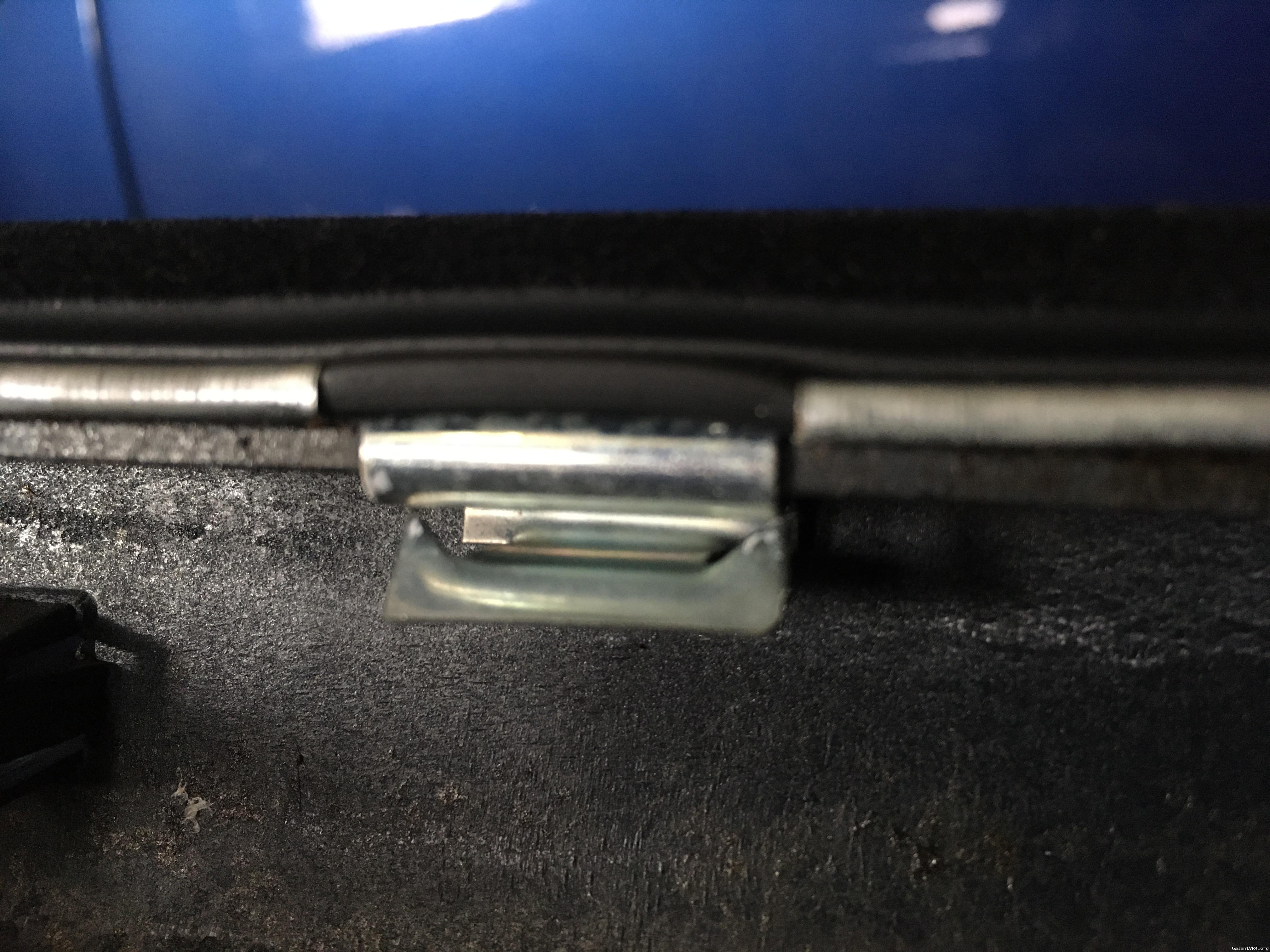

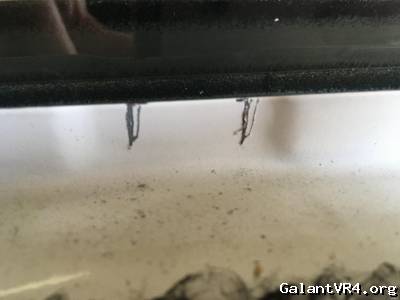

Along the top of the panel are metal u-clips with teeth. See blurry photo...
Those had really dug into the door!
I had to get a small hook in there and really pull up hard before they let go.

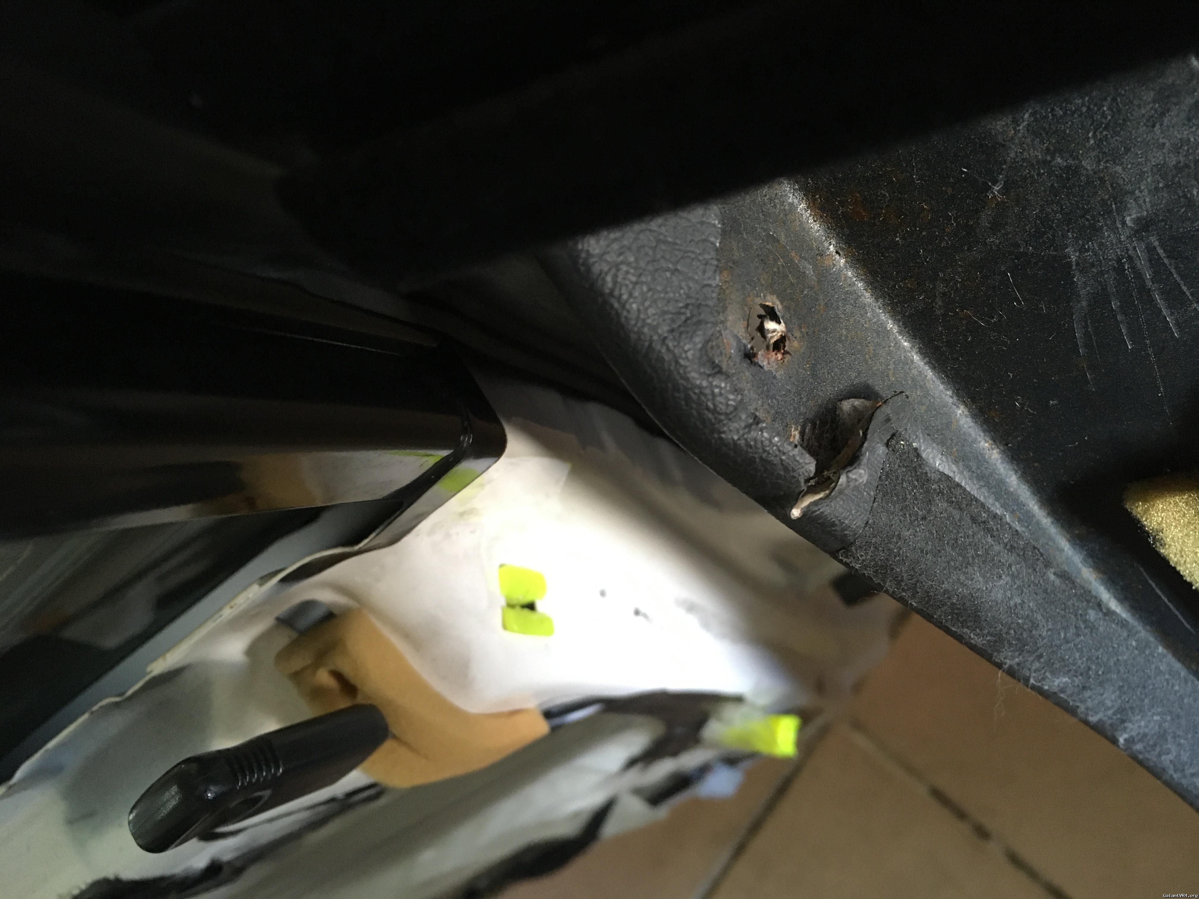

...and my second issue was a piece of vinyl on the back side of the door that had hooked itself to one of the plastic screw clips on the right side of the door (also near the top). When pressing/pulling up, that required additional force which slightly tore the vinyl on the inside before it let loose. Pic attached.
