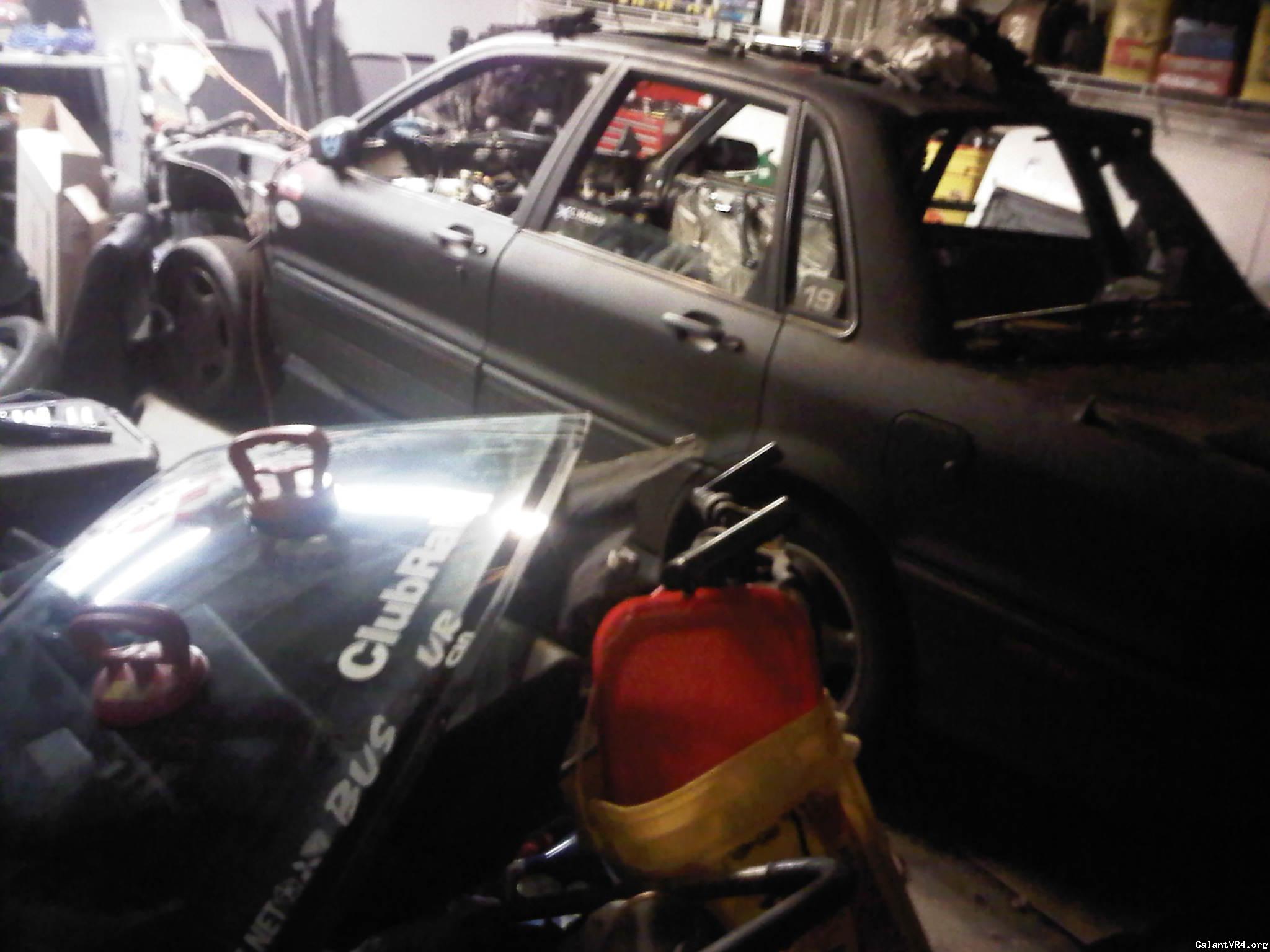

Peeling the roof off 195/2000 to make life easier for Kent when he installs the cage here pretty soon. (Almost there, Kent. Promise!)
1. Snap roof trim out of drip rails.
2. Use two slotted screwdrivers to remove trim retainer clips.
3. Mark, center punch, cut spot welds along both sides of roof skin.
4. Carefully remove trim around windscreen.
5. Use special tools to cut through the Window Weld sealing the glass in place.
6. Get to the last corner and crack the glass.
7. Switch to pry bars and forcibly remove fubared windscreen.
8. Mark, center punch, cut spot welds along front of roof skin.
More pictures, comments onTarmac & Gravel.

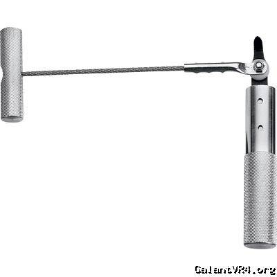

I still need to remove the rear glass - the back light. I've disconnected the defroster connections and removed all the trim. The little green clips that hold the trim in place seem to be glued in with the glass. This is original glass and I'd prefer not to f*ck it up removing it. With homologated seats running $300 and up, I'm already pissed that I'll have to drop $200 on new glass up front. Don't want to stick stock seats back in the car with a cage because I had to spend all my cash on replacement glass.
So, anyone have tips for removing the back window without breaking it? Any areas to be particularly careful of while doing this? I've got the one tool with the handle and pull bar, but it pretty much sucks.
We had some luck with a stainless steel cable saw slipped through... until the cable snapped. It's tricky to get a razor blade between things at that angle.
Just looking for some insight if anyone has experience with this project. Thanks.
Go to a glass shop and get the cool guy wire. Not cheap for the real stuff, but it's stranded, and will cut the adhesive like magic.
A little wd-40 sprayed on the wire every now and then will increase it's service life significantly.
Or you could just find a mobile glass-repair company and have them come out and do it for you. They're experts at pulling and later reinstalling glass without breaking it. That's how they make their living.

I bought a simple wire saw at Harbor Freight for two bucks. It got almost all the way around the windshield and the only problem was that it was terminated on both ends. I just cut one handle off, threaded the wire through, and had at it. Might just pick up a couple more and remember to spray them. The cold knife I've got sucks donkey balls. Most of the time, you have to stand in the engine bay, grip it with both hands, and then fight it side-to-side to get it to work. FAIL.
I'd call up a glass pro, but that costs money. Yes, cheaper than replacing the busted glass, but I'm trying to do this on the cheap. As tricky as things are, it's just cutting some urethane. The right tools make all the difference in the world. Appreciate the feedback, gents.

Thanks for the tips, gents. Managed to get the back light out last night without much fight. Just took a lot of passes from the inside with a sharp blade. Next time I need to pull glass, I'll see if I can't get a small piece of pipe tacked onto the end of a Harbor Freight razor knife. Seems to me that's all the pipe knifes are anyway.

Thought I would update this thread, as I have removed the roof on 195/2000 and am *damn near ready* to show Kent the money!
After the front/rear glass was out, I used a spot weld cutter to drill out the spot welds holding the roof skin on the car. Mike (3of1000) helped out.
With the spot welds cut, I took an old screwdriver to the tracks to both scrape out the adhesive and begin testing separation.
I had to go back through a couple spots to further cut spot welds (or drill out one or two we missed), then slipped a pry bar under the edge, gave it a slight lift, and POP! The roof skin was free.
Here's the roof skin, chillin in the driveway. I have to put the roof back on before I can install the front and rear glass, so if anyone had a non-sunroof roof skin they wanted to trade for a factory sunroof panel (cough-mikewitdaspike-cough), let me know! Otherwise, I'll be covering this sunroof opening with a panel and a roof vent.
