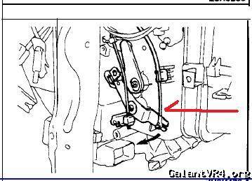

With the car warmed up, grasp each of the heater hoses and see if they're the same temp. If you're not getting circulation, one will be much cooler than the other. Full coolant flow will cause both to be hot. If one is hot and the other much cooler, disconnect both from the core at the firewall and connect together with a piece of 1/2 inch pipe, tighten the clamps and try it again. You said the core is good, so if the supply and return are not both hot then there is some obstruction between the two. If they're both hot, then make sure the ventilation and temp control cables in the dash are not crossed up. I did this once. The temp control cable should connect here:

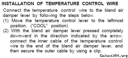

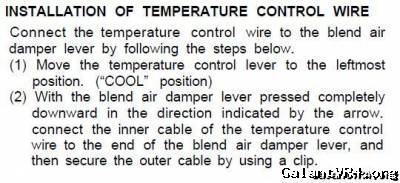

IIRC you can check this area easily by removing the panel on the left side of the console, near where your right calf is while driving. Rotating the temp knob while watching will tell you. If it is correct, then follow instructions for reconnecting it (from pg 55-27 in the electrical manual), pasted here:
Make sure the outer jacket is removed from the pinch clamp when you connect the inner cable loop to the end of the arm, rock the arm down while the control knob is in the cold(est) position, then press the cable jacket into the pinch clamp.
