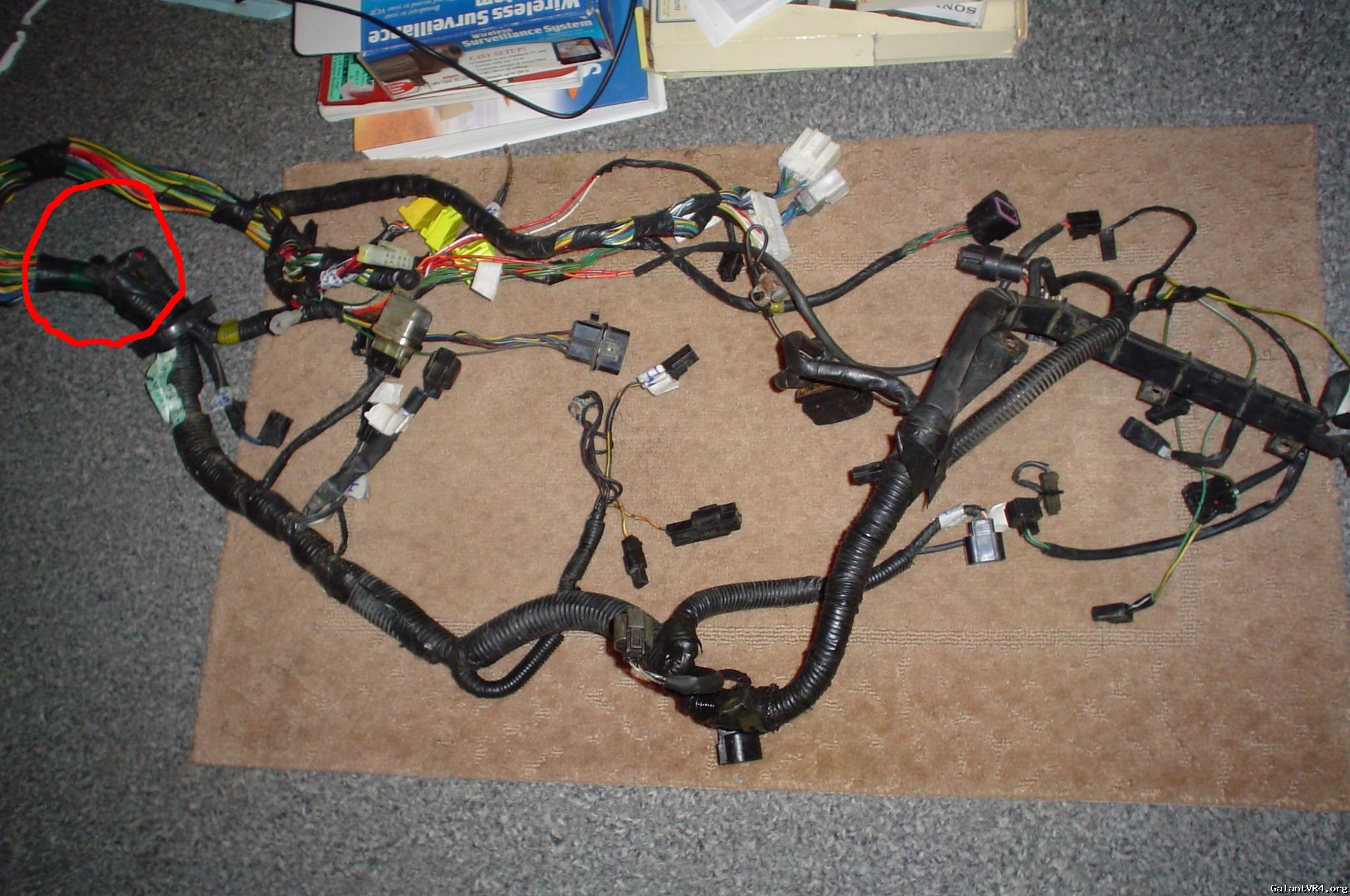

1.Has anyone pulled the wiring harness out of their GVR4 with the heater/blower still installed (dash still in tact)? I have done this on a TEL but it appears as though there is one cluster of wires connecting just cabin side of the firewall I cant see or feel to get un-snaggled.
This is the biggest pain in the dick of the harness removal. I finally got it out by removing the glove box and reaching under there to cut the tape holding the harness to the big white clip thing that attaches to the inside of the hole running through the firewall.
I do not have a pic of the plastic piece that I am speaking of, but here is a pic of my harness out of the car. Circled is the area where this plastic piece was taped to the harness. Hope this helps.
Oh BTW, remove the passenger side dash speaker to gain easier access to a few of the harness plugs (the white ones circled in the second pic) that are otherwise very hard to get at with the dash in place.

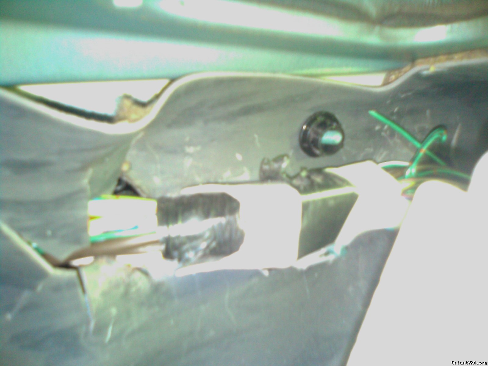

Well yeah it was that taped piece on the firewall after all. I ended up pulling the blower enough to get it out of the way. Thanks for the tip.
This is the piece for anyone else who stumbles on this.
Sorry for the crappy cell pics.

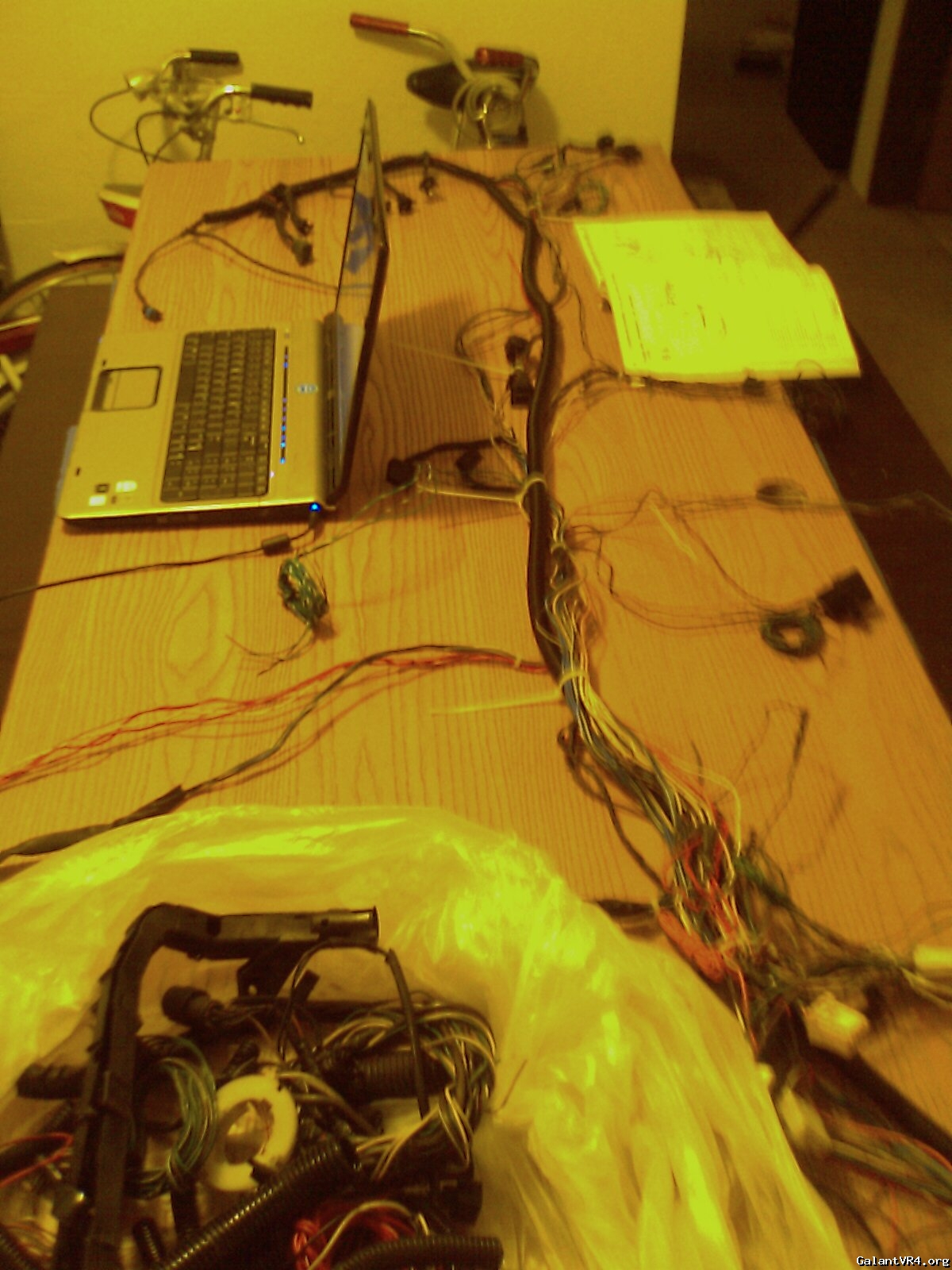

and here is how it all sits right now. Take note of Factory issue galant shop manual with EWD's open. and lappy with the like as well.
The main black covered harness you see running up the middle is the megasquirt harness. everything off it is what has not been cut away yet or is what is needed to keep the car functioning. The bag-o-crap in the lower right is what has already been chucked.
All I have to say at this point is wow.
Ryan thanks for all the help. Cant say for sure if im going to need more or not. But thanks for the help thus far.
