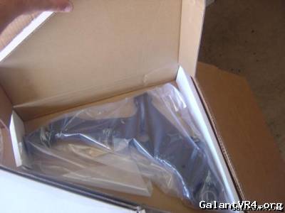

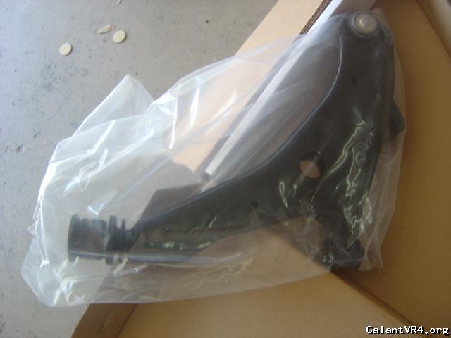

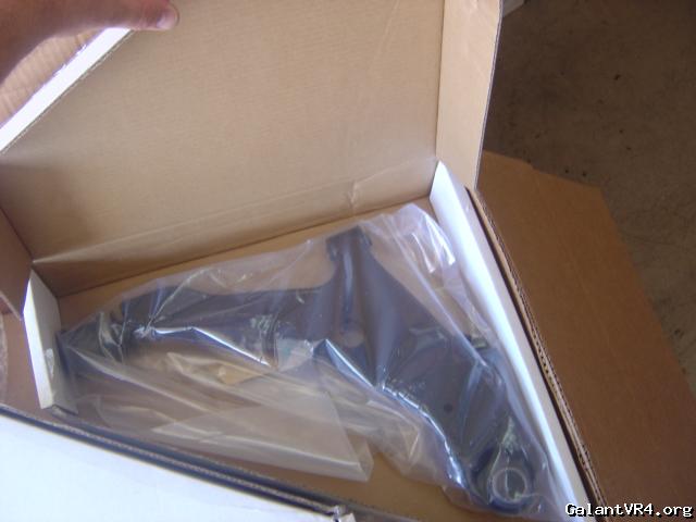

Thanks guys for the help. Going to pick up a set dorman arms. Just got to find the time to work on the car again. She has been siting for 4 months /ubbthreads/images/graemlins/frown.gif
I installed my Dorman arms this weekend. I bought them from am-autoparts on eBay. They have them for $98.93 for a pair.
The rear bushing needs to be moved back on the mounting stud slightly to line up properly with the bracket.
Other than that they fit great.
bobdole
Aug 23, 2007
896
U.K.
Got the Dorman arms in. They look like a really nice pc. Picked them up from Rock Auto. They shipped out very fast.
Thanks guys for all the advice /ubbthreads/images/graemlins/smile.gif
