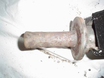

Just removed the stock bushings from my front lower control arms, and am seeing that the pivot arm on them is rusted enough in the middle that the bushing is a little floppy on there. I figure my 3 options for fixing are:
1. Weld some beads on them and grind the beads down, hoping to get close enough to the original contour.
2. As much as I hate the idea of the stuff, JB weld on them and then sand it down to get it closer to the original contour.
3. Use fiberglass resin to follow a solution closely resembling the one listed in #2.
Any of you have to fix this before? I've never used JBWeld, so I'm not sure if it's up to the task or not.

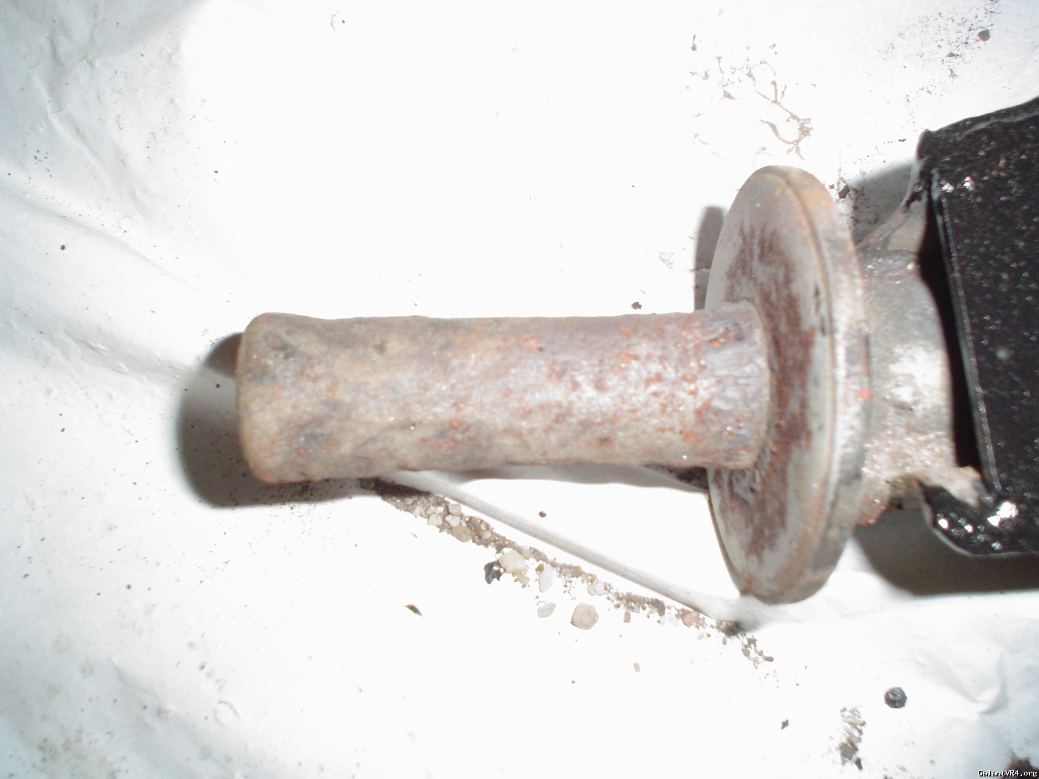

Yes, all options. Here's what I was referring to:
You can see that the tip and the base are fine, it just rusted out in the middle a little bit. I think I'll try the welding method first...

I will have to look for some pictures of the finished product, but I ended up filling in the missing metal with a mig welder. Picture beads of weld running down the control arm. Then, using an angle grinder and belt sander, I was able to get them very round and in-spec. To make sure that the bushing wouldn't have any wear problems, I covered up all grind marks/divots with JB weld, and smoothened that out with sandpaper until it was like new. I haven't had them apart since, but I'm not having any issues so far.
