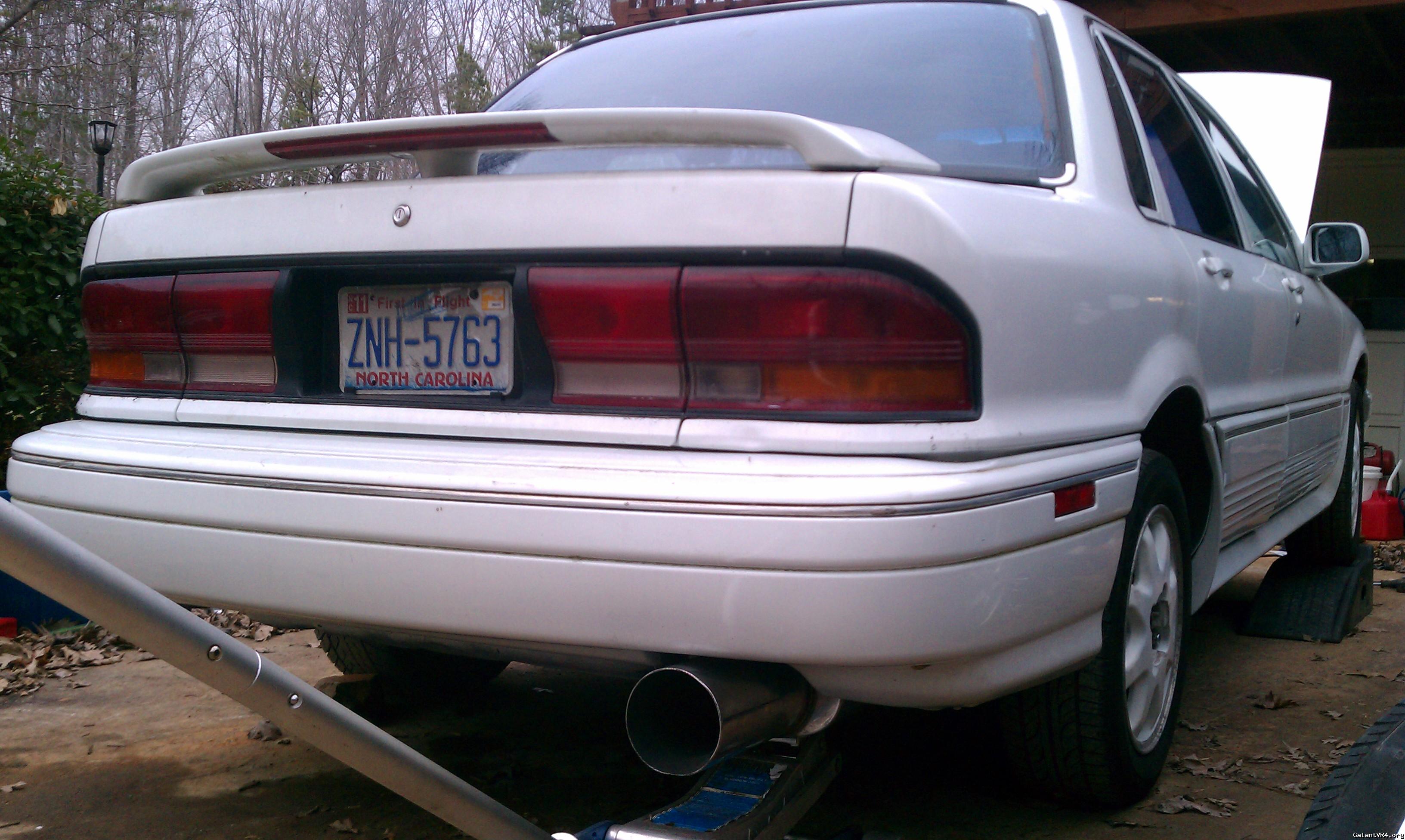

I got bored the other day and placed my exhaust tip up to the bumper to figure out fitment issues (as you can see the jack is holding it up)....once I get some more 75/25 (welding gas) I will weld some hangers for it and get more 3" tubing so I can finish my exhaust......but this is what it should look like. Oh yea the tip is a thermal research...3" inlet and perhaps 5" outlet???)

No offense, but that muffler tip looks absolutely horrible. Not only that, but it will add exactly 0% to performance over a 3" outlet.
Lonewolf64- I appreciate your honesty. I do not expect to gain any performance from it...if anything I hope to not loose performance. The only reason I am wanting to put a muffler on it at all is so that I dont get hasseled during NC inspection. Also hopefully it'll make the car a little quieter then a straight 3" exhaust will. Lastly if it would fit under the bumper so I could hide it I would but then there'd be no good way to connect the exhaust to it (to sharp of a bend). I am open to suggestions though.
Also if I had one that had a 3" outlet i'd be happy..........but I have had that muffler for a while...it came with one of the cars I bought and "free" is nice...
