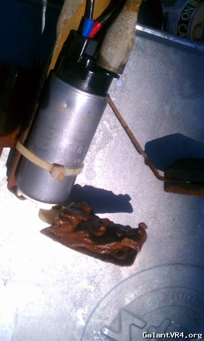

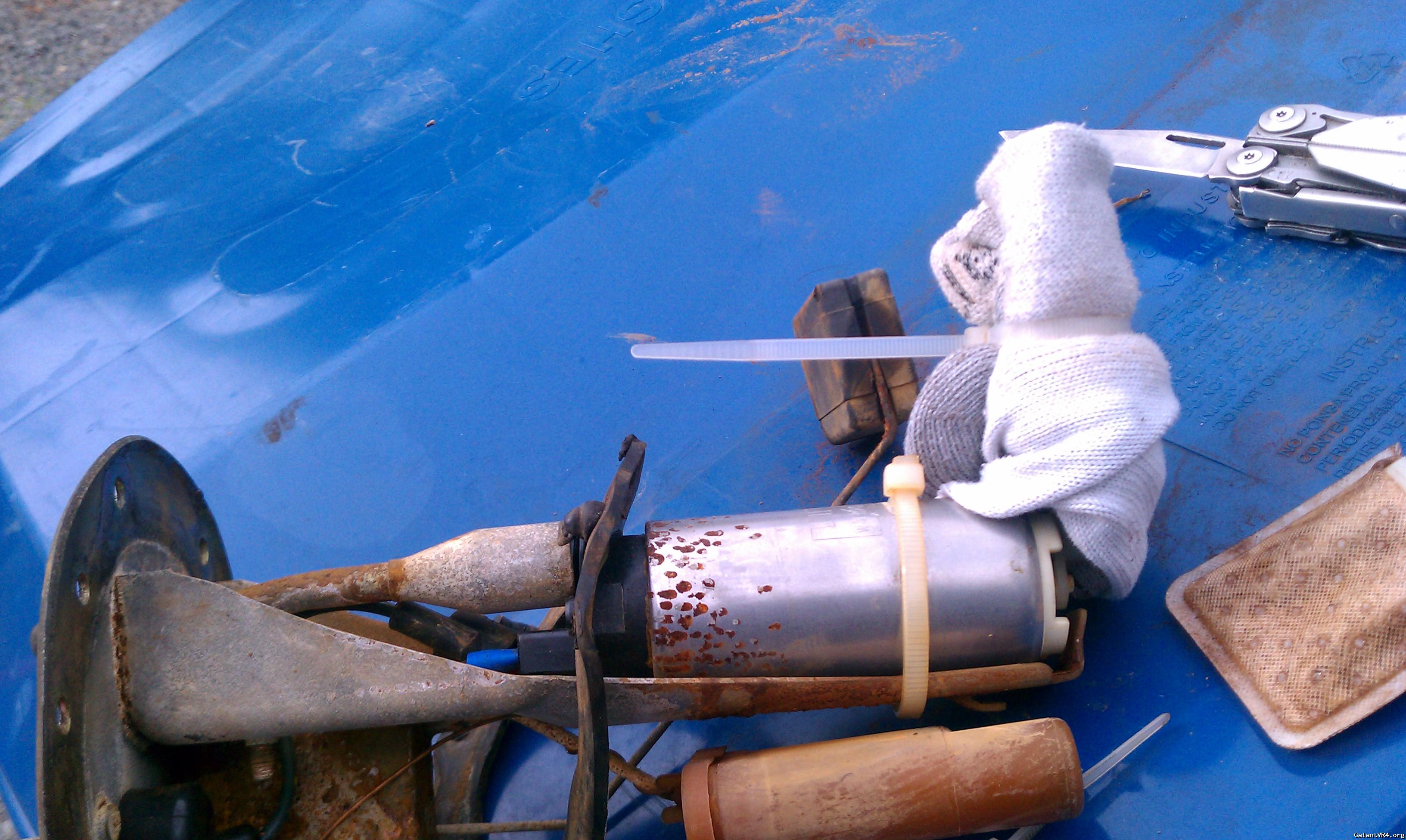

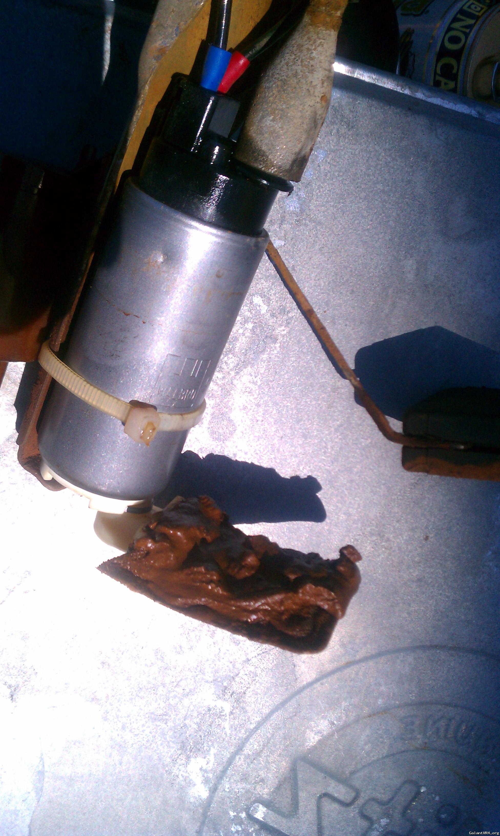

So I reinstalled that check valve which seems to be working and then pulled out the fuel pump...........it appears I was right about a clog however I didnt assume it was my brand new fuel filter (off the pump).....it basically looked like I had dipped the filter in a bucket of mud. This also seems to make a little more sense considering when I first installed this pump it was very quiet then after the first test drive it got loud like my 255.....I suppose when I went for a drive the junk in the tank sloshed around and clogged the filter which caused my lean condition and hopefully the loudness to the fuel pump (due to strain). So I am off to get another fuel filter and I am trying to decided the easiest way to drain and clean the fuel tank.......I am open to ideas.....last time (when I first got the car) I used a transfer pump to get mostly all of the old gas out...apparently that didnt get all of the junk out though.
(heres the fuel filter about 5 miles after new)
*Fuel problem solved
I was finally able to get into boost and have the car run rich :-D.........I had to pull the drain plug out of the gas tank then hand scoop out all of the crap/crud (about 4 or 5 handfulls worth of crap) and then paper towel the rest clean....it was pretty nasty. I am tempted to start looking for a new gas tank or perhaps modifying one of my racing fuel cells to go into the car. Regardless with a semi clean tank and new fuel filter the fuel pump was relatively quite and I was able to get into boost with my AFR's in the 10's instead of 17's :-D.....the car still desperately needs a tune and now that I have a little power really needs the brake issue resolved but I am one step closer to having her road worthy /ubbthreads/images/graemlins/smile.gif..

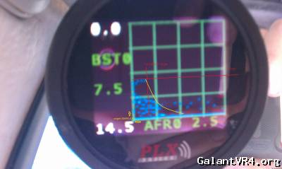

I just thought i'd provide a small visual update on what a dirty fuel tank can do for you........I pulled my fuel filter off the pump again this morning to clean it (dirty but alot better then before) and went for a drive...at first I was able to get to about 12 psi before leaning out...after a mile or two that dropped to about 4.5 psi before I started to lean out.....i'd bet money that my fuel filter is dirty again (its amazing how sensitive they are)....anyhow I had my plxdm200 do a scatter plot of boost vs afr and thought i'd upload it here (I put in the two red lines for easy referencing).

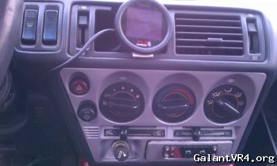

What a bad ass guage. I'd probably just source a tank rather than keep going through that sh*t.
Dbossman- Thanks /ubbthreads/images/graemlins/smile.gif , I am actually slowly looking for one....I am also strongly considering building a fuel cell for the car or just adapting one of my spare ones for my race car (late model).........either that or just drop my tank and give it a real good cleaning...the tank it self seems to be in good condition on the outside and from what I read finding a good condition tank at a decent price seems difficult (but I havent looked to hard yet).

So I took my fuel pump out again to look/clean the filter and take another quick drive ( I got bored)......and the light was hitting the tank just right and I was able to see rust on a good bit of the tank inside...I was able to knock some of it off and my filter wasnt quite as dirty as the past but I am thinking just cleaning that tank wont help unless I use some muratic acid (or similar) and then hope I dont thin it out too much...........or probably the easier solution of find a good used one local (with 2 hours of Charlotte, NC)...if anyone knows of one let me know /ubbthreads/images/graemlins/smile.gif.
So since I have been having a hard time finding a good cheap fuel tank local I decided to attempt to clean mine while keep it in the car.......so I drained about 2 gallons of gas from it , filled it to the top with water...sloshed it around and drained it all.......then put abuot 6 gallons of fuel in it with two bottles of heet (water remover) and drained most of it until the fuel coming out looked normal. With about a gallon of gas (maybe less) I went for a test drive and the AFRS were great (comparatively speaking...actually a touch rich under boost) untill I ran out of fuel lol...luckily it died in my driveway. However while under neath the car looking to see how much of a paint it'd be to drop the tank I decided to look at the drive shaft since I had been getting a vibration in reverse....come to find out it has 3 bolts in it but all of them were about a turn away from falling out........so needless to say I tightened them up and the vibrations seem to have gone away.

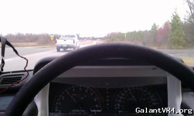

I took the galant on the main roads today and she did pretty well all things considered........and not that its a problem but the dash seems to ready about 3 mph fast...which is probably done on purpose for liability reasons (from mitsubishi)...although I am still curious why I appear to have a automatic/turbo/gvr4/usdm dash....

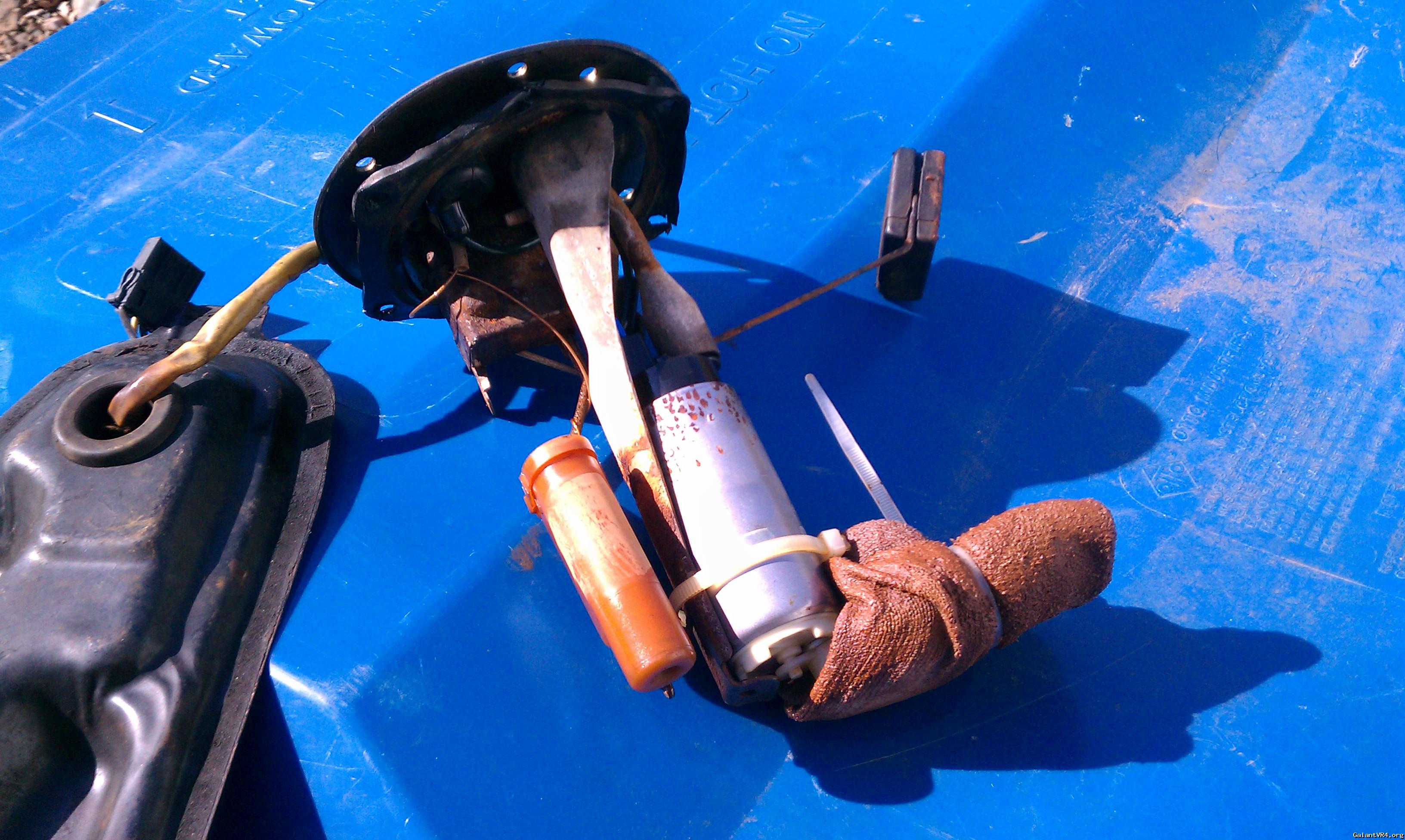

Fuel issue is slowly becoming less of a issue....I wrapped a sock around the fuel filter/strainer to help reduce the amount of new filters I have to buy (socks are cheaper then filters lol)..plus we did that with air filters in racing (but not the kind of socks you use on your feet) so I figured i'd apply the same concept here. I also used a magnent and an entire roll of paper towels to help clean the tank out more....I think it is almost fully clean. Fueling seems much more consistent and is nice and rich (eventually i'll tune it away from super rich but its a good problem right now). Also I realized I had a blonde moment when labeling my prior boost vs AFR scatter plot (origin is at the bottom left axis)

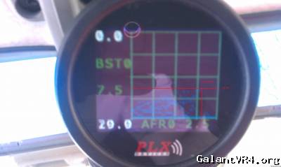

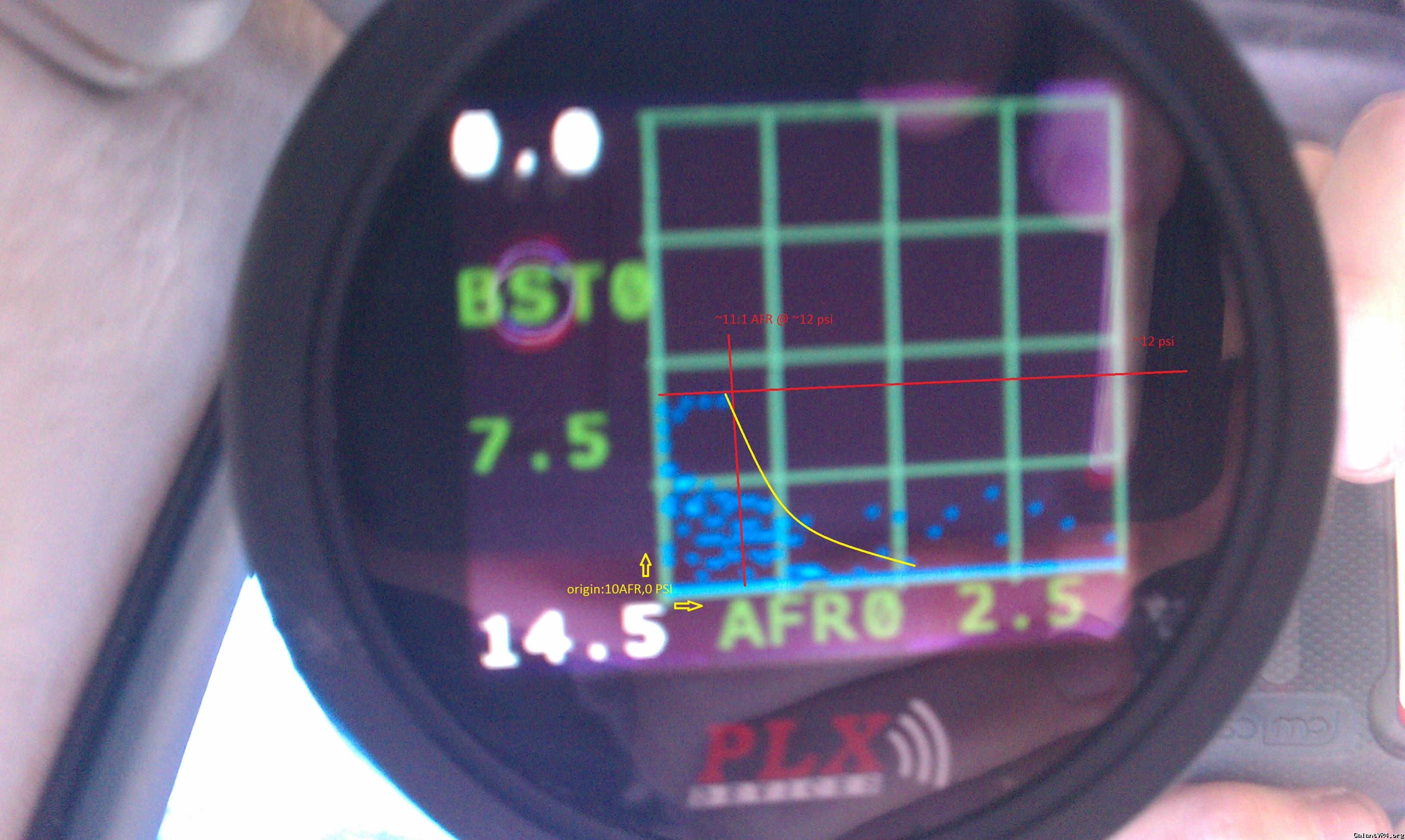

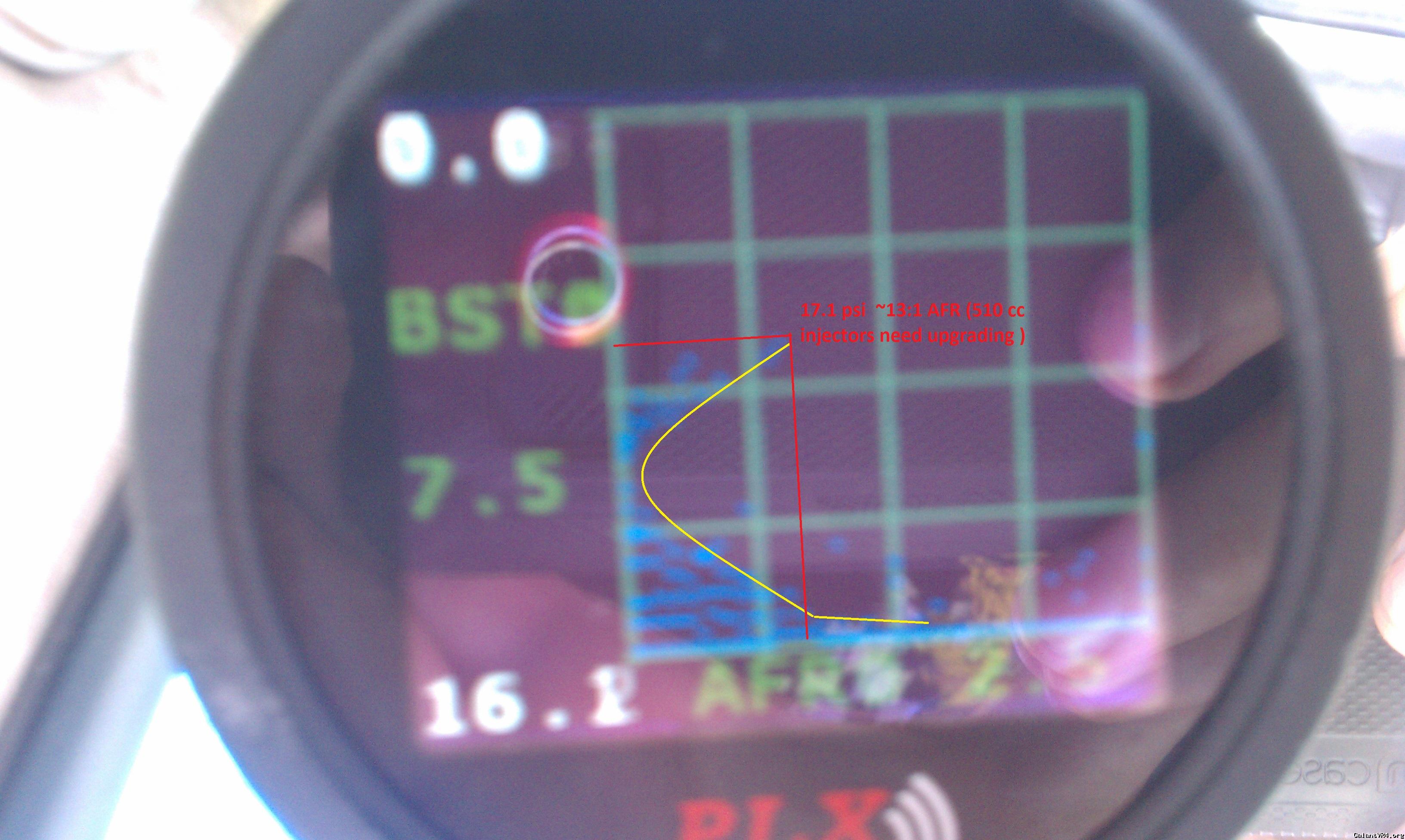

updated old boost vs AFR plot (clogged strainer/filter)

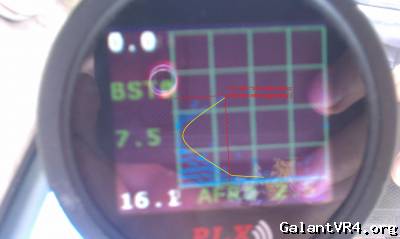

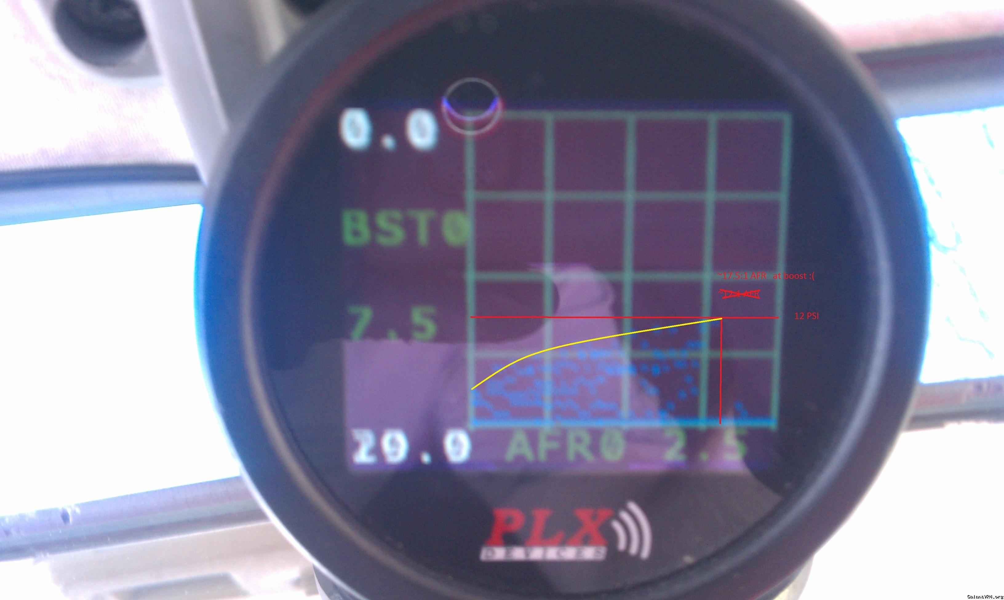

cleaner tank with new filter+sock

I also replaced my fuel sock as the pump was starting to get loud again (implying it was dirty again)
