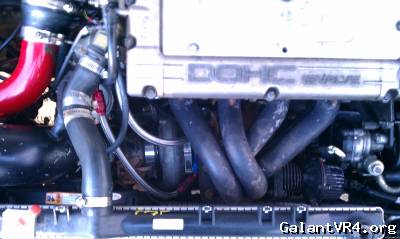

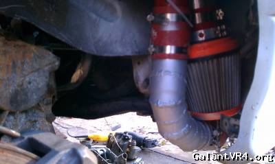

Alright so here is a quick video of the car running on jackstands, just to summarize the car: 1991 galant vr4, evo III motor, holset he351 vgt with mechanical control (oil and water cooled), currently no FMIC, GM MAFT (eventually speed density), custom 3" downpipe (thats the only exhaust currently on the car), front wheels converted to 5 lug...the rear soon enough, walboro 190 fuel pump, battery relocation to the back (not finished yet), saturn GM alternator (currently rewiring since it was draining the battery), dual oil filter relocation kit, evoIII front mount oil cooler and.........yes I know my spark plug cover says talon...i'll change it eventually :p

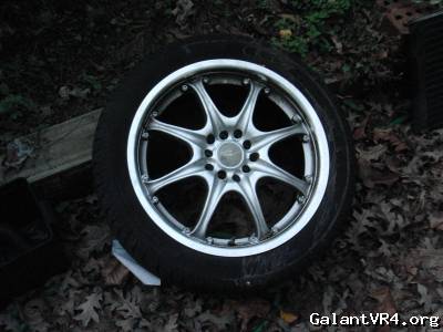

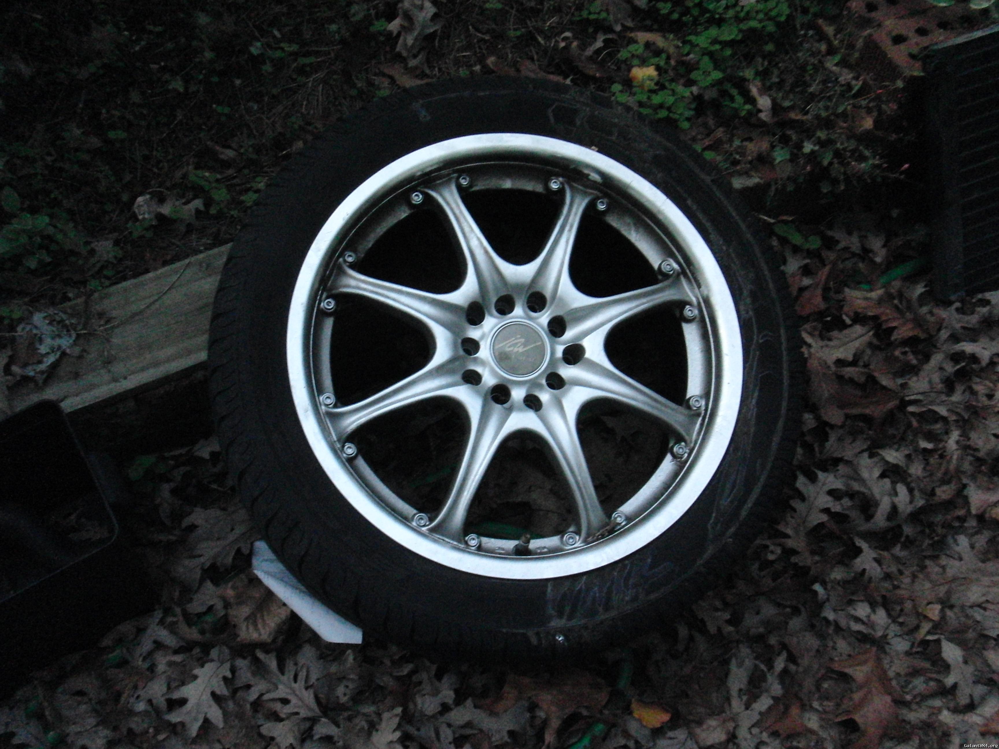

a quick picture of the rims that are going on it

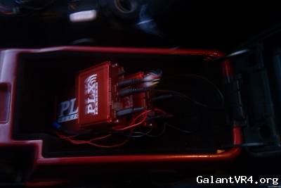

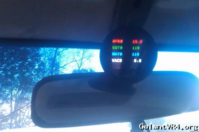

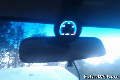

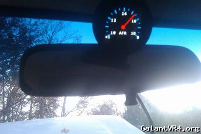

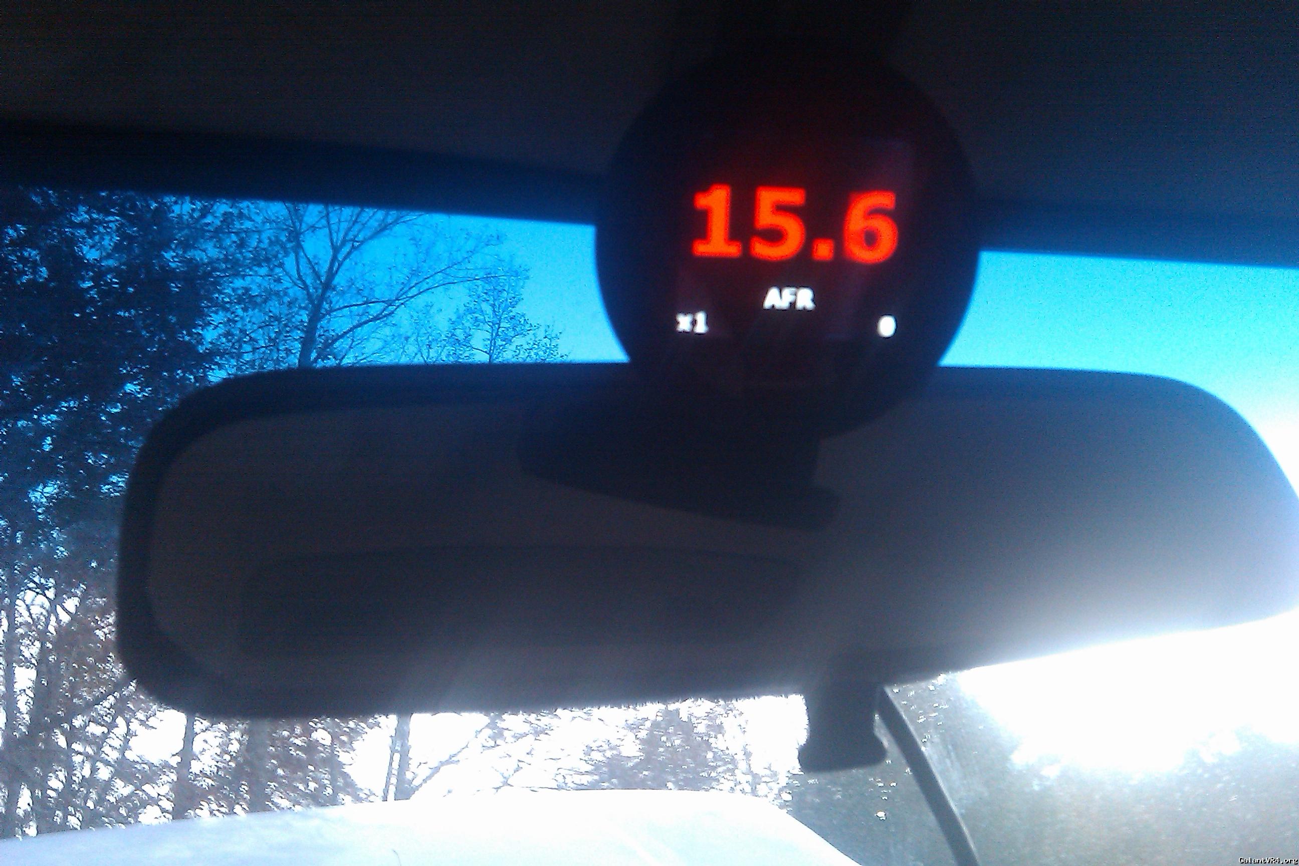

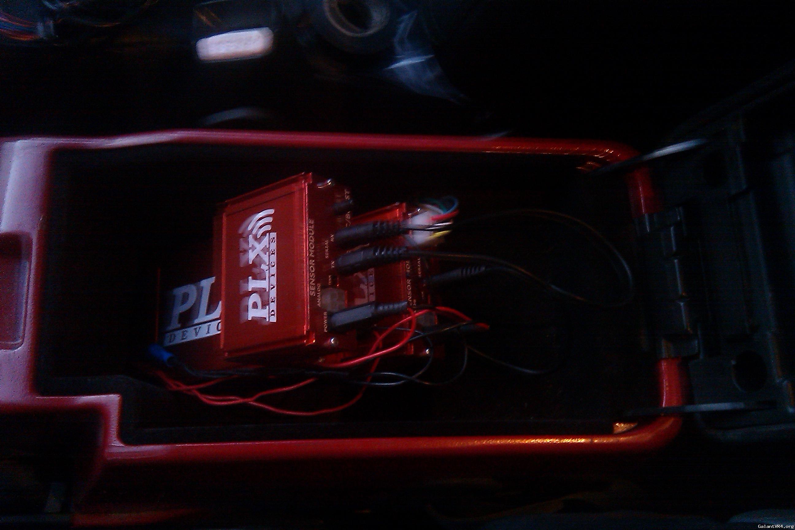

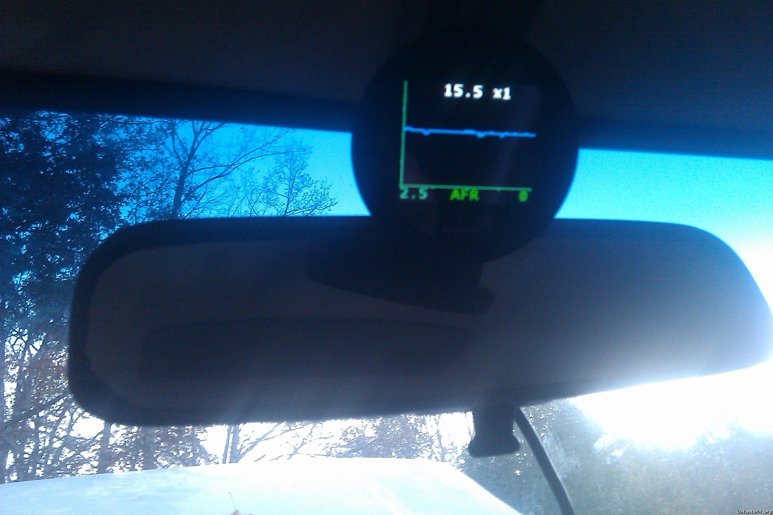

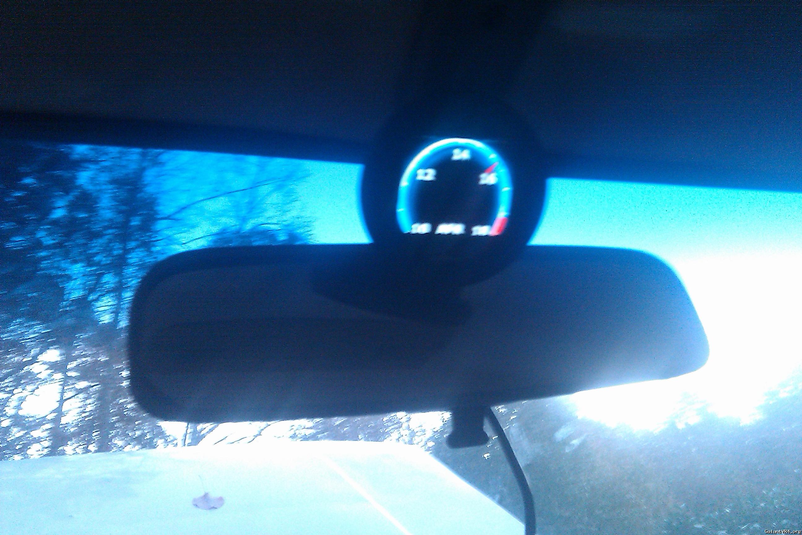

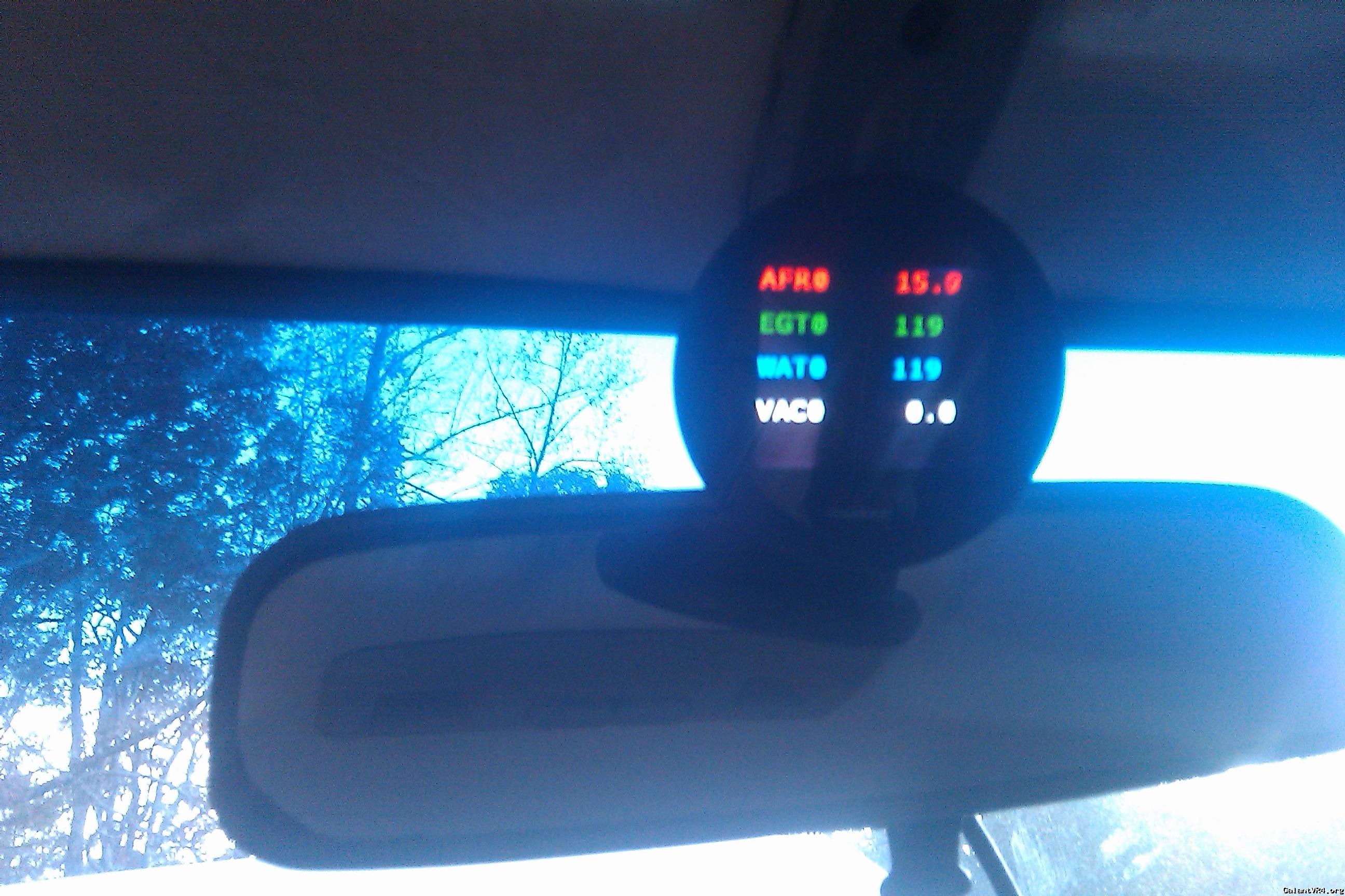

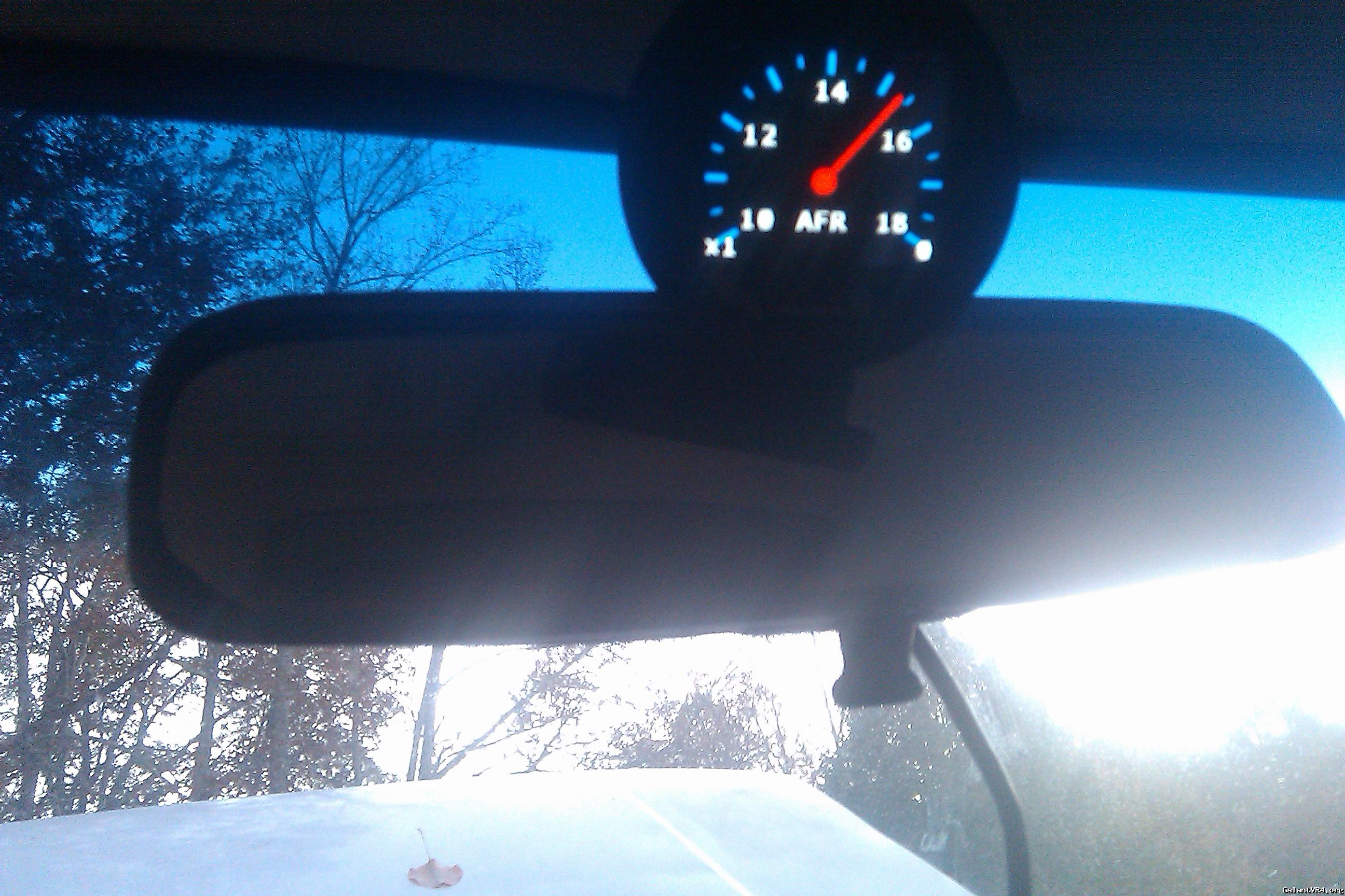

In effort to maintain a sleeper look in the galant I orginally planned on doing a full Car pc and displaying my gages on their.......well between time and money (mostly money) and a trade oppurtunity that arose I know own a PLX dm-200 with the AFR and Boost modules............basically its a customizable all in own gage...I can display 4 parameters at once , view a time plot, numeric gage, dial gage or upload my own graphics.......I dont have the gage mounted yet because I am not sure where I want it but here are a few pictures with the different gages for AFR. Modules are currently located in center console.......sorry for crappy pictures/lighting.

That gauge is pretty cool - I don't think it will be sleeper to the guy behind you though /ubbthreads/images/graemlins/rofl.gif
RedTwo- Thanks....well the gage placement is causing a mental debate....mount it low and out of sight that is hard to look at when I am going fast, or make it easily visible to everyone :p.....so many choices /ubbthreads/images/graemlins/smile.gif

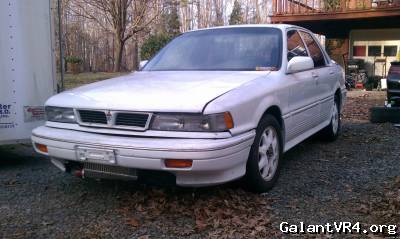

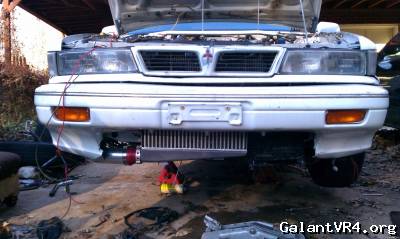

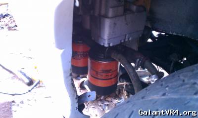

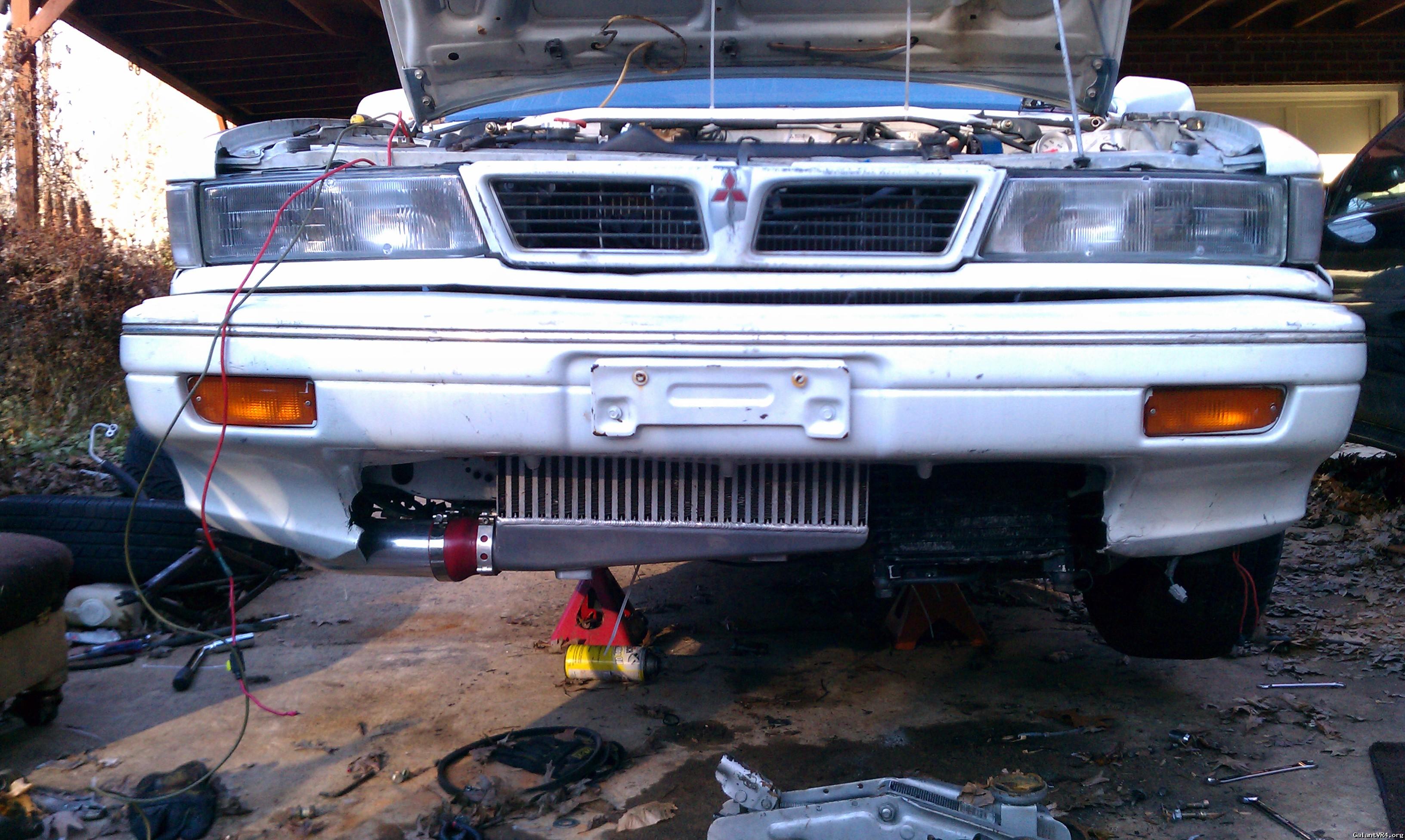

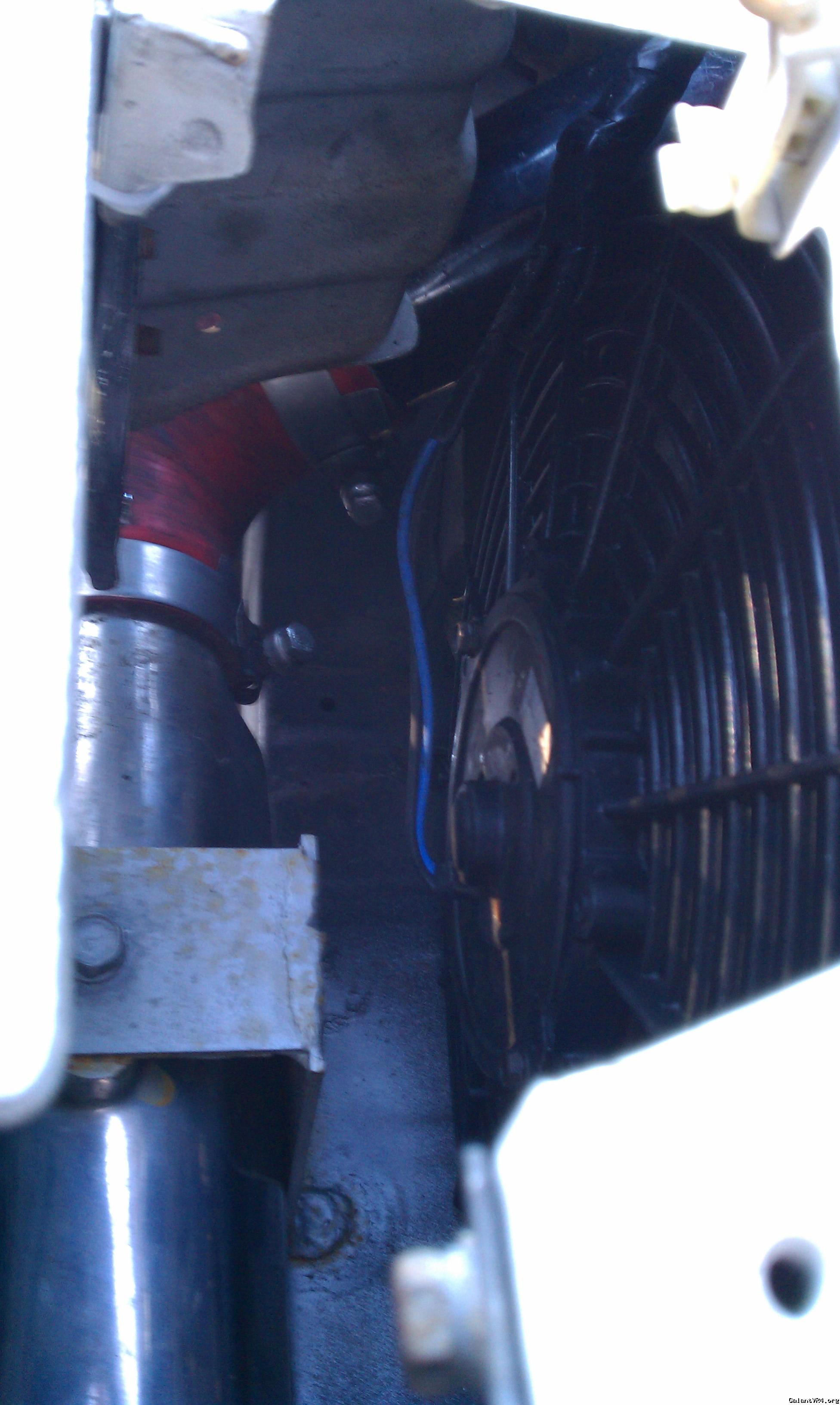

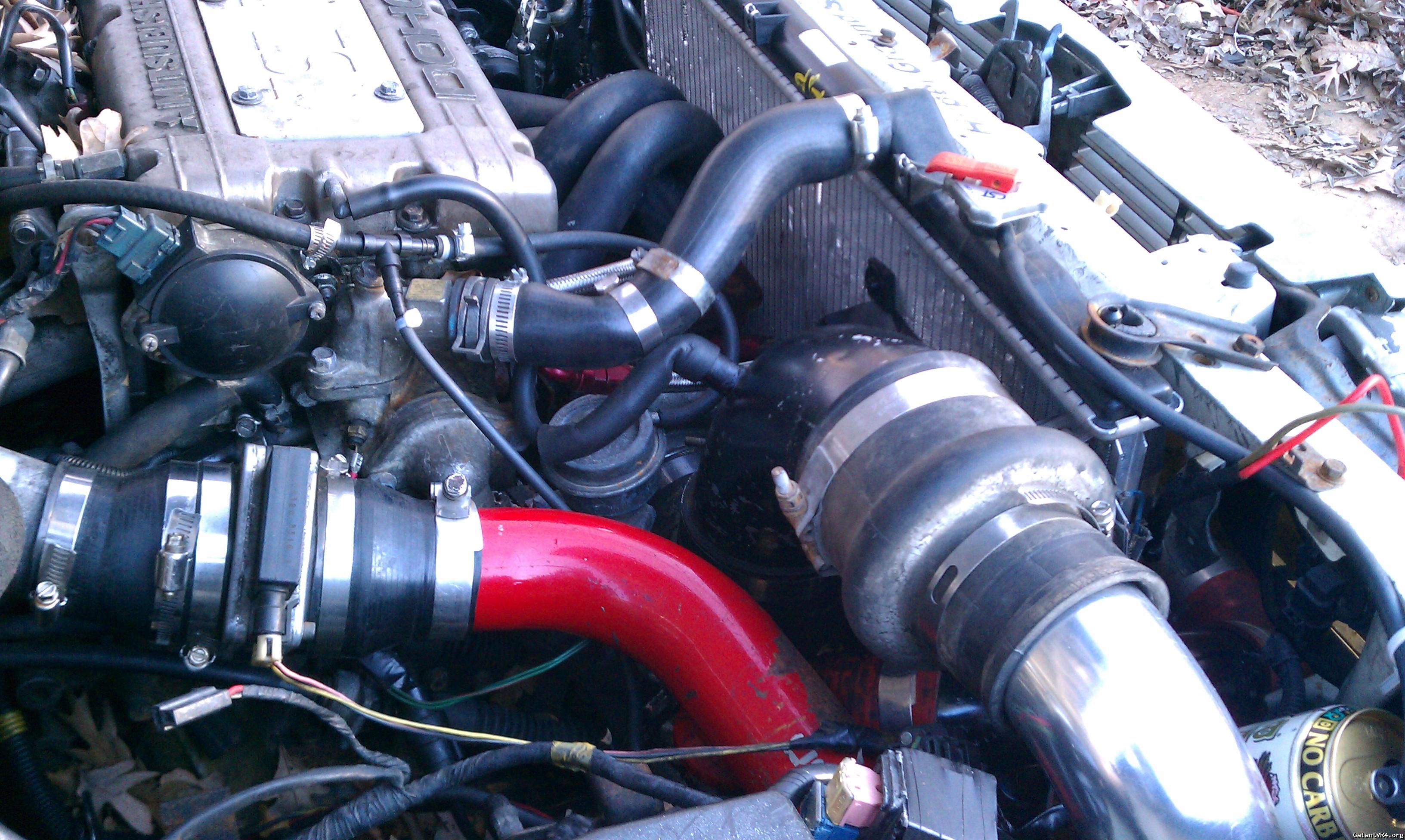

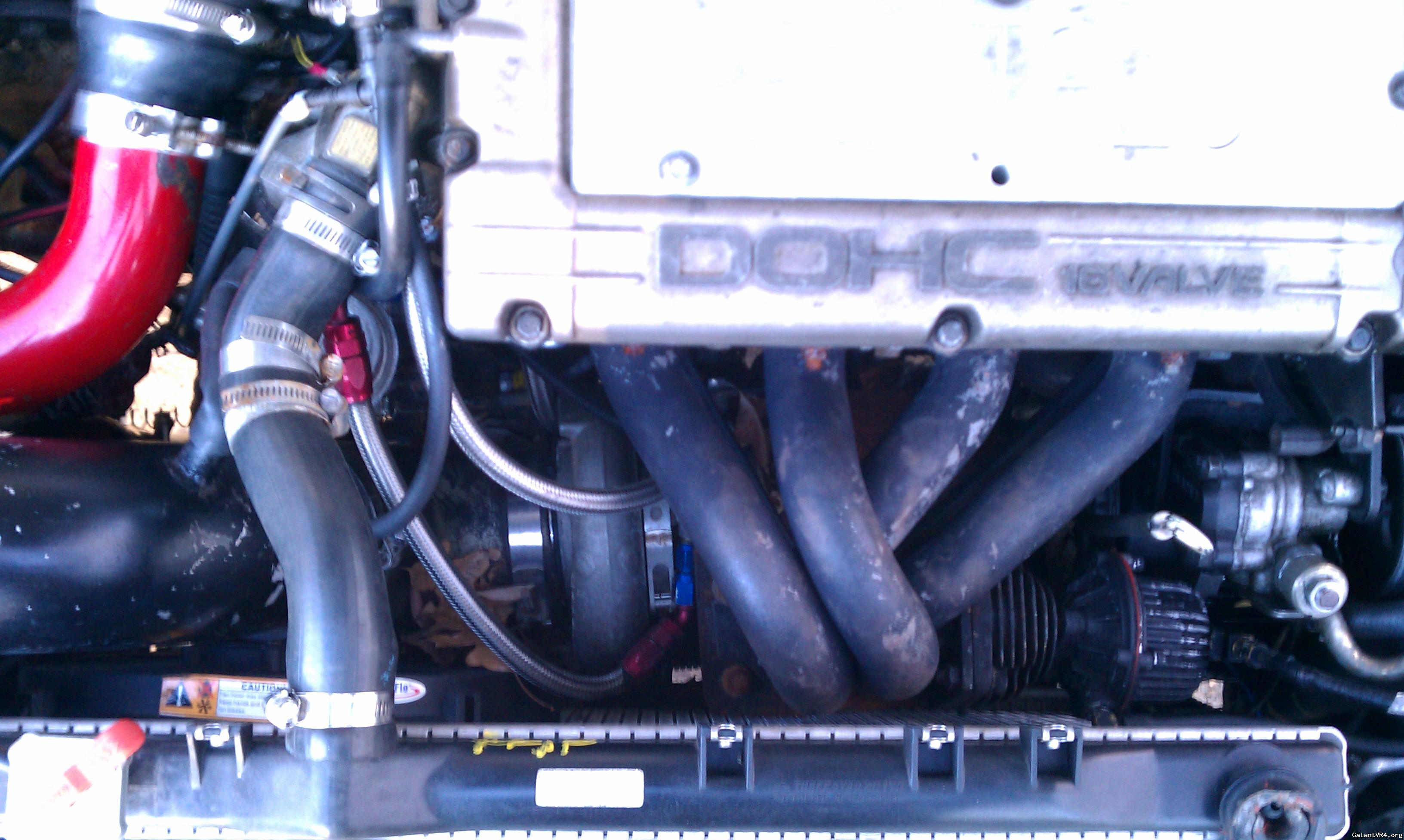

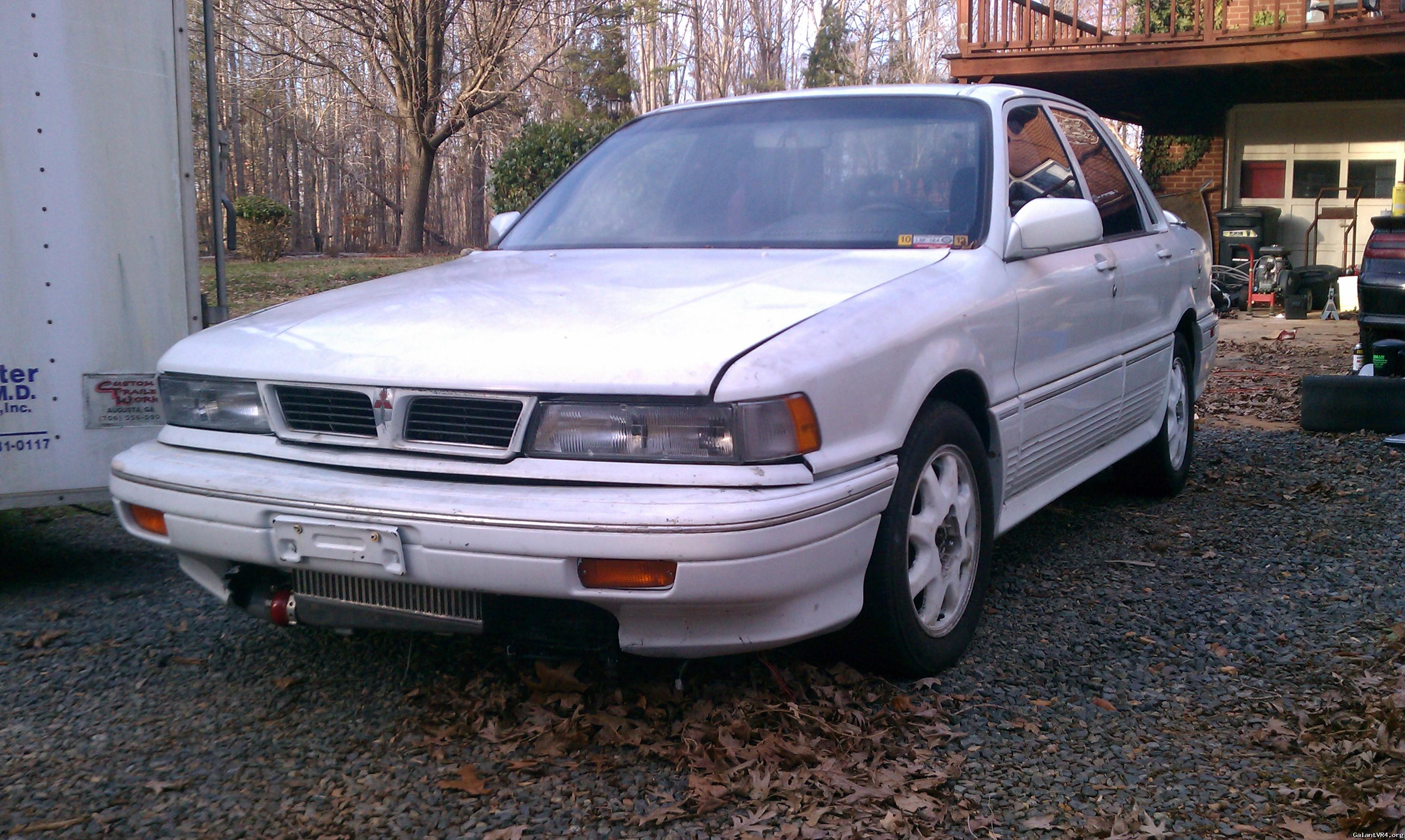

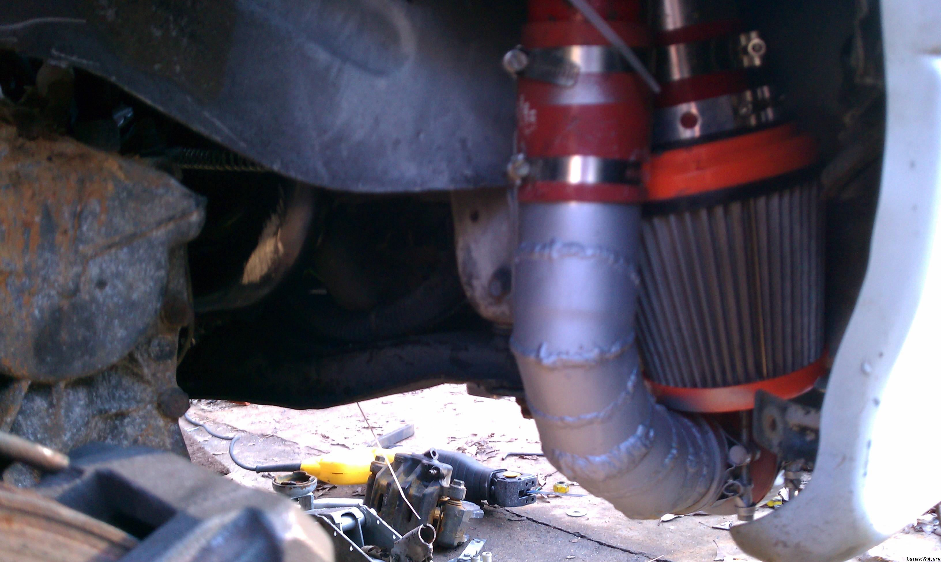

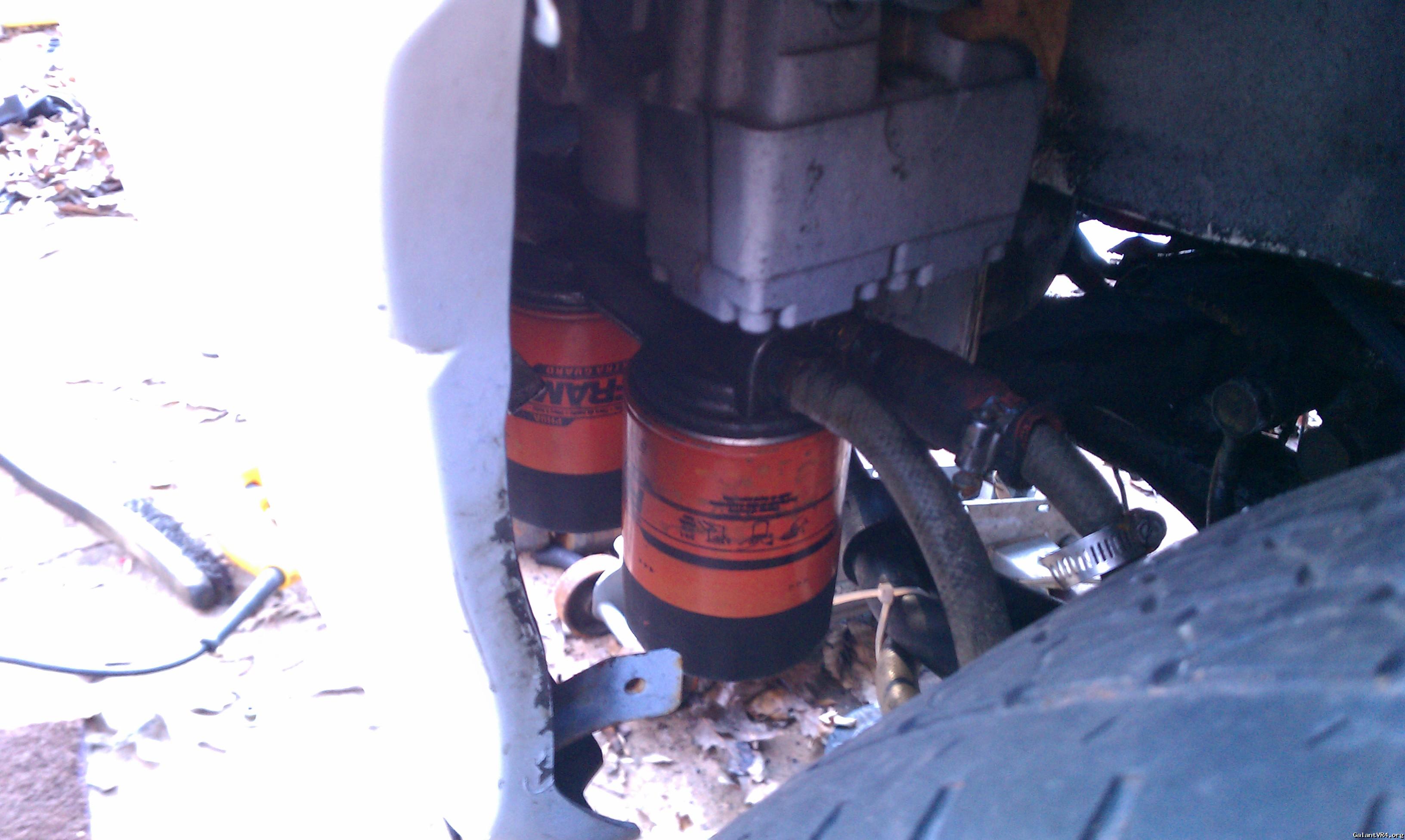

Hey everyone...I have been working on the car slowly over the past 2 months, been busy with school and trying to find some sponsors for my late model (asphalt circle track) but anyhow the car is almost road ready....I could put her on the road right now but i'd like to replace the RF outer tie rod end and i'd love to find some new rotors local (but thats harder then you'd think...no one seems to stock them). Also I bought a new FMIC for $75, had to make some brackets for it but aside from the good price the inlet/outlet is on the same side which make a world of difference when trying to route the IC tubing since the turbo is so large. I also mounted the oil cooler up front as you will see and finally mounted my dual oil filter relocation kit (uses mustang filters)....hopefully I can get some steel braided lines for it eventually. Lastly I finally decided where I want to mount the battery and now I just have to make a few brackets for it, after that its just cleaning up the interior (wiring/installing radio/maybe new seats???) and tuning it /ubbthreads/images/graemlins/smile.gif.
Here are a few pictures for yall.....also if anyone knows where a decent front bumper is at a good price local let me know....I am not a huge fan of mine being all cut up like it is......
She is finally on the ground :-D.........perhaps ill drive her around some this week/weekend as she still needs some work done to her (mainly wiring stuff up then hiding the wires).......but she is finally off of jack stands :-D

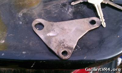

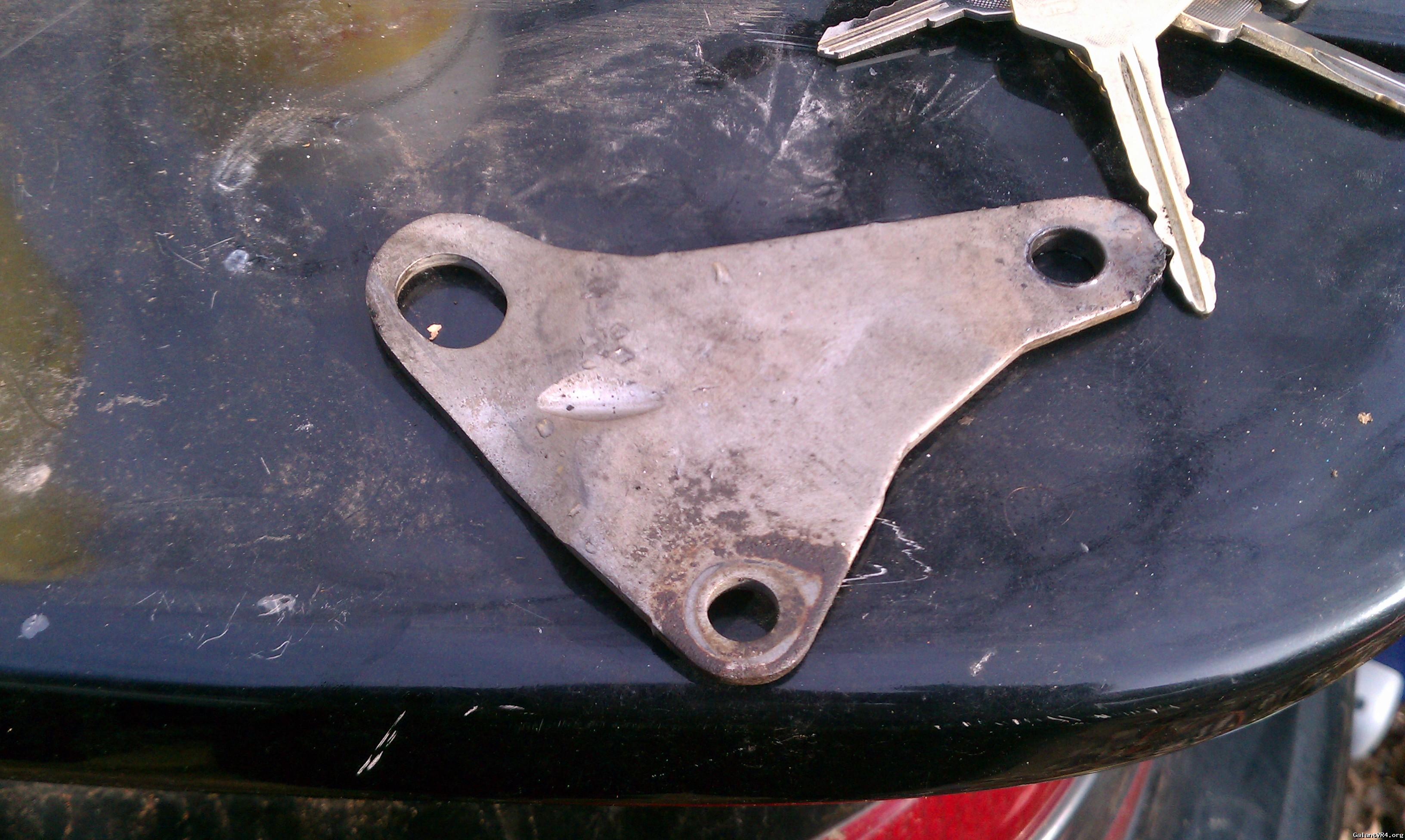

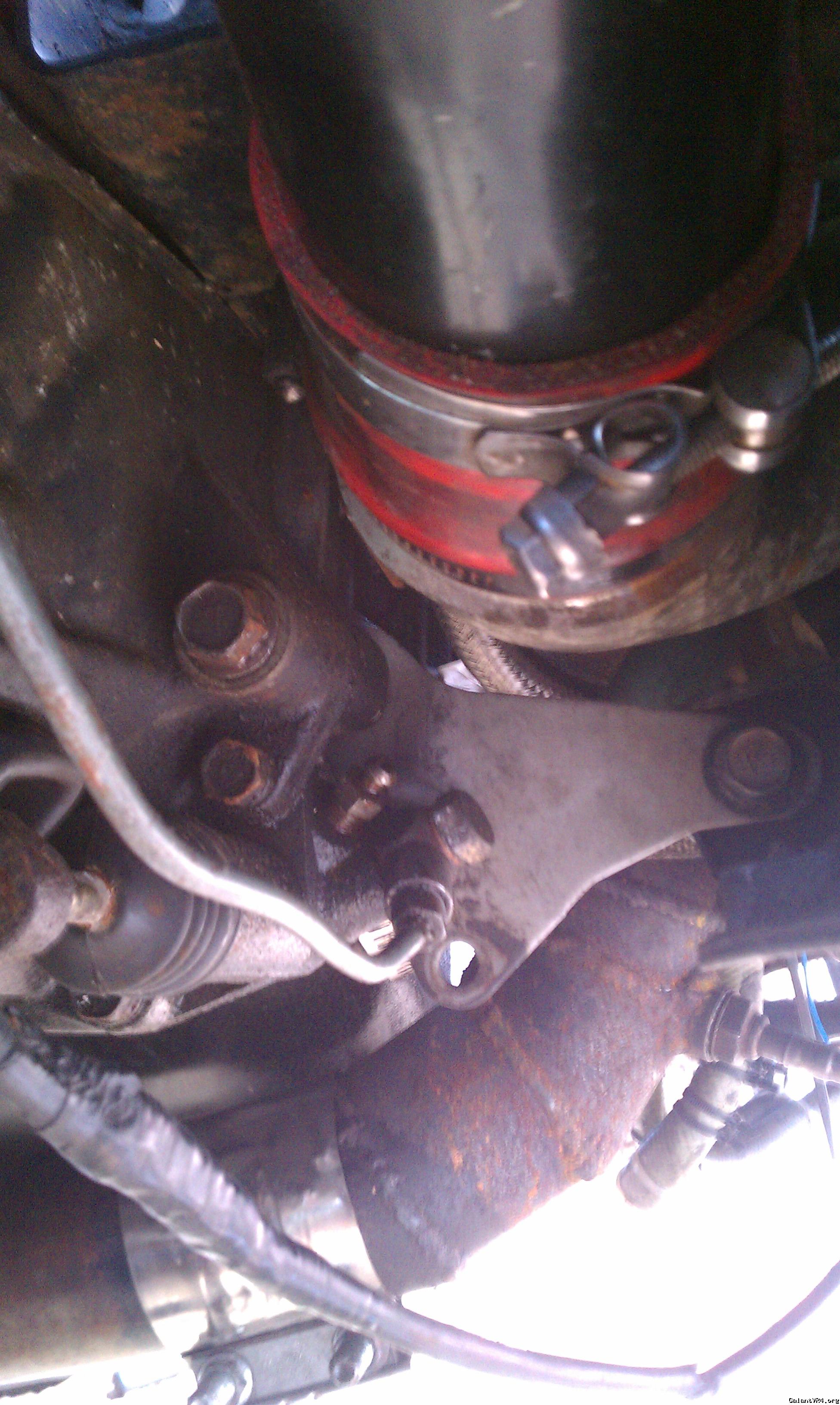

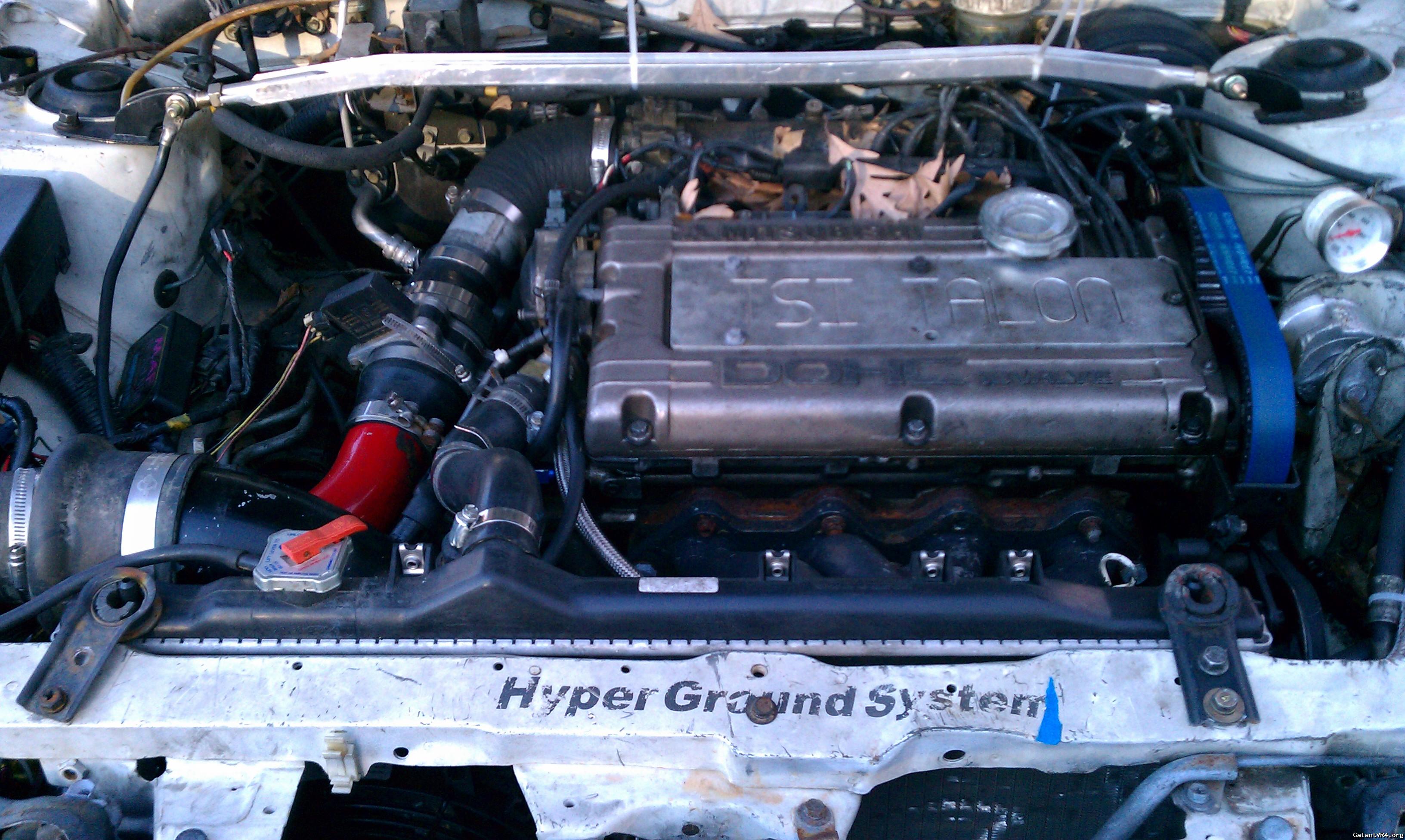

Also I took a picture of the front motor mount that I made due to the large turbo (he351 vgt) and it being a evo3 motor....i'd of preferred to do it with a heim so I could adjust it but it should work for now.
cutlassJim-Front roll stopper is pictured right above you...it is a piece of steel ............driver side motor mount was cut and welded to get the motor aligned right, rear roll stopped and pass. side mount are stock.
I had previously (with a smaller turbo) used a similar piece of steel that provided better support but my turbo is currently in the way so I had to use this...which will eventually get a little extra bracing or i'll switch to a adjustable heim joint.

Your front roll stopper is my ceiling? Kidding, I Fkn fail. That's what I get for browsing on the pooper at work. Is there provisions for a rear roll stop bracket on a 7 bolt motor?

cutlassjim- I am using the stock gvr4 rear motor mount with no mods to the mount/block so yes /ubbthreads/images/graemlins/smile.gif

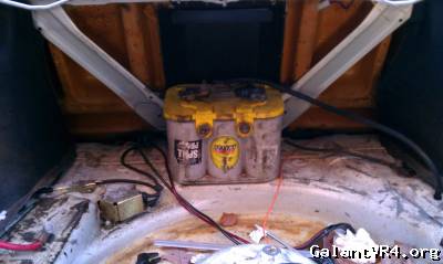

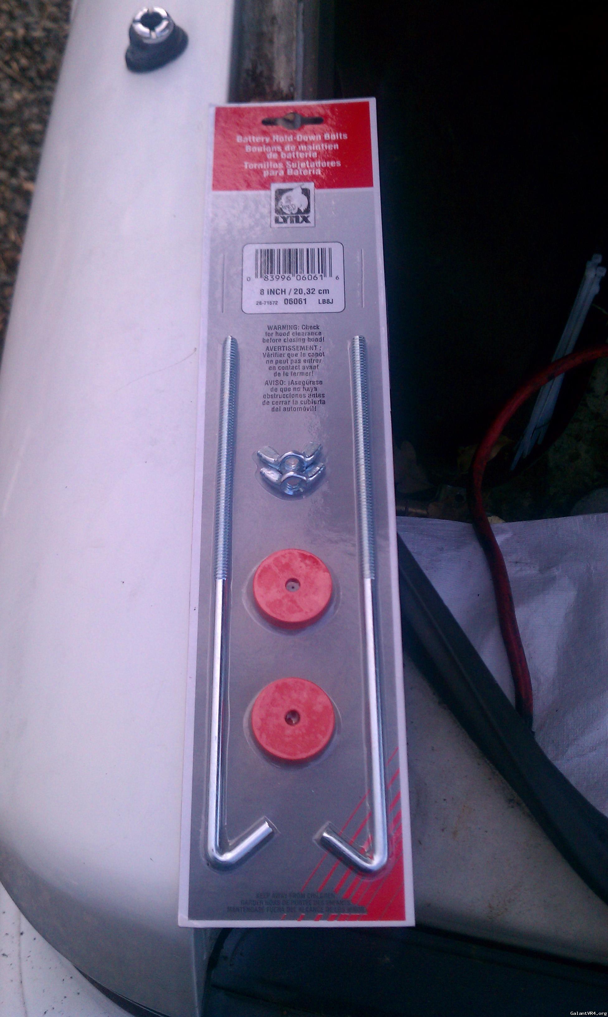

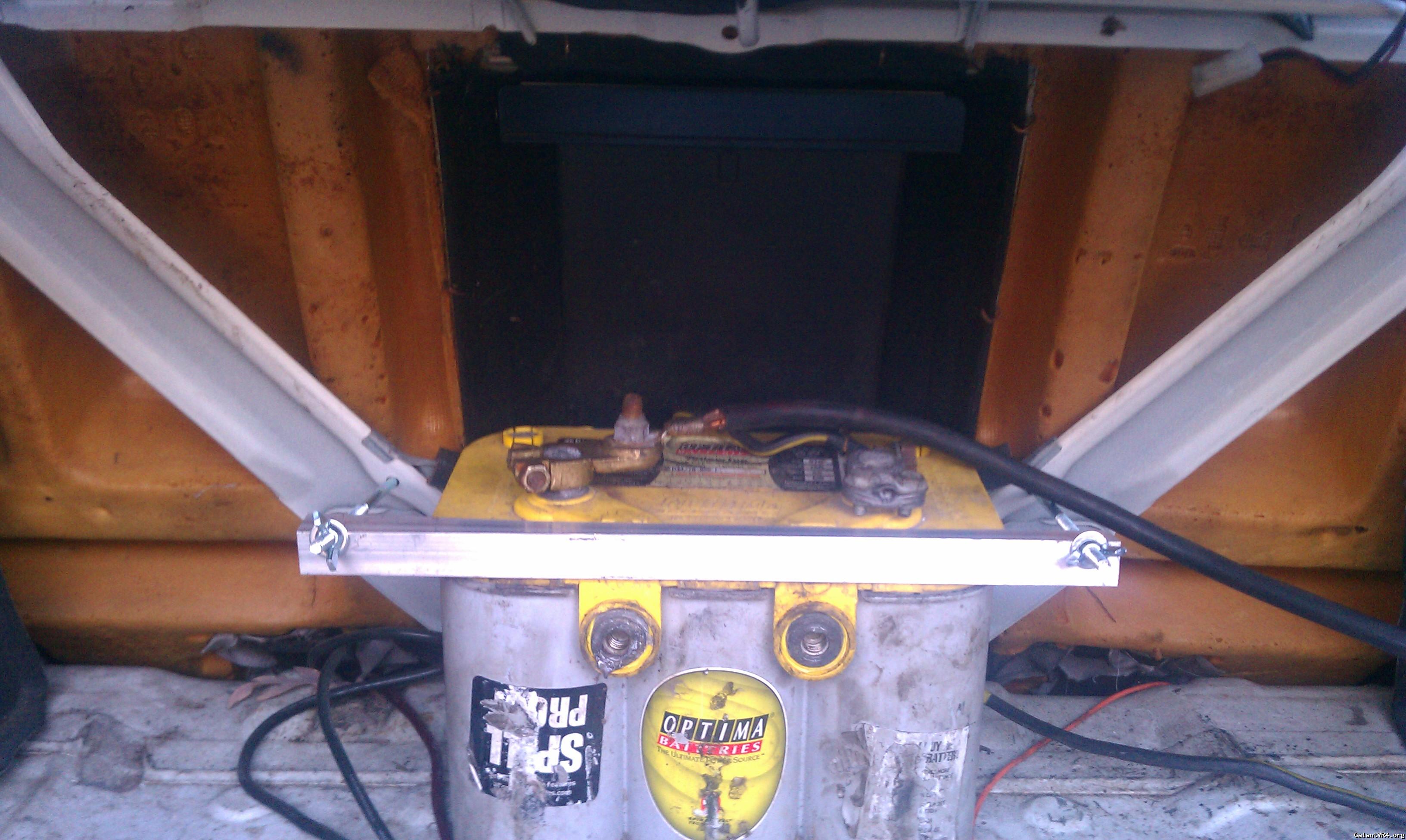

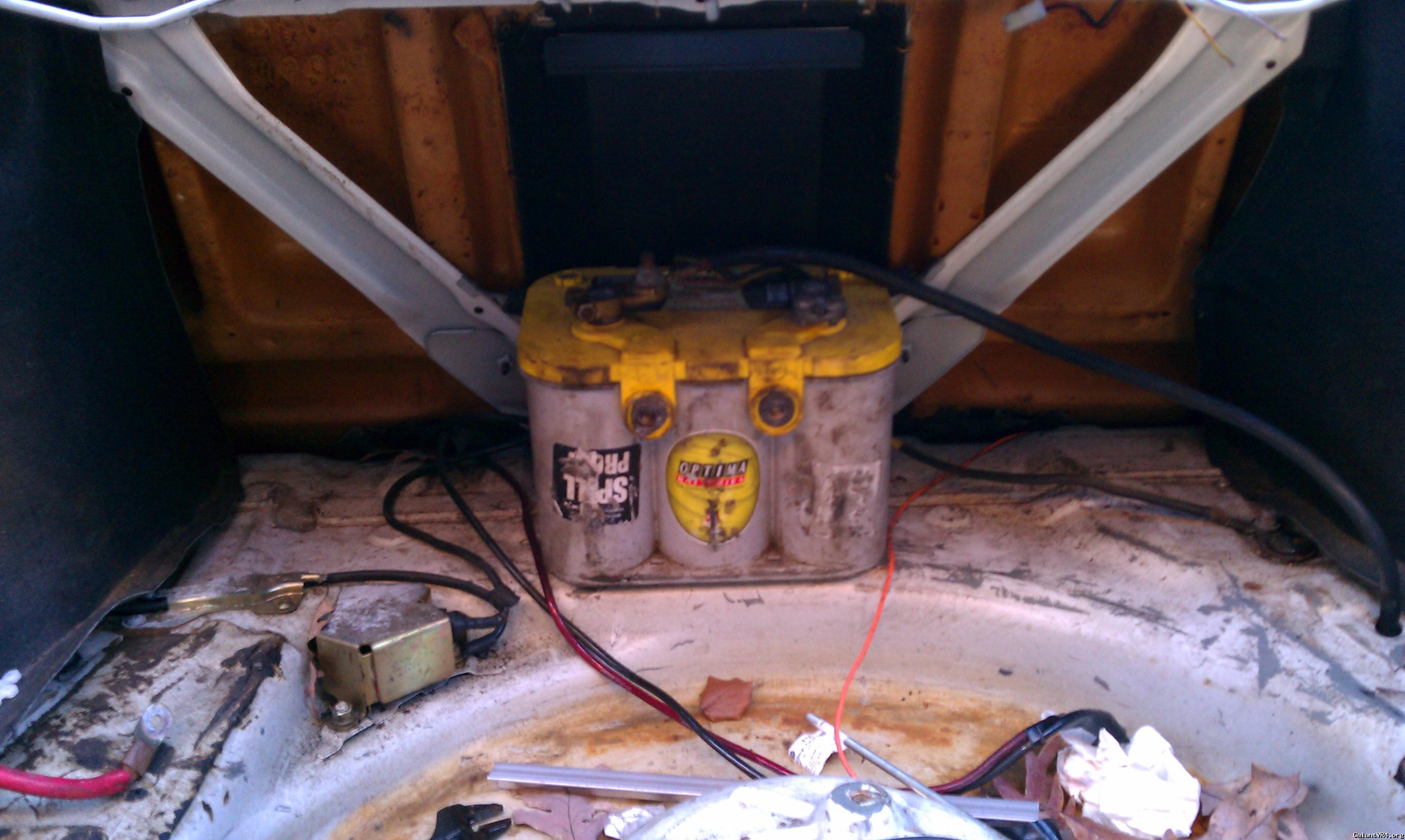

Also I finished (for now) my rear battery mount.....its not as elegant as i'd like but then again I am on a budget and it only cost $3 for battery tie down rods (from autozone) and I had the aluminum in my scrap bin which I just drilled two holes through. The two "J" hooks went into stock holes located in the trunk (so no drilling needed)....however in the future I might drill a hole for one more clamp to hold down the bottom front of the battery, just to make sure it will be completely secure.
