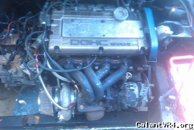

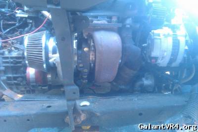

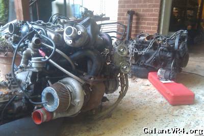

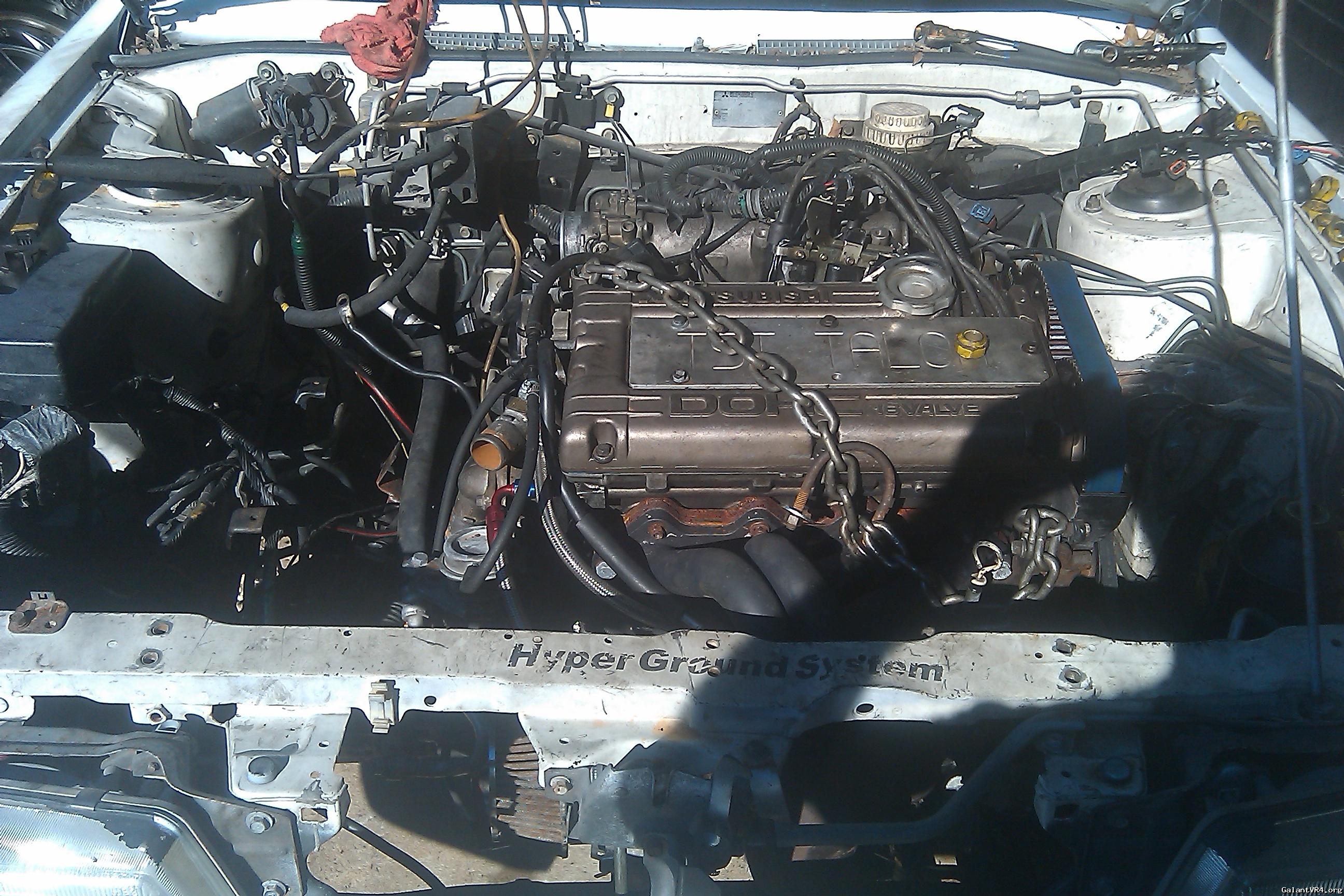

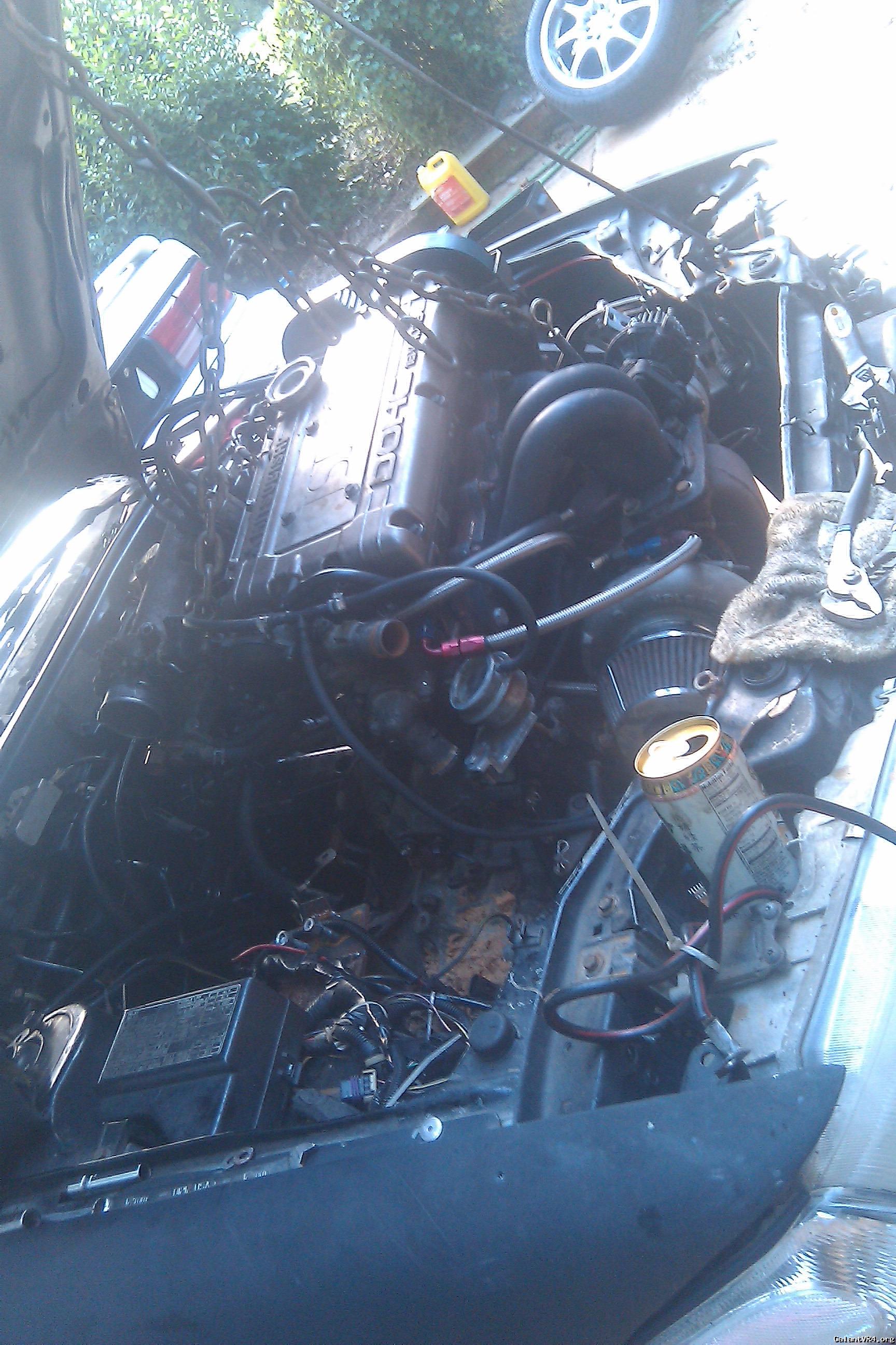

I thought i'd share a little update, I have almost finished pulling the motor out of my eclipse to go into the gvr4....I plan to have it out today and then clean it up over the next few days and hopefully install it next weekend. Here are a few pictures that I took while it was in my eclipse:
Yay it's out :-D

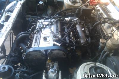

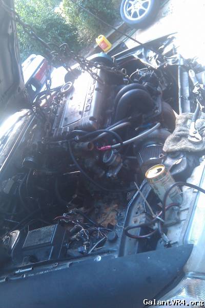

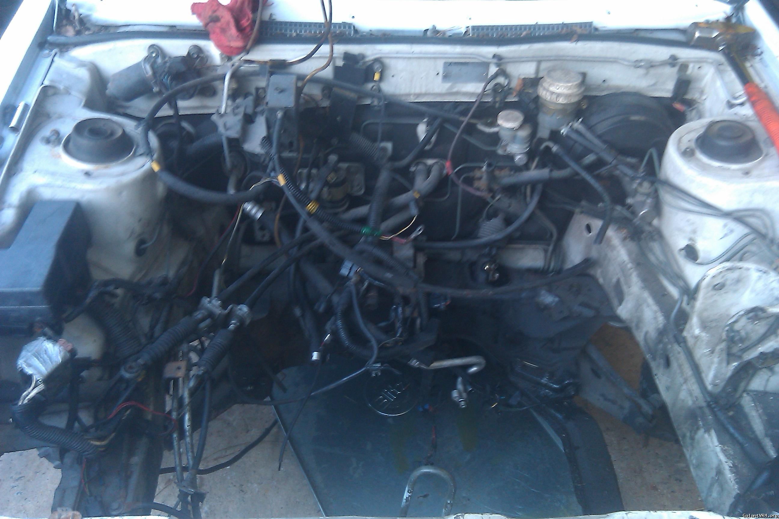

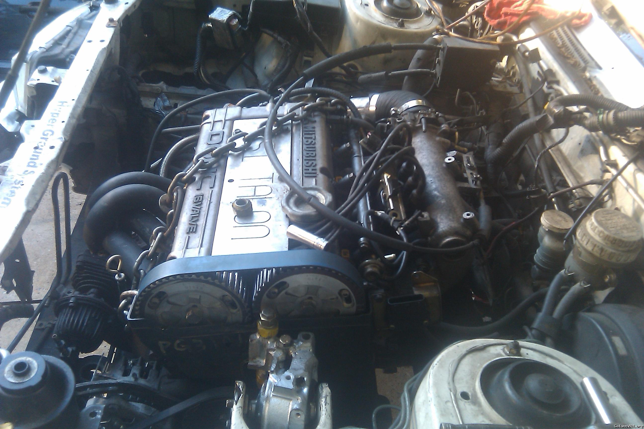

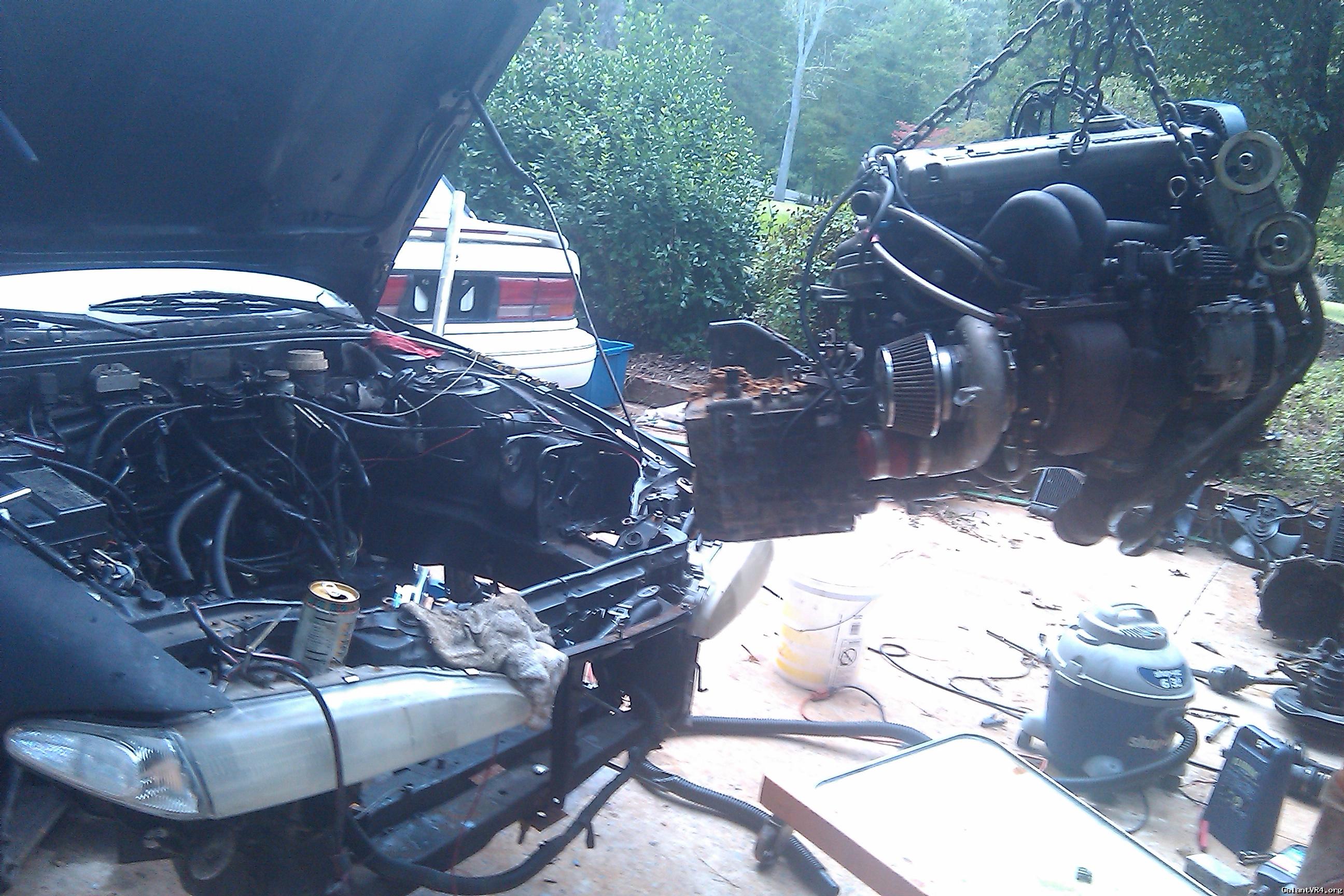

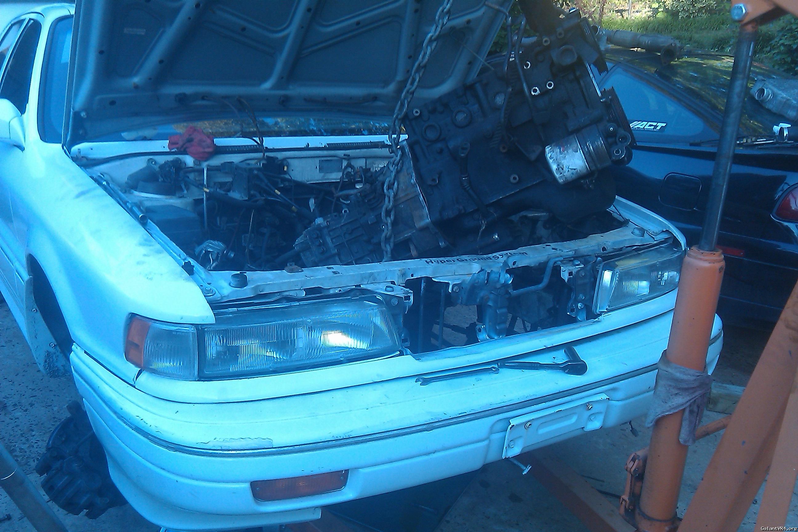

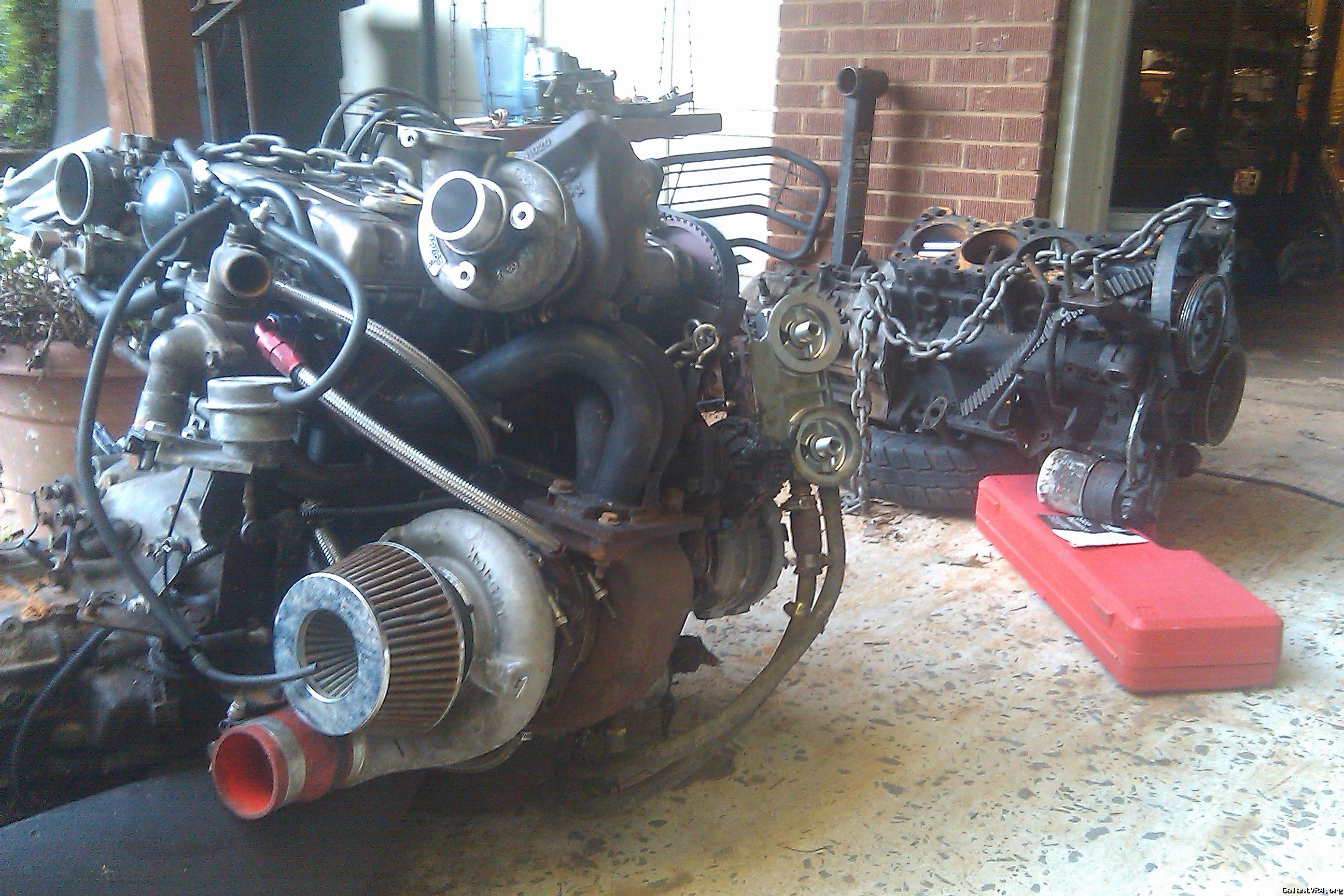

Another update, I was finally able to free myself for a couple of hours and pulled the motor out of the GVR4......noticed a few "odd" things....but over all after a little money is put into her I think she will turn out to be a nice reliable ride /ubbthreads/images/graemlins/smile.gif

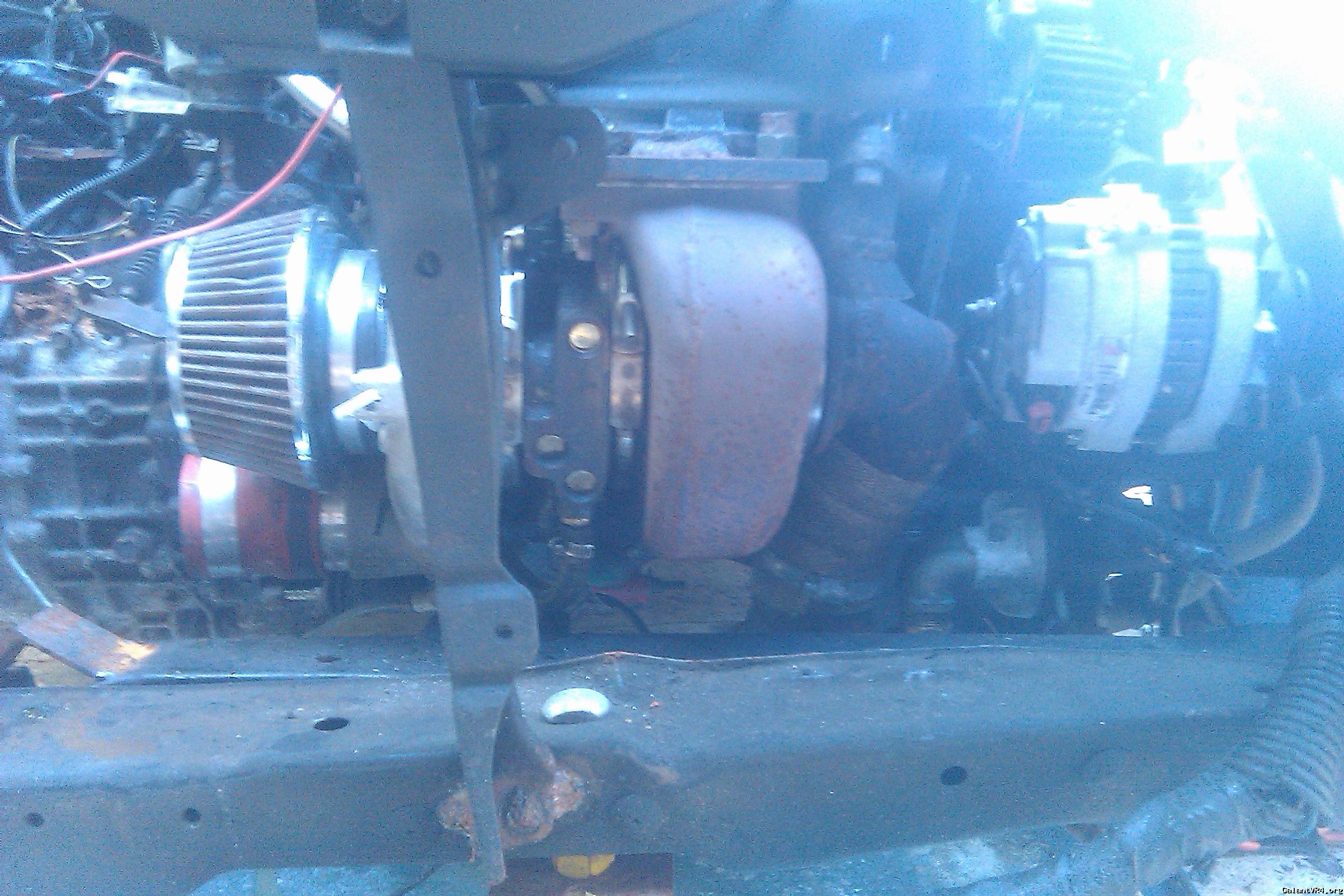

Btw in the last picture I placed a 14-b ontop of the ex. manifold just for size reference against my holset /ubbthreads/images/graemlins/smile.gif
That holset could eat that 14b and sh*t t25's. /ubbthreads/images/graemlins/devil.gif
Dbossman: Haha...nice :p

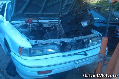

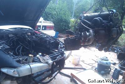

Update, I have the motor mostly into the car car.........about to go put the other mounts on it........I swapped my front suspension from my eclipse over since it had better shocks.........I also converted the front to 5 lugs.

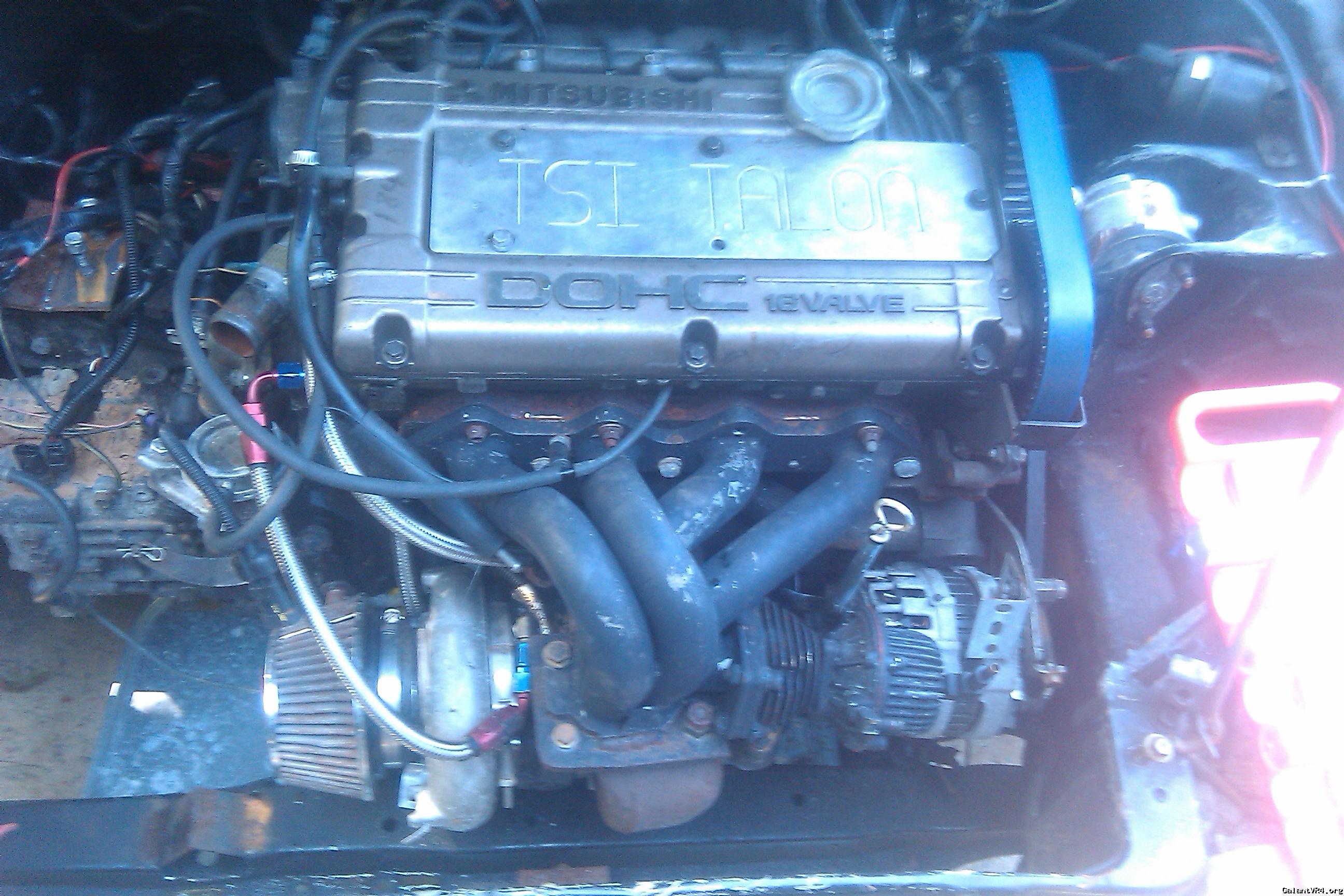

Update: I dropped the motor in today and hooked up a few things (front axles,xfer case etc). I have a few pictures I will upload below, however what is odd is that it seems like the driver side motor mount I had in my eclipse puts the motor at a odd angle in the galant....I wonder of my eclipse (or maybe this car) was slightly bent somewhere when I made the mount? Anyhow I have it temporarily mounted (upside down) to hold the motor up while I bolt a few more things in place and then I am going to make a new one, and possibly a new rear motor mount as well. Does anybody happen to have some factory specs on the motors location relative to everything, mostly how much it should be rotated forward relative to some point. Also I am wanting to retain power steering and AC even though I dont have the pump/brackets/condenser for either so I am going to start sourcing out those part. I saw one post from a few years back about a guy using a electric powersteering pump off a 2g MR2.....but it never stated his success or failure, is anyone familiar with this mod? Also I noticed when I started swapping some of my suspension over, the galant has 4 mounting holes for the shock (at the top of the shock tower) where as the eclipse only had three.........any idea why the galant has an extra hole?

Did you use the motor mount brackets from the Galant motor?
The front mounting bracket is specific to the Galant.
Using the t/e/l mounting bracket may make the engine sit at an odd angle.
