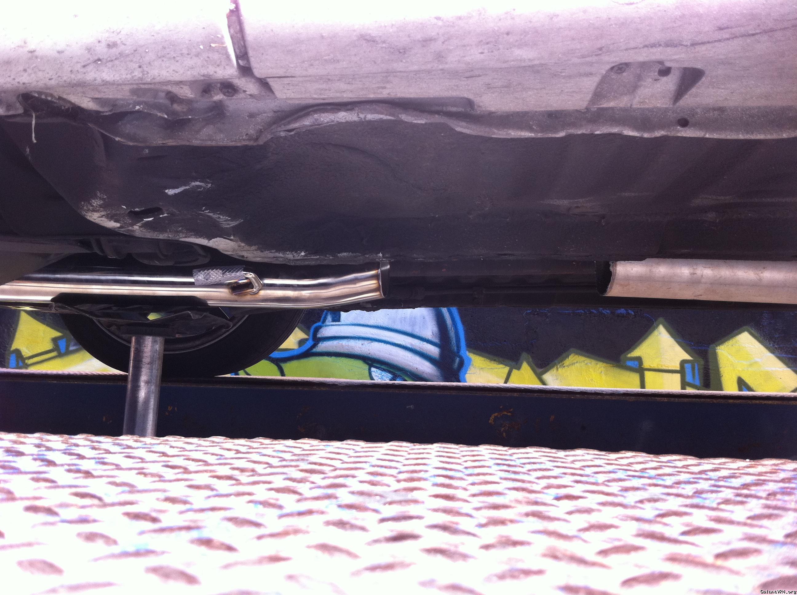

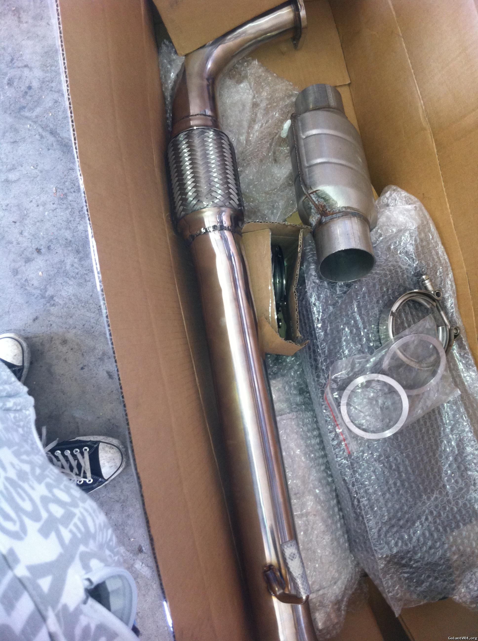

So i have a 2.5"-3" straight pipe, one piece with one resonator and a ebay muffler, Well my mother(yes my mother) told me its to loud and im waking up neighbors and her, So I have to change it. I want the most out of my setup but I want to go quieter, any suggestions? I am planning to order a DP off ebay. a ALL Flow cat from siliconeintakes.com and a Vibrant 3" single tip flat black muffler. Vband everything and call it a day. OR I want to get a E-Cut out. What is everyone else running, and is it quiet or Partially loud? Pics would be nice as well. Thanks
-Shane
Sorry no pics, I fail at the internet. But my setup is essentially a 2.5" dp, 3" test pipe, 3" cat back to a magnaflow "box" muffler, with dual outlets to appear more stock. I have received no complaints from the neighbors, and it gets quieter if I put the cat in. The P/N for the muffler is M12198, or just 12198 as I believe the exhaust shop *might* have added the M for their own purposes. It is more like what you'd expect a muscle car guy to use rather than a tuner coffee can style muffler. I have received many compliments on the sound of my car, and even tricked a occifer into thinking that he must have confused the roar of my dump tube for a different car because the exhaust itself isn't nearly that loud.

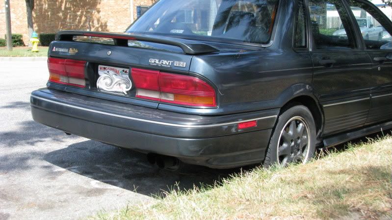

I have a full 3" with a magnaflow 3'(straight, no baffle, oval body center in/side out) & tapered single magnaflow tip with a high flow cat. Is my car audible Yes but loud no. cops don't even give me a second glance & I think the single tip makes it look even more unassuming. It will get real loud when you're really on it but it's mellow the rest of time.

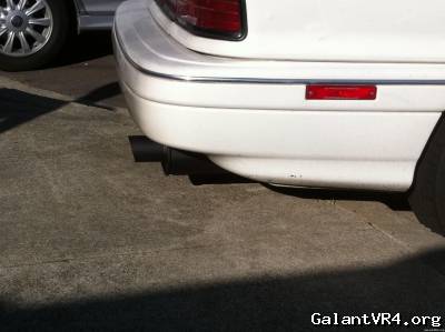

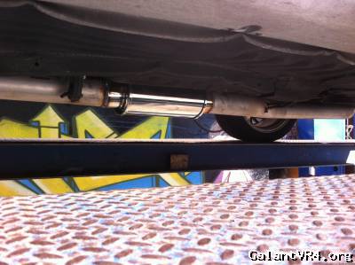

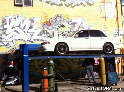

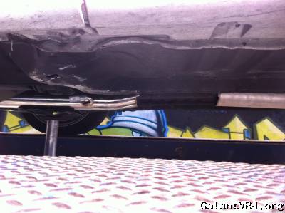

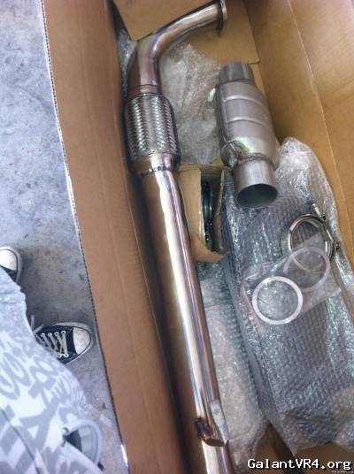

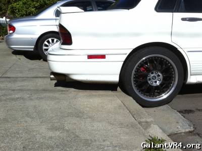

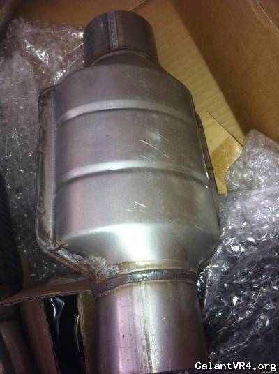

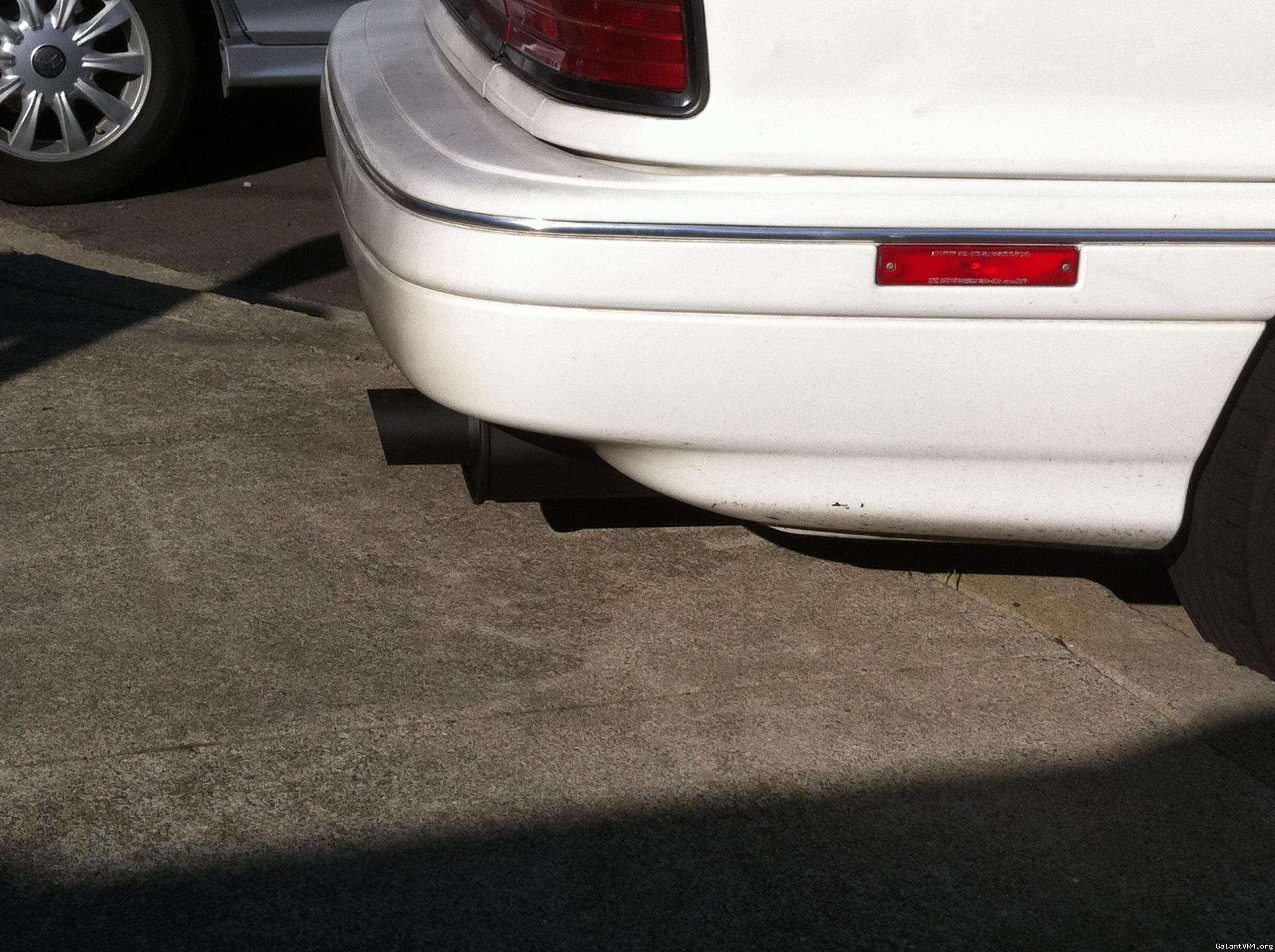

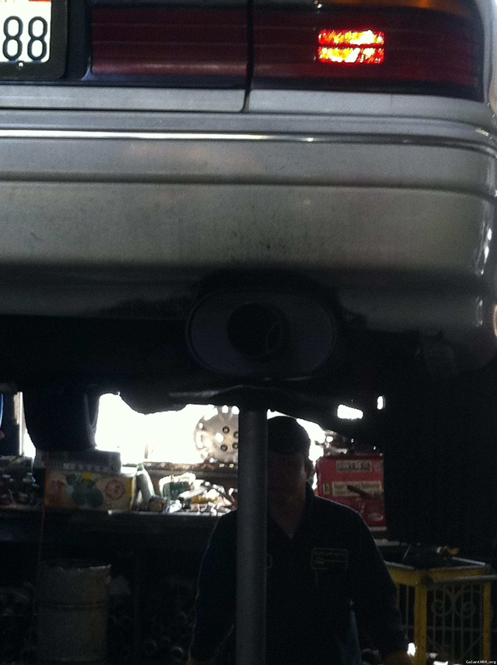

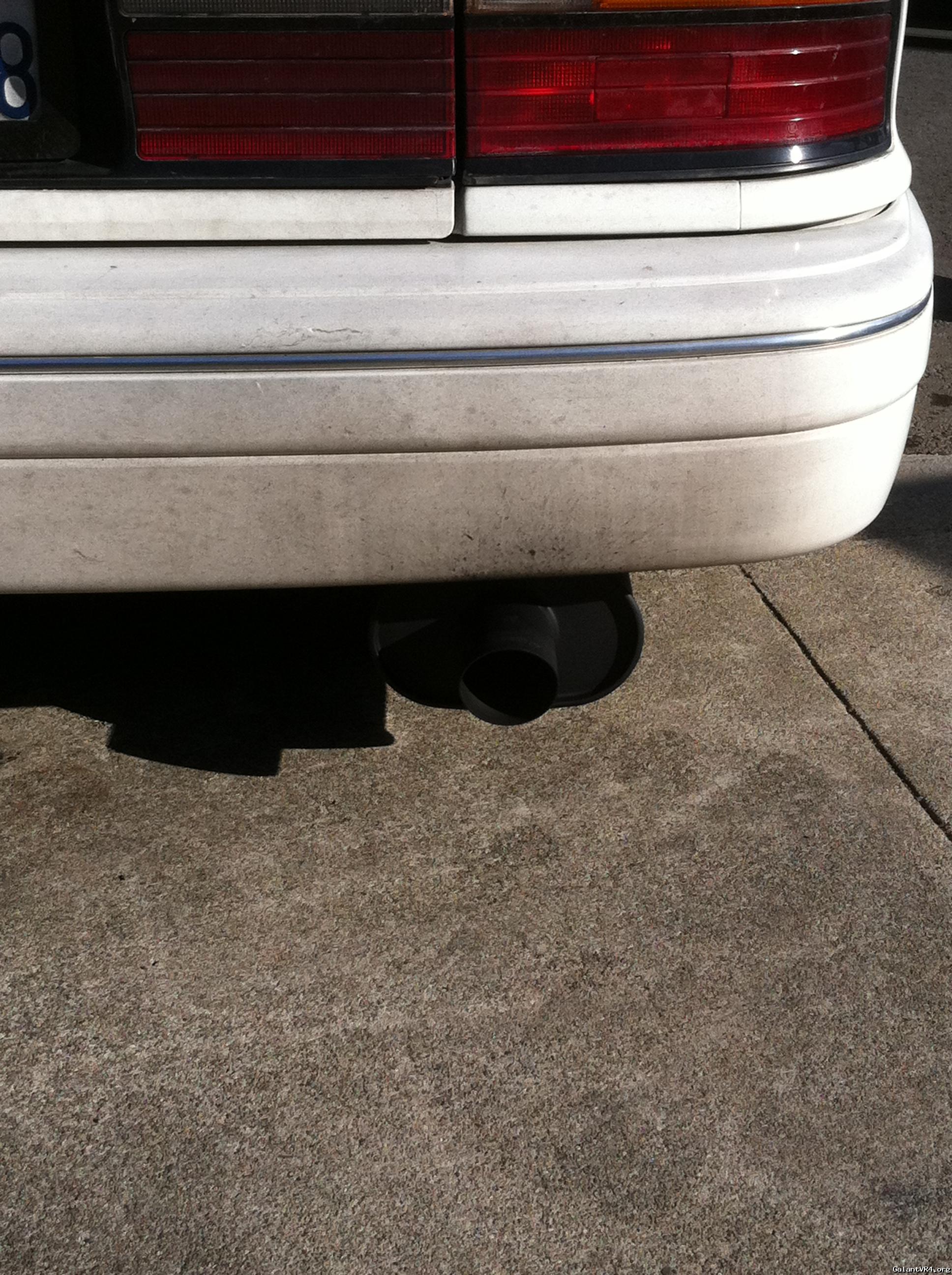

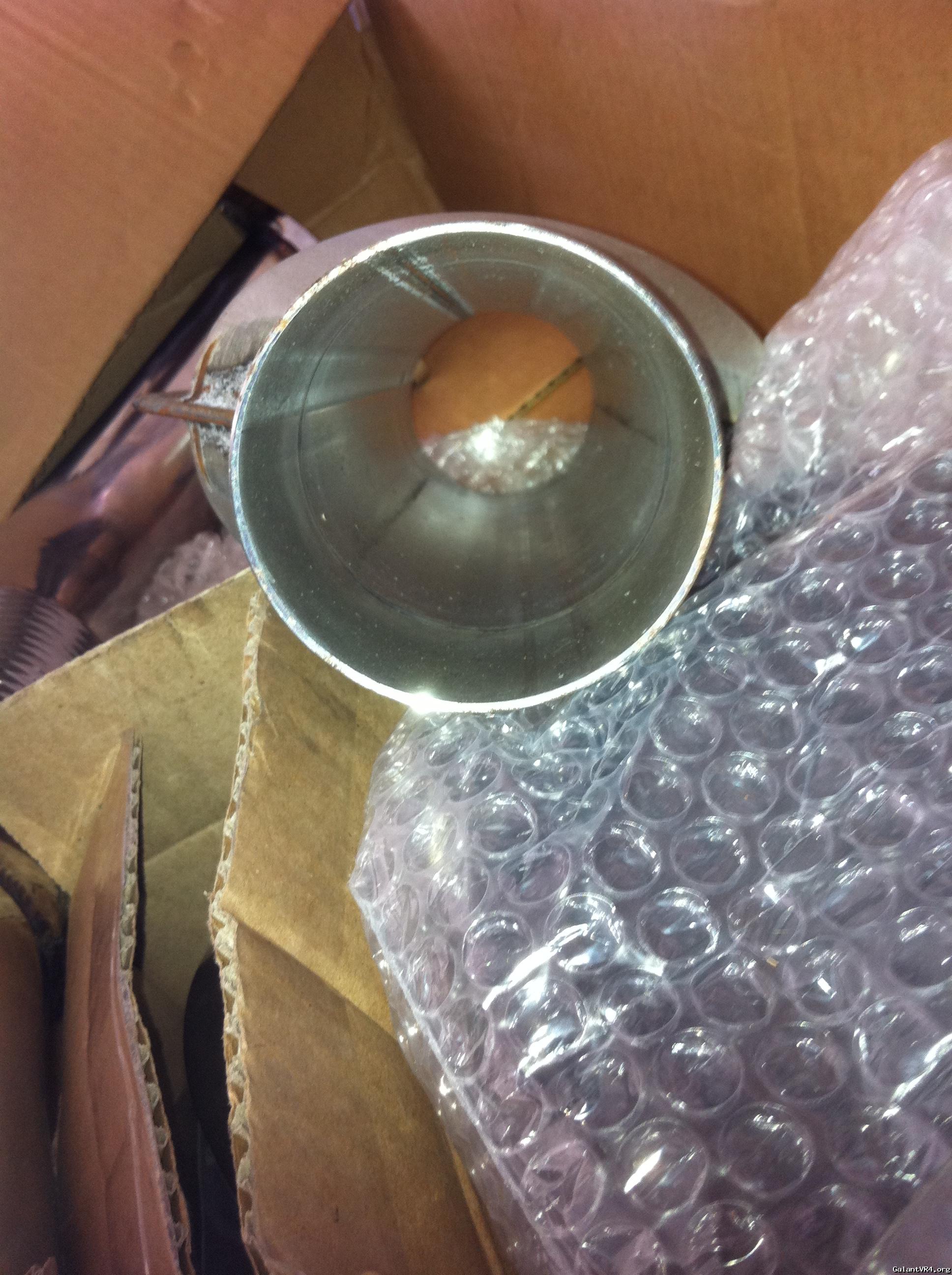

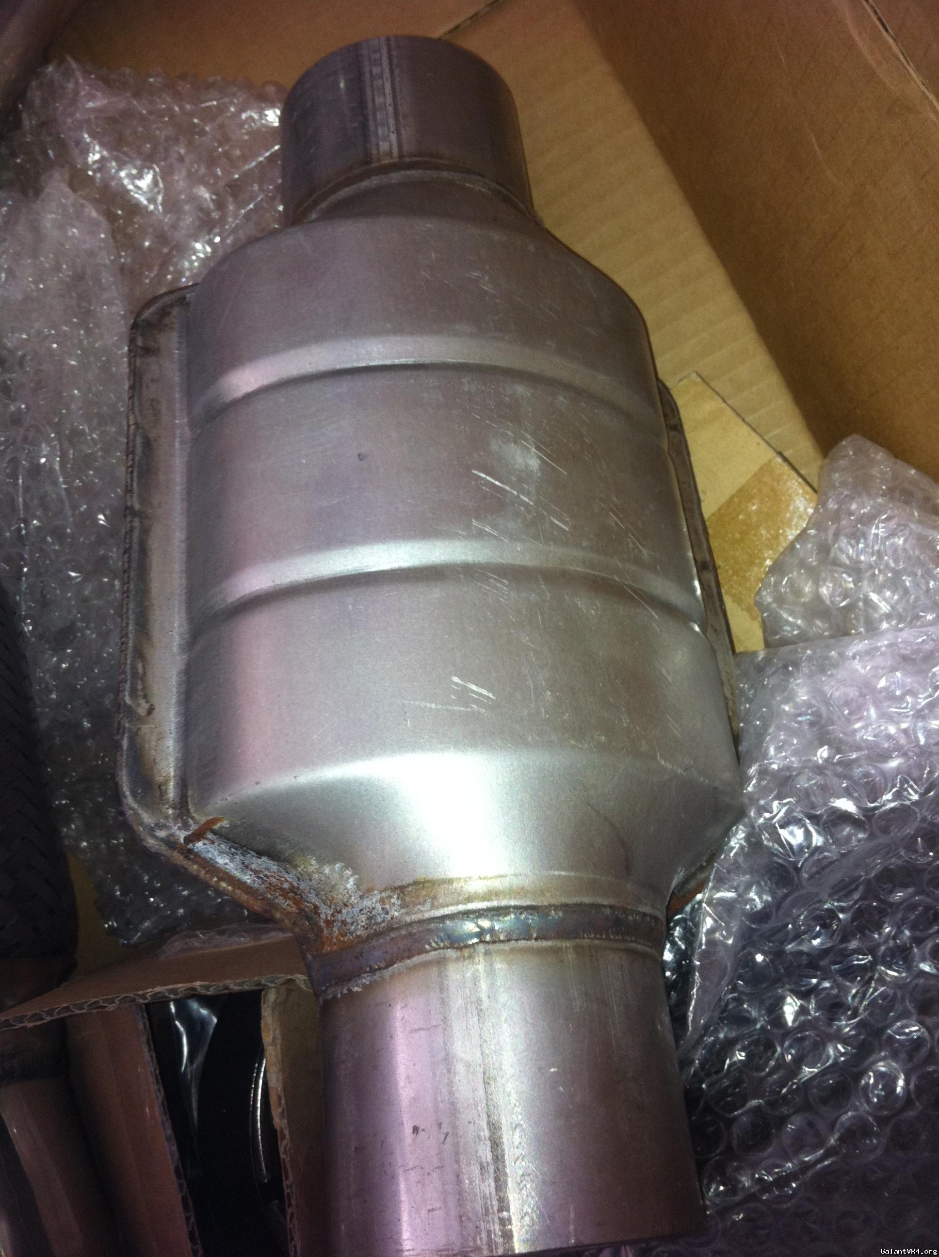

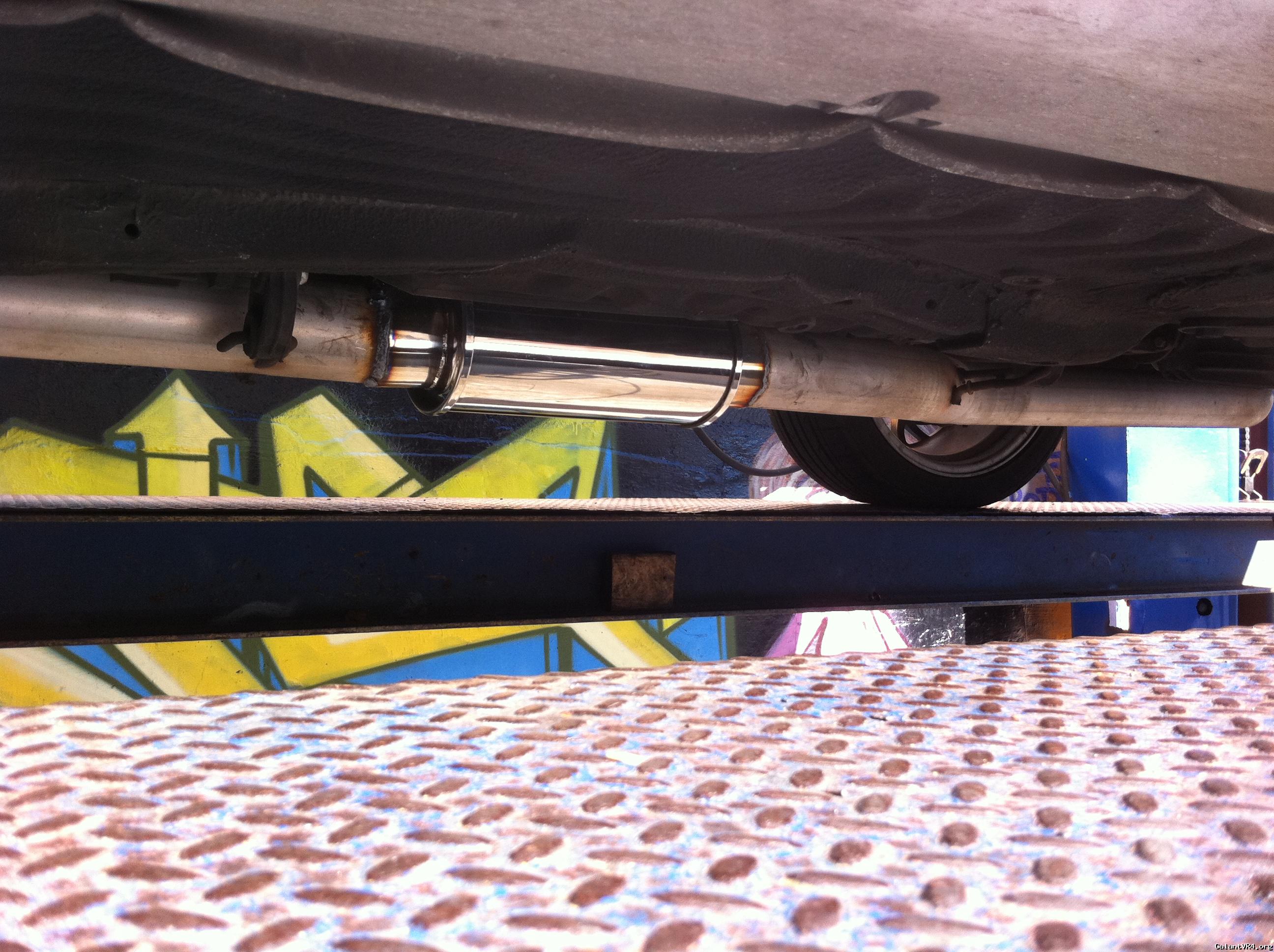

So this is what I went with, Installed and all was $155, welded the muffler on, rewelded a new resonator on and had to v-band the dp to the fake cat, and to the rest of the cat back. Not too bad, all in all it was about $550 with parts and labor, but im very happy with the way it sounds. nice and quiet at idle, and DD it doesnt drone. Conversations can be heard in the cabin aha.I will get a video clip later on.
Old Muffler:
New components, and on the car:
SouthCaliVR4
Jul 31, 2010
984
North county San Diego

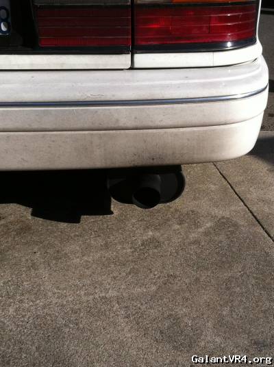

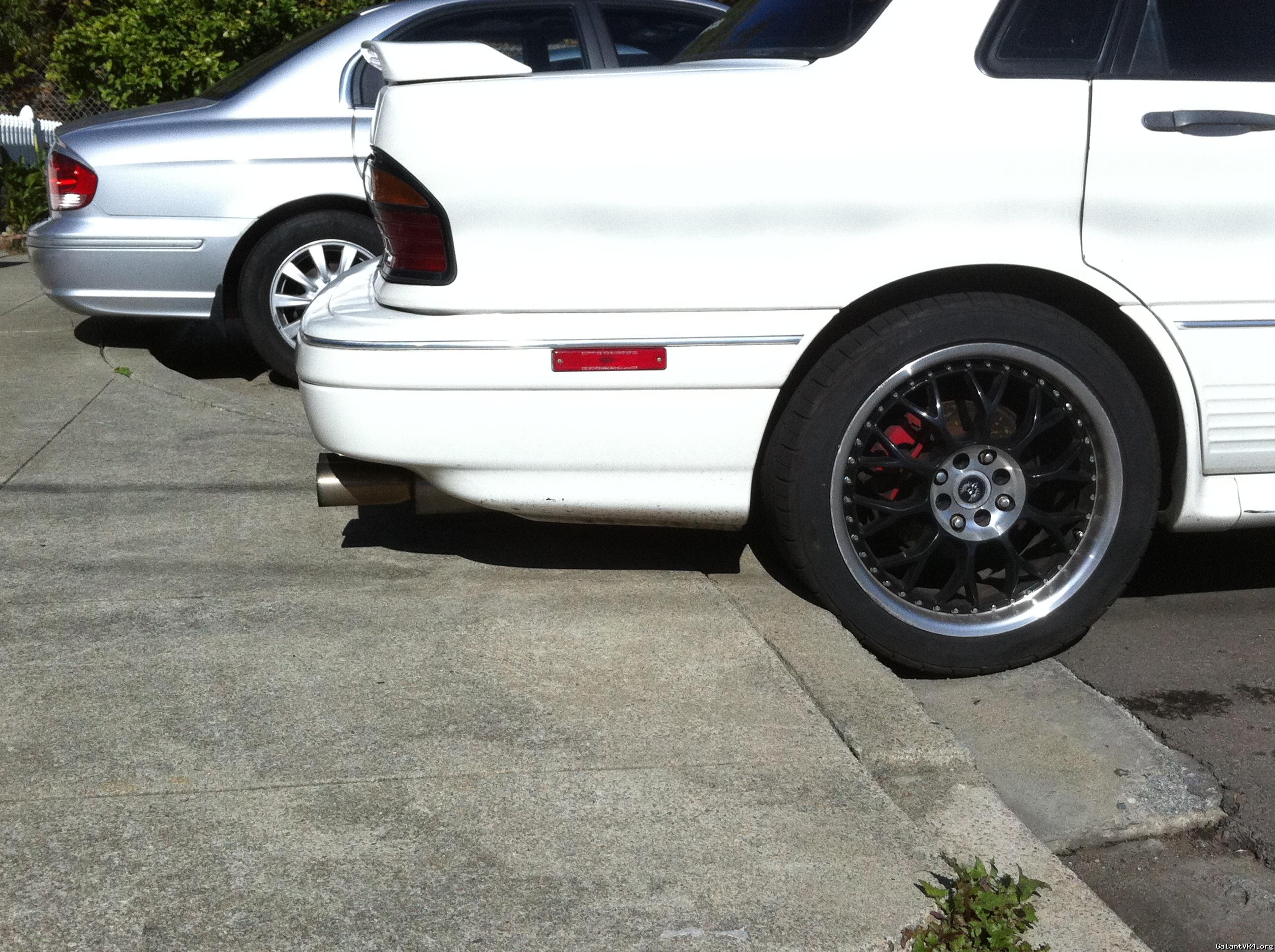

Only thing I would have done different would be to have the muffler tucked up under & ran a tip to get it out from under the bumper. Mainly cause that's how mine is & I still scrape the tip from time to time, I'm thinking you're gonna scrub that muffler pretty good. Looks good & if your happy with it that's what counts!

Is that a Vibrant muffler? If so, there should be plenty of room to tuck it under more. You'd have to weld a ~6" tip on it to get it to sit inline with the rear of the bumper.
SouthCaliVR4
Jul 31, 2010
984

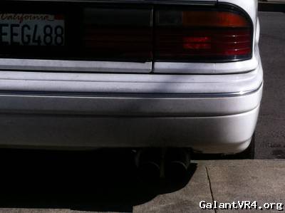

Mine is that size & tucked right up there & yes, I do have a six inch tip ( /ubbthreads/images/graemlins/rofl.gif /ubbthreads/images/graemlins/rofl.gif"six inch tip") in order to come just flush with the outermost part of the bumper. It actually looks pretty decent & no chance of staining or melting the bumper.

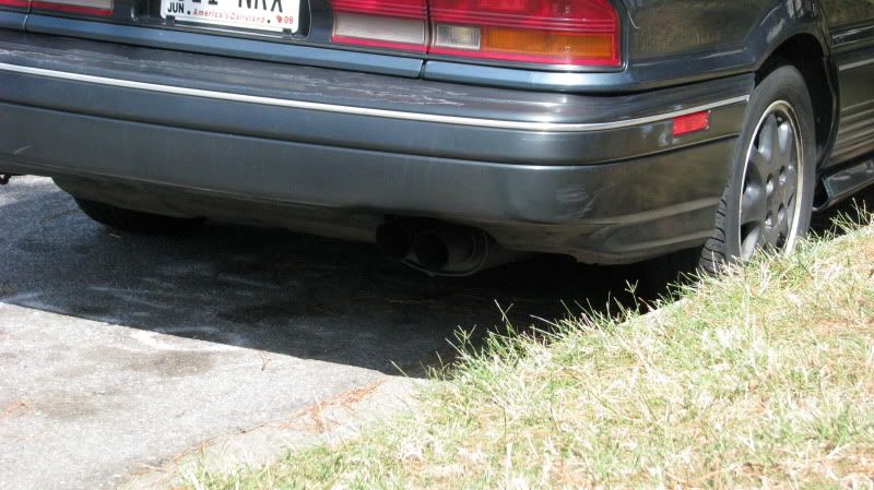

raptorWagon
May 17, 2007
2,829
Oak Harbor, WA

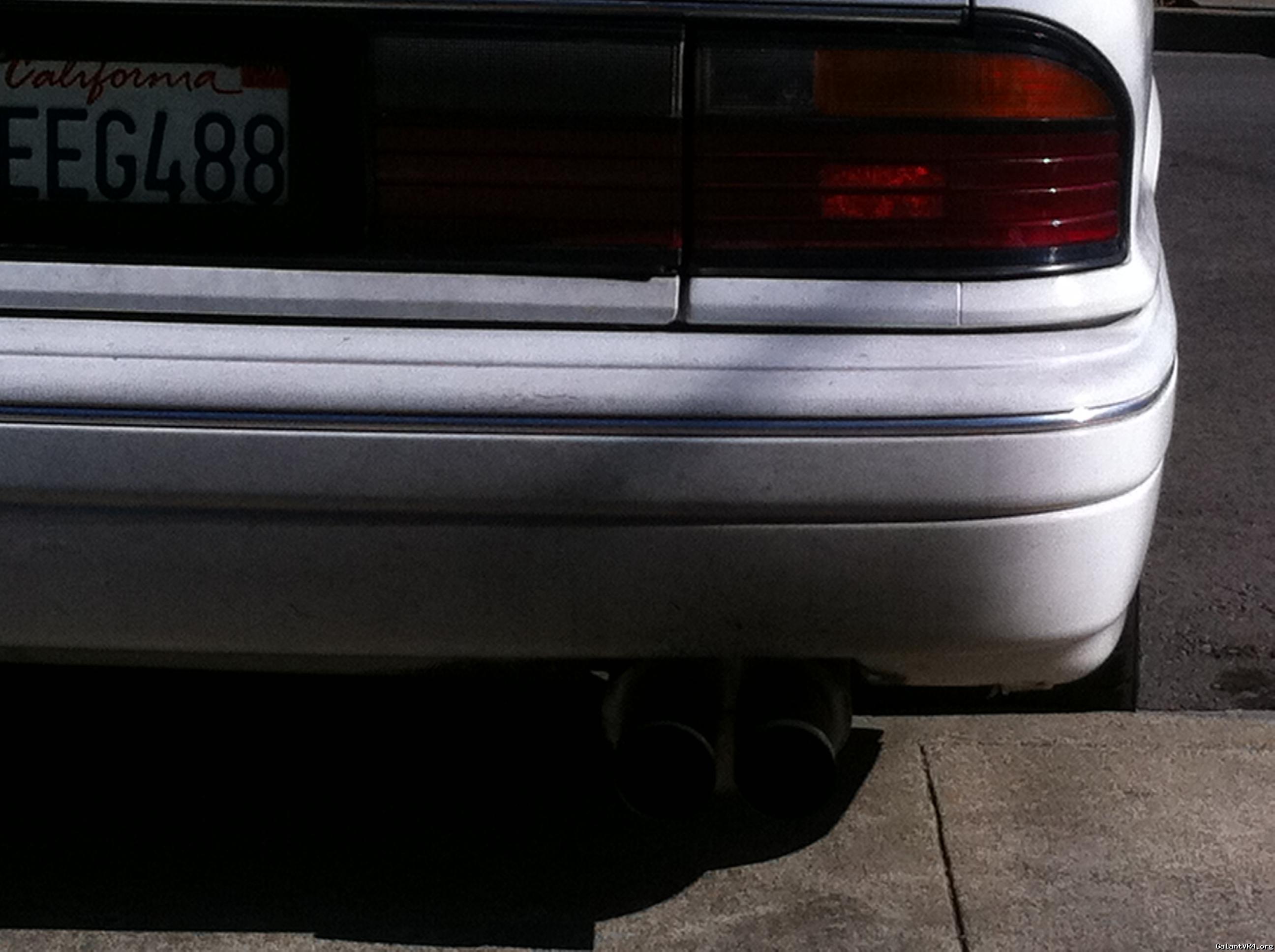

I have dual tip version on mine and left it tucked up underneath, everyone thinks it stock till they get up close /ubbthreads/images/graemlins/smirk.gif.
