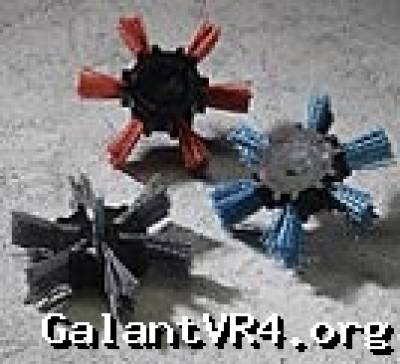

Nylon abrasive wheel. The pic is the only one I could find on line with a quick search, but they sell a Nylon wheel similar to this at Menards for around $10. The Nylon bristles are excellent, and are "supost" to last up to 10x longer thatn steel, but the biggest plus, is they clean very smoothly, and you can run them in your drill. Nylon abrasives are widely used in machine shops and fab shops for deburing engines and componets and finished product.
Personaly I like them.

Yeah I used wire wheels on my stock integra exhaust to get off all of the rust than I painted it with exhaust paint. That nylon wheel seems like a good idea but I'm wondering how strong those are...if they will do the job?

They are pretty durable. The nice thing about them is they dont gouge the metal like the steel wire wheels. They give it the brushed look.
