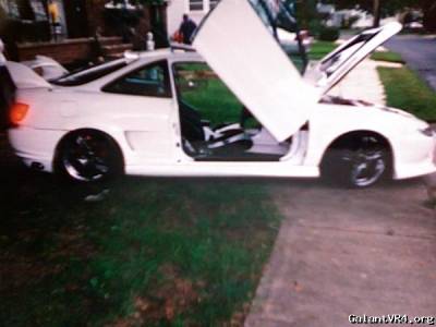

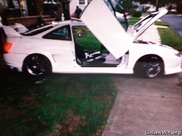

a prime example of a show honda heres one i built many years age it won several big compitions includeing funk flex nopi hin and many others
it is a 1995 acura integra
fully built ls v-tec turbo itrous
black and white leather iterior
acura cl headlights
honda s2000 tail lights
acura nsx side cuts
shaved handles
lambo doors
lanex windows
ect,ect,ect...
this car had well over $75,000 in to it and it was no trailer queen it was driven to every show/event
