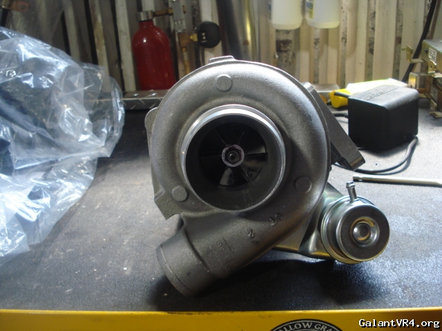

as for the turbo
Compressor Wheel Diameter 54mm
Compressor Wheel Inducer - 2.123
Compressor Wheel Exducer 3.000
Wheel Trim 50 Trim

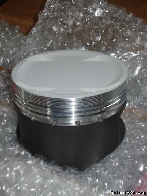

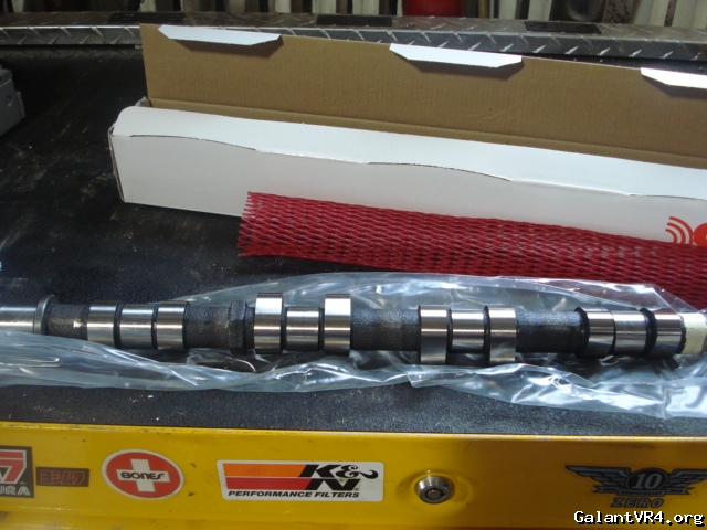

didn't see the point in taking both out of the box. there is also a pic of only 1 piston does that make it a 1 cylinder.
