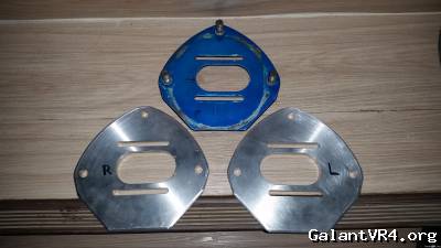

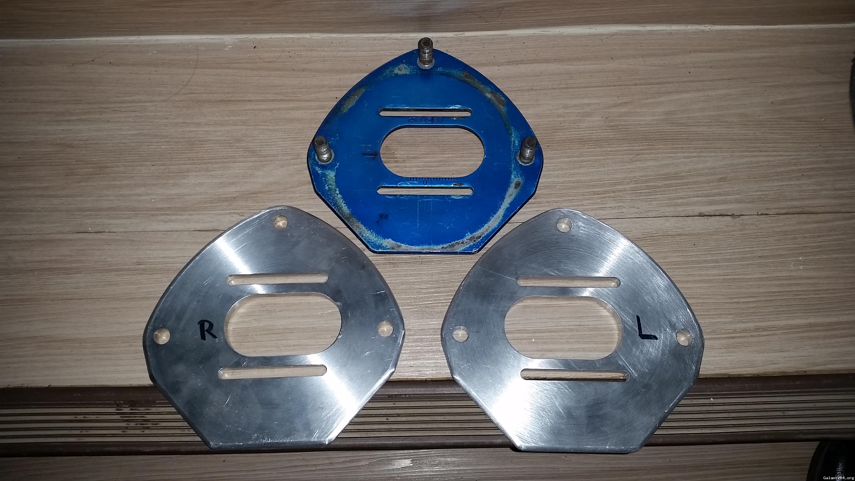

With a misalignment spacer and a 2.5 in spring top I think it could be set up. The piece I showed was engineered to fit on a car too right?
AllanL
Aug 4, 2008
301
NV
universal camber plates
i'm sure those center pillow bearings will fit in here...Cusco's remade for the E3x Galant
if you need a drawing, I could probably get some to do it...
