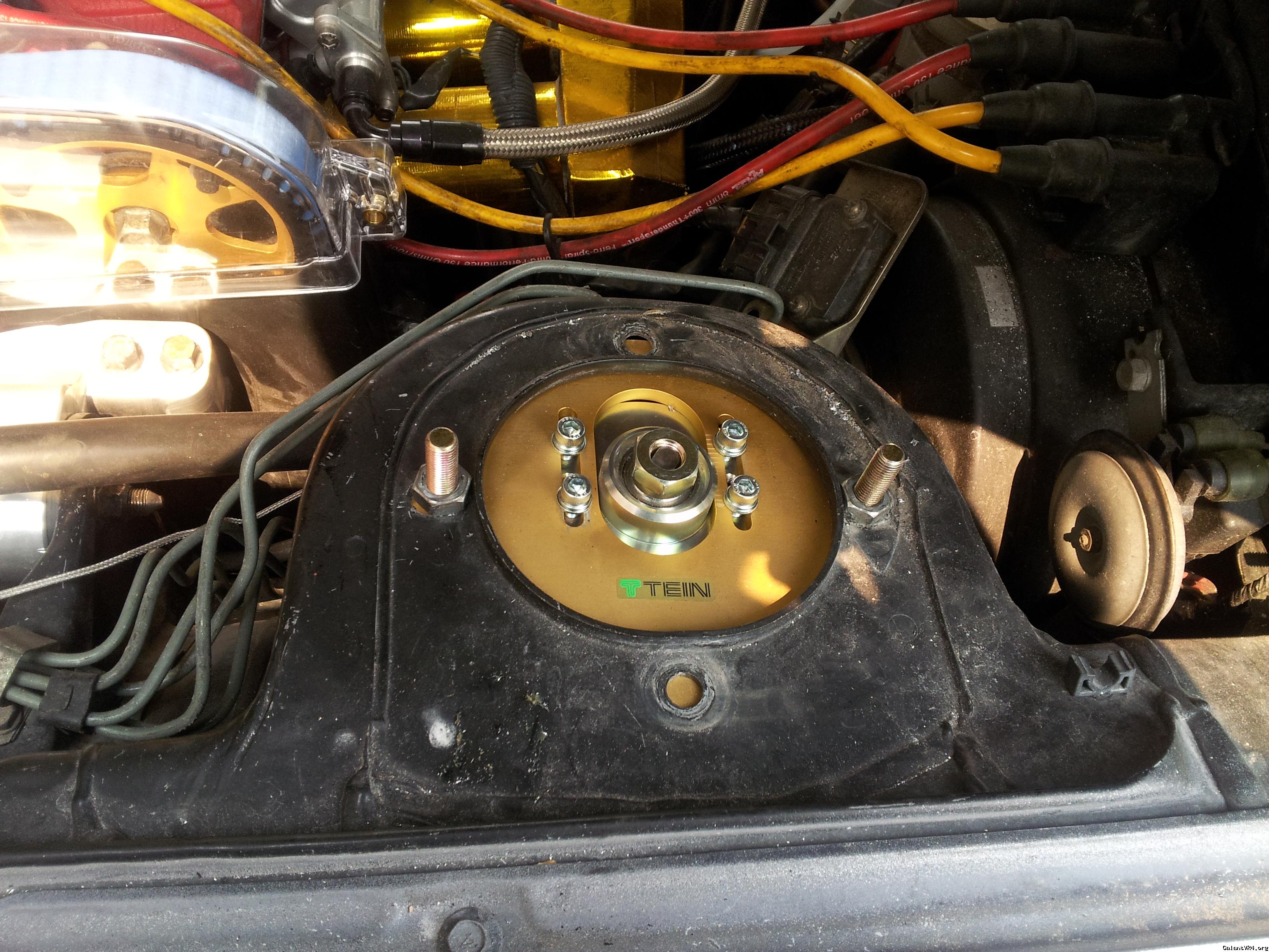

I have Tein camber plates on my evo suspension. They are the stock GVR4 replacement plates and work good. I think they raise the front a little bit though.

I have stock evo plates on mine and a set of evo teins in a box for it. All you have to do is drill two holes in the strut towers. Did a thread on it years ago.

okay so the tein camber plates for an evo work on the evo struts? I dont mind drilling some holes, as i did that on my 1g that had evo suspension. I saw road race had a set but they want like $285 and i just dont feel like spending that much on some camber plates.

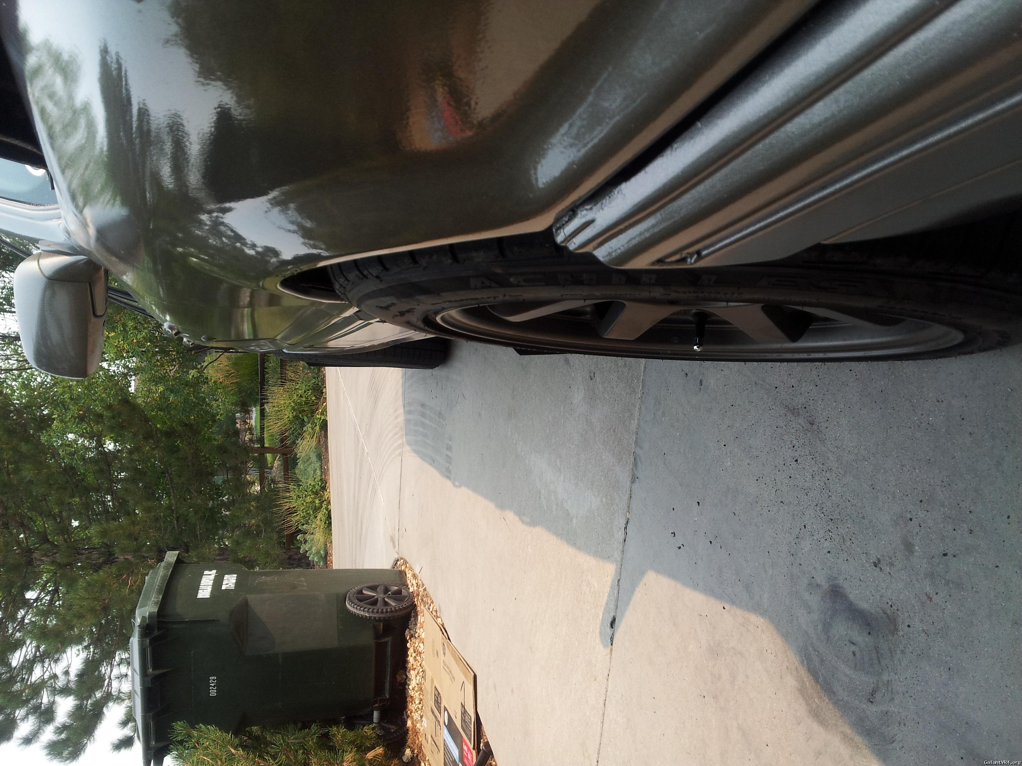

A little update. I purchased evo 3 tein Camber plates new for 125$ from ebay. They bolted right up to the evo struts no problem. The only difference is the are two bolt strut mount but with a drill they can fit very easily. Between that and slotting the lower strut hole i got my Camber how i wanted.
I will be machining a spacers with the lathe so that the nuts sit up past the lip, but overall for the price they work great.

That is what i was running before. i slotted the holes on the strut as far as i could and still had positive camber.

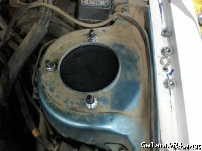

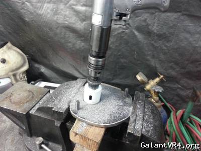

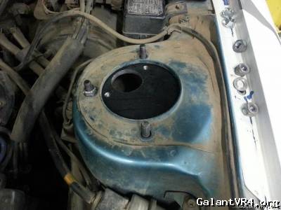

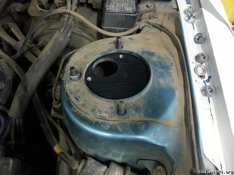

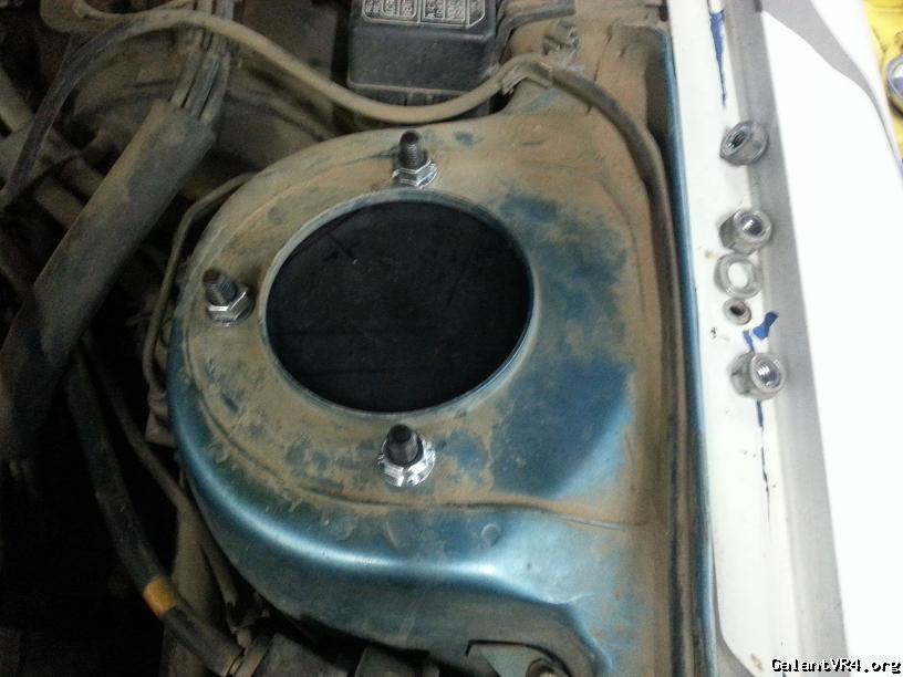

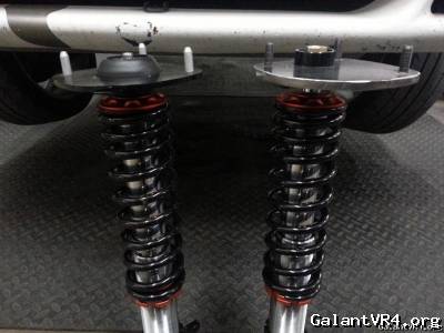

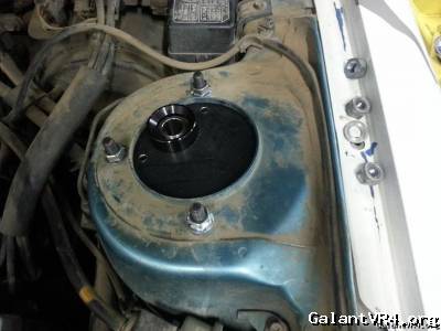

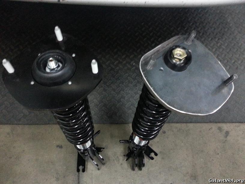

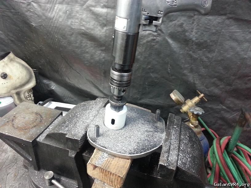

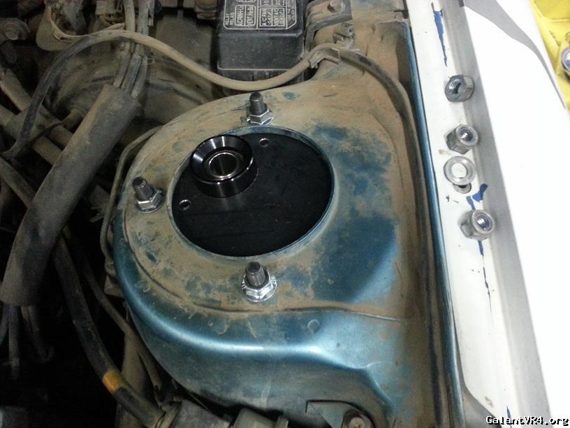

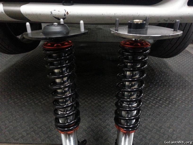

I was not satisfied with any of the off the shelf camber plate solutions for our cars so this week I built a set of plates. I designed mine to induce as much caster and negative camber as possible. Since our cars are so challenged in this area I found it pointless to make them adjustable as I know I would have them set at max all the time anyway. I built this first set for my rally cross 1G and will be building another set for my GVR-4 rally car once I shake these down. Here are a few pics of the process I took:
Peter
