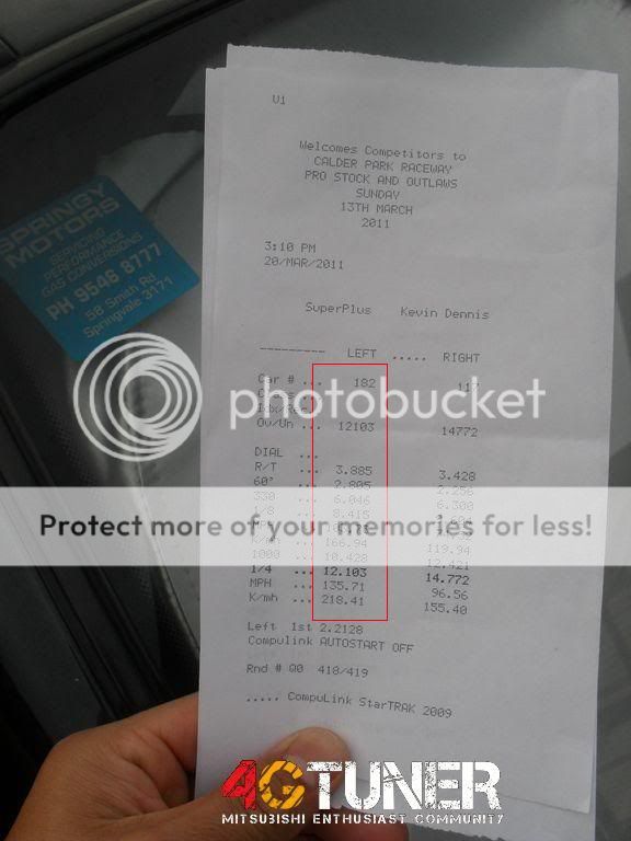

UPDATE!
I have achieved a new pb!!
Here is a quick run down.
Car:
pump 93 fuel - full tank
Drove it to the track (1 hr away)
Drove it home
Tyre pressure 36psi (street pressure)
Run down the track as is on the street except for the added helmet and number plate block off.
Roll cage added since last heathcote run (11.08@132mph)
Manual shifting without any flat shift ecu - switching used
No launch control used
1st run -
no launch
2nd run -
no launch with dry ice
3rd run -
light launch with dry ice
I am very glad that the car is doing what it should be doing.
Still plenty more in her.

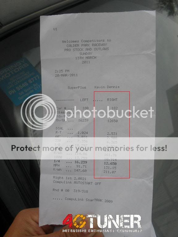

/ubbthreads/images/graemlins/worthy.gif 10 SECOND CLUB on street tires. Congrats
You ran a 12 second run at 135.71. /ubbthreads/images/graemlins/jawdrop.gif That's a low 10 second mph not low 12's.
Man a set of DOT slicks all around will be nasty. You got a mid to high 9 at 140+ with the right tires and car set on kill.

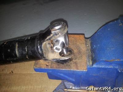

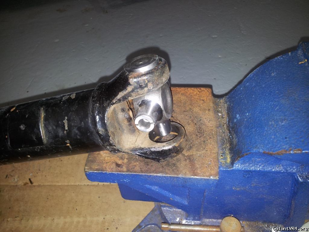

I don't think that's ment to be dragging on the ground like that /ubbthreads/images/graemlins/ooo.gif /ubbthreads/images/graemlins/blush.gif I guess those drive shaft loops are not so stupid afterall /ubbthreads/images/graemlins/ooo.gif

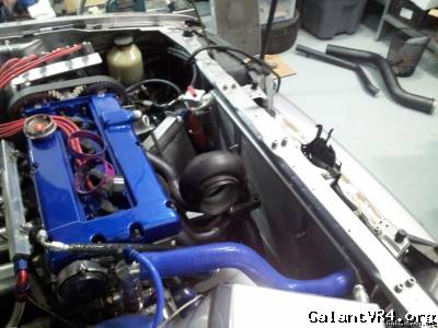

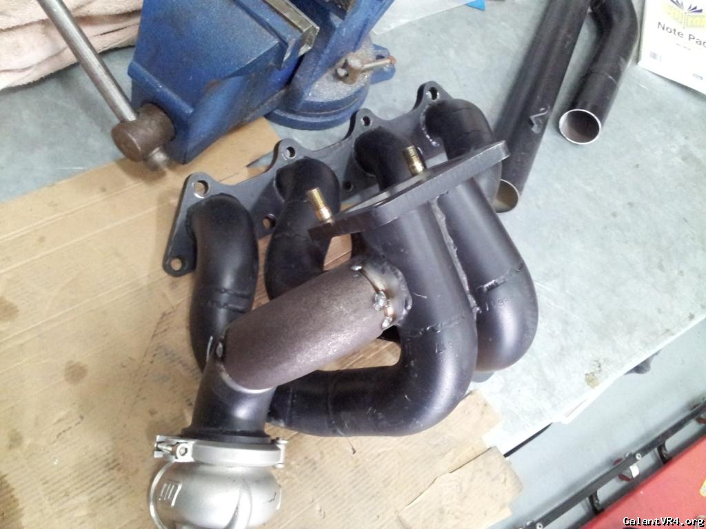

I thought I'd update this thread....

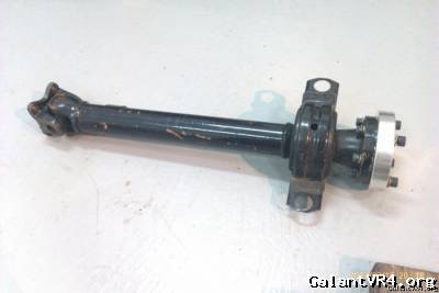

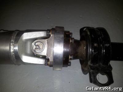

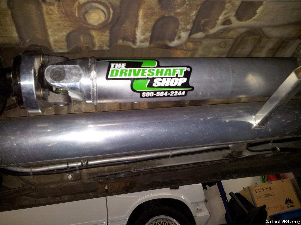

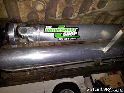

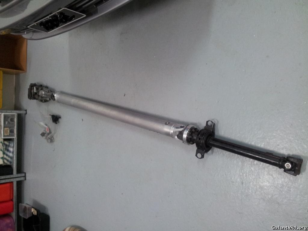

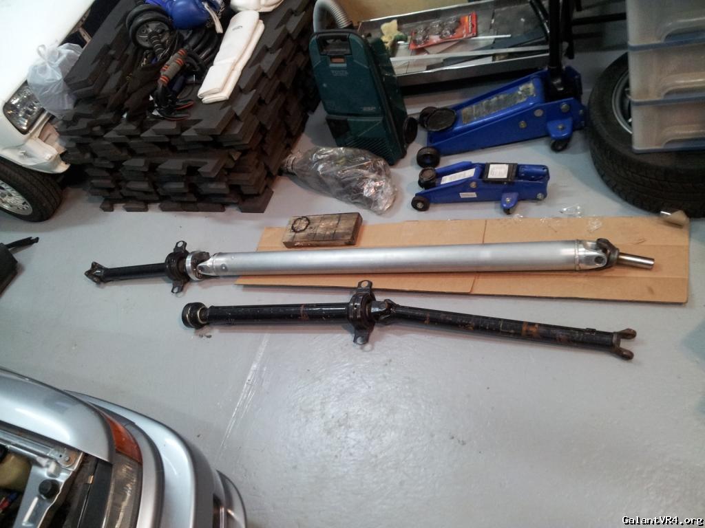

So since the VR4 has been sitting since breaking the driveshaft.. I decided to hold off and buy a DSS driveshaft..

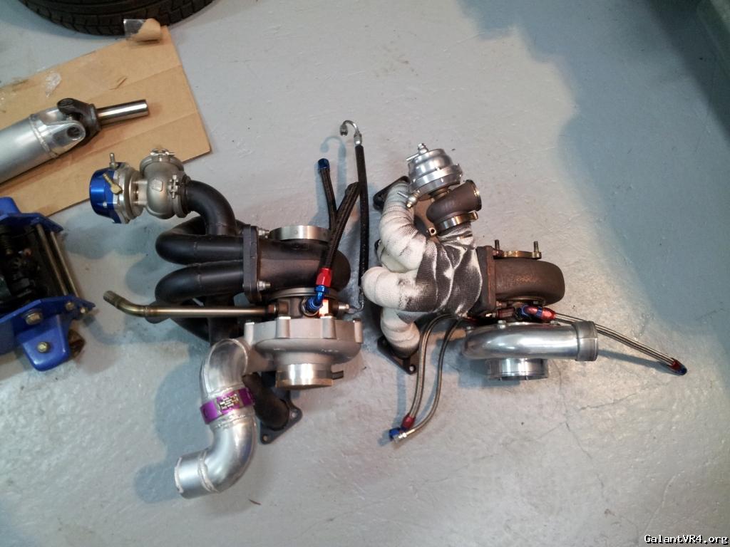

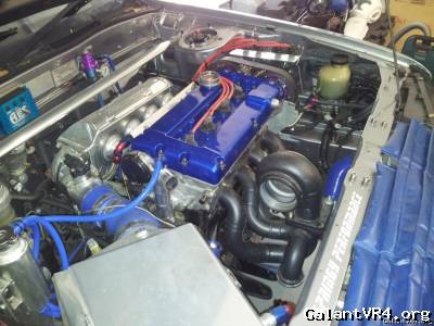

I have also decided to bolt on the spare turbo setup since I was offered a good price on the GT35R setup I had.
I honestly don't know if I made the right move BUT in saying that, I'll never know if I don't try..
(I've recently moved into my new house and also my wife just had our first baby.... lots of things happening... VR4 is being neglected)

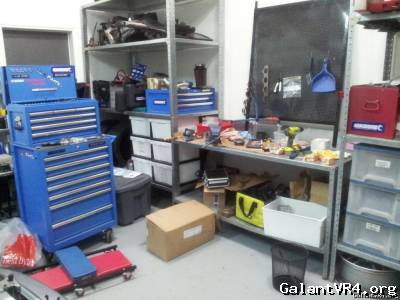

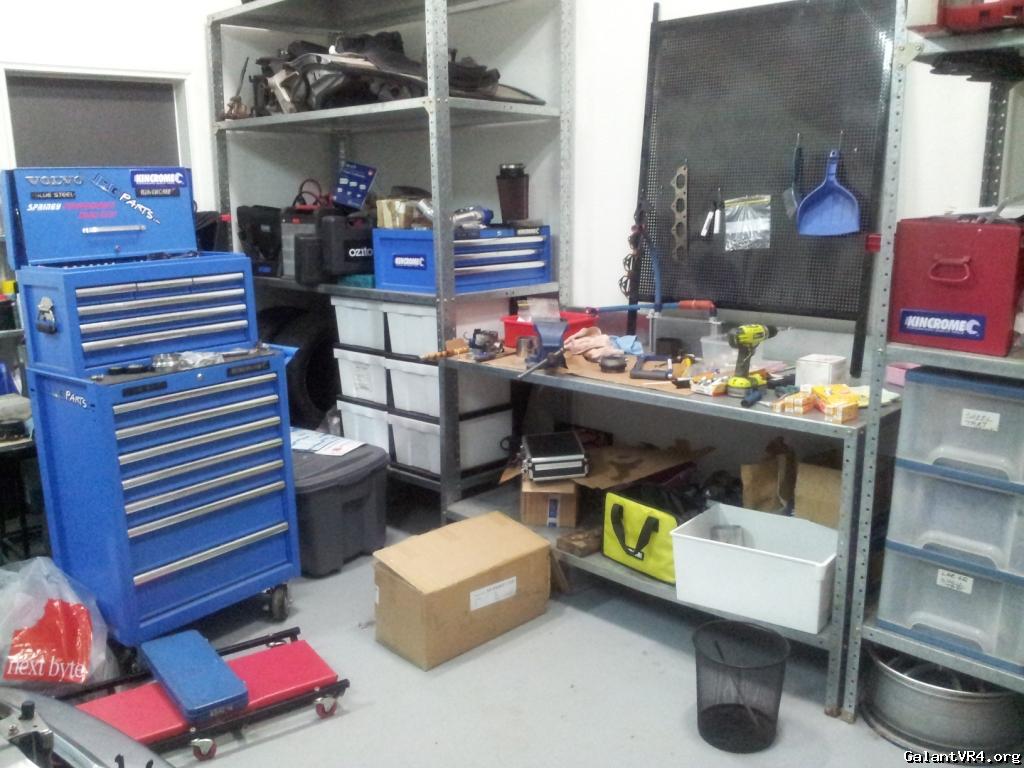

The new garage!

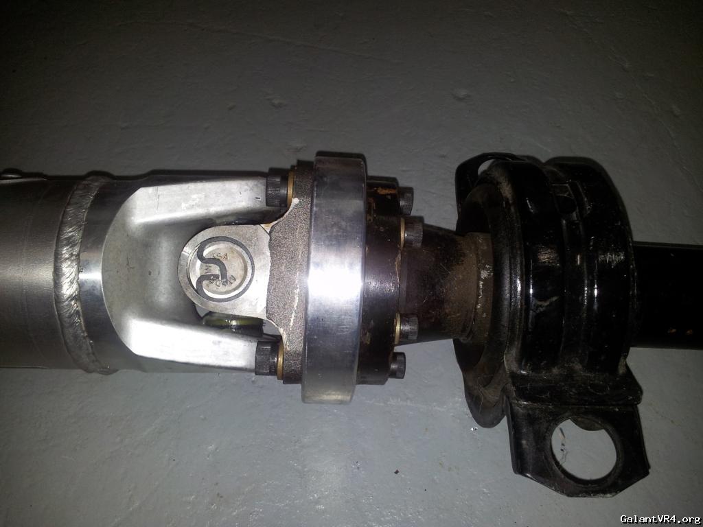

The new driveshaft parts:

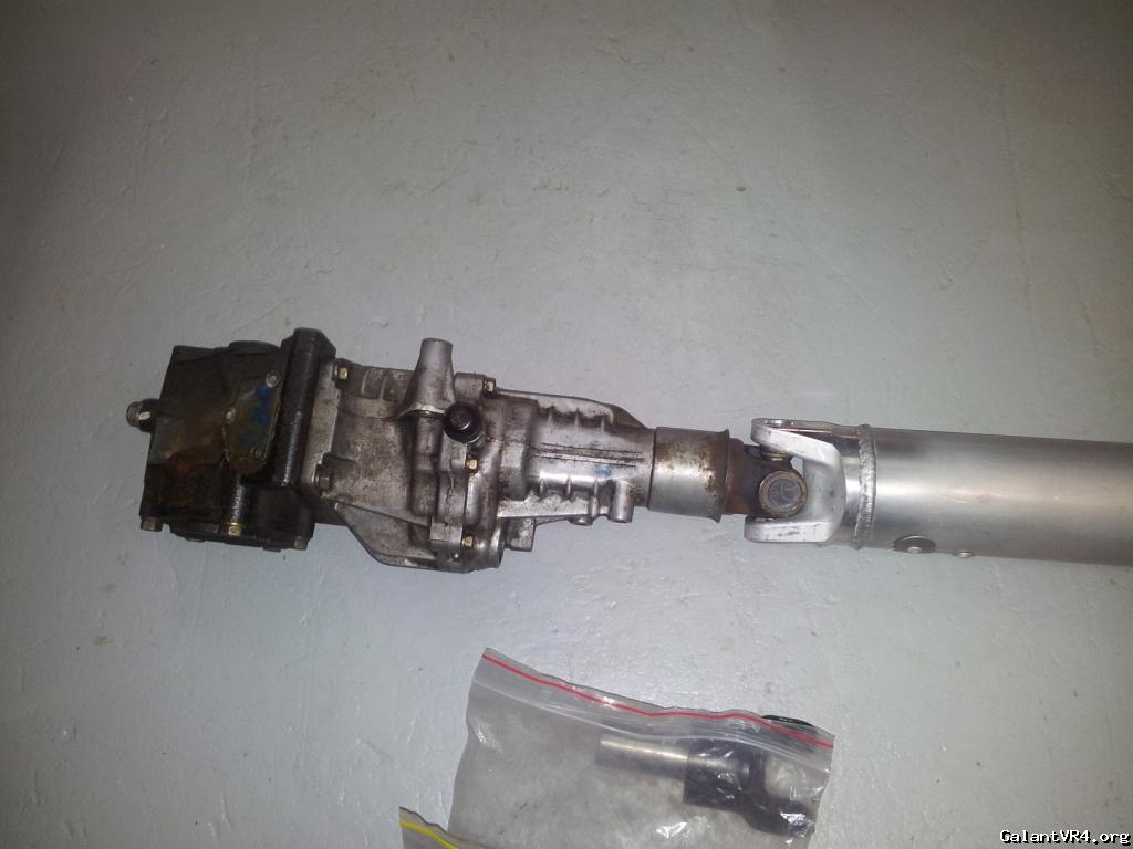

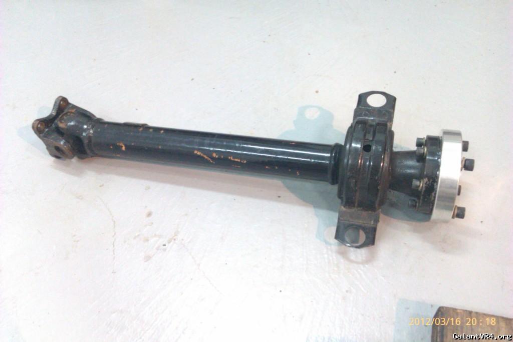

OEM MITSU UNI (hpoefully this one will not break!)
Bolt on DSS VR4 3.5" alloy drive shaft

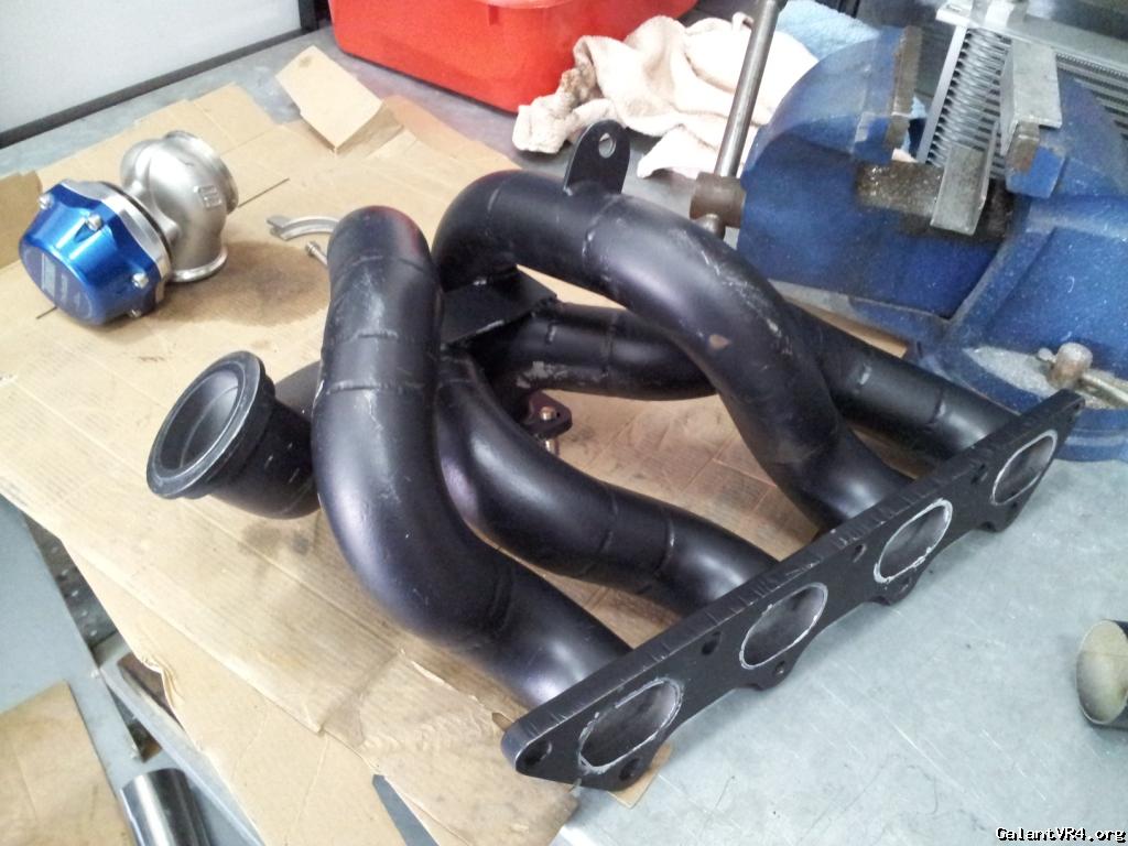

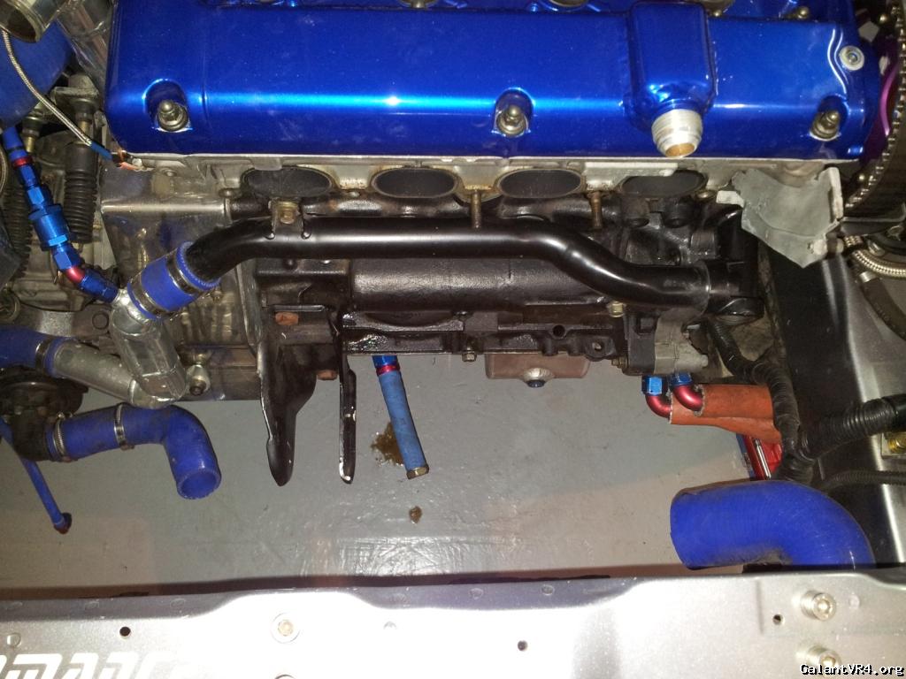

GT35R setup removed

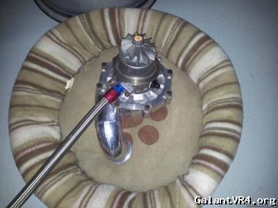

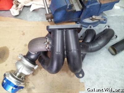

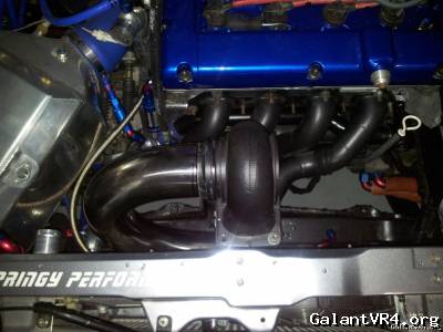

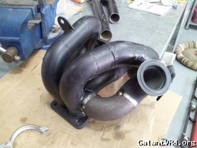

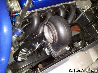

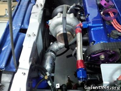

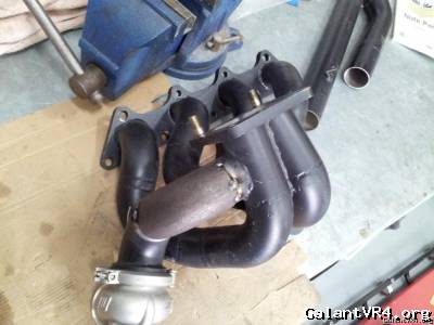

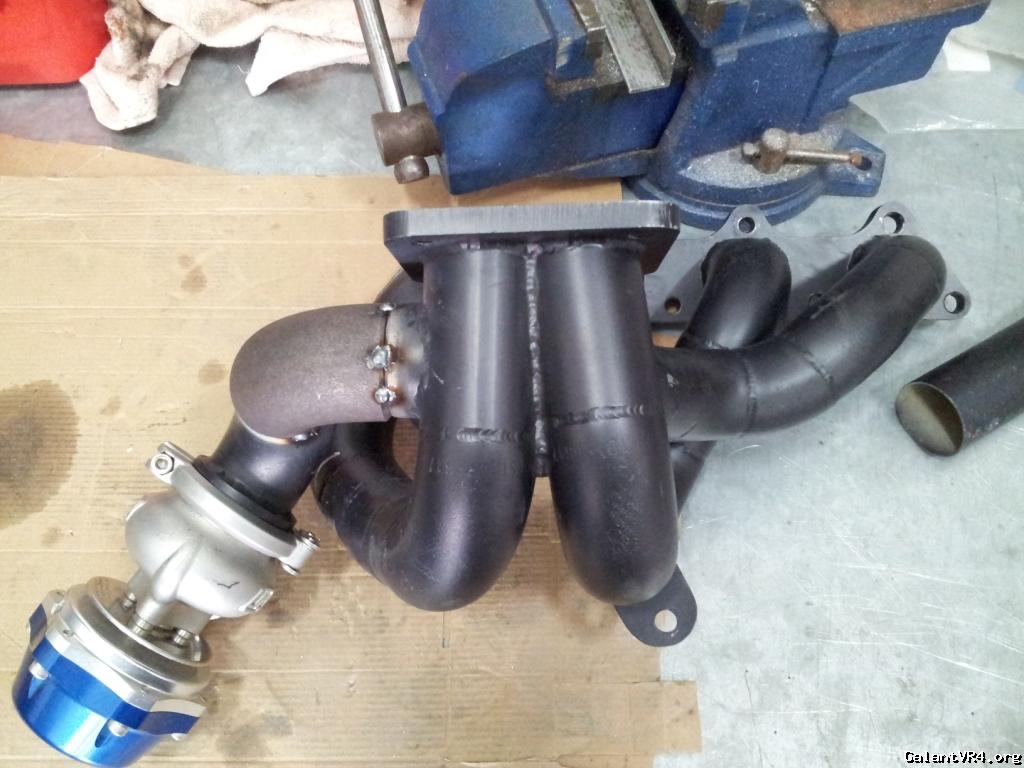

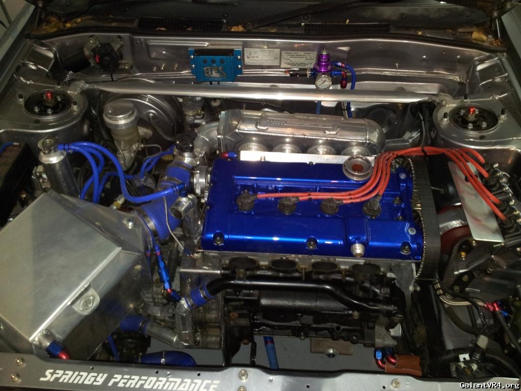

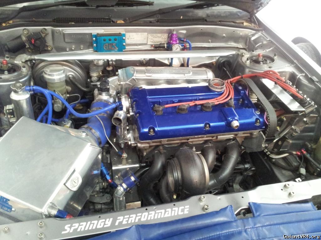

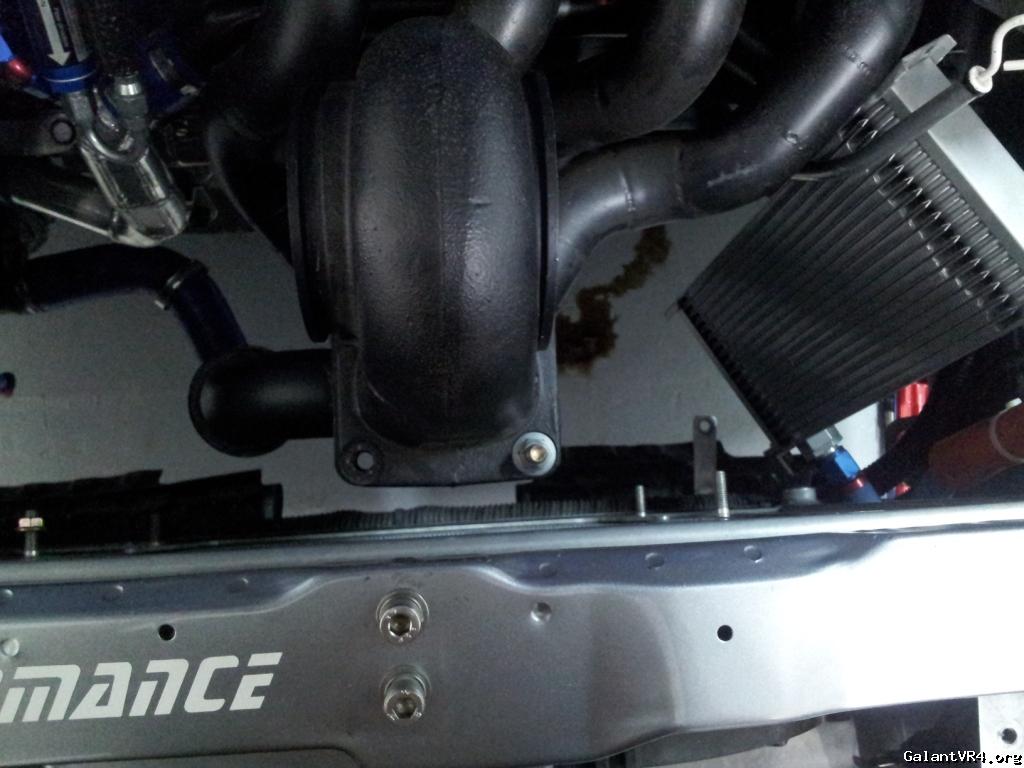

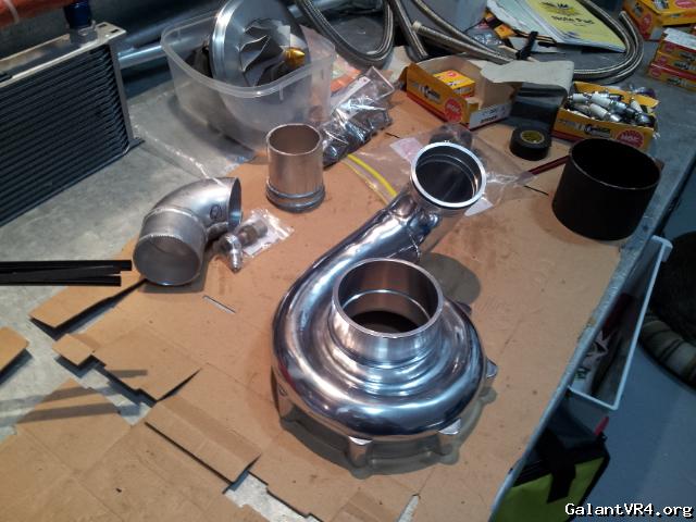

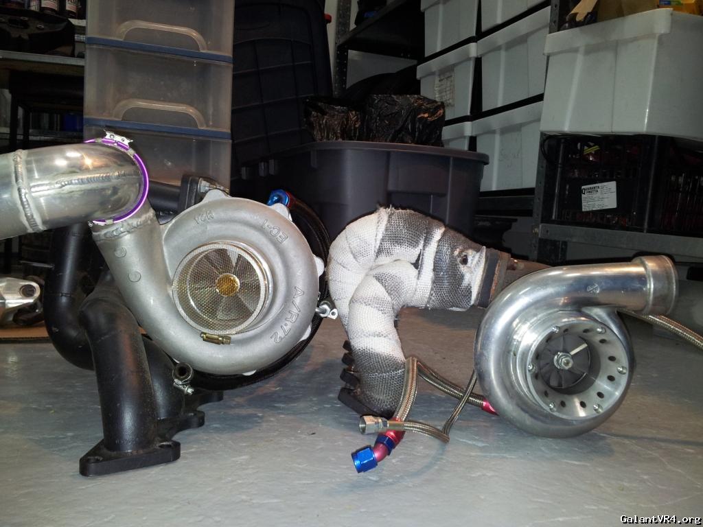

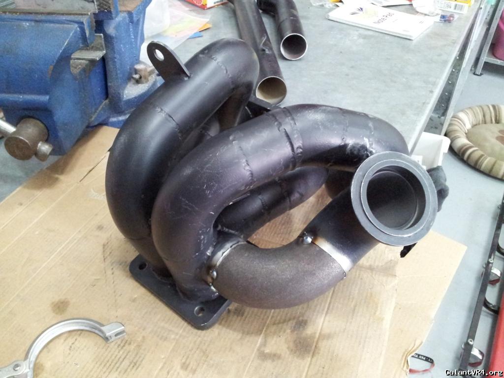

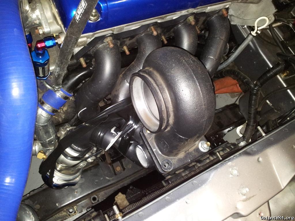

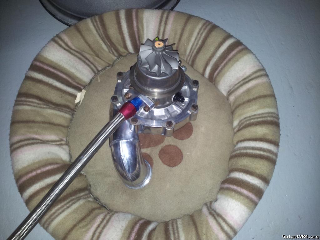

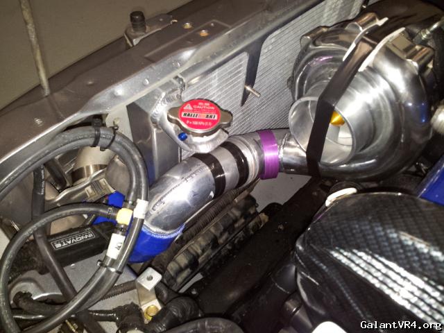

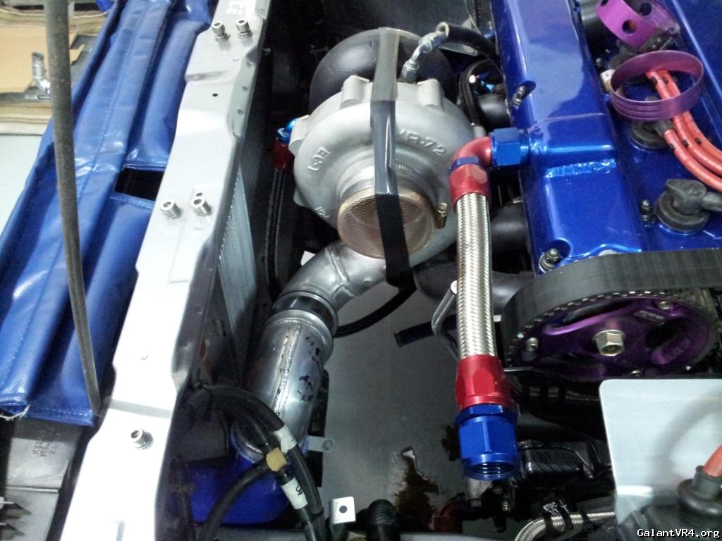

Old Turbo Setup (GT35R 1.06 / 6boost manifold / Tial V44) VS New Turbo Setup (Garrett T51R SPL TO4Z rear / Custom steam pipe manifold / Turbosmart V50 gate)

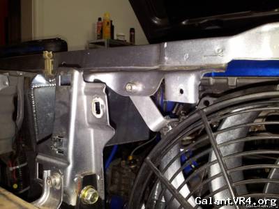

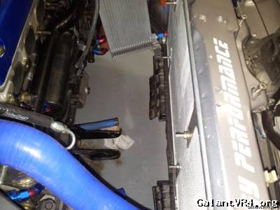

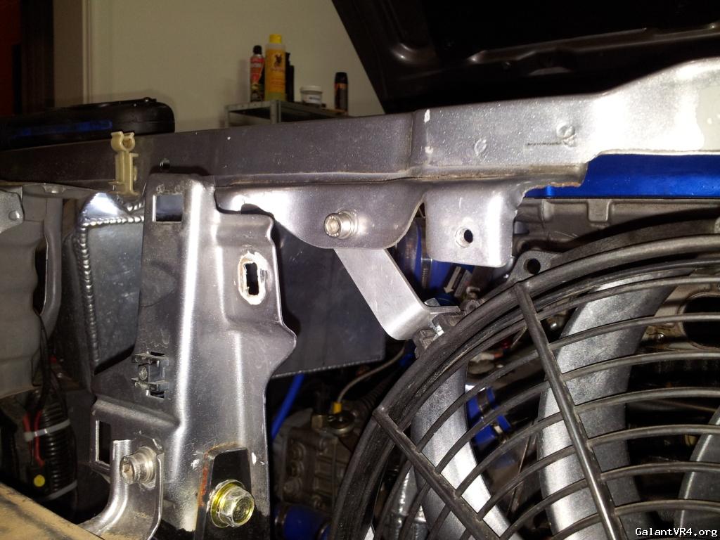

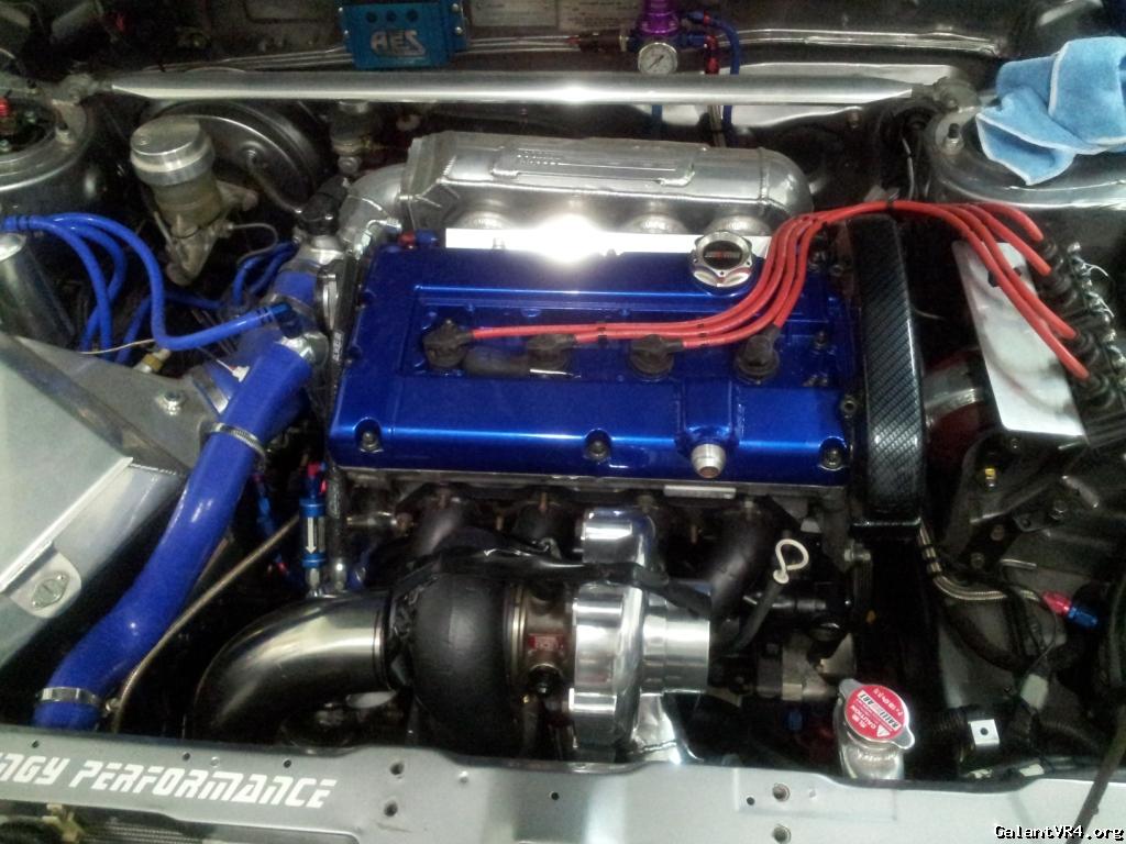

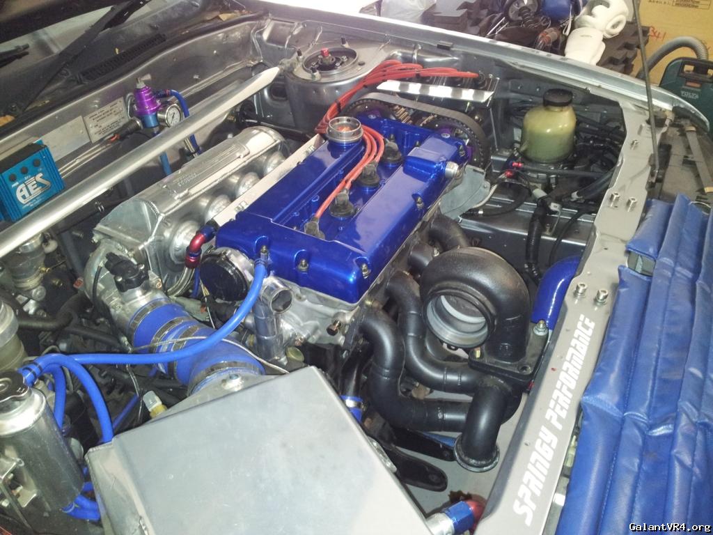

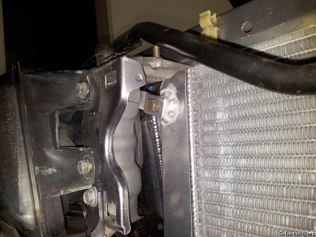

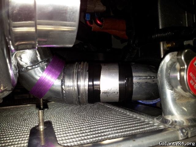

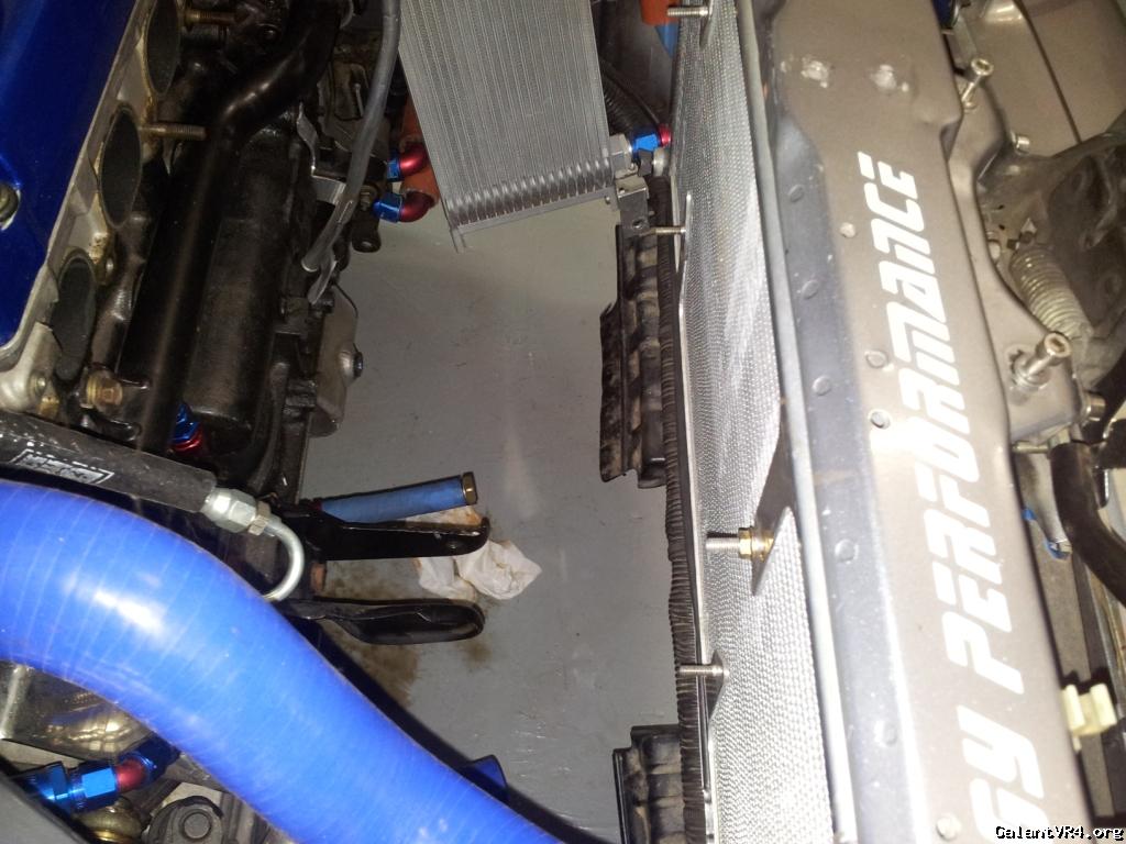

New Radiator setup (More clearance than my old custom cooler)

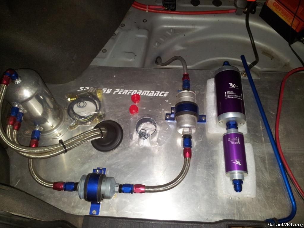

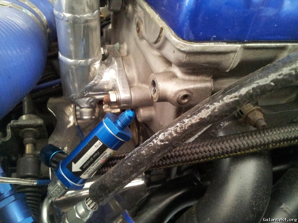

New Fuel System (Might go E85)

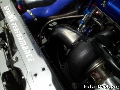

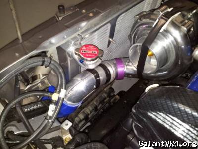

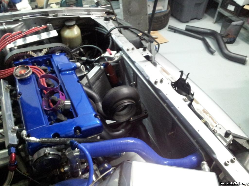

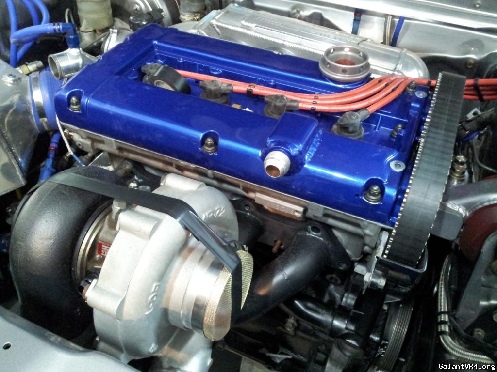

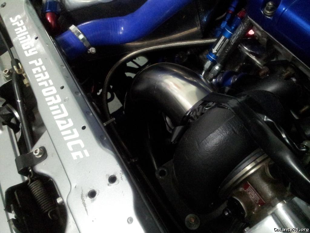

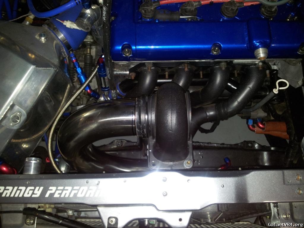

Dummy fit turbo:

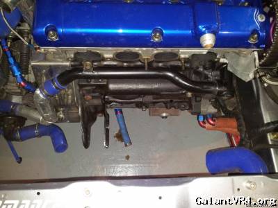

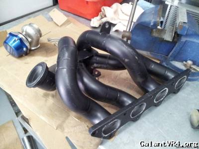

Hot pipe fabrication:
Custom lines fitting:

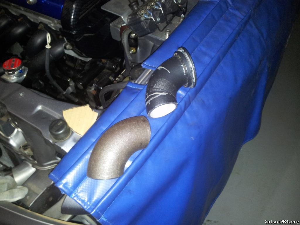

Custom dump pipe fabrication / testing:
Wastegate fabrication (change position)

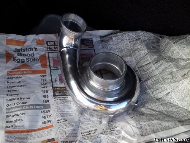

Polished cover
Slowly but surely..... I'm finding time to do an hour here and there with all the sleeplessness with the new baby etc.

1. Match port exhaust manifold
2. Weld EGT fitting on manifold
3. Tig all parts once measured up and dummied
4. Heatwrap manifold / dump pipe
