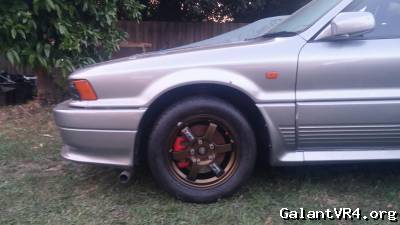

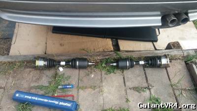

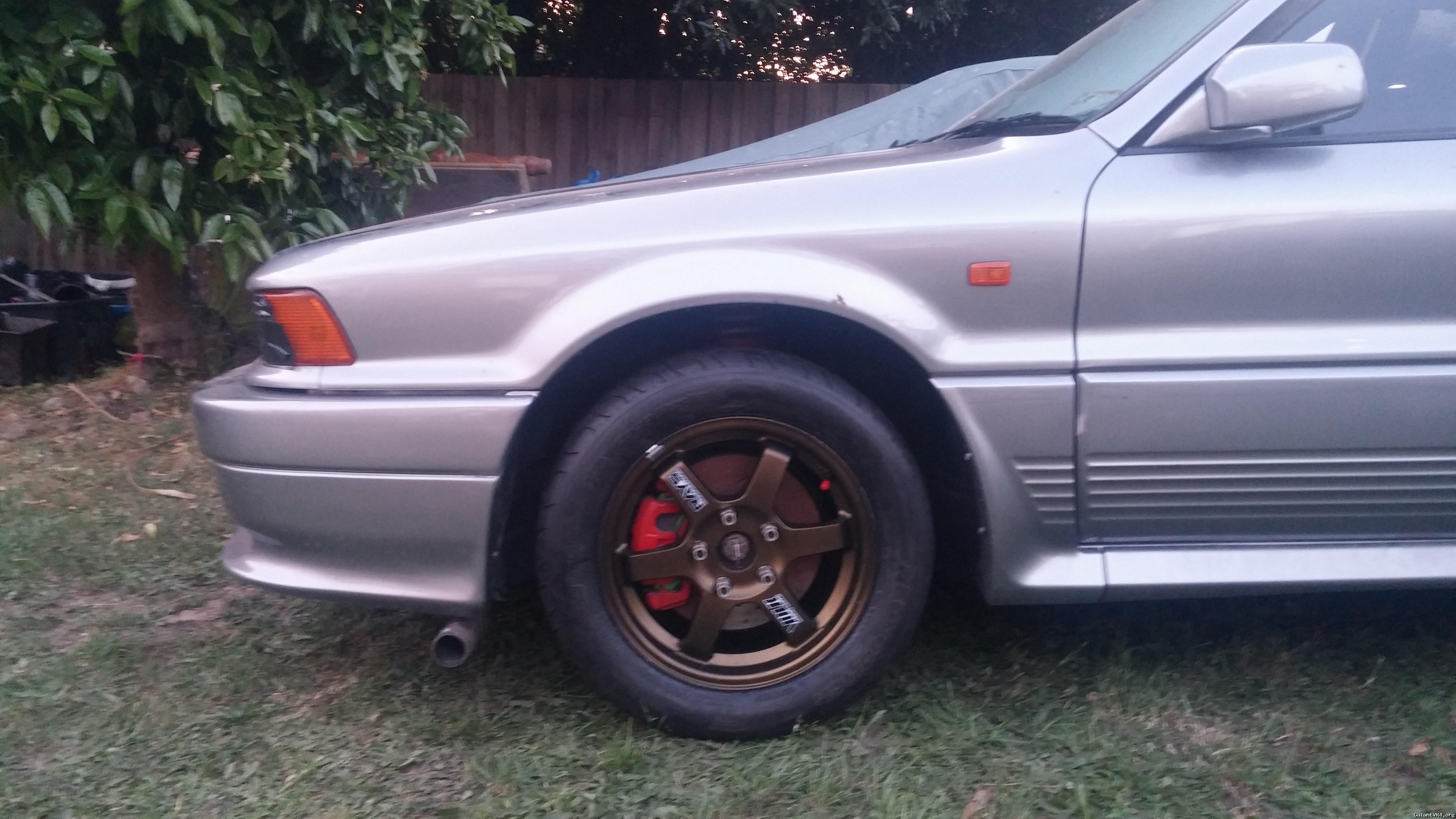

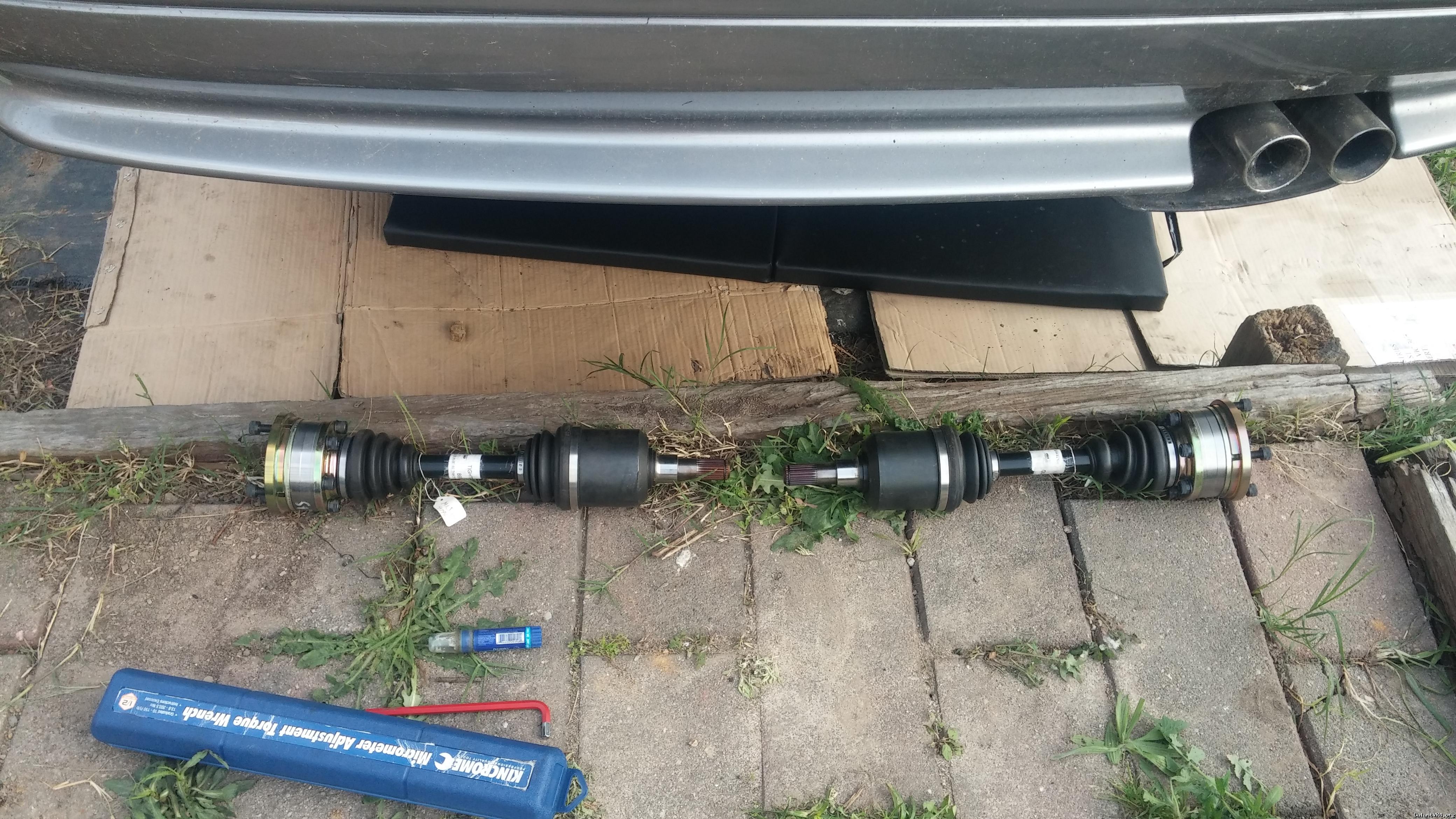

Hi All,
Some updates:
BBS LM's are now gone.
I've downgraded the brakes so I can fit 15" wheels.
I now have 15x7 TE37's for street wheels with BF Goodridge Drag radials 225 50 15.
Also I've upgraded the rear axles to DSS 1000HP items.
Fronts to follow.

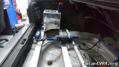

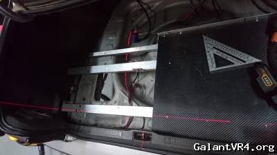

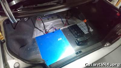

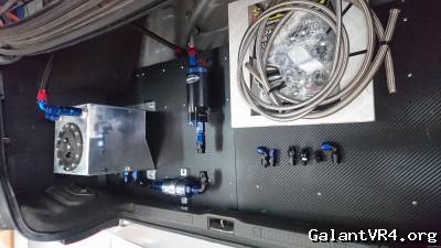

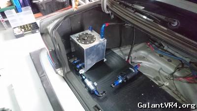

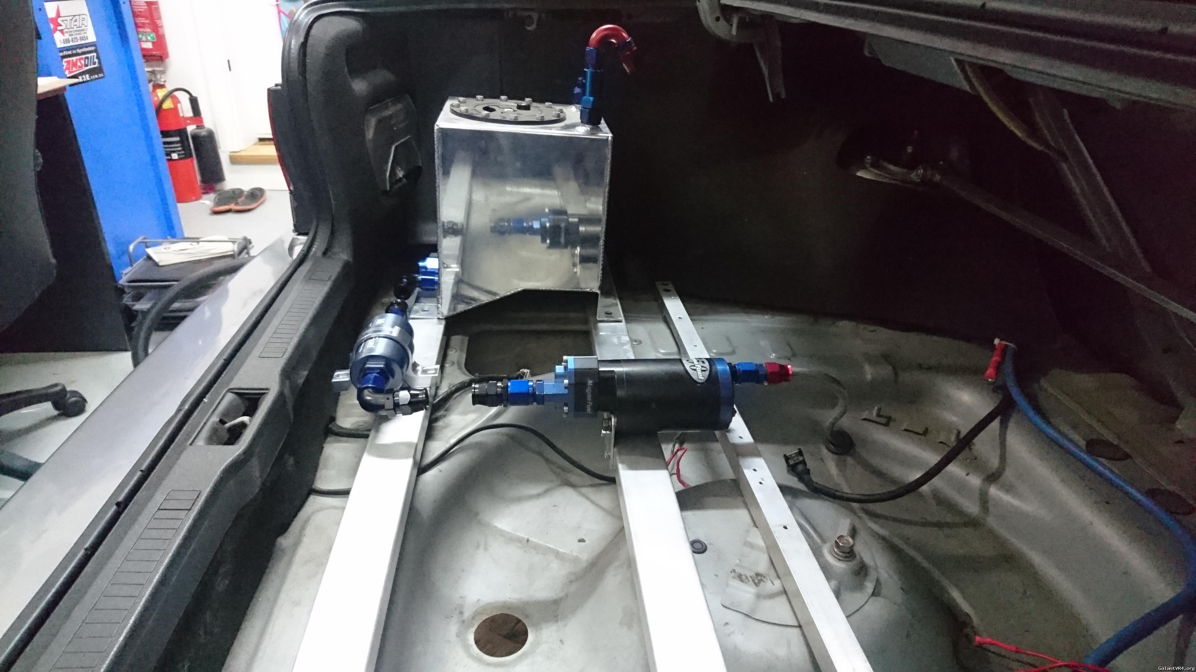

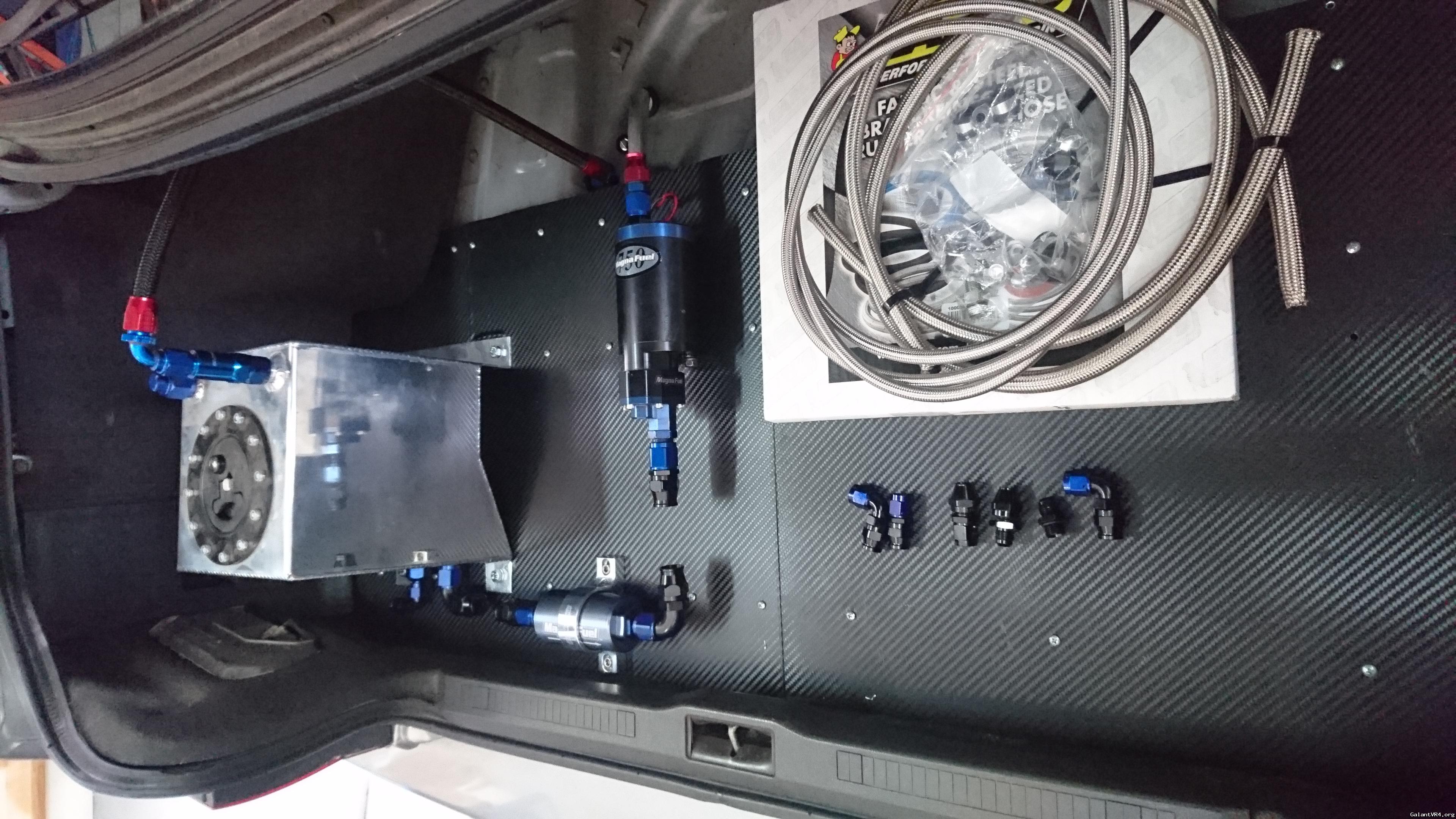

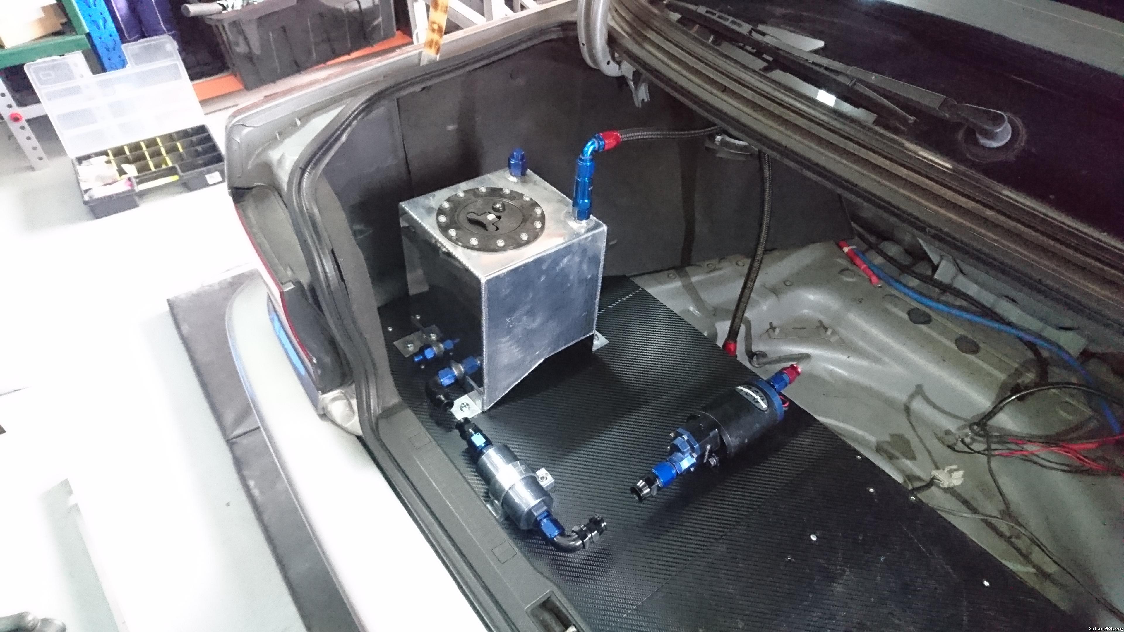

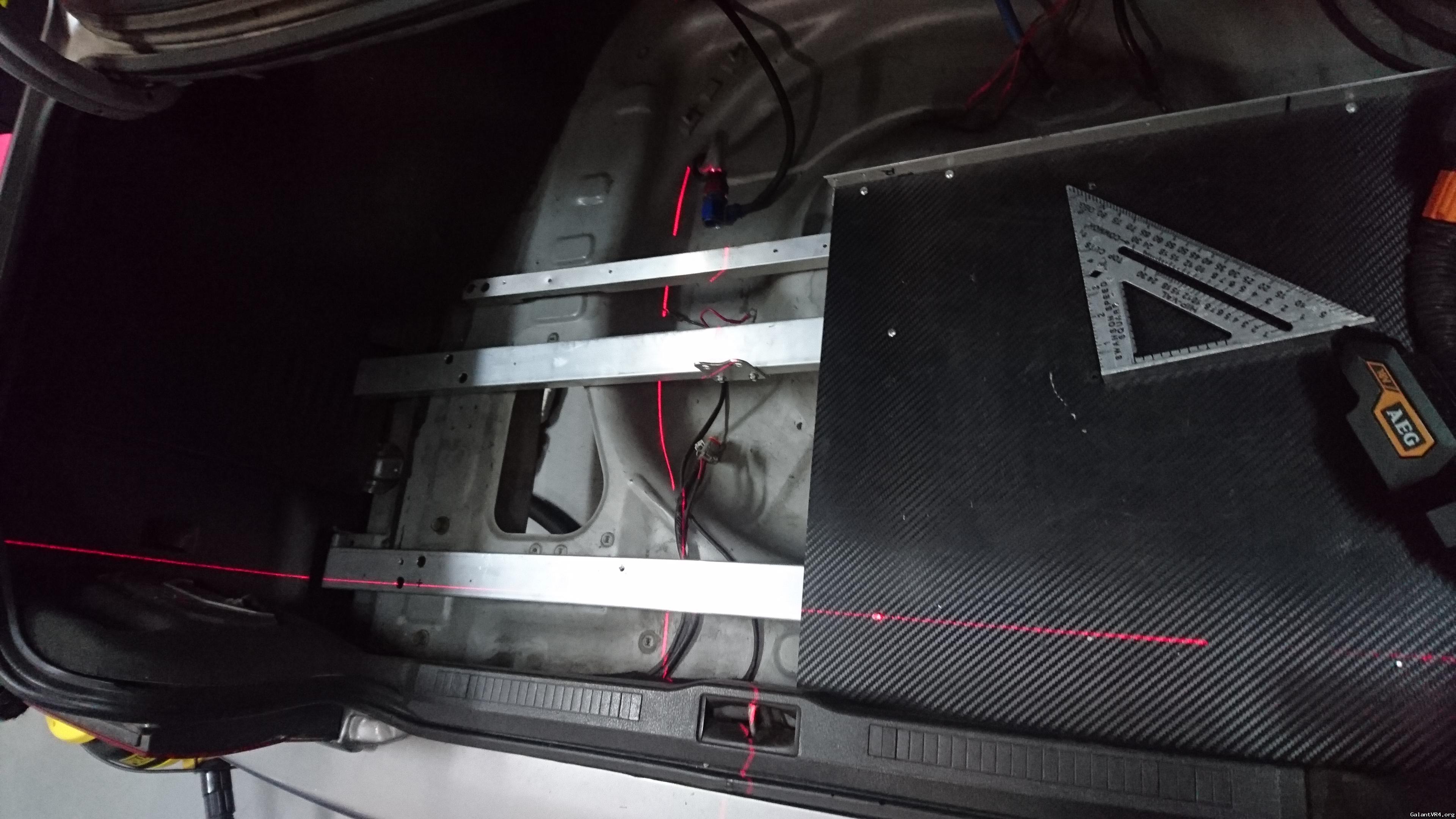

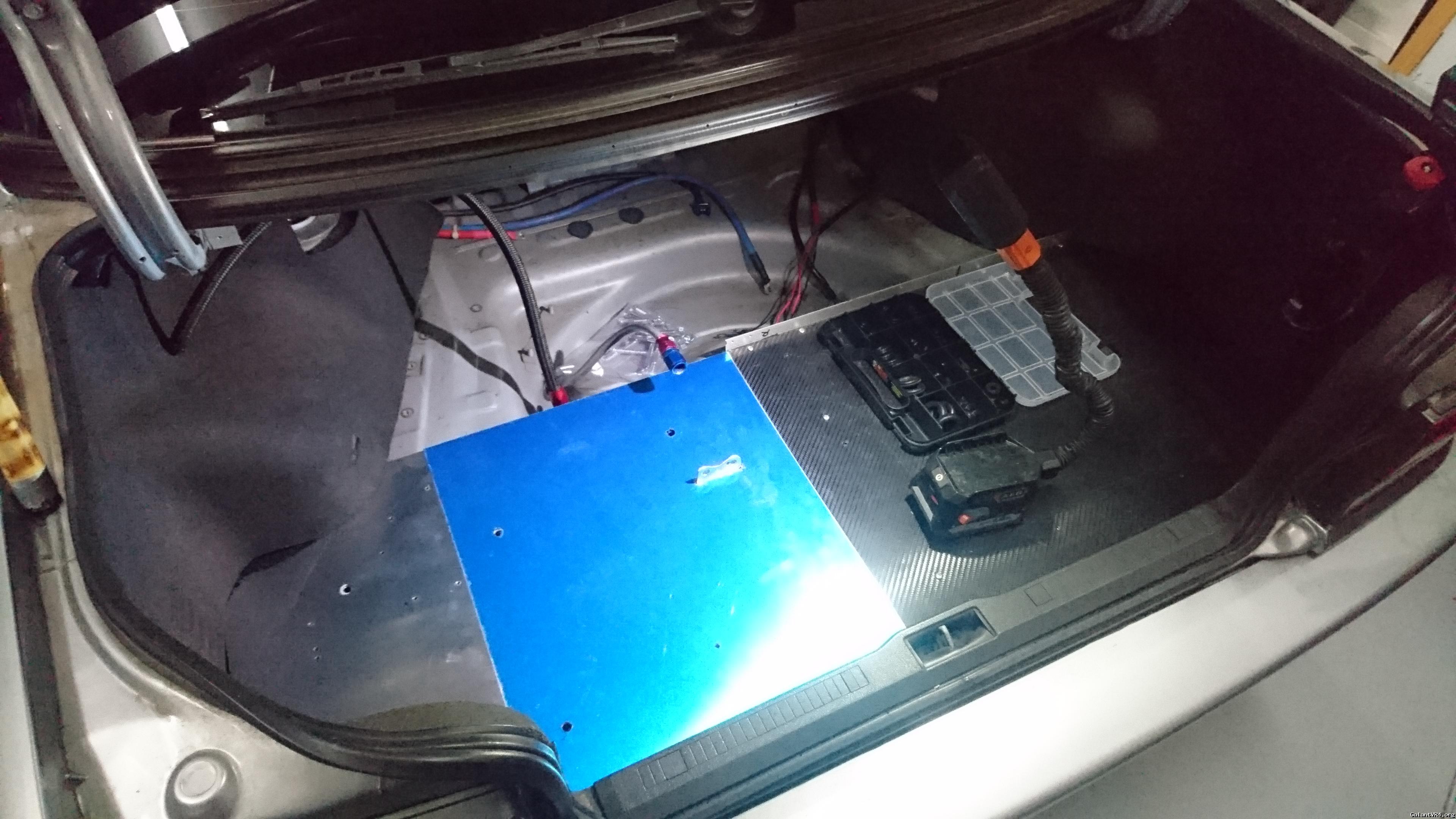

Ok. Started working on her again..
Straight into the new fuel system.
Includes 1 fuel cell. 1filter and Magna fuel 1500 hp pump. Teflon lines all round.
Also have Siemens 2300cc injectors specially for E85.
