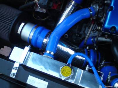

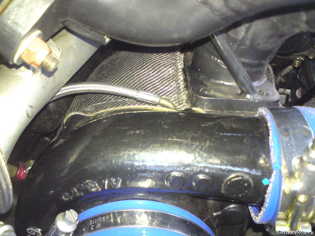

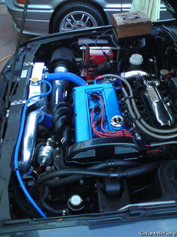

The AMG is pretty much mechanically ready for a tune. I just picked up the intake pipe from the polishers. It turned out pretty good. I still have to make an air box where that unpolished pipe will be welded into so the airbox and filter will be solid mounted. I struggled to get the turbo beanie on. It should keep all the heat in rear housing. All that is left is pretty much cosmetic. I have to change one of the rear tail lights, replace all the power window motors and regs and re install all the trim.

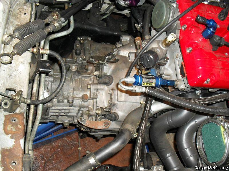

As for the VR4, I'll drop the tranny out shortly and organise from some EVO3 bits to put inside with all the good stuff. Either that or get a dog box built. It all depends on how much the wife lets me spend!!

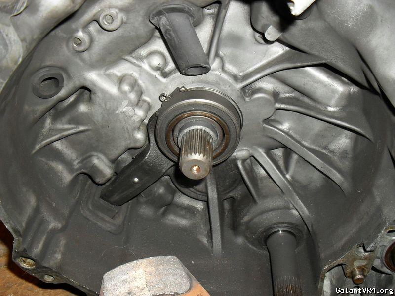

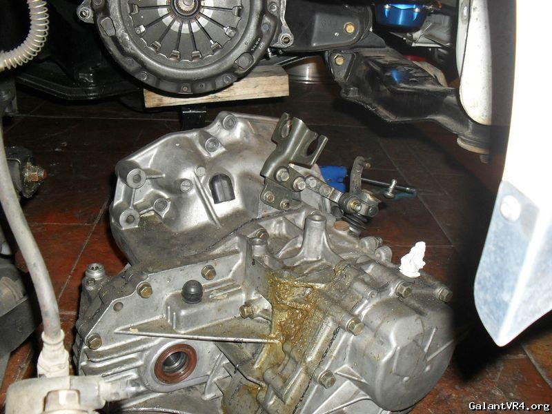

I've just purchased another GVR4 which had a DOGBOX in it.
Now I'm yet to identify the gearset. It's either a PAR DOGSET or a PPG DOGSET.
I know it is aftermarket because it has a larger input shaft than stock!!
I'll find out shortly!!
Box pulled off newly purchased GVR4

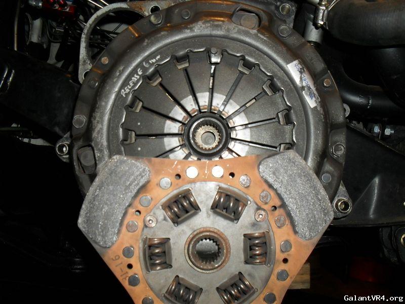

Stock VR4 clutch disc below, evo4-8 type on the engine.
