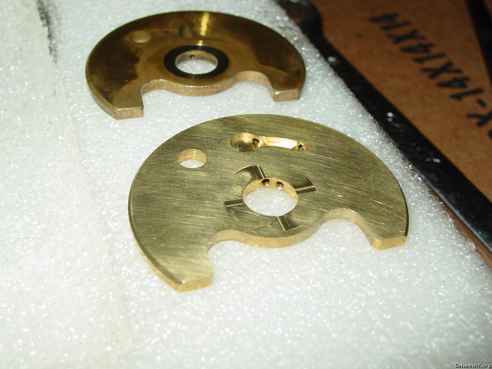

the only thing i saw different in thier rebuild kit was
as you can see the kamak oil feed journal in the thrust bearing has 2 exit points (larger i.d.) than the stock mitsu.
i used this rebuild kit on a 18g, we will see how it goes when i 1405 back on the road.

I am definitely interested in how it holds up...Thanks for the photo that helps the understanding of this upgrade look more reasonable...keep us updated!
the First 500mi have been great, still zero shaft play, no smoke.
the 18g spools to full by 3k, and sounds AWESOME probly do to
no inlet restriction other than a filter. the balence shafts
have been removed so oil pressure is a bit more than stock.
I have the oil feed comming from the head, I'm also running
royal purple 10-30, 3" downpipe into a evo8 cat back system (for stealthness)
and still works much better than a 14b with a full 3"! She is still at 10psi
gonna bump it up after the first oil change when i get some more
solid tuning.
I'll keep this thread updated as I rack up more miles. the rebuild
was VERY easy to do esp if you have a pre balenced turbo, the kit
itself was only $70, so if your shaft and blades are still good, Id
highly reccomend this kit over a new center section.
Oh yea, on a side note, this is an MHI/FP TD05H 18g turbo with no
coolant lines, so this will be a true KAMAK test /ubbthreads/images/graemlins/tongue.gif

Heading near the 4,000 Mile mark on the rebuild still just as good as day one! no oil loss, smoke and or shaft play.
set at 15psi for the past 3 month's(i know, but its my DD /ubbthreads/images/graemlins/crazy.gif). Considering this turbo is oil cooled only I give
kamak a thumbs up @only 70$ and a DIY job.
