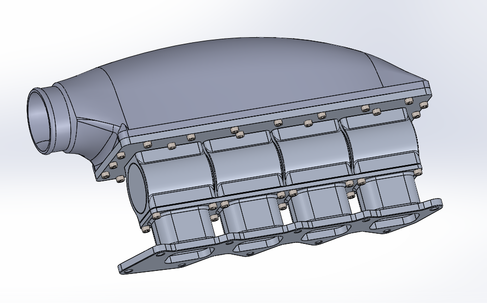

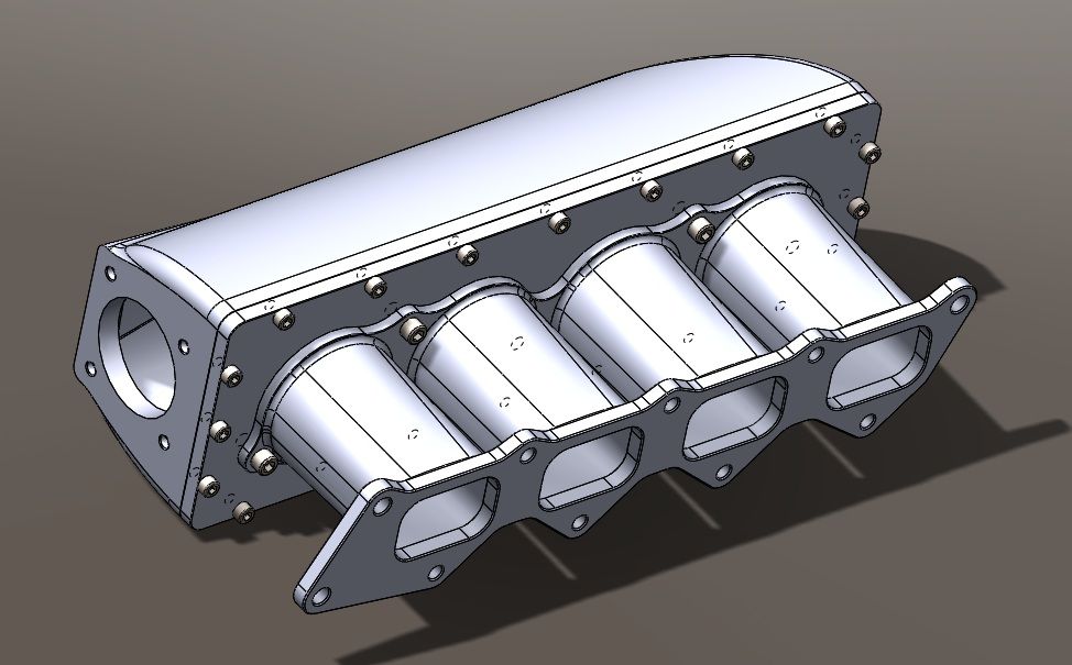

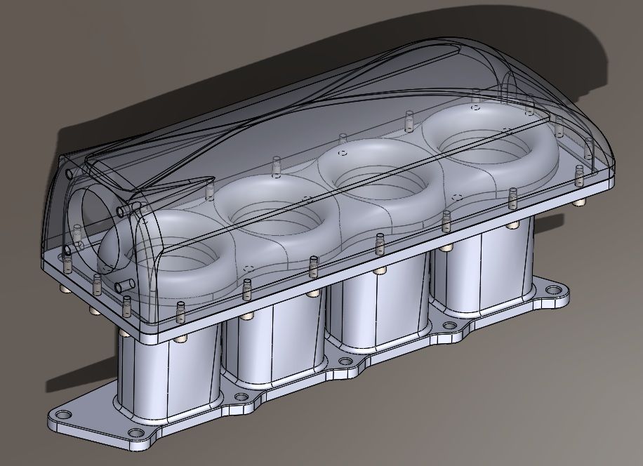

if its what i think it is. it should eliminate any restriction at the throttle shaft as there would be nothing.
jeverts
Jul 14, 2011

Correct. The problem I would run into is all the vac lines that are built into the plenum on a normal intake...I may look into building a vac tank to come off of it somewhere to take care of that.

individual throttle bodies work well in N/A applications where you are trying to squeeze every last bit of HP out, but on turbo applications a normal single throttle body is fine surely. The throttle plate and shaft aren't that much of a restriction if you move up to a larger sized throttle body. I can't help but think there was a reason Mitsubishi opted to use a smaller diameter throttle body on the turbo engines than the N/A engines.

There is a lot more work involved with the barrel throttle body design and more money that would need to be invested with it, so I may scrap that idea and stick with a traditional intake. I may design a throttle body with the barrel to mount in the stock location later on just because I like the no restriction at WOT. I am waiting for tax return time to order material for this. I also have designs for a bunch of other things and I know the Galant page on facebook was begging me to make (Sending units) I will post more up when I have time to maybe do some production runs of stuff and sell them.

ITB's will help with throttle response so there would be other benefits over max hp. But I can't see any ill effects other that tuning that would be a concern.

The only thing that I would be worried about is part throttle, But as you said it's probably something that tuning can take care of.

SD seems to work well with part throttle as long as you have a good vac source running behind each throttle body to a distribution block. A vacuum canister should help limit the effect on the map sensor when hitting the brakes if you decided to stick with a brake booster. But ITB's do require you to lock the WB o2 for initial tuning.
You will most likely have to spend time adjusting the throttle tip in (comparable to an Accelerator pump on a carburetor). The results of ITB's are rewarding on a properly working setup but it just adds more complication to tuning.

I am planning on driving it. Not daily but I would like it to still drive some what decent. Here is a question would I have to run vac lines off of just one runner or would I have to run a line off of every runner?

you would have to run one line off of each runner to get the best vacuum. then run any of your sensors,brake booster and related off of the distribution block. or you can have an additional runner/balance tube that connects to the underside of the runners to make it look cleaner. then run a nipple off the side of the rail for the booster and all other fittings can be attached to the middle portion under the intake for a clean look.
