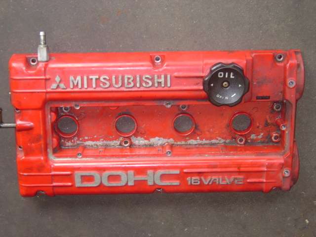

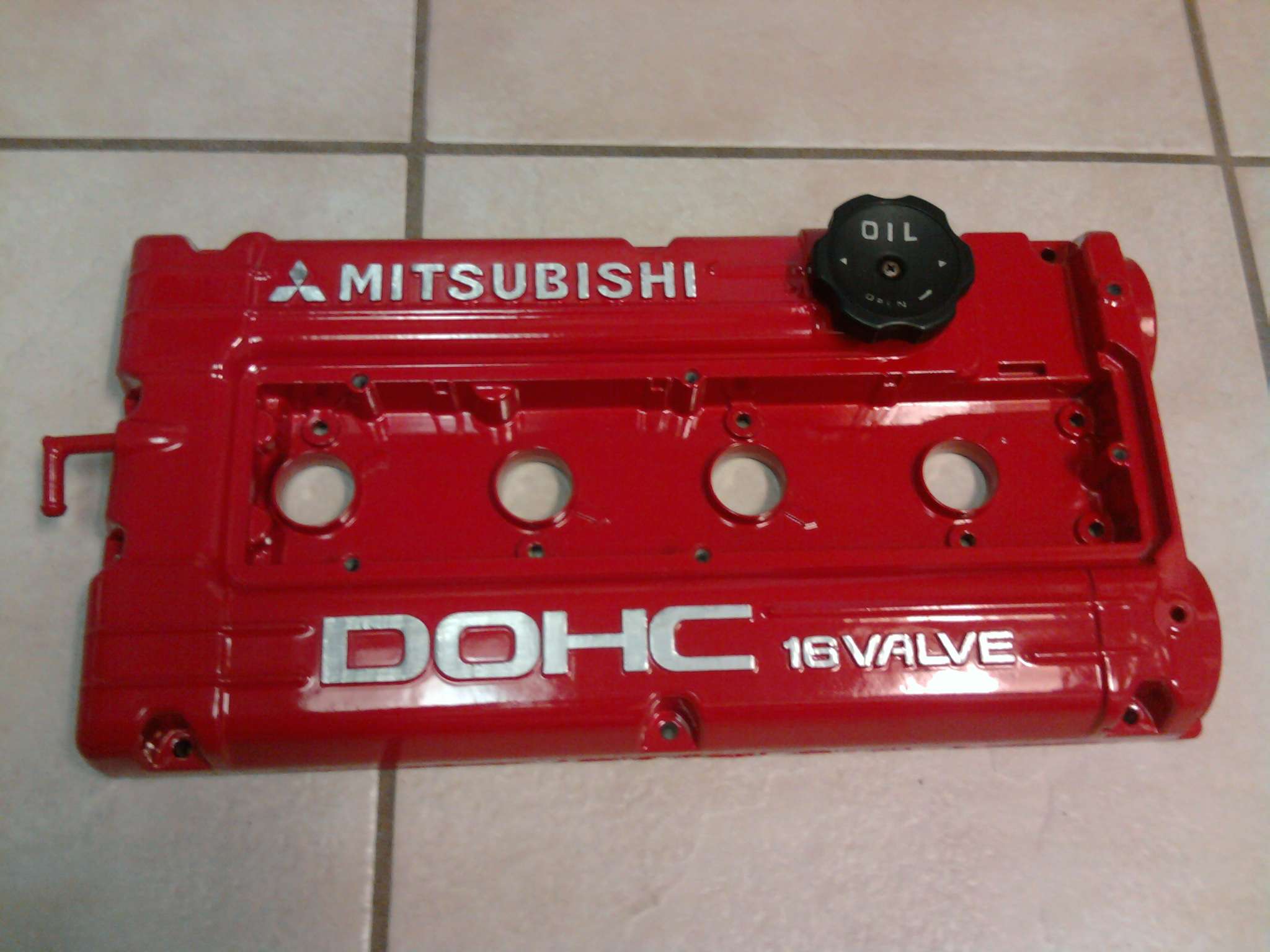

These cars are money pits, but any project car is. Just got my valve cover back from the powder coater. Turned out sweet.
before:
after:

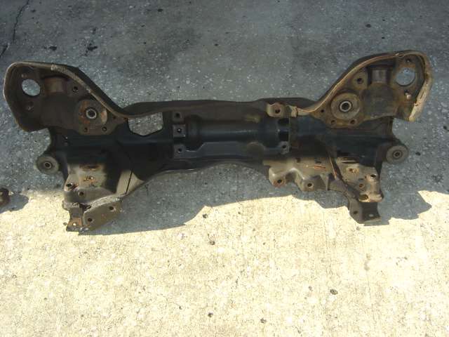

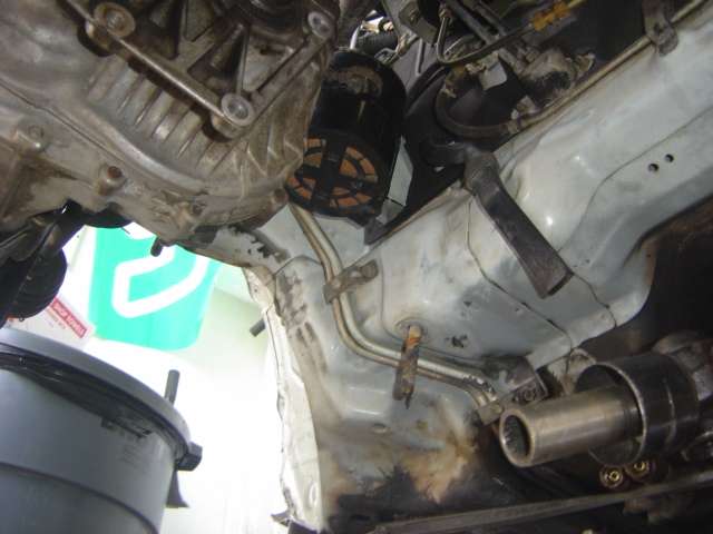

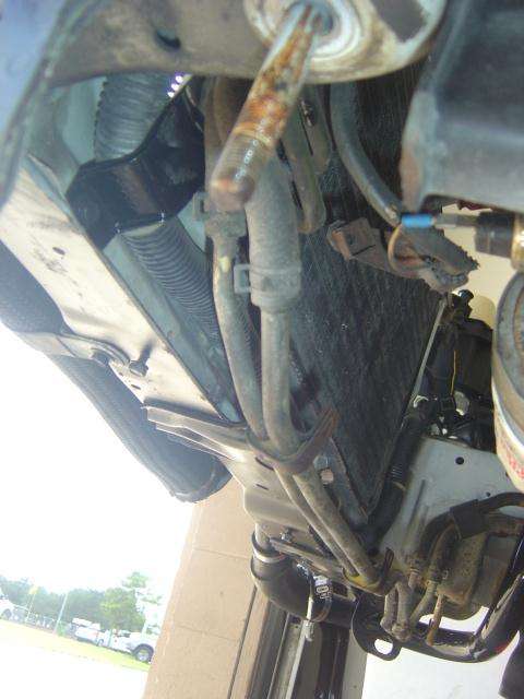

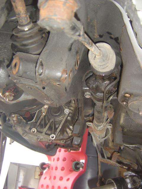

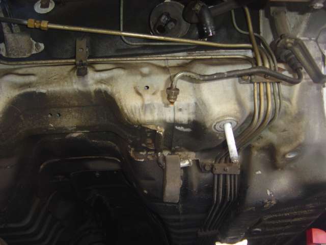

Starting working on the car again today. Got alot done. Stripping the front suspension. The plan is to drop the front subframe. Replace all bushings. Install the lower control arms, rebuild steering rack, Whiteline swaybar, BC coilovers, new brakes, new oil pan and new motor mounts. Lots of parts going to the powder coater and going to finish under coating the car.

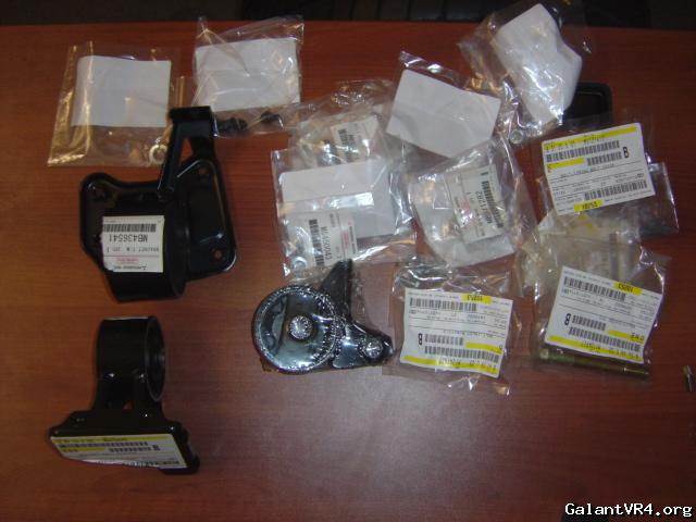

Update. Mitsubishi should up this morning. New engine/trans mounts.
Got the subframe out. Got alot of work head of me.

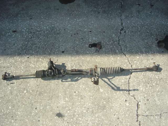

Steering rack.

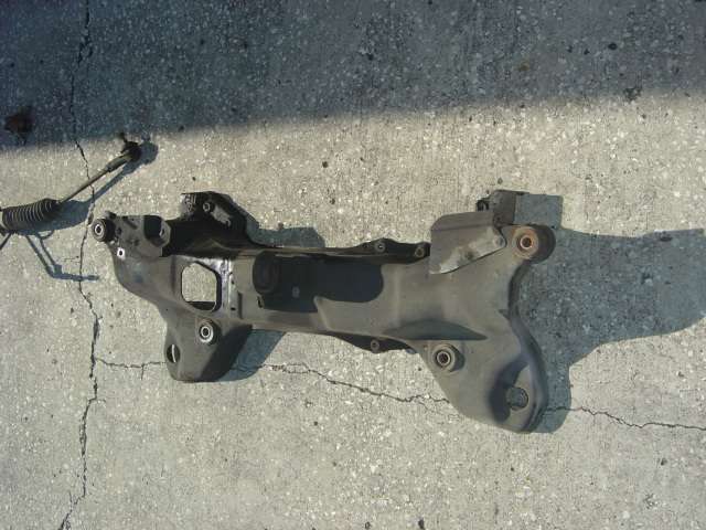

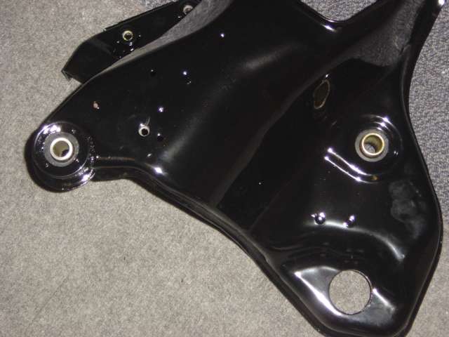

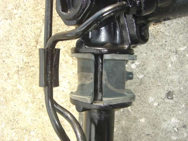

More updates. Got alot of stuff back from the powder coater.
Front subframe:

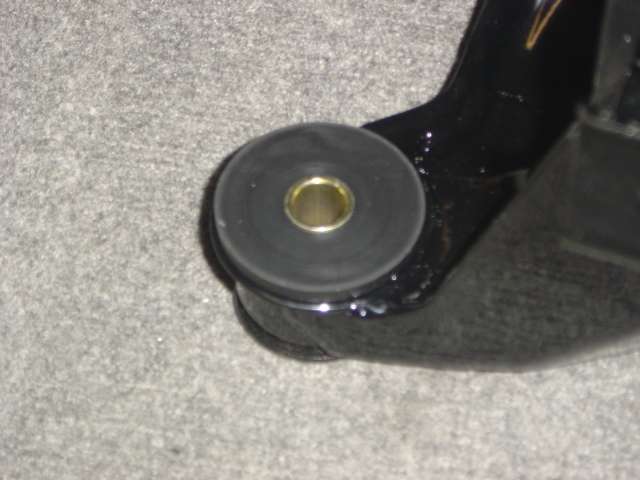

Bushings installed:

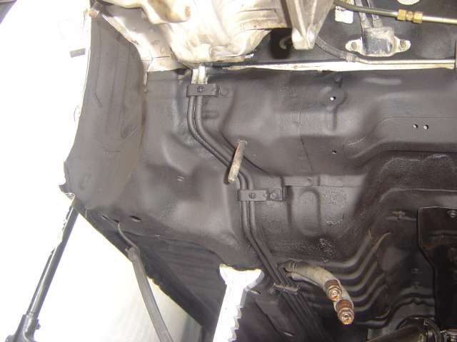

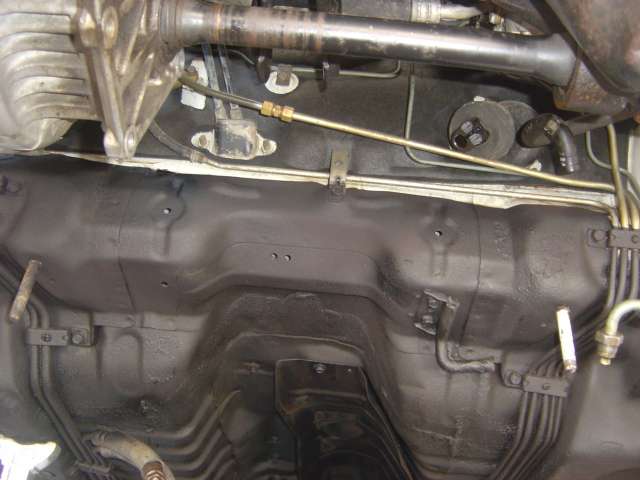

Cleaning and painting with rust protection. Then I will be spraying the under coat.

What bushings did you use in the front subframe and how was the removal of the old bushings?
Looks great BTW!
bobdole
Aug 23, 2007
899
U.K.
Quoting Romanova:
Looks great BTW!
Energy suspension bushings. Used a press. It was very easy with the right tool.

Ok finished undercoating.

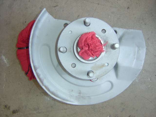

Hubs ready for paint.

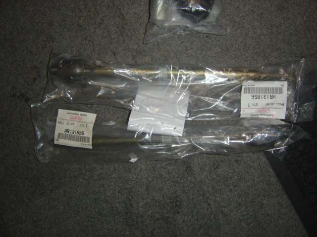

Inner and outer tie rod ends came in.
Just got to rebuild the steering rack and I can start putting back together.

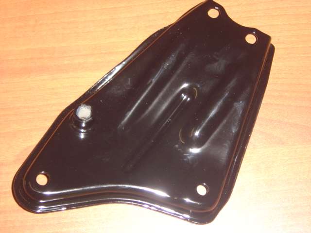

Working on the car alittle today.

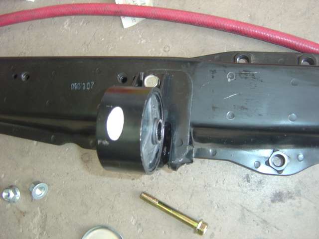

Dropped the front motor mount support to get the new one ready for install w/Motor mount.

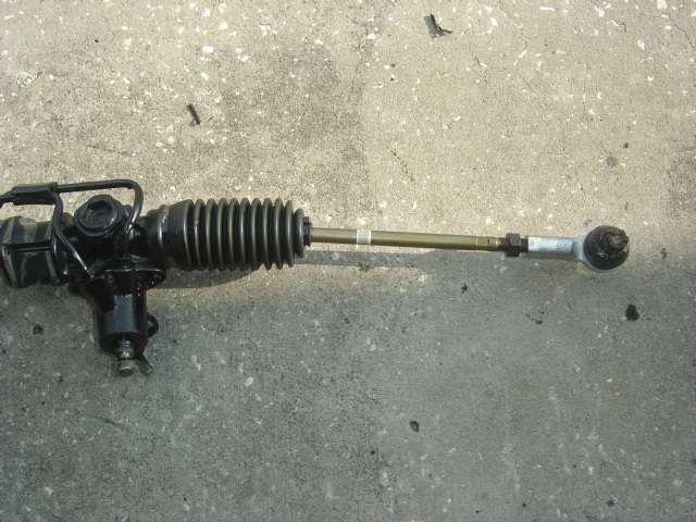

Got the front steering rack back from a fresh rebuild. Ready for install.
Just waiting on a few bolts to come from Mitsubishi then I can start putting it back together.
