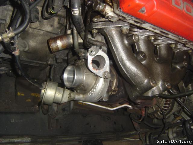

Replacing the valve cover gasket. It was leaking. The engine looks clean for the miles. Finally finished replacing the exhaust manifold studs. Got most of the turbo back on. Going to pull the oil pan and but a new one on. So I had to take the front transfer case off. Went ahead and cleaned it up and painted it. Still have a ton of work to do.

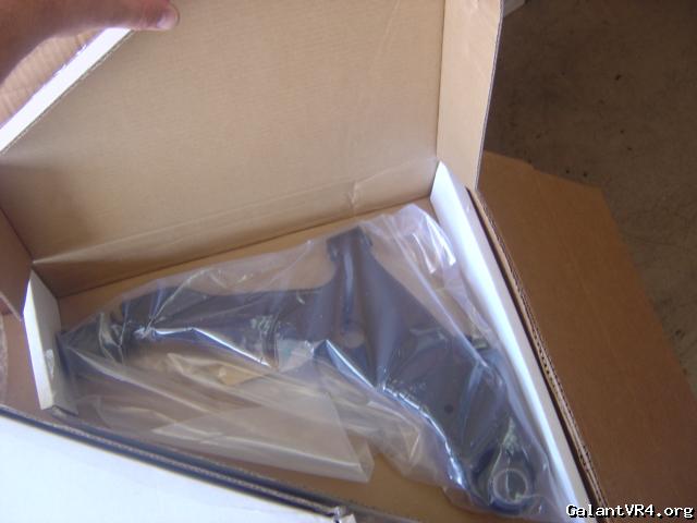

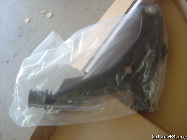

Got some new goodies in. Dorman arms, OEM swaybar endlinks, OEM Steering rack rubber mounts, OEM Radiator rubber mounts and Energy Suspension front subframe bushings. I am really hoping to find sometime to work on her. Got alot to do still.

Hey Bob is that a bolt I see in the manifold instead of a stud thought that was bad....
bobdole
Aug 23, 2007
899
U.K.
That bolt is not staying there /ubbthreads/images/graemlins/smile.gif

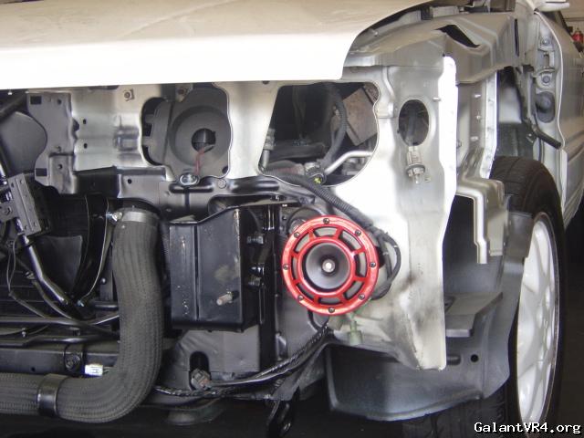

Got some Hella horns in today. They are loud.

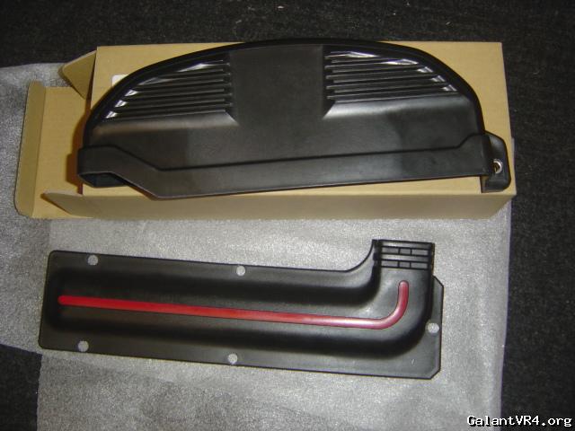

Got some new parts in today from Mitsubishi. Shift cables and E-brake cables.
bobdole
Aug 23, 2007
899
U.K.
More parts in from Mits today. Can't wait to start installing all this stuff.
