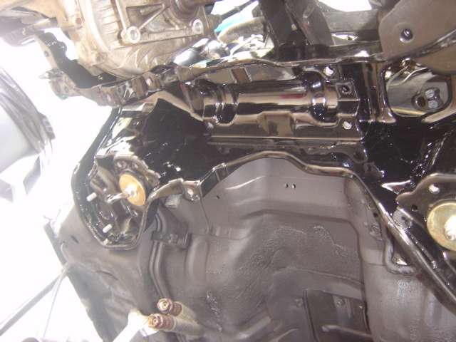

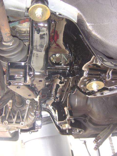

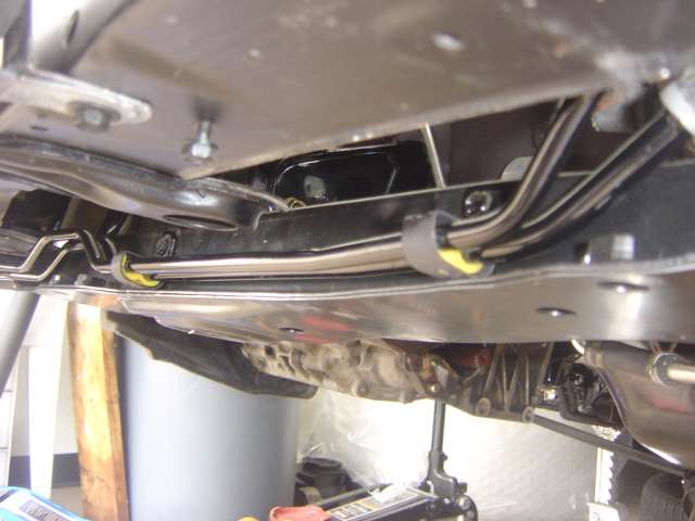

The undercoating turned out nice. I'm jealous of all your nice new OEM parts /ubbthreads/images/graemlins/smile.gif

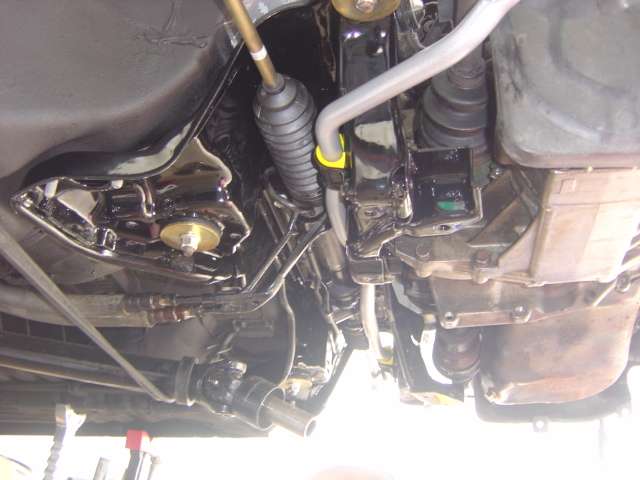

Did you order your tie rod boots from Mitsubishi or come with the rebuilt rack? I picked mine yo from rock auto and they don't fit over the inner part of the rack.

You have to get the Moog boots (or bellows) that are MADE IN JAPAN. I bought the Beck/Arnley's and they were made in taiwan and couldn't get them on. So I ordered the Moog's and the one made in Taiwan was the SAME EXACT boot as the Beck/Arnley. They use plastic zip ties too. The Japan made Moog has metal straps and a different material.

The shop where I had the rack rebuild at supplied those. I just supplied him with the inner and outer tie rod ends.

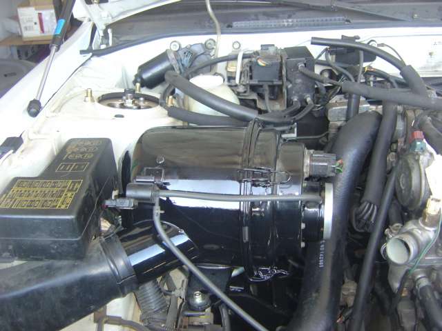

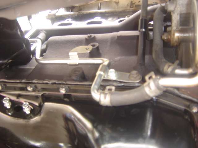

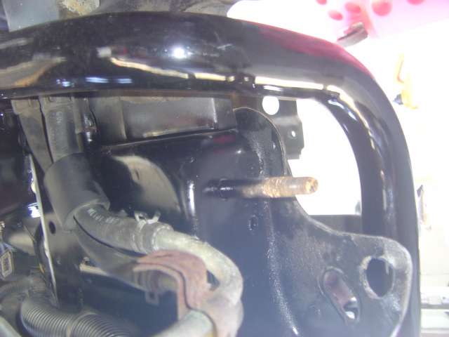

Bolts showed up today. So I will be putting everything back together now.

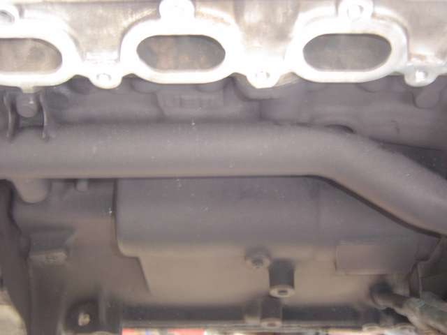

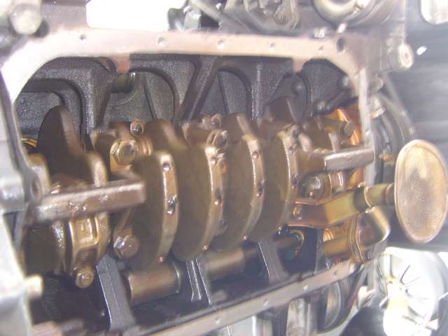

Did some more sanding and painting today. Also cleaning up the block. Snapped a few pics before I left.

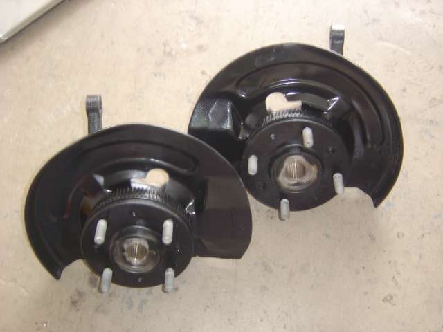

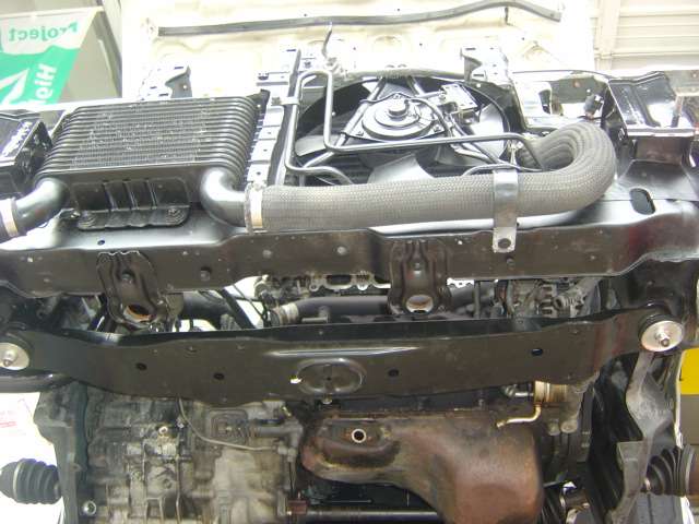

Small update:
Finished painting the hubs and block. Also ordered new front bearings and seal, because one of the bearings doesn't spin as free as the other.

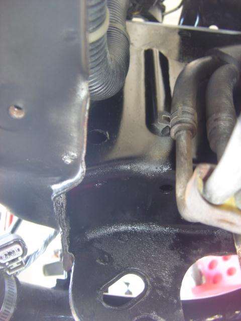

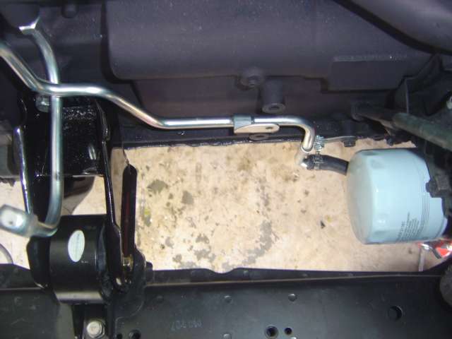

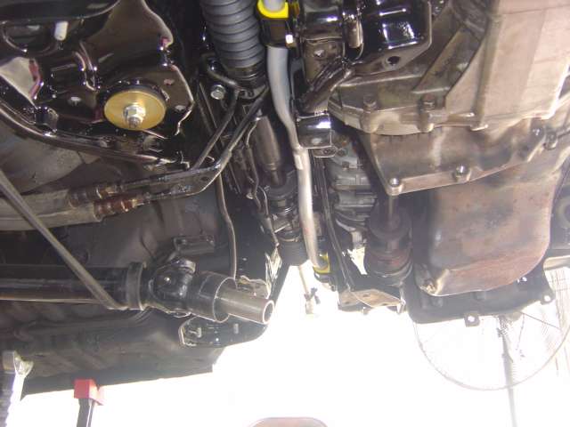

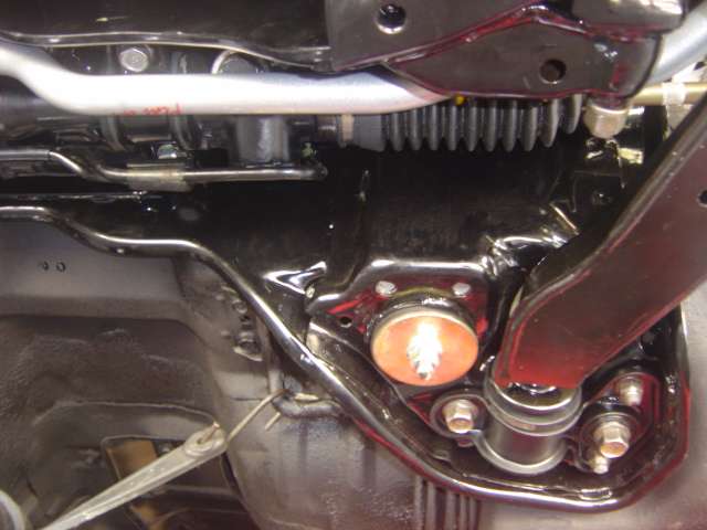

Thanks for the kinds words guys. Lots of pics on this update:

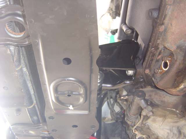

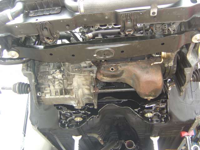

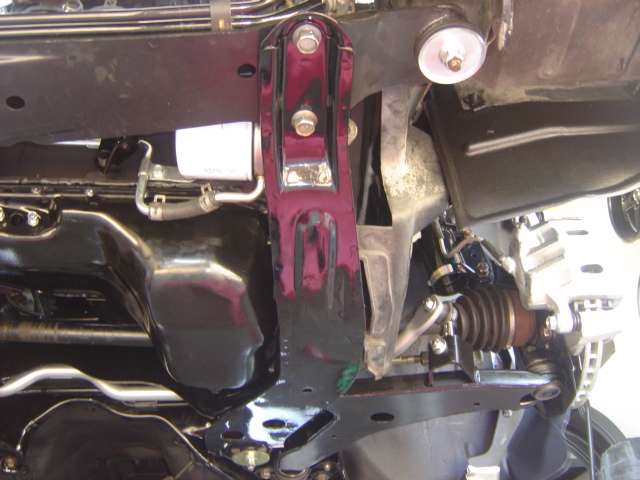

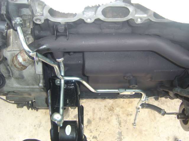

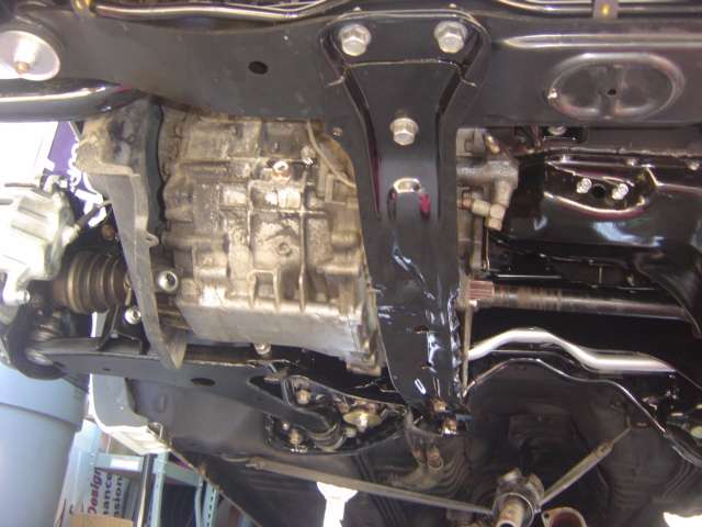

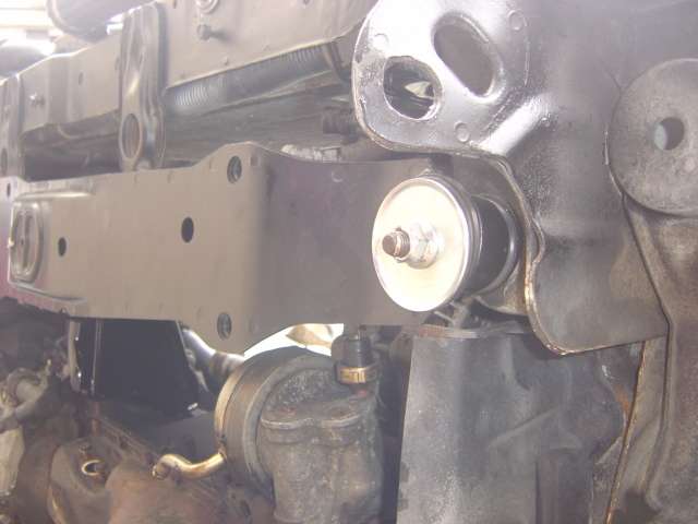

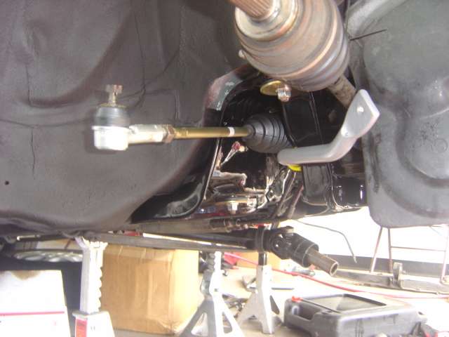

Got the front subframe back up and the front motor mount brace. Also installed the steering rack and front swaybar.
Should have more updates tomorrow if the Mitusbishi guy shows up.

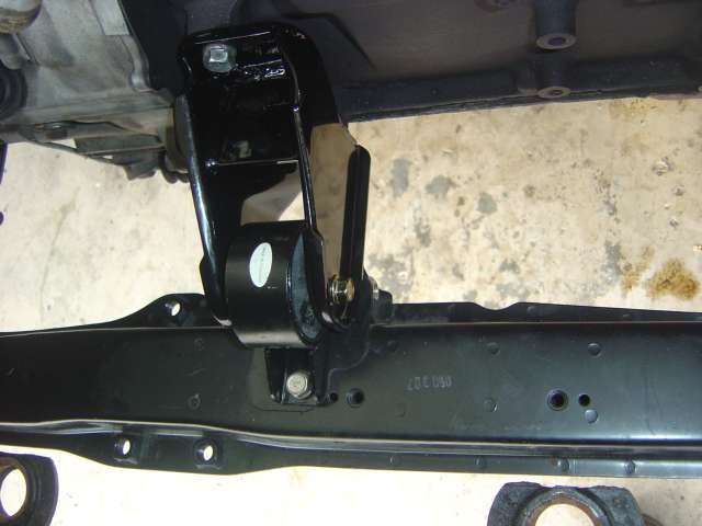

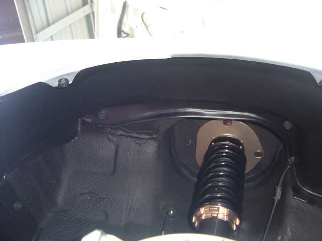

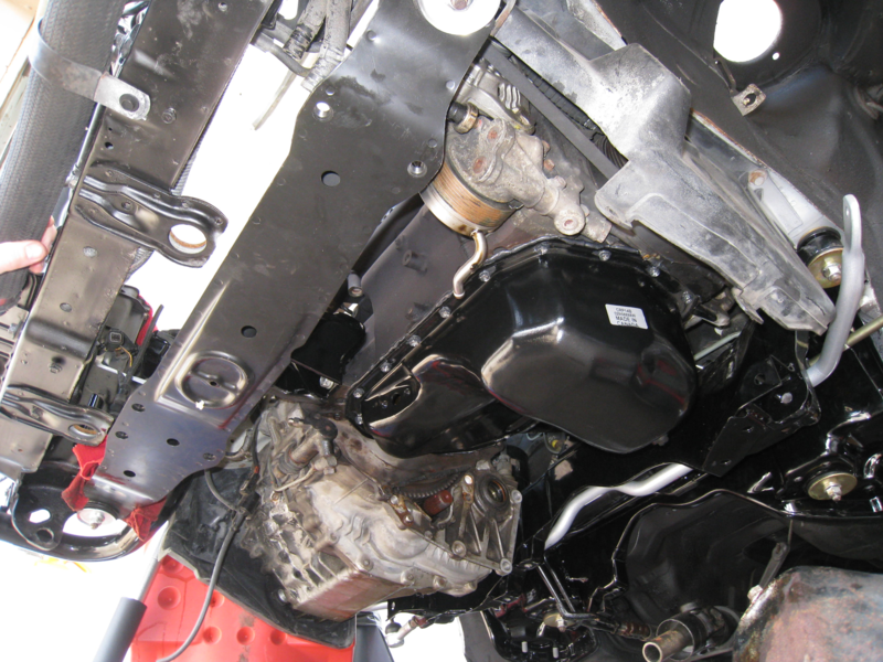

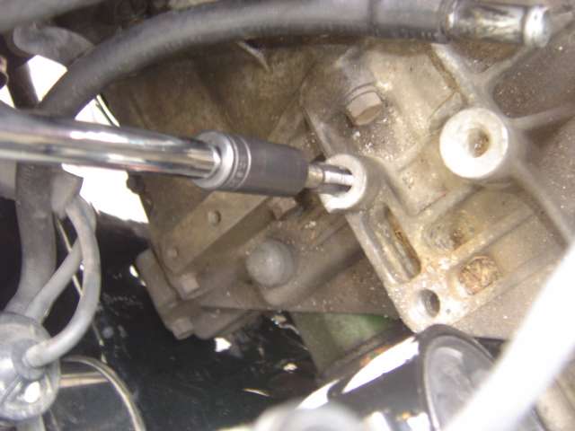

Here's some updates from today.

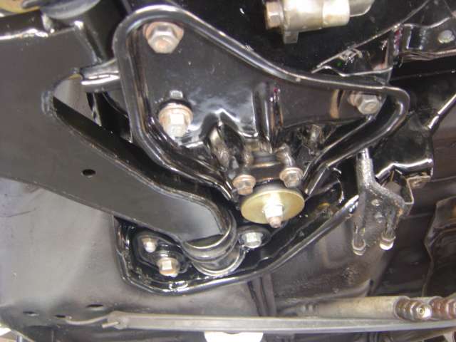

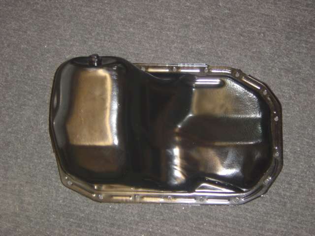

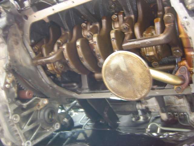

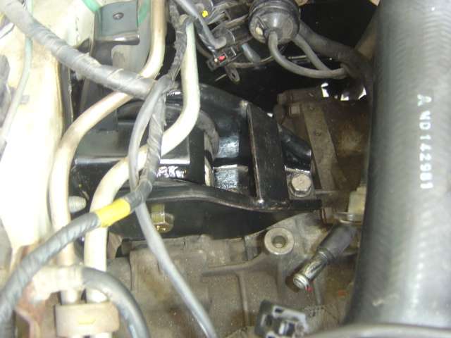

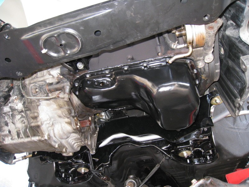

Installed the new transmisson mount (What a pain in the A--). I guess the last owner had some transmisson work done. Because one of the bolts on the transmision was stipped. The impact almost didn't get it out. So had to retap the thread. Also got the new oil pan in and installed that.
Out with the old.
In with the new.
Oil pan

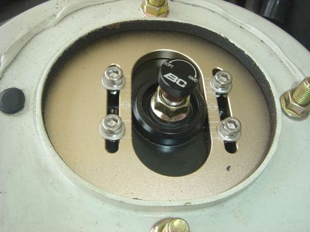

Tomorrow I am hoping to get the coilovers and the lower control arms installed.
GSX_TC
Apr 7, 2011
3,733
Houston, Texas
God its soo freakin Clean man! i was about to say i bet your gonna have a field day with that oil pan but you already addrssed that before i could even say it haha

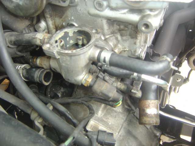

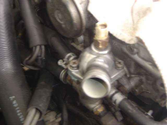

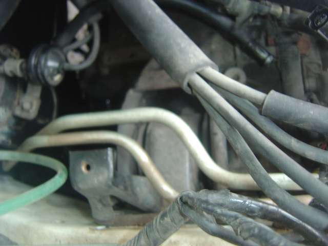

update: Got alot done. Installed all new coolant hoses as the stock ones where really brittle. New thermostat installed and replaced the turbo coolant lines as they where really rusted.

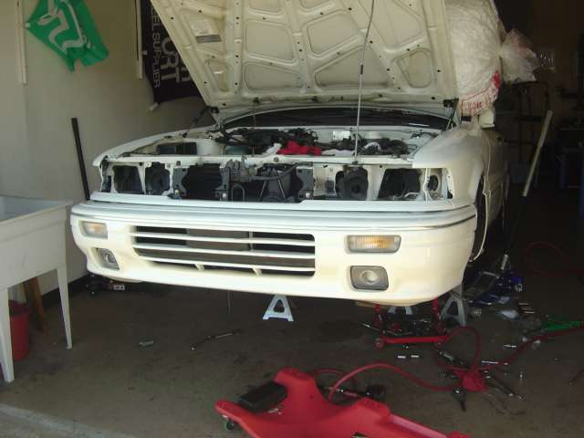

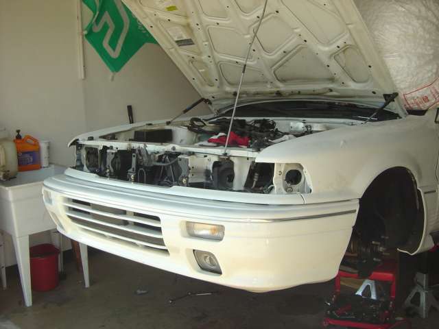

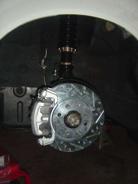

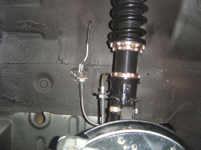

We are taking a break from working on the car today. Thought I would update the thread while I cool down. I think I lost 10lbs today. So hot in Florida.

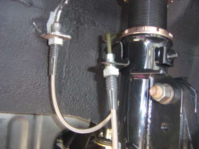

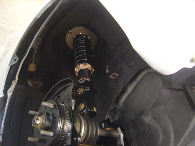

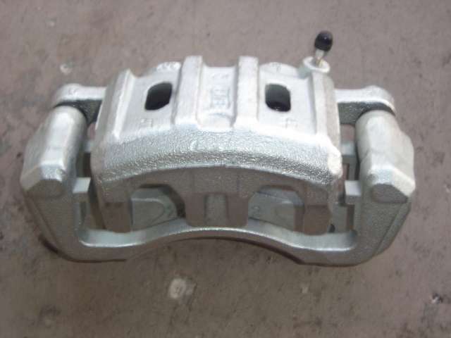

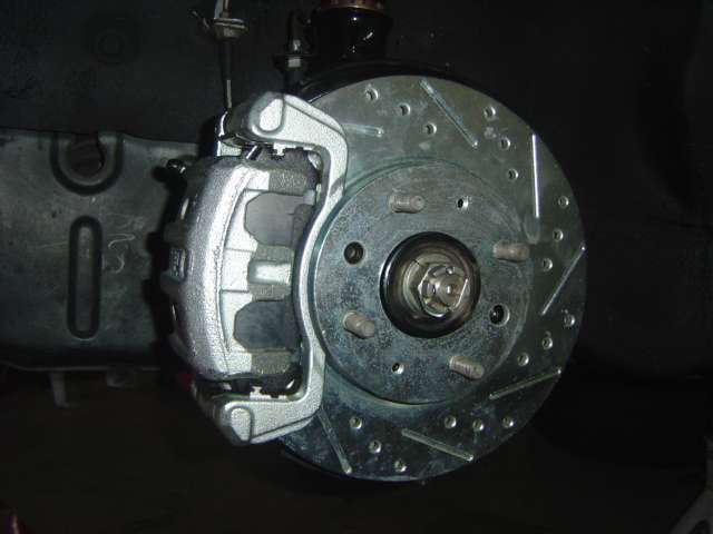

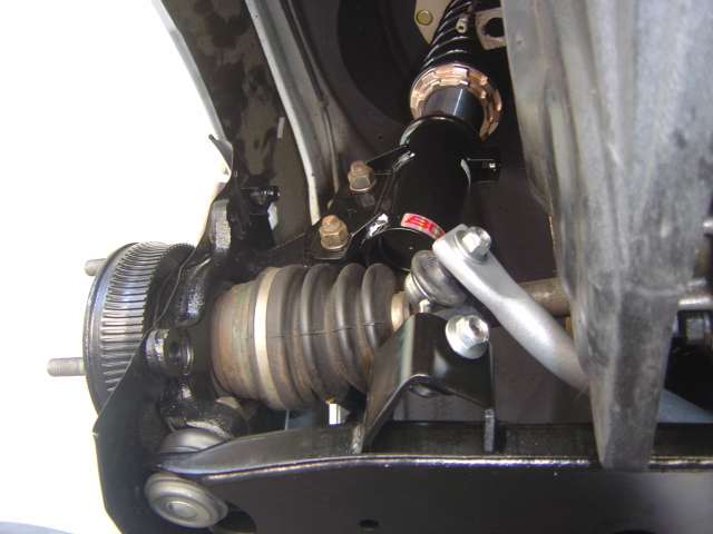

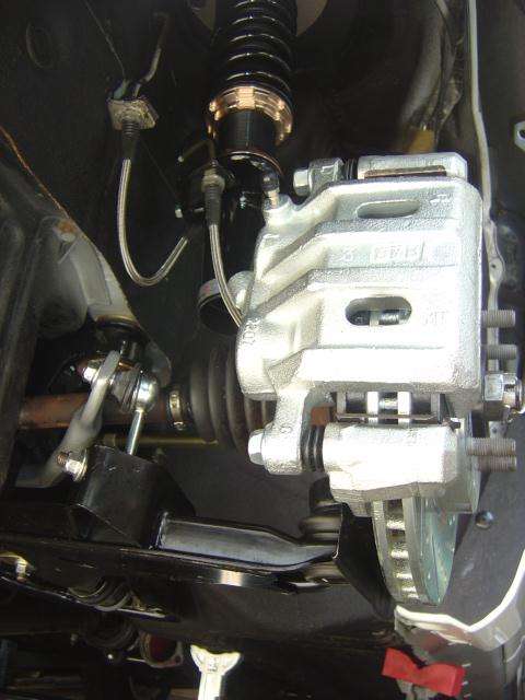

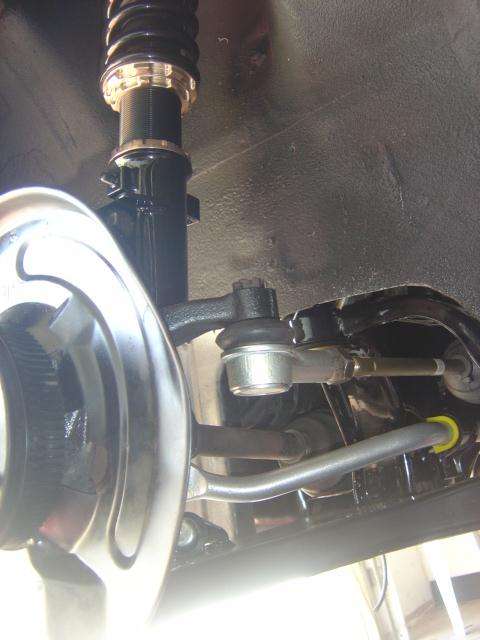

Bumber and fenders back on. Installed the front suspension and brakes.
Brakes:
bobdole
Aug 23, 2007
899
U.K.

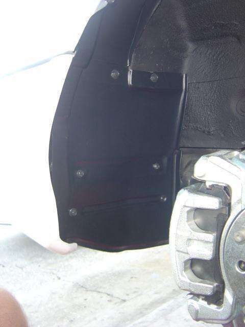

Front is all back together. Just a couple little things to do. Then I can install the wheels and drop it down.
