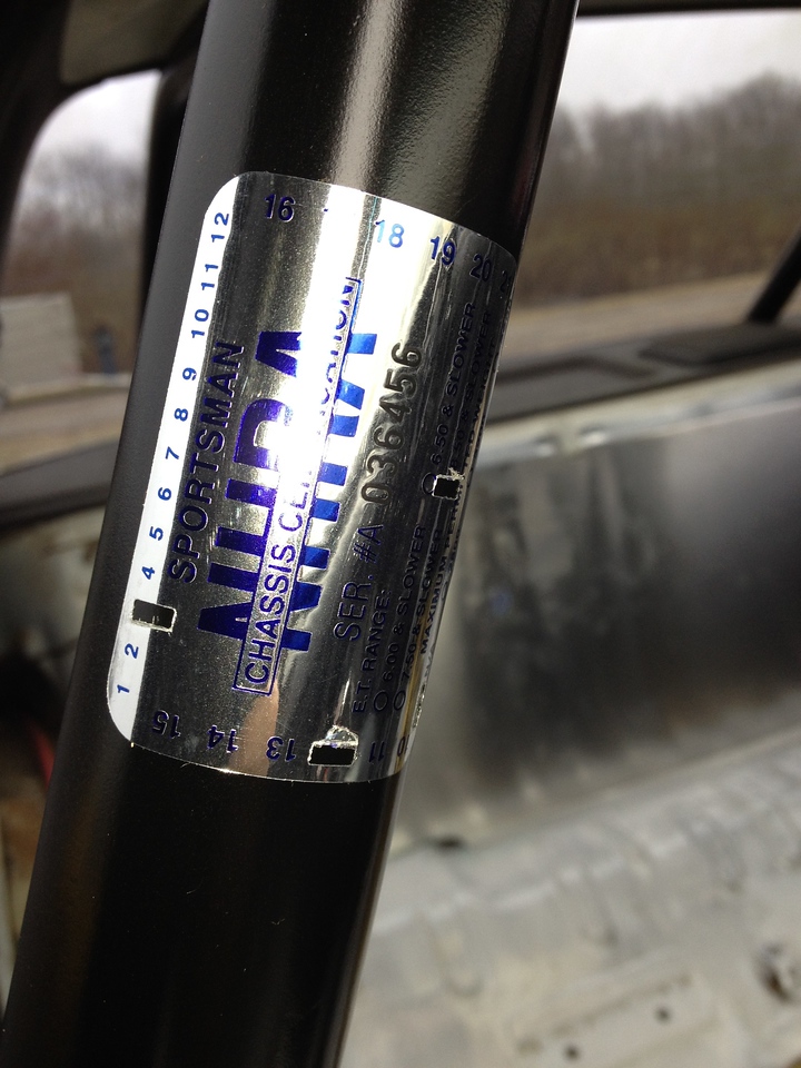

All of the pictures in the members showcase are recent – the pictures in “street trim” were taken at the end of December. The pictures in “race trim” were taken this past weekend.
As for the interior – we had to remove the carpet and seats for chassis certification. The rules also state that the driver has to be seated in a race seat that is bolted to the cage- thus the race seat. The cage was built to fit the galants full leather interior, carpet, center console, door panels, and headliner – the car still has power windows, doors and sunroof as well.
