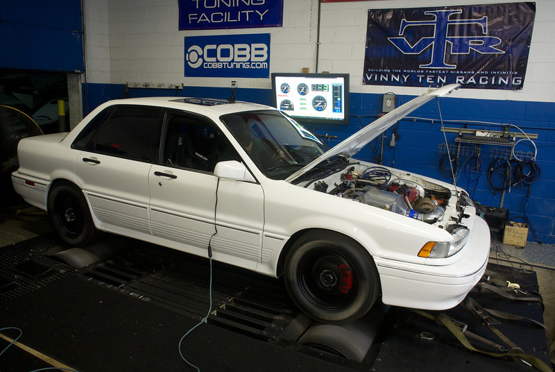

GizmoVR4 and I went out to VTR (Vinny Ten Racing) in Long Island on saturday night to spin the rollers with #431. Our goal was not to set any specific power level, but to simply get the car back into quick 1/4mile shape after 2012's "waste of season" that ended abruptly with not a single decent pass. Nelson took the car about a month or so prior by himself, but wasn't able to make any pulls as there was a setup/tune issue with the car misfiring/bucking which we guess attributed to ethanol buildup on the injectors from fuel sitting stagnant all fall season after the track blowup. So Saturday was simply a night to get back on track, sort out our issues, and redeem ourselves. Ideally we wanted to leave with a car that will go mid 9's again at the 1/4 track.
We are back on the T3 based FP3794 turbo (screw that GT4202). A Fresh 2.3L with the better Manley steel rods & Eagle 100mm crank. Standard 1g head w/ 1mm+ valves and GizmoVR4 intake manifold. Same HKS280* cams. PowerMist E98 fuel. FIC2150 injectors, DSMlink V3, yada yada. We are back to the "small" turbo that enabled 1.3 60' times with the restalled oem converter. The dry nitrous kit is still in the car, but we don't intend to use it anytime soon.

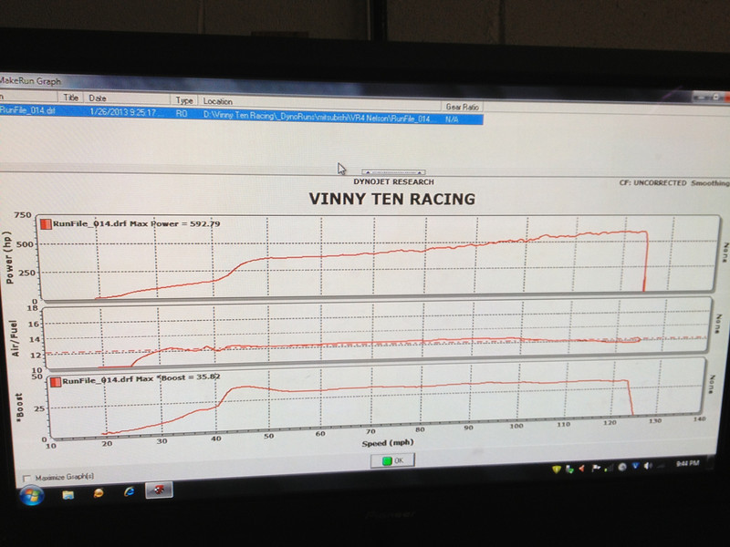

Second pull was 592whp at 31psi @7800rpm and again the trans shifted itself. WTF again....then I figured it out....the trans shift controller was using the 1-2 shift RPM setting (7600) as the timer doesn't know we were manually going up to 3rd. DUH! This run was with basically the same tune, just ice water and pulling 5* of timing out across the board to see if the knock sensor activity went away. AFR was pretty fat past 6500rpm. knock pretty much gone now.

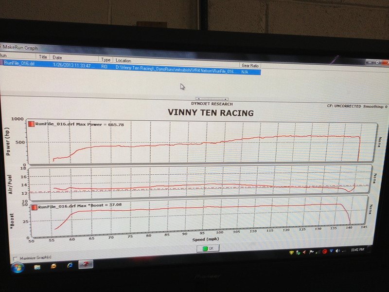

9th pull..... up to 8600rpm. boost steady 35.5psi, AFR averaged 12.0, max timing 17*, AIT 46->68*F it made 665whp. powerband is "FATTY" IMHO. It breaks 500hp down at like 5800rpm and holds 600+ from about 7400 up to 8600. very flat and broad. Im impressed and Nelson is more than pleased!

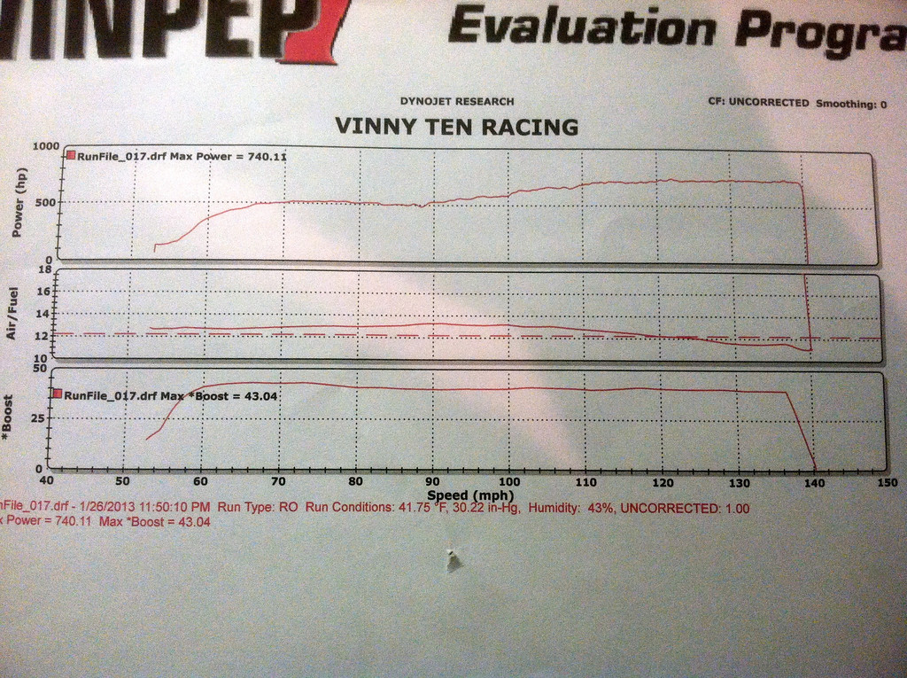

Last pull: 740awhp. up to 8600rpm again. Boost set to 40psi. Max timing 18*, AFR about the same..the SD map needs some fine tuning, but today wasn't the day for that. same "fatty" power band just more of it (breaks 500hp as early as 5200rpm on this run). Little bit of wheel spin on the dyno as we left little piles of black dust behind each roller.
