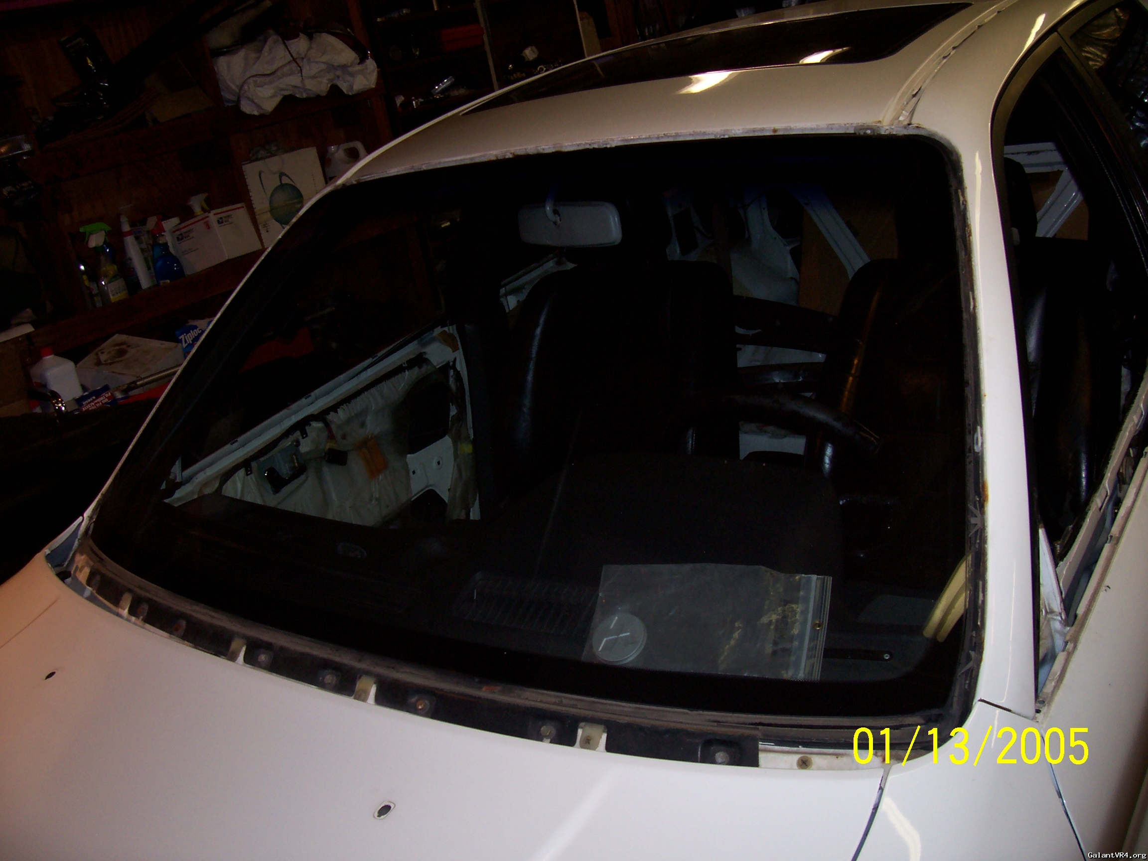

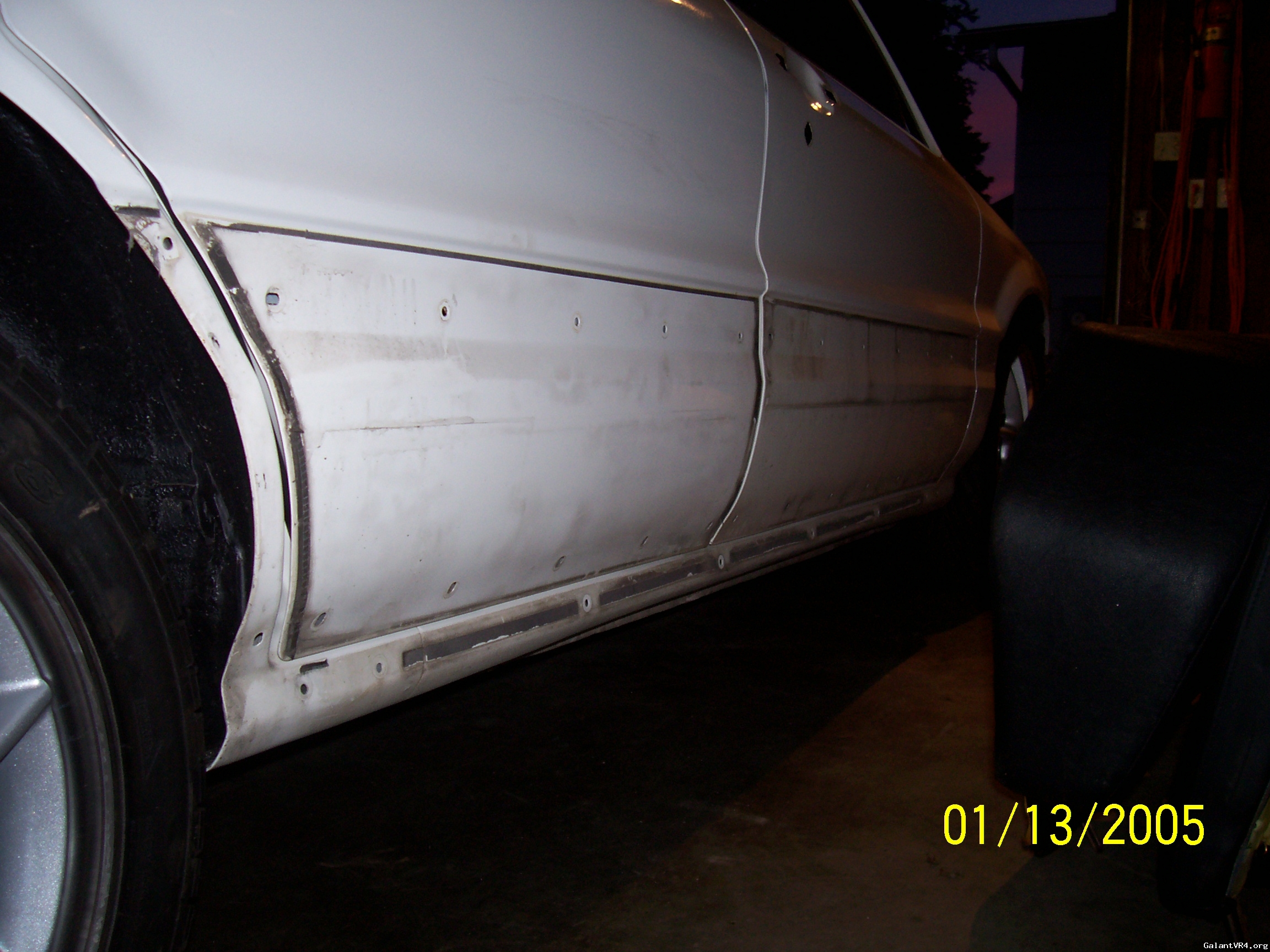

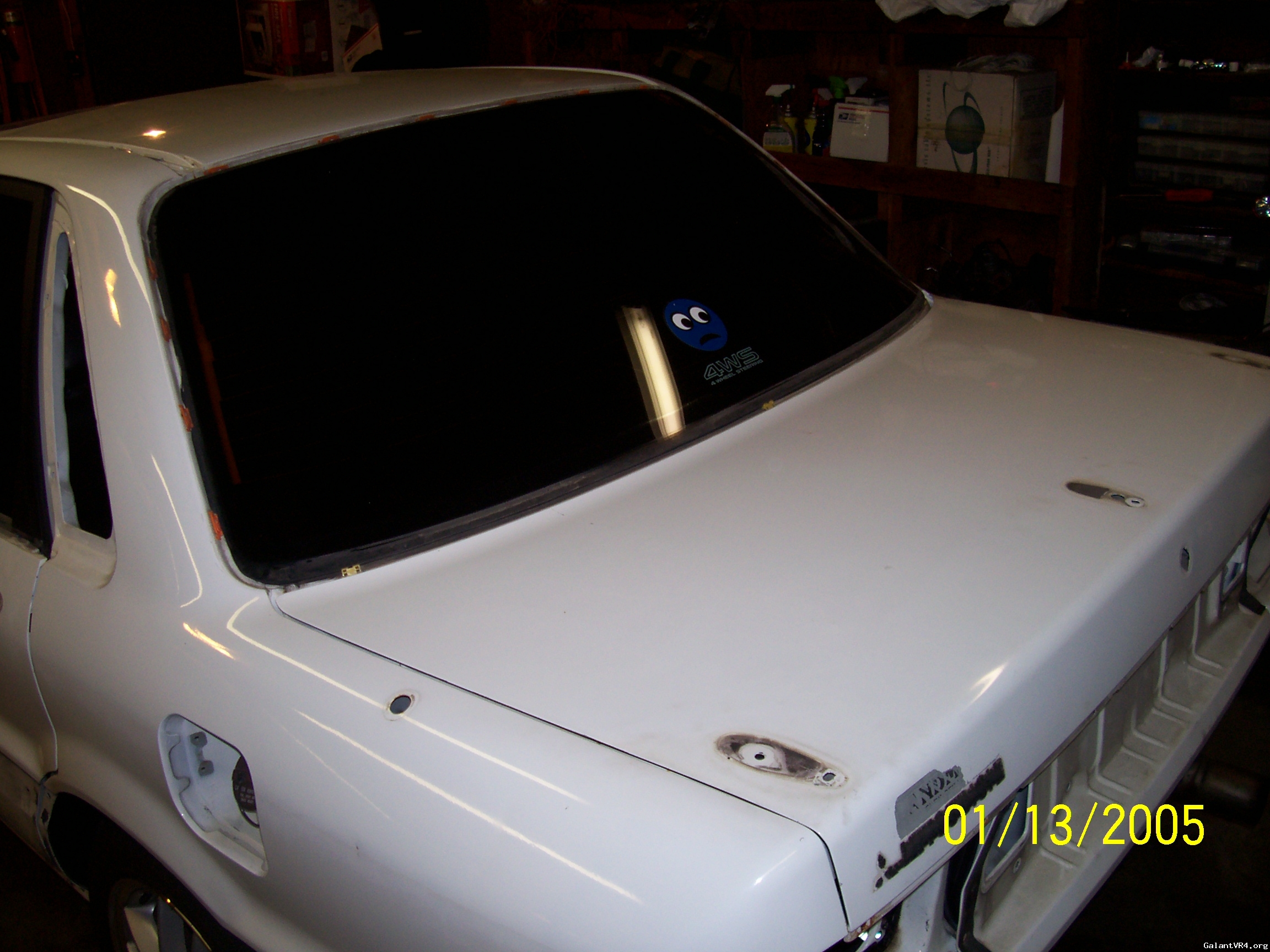

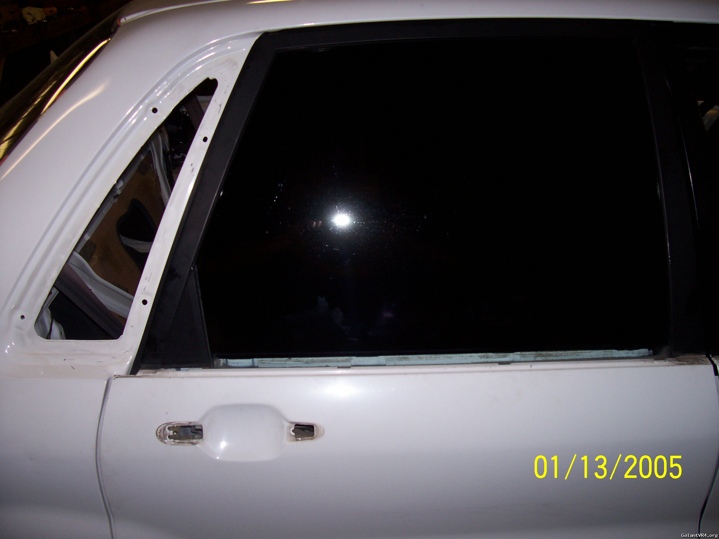

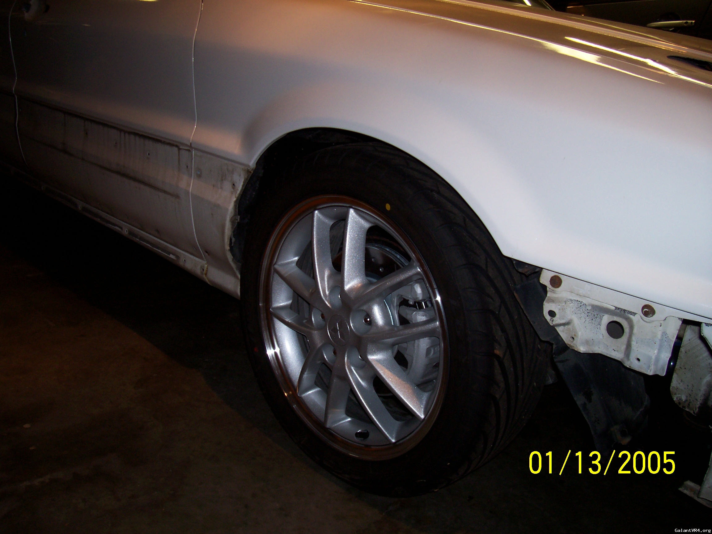

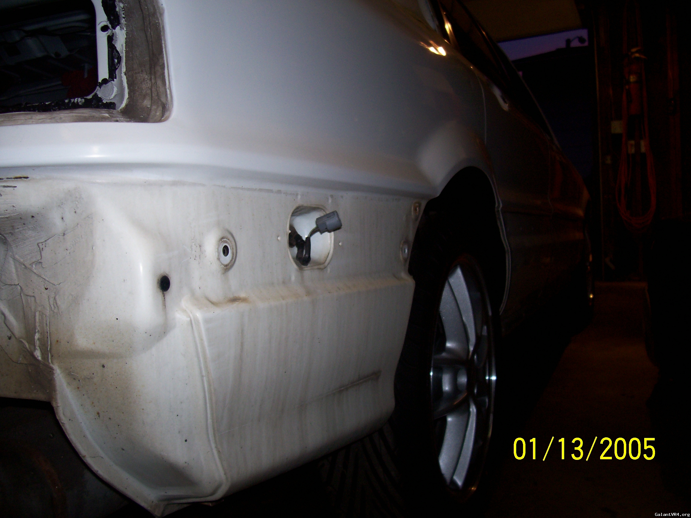

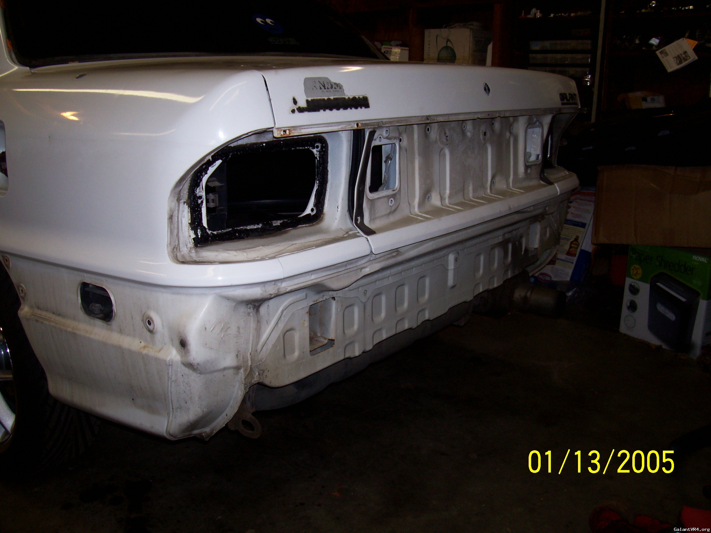

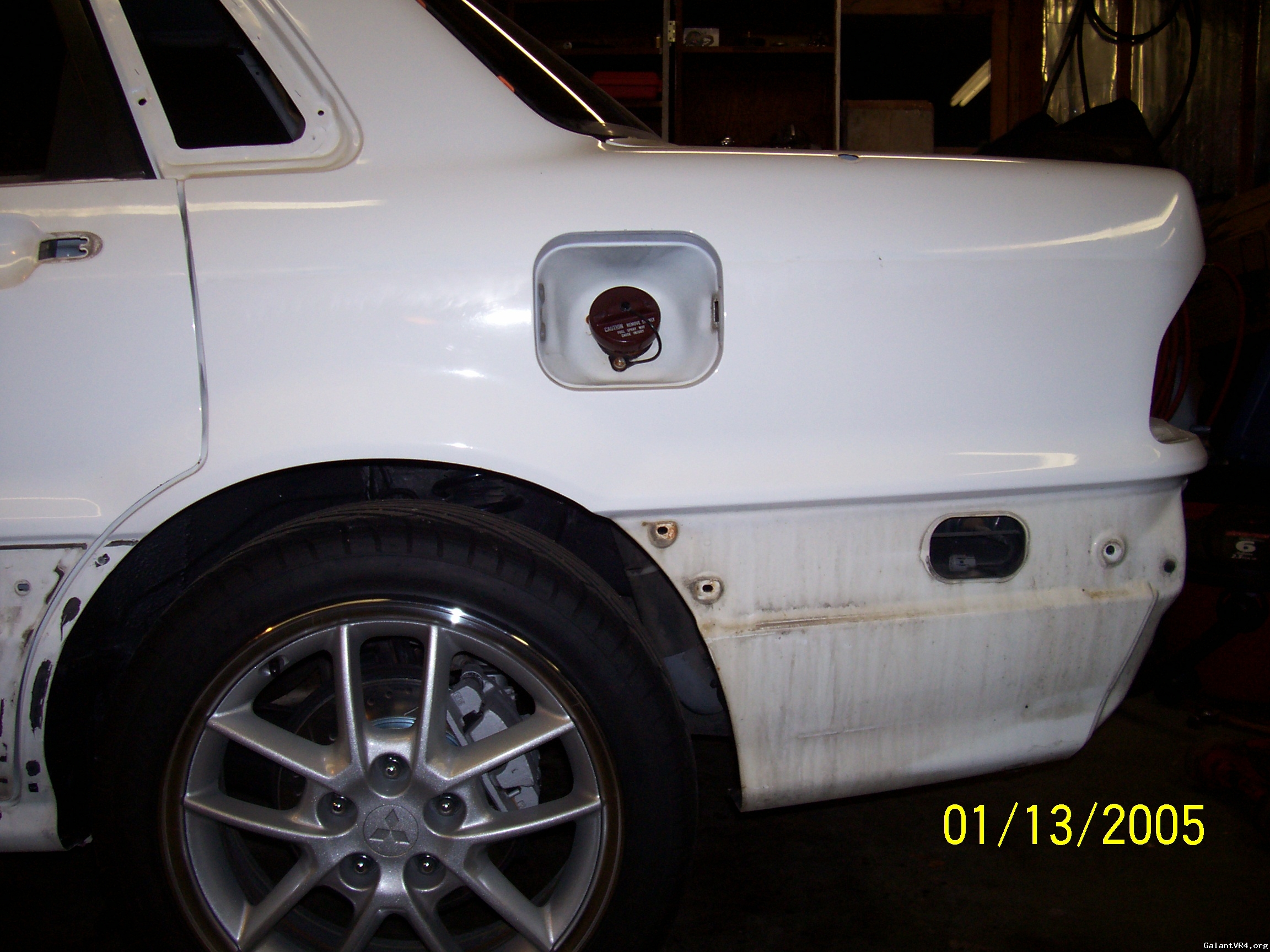

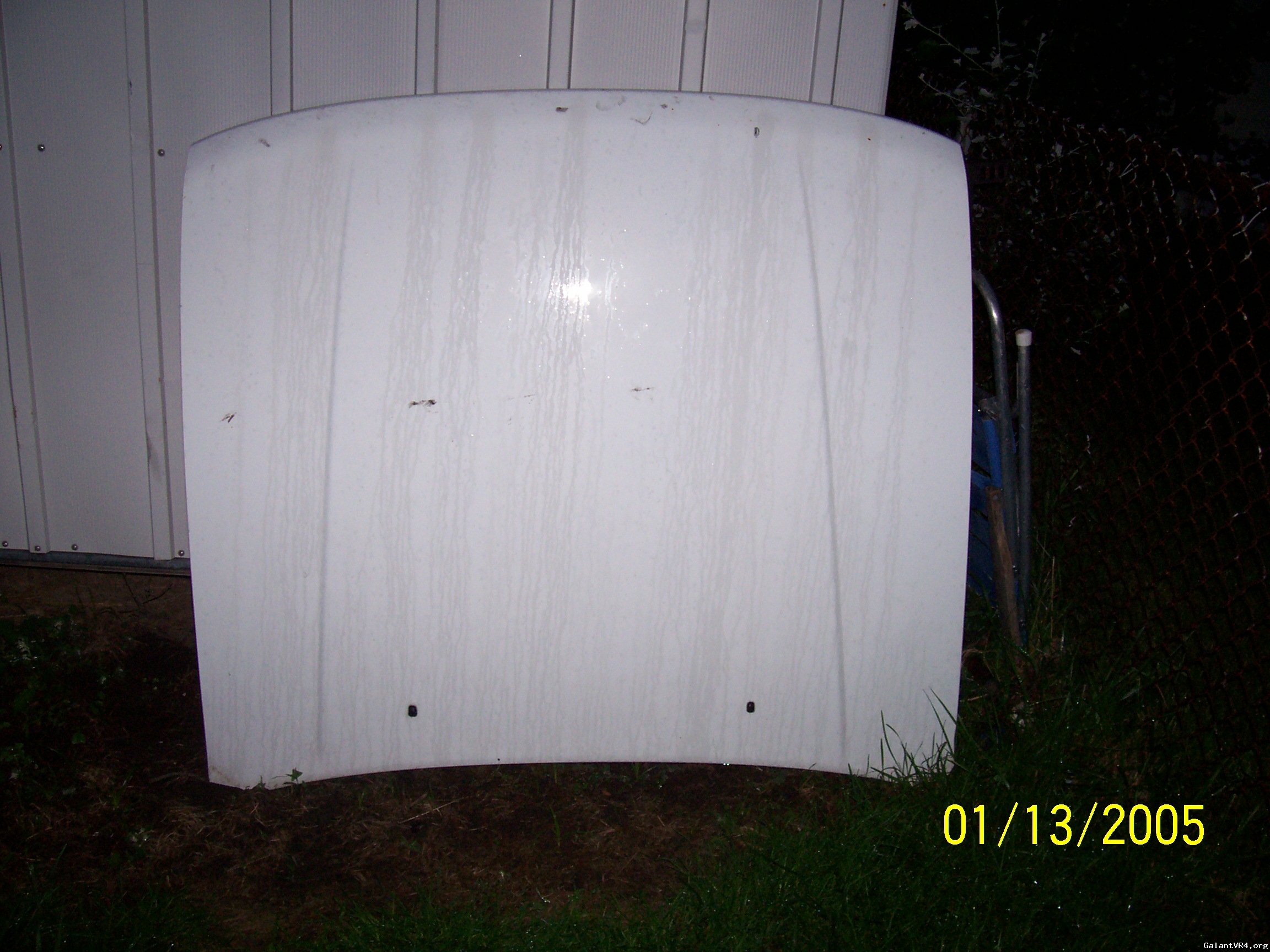

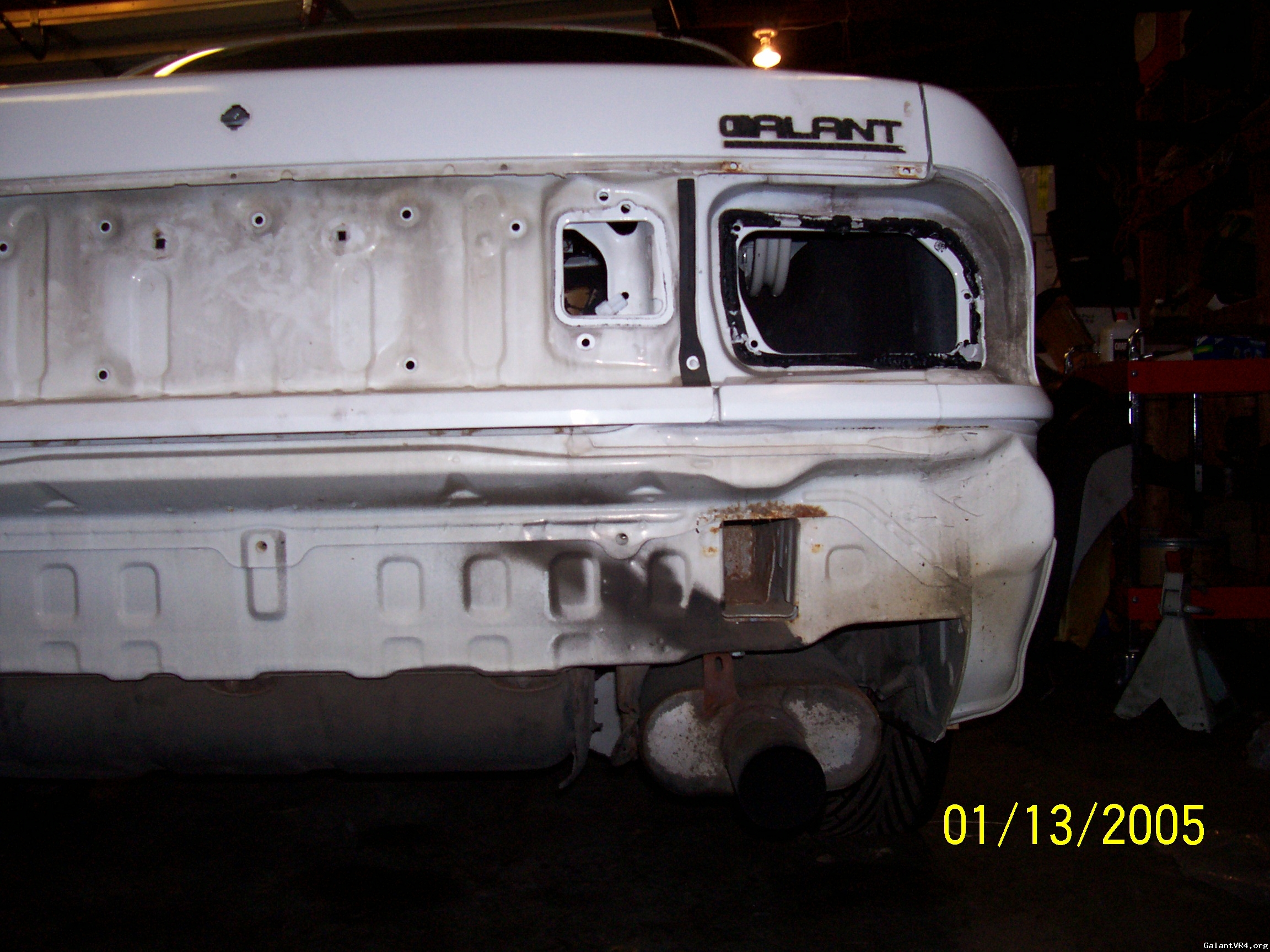

This is how it went to the painter. Ignore the date stamp /ubbthreads/images/graemlins/banghead.gif
I did the whole disassembly and re-assemble. Tom Lindle (local painter - also did my 88 GTA back in 2000) did the body work (minor dent/ding repair) and paint.

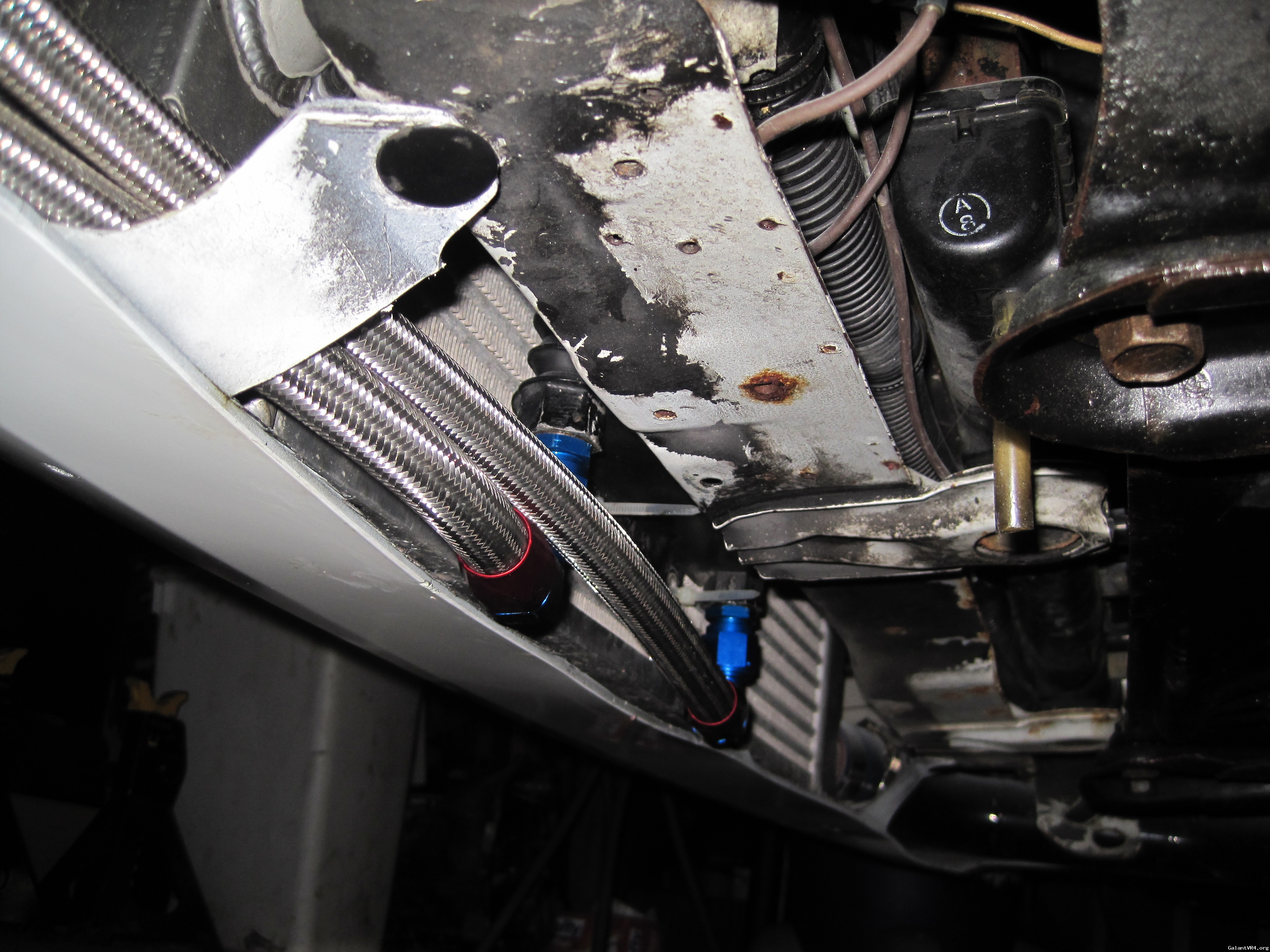

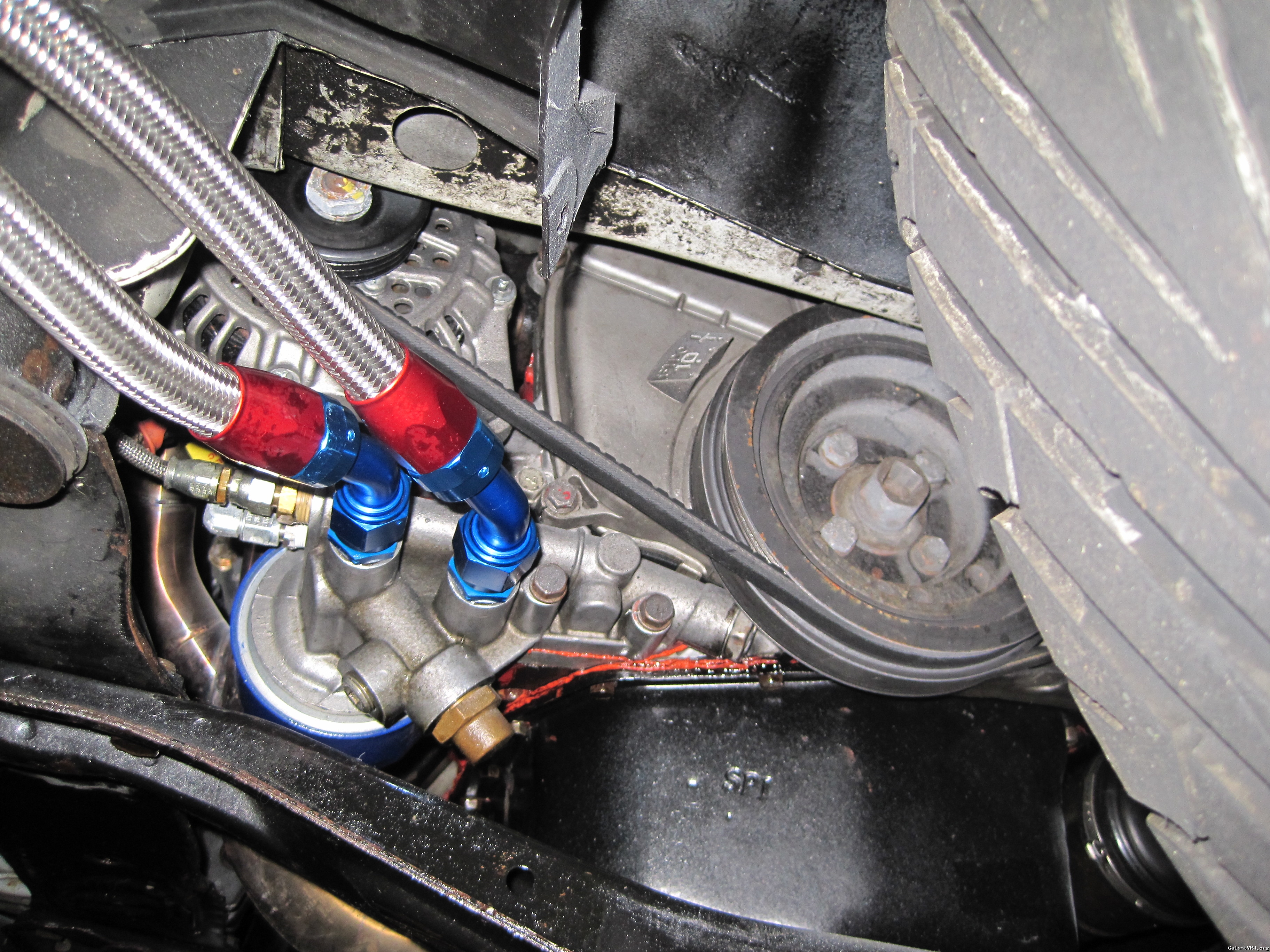

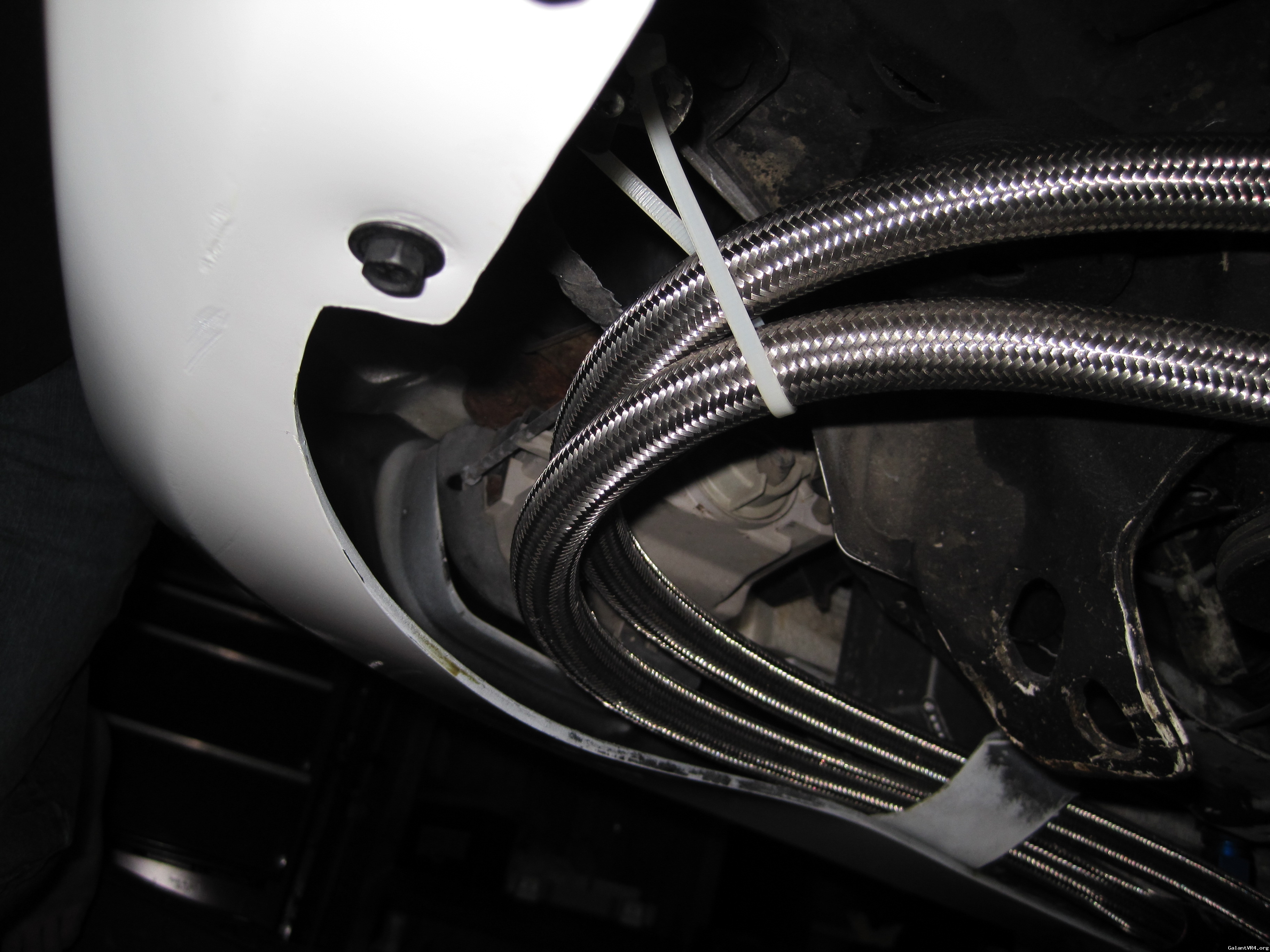

I just received my box-o-parts from Summit today that held all the oil cooler line parts. $180 worth (for just 2 lines) /ubbthreads/images/graemlins/ooo.gif Not happy about that. But I guess it was money well spent.
I basically used:
4 9919FFJ Earls 16x1.5 to an -10 adapters (2 for the filter housing and 2 for the stock cooler)
2 SUM-220086 an -10 45 deg flex fittings (attached to filter housing end) Summit brand is a few dollars cheaper and they look exactly the same. (Thanks Car racer)
2 SUM-220087 an -10 90 deg flex fittings (attached to cooler end) Summit brand is a few dollars cheaper and they look exactly the same. (Thanks Car racer)
10 ft of stainless braided an -10 hose
4 - recycled stock banjo washers (with the rubber inners - for the sealing surfaces on the Earls adapters)
I cut the hose into 3 pieces. The first one was 31" and the second one was 41" (shelved the rest). I used black electrical tape to keep the braid from fraying and my 4.5" angle grinder for nice clean finished ends. I cleaned the hoses of rubber particles and used my air compressor to blow out the hose to make sure NOTHING was in them.
I used a very little dish soap to lube the fittings to allow the assembly of the ends to be a little easier (a bench vise makes this an easy job). Hand tightened all fittings and then used a wrench to very lightly tighten the fittings down. Started the motor and even at 80 psi (cold start-up pressure) not a drop leaked. /ubbthreads/images/graemlins/cool.gif
Refilled the oil level (lost a full quart).
