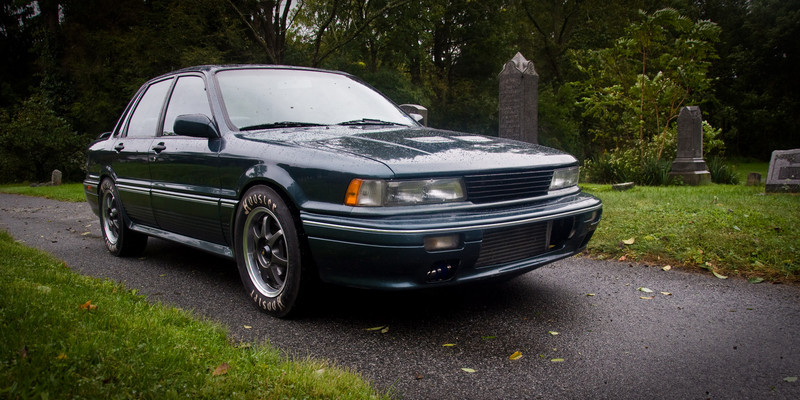

I did some new mods on #139 this week since getting back from vacation in florida:

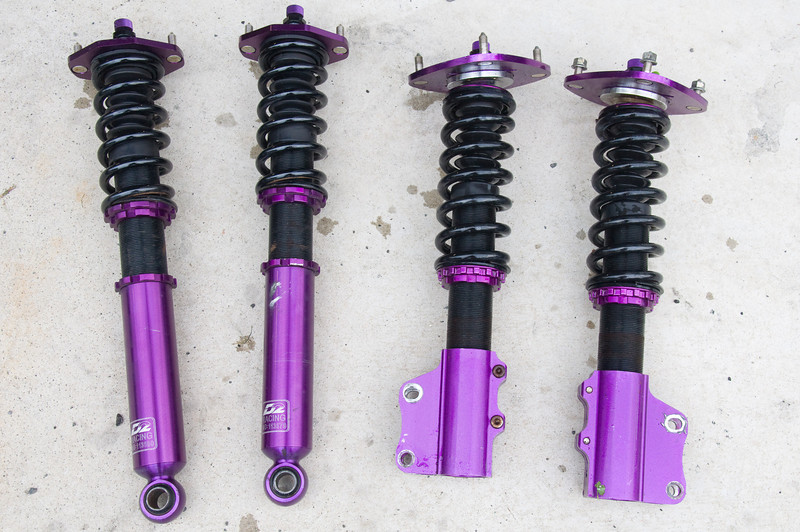

Set of D2 coilovers I picked up. They are used, but seem to be in great shape. Cleaned up nicely.
Weights: Fronts are 12.25lb each, the rears are 8.25lb each
Replaced standard type shocks that came in at 18.75lb & 13.5lb each respectivly.
Total weight loss from coilovers: 23.5lb
I left the height adjustment at what the previous owner had. I'll work on the adjustment and alignment over this week. I'd like to find a height setting that rides well and can fit my track tires without having to raise it. if not, no biggie to raise the car every time the tires change. I'd like to find the correct wrenches for the shock instead of using the hammer/punch method..didn't get the tool with the shocks. /ubbthreads/images/graemlins/bawling.gif

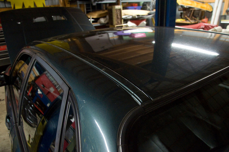

YEAH. I got a nice set of green roof rails. Thanks Matt! That was the last exterior part I was missing. (still need to change the rear bumper cover and ditch the 50lb support)

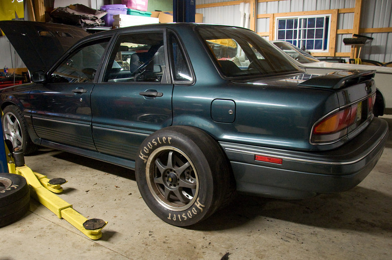

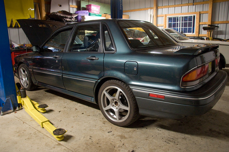

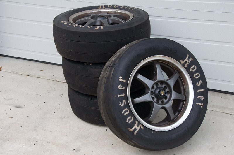

Also picked up a set of Hooser QTP's (26 x 9.5 x 16). Mounted them to a set of 16x7 prime wheels I had around, unfortunatly the wheels are hefty 18.75lb. The hoosiers are 17.5lb each for a total wheel/tire combo weight of just over 36lb. The 17" street wheel/tires shown above are just over 39lb, so another 12 lb off the total weight. That's 12lb of rotating weight too.
While I should gain a TON of time in the 60', I will lose some gearing due to the tire height as these are quite a bit taller than my street tires. Whatever, Ill take 1.5's over 1.8's and spinning through first. /ubbthreads/images/graemlins/devil.gif
Can't wait to get back to the track /ubbthreads/images/graemlins/grin.gif

quick question to anyone that might know. seems there are two adjustments on the shock:
the lower coil mount is obviously threaded as well as the lower mount. I'm not really sure on how to go about adjusting it. Lowering the spring perch lowers the car, but also reduces shock travel. So should I be adjusting the vehicle height via turning the shock body within the lower mount?
11,982
Changing the height of the spring perch compresses the main spring, changing its rate. If you wanted to go lower than the height of the spring, it would rattle around like a set of Ground Controls. Since you have adjustable bodies, adjust those for ride height instead.
My Tein HA's don't have adjustable bodies, but they use helper springs under the main springs so I can adjust the height of the spring perch without compressing the main spring or letting them dangle. The helper springs compress under the weight of the car so whether they're compressed or not at full extension doesn't matter.
Ok, ground controls are the only "coilover" setup Iv ever used myself previously, where the only option was moving the perch. But this really does make alot of sense in that you can adjust the ride height without changing the shock travel. Nice. Can't wait to play with it tomorrow. hopefully there is enough thread left on the shock body to raise it an inch or so to fit the taller tire.

anyway, the tool is no big deal. Franks has an extra and Iv sent an email to D2 to see about them sending me a set along with any instructions/papers. Ill get a set somewhere along the line. All I did to clean them up was a quick rinse in degreaser w/ paintbrush action. Boy you aren't kidding these are stiff! /ubbthreads/images/graemlins/ooo.gif
The hoosiers all hold air fine and have plenty of meat left. Can't wait to get them on the car and try a 7000rpm launch /ubbthreads/images/graemlins/devil.gif /ubbthreads/images/graemlins/devil.gif /ubbthreads/images/graemlins/devil.gif If they pull my 60' from a 1.82 down to a 1.5xx that should take my 11.9 @ 120 to something in the 11.3 to 11.4 range. oh, I can't wait. Im thinking next wednesday for a track trip.

yeah, they are pretty big tires, Id say a solid 3" taller and 2" wider than my street tires (215 45 17). Plus they grow at speed.

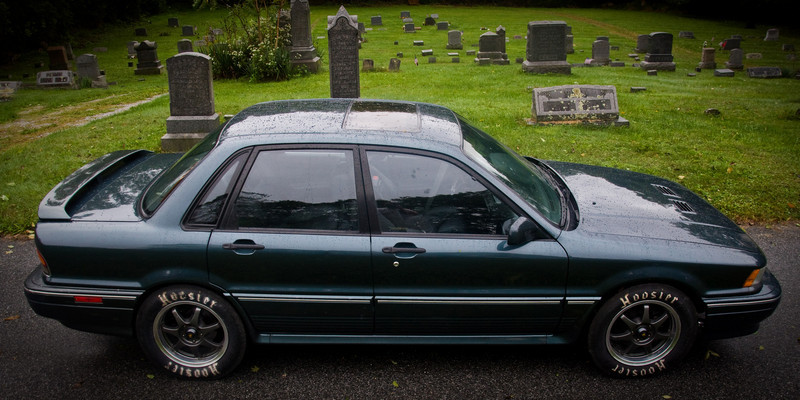

Fresh coat of wax after a full body rub with polishing compound. Rear bumper cover needs to be swapped for a matching paint one, and front cover need TLC for tar/bugs/chips
Love that AEM Tru-boost controller. works awesome.
