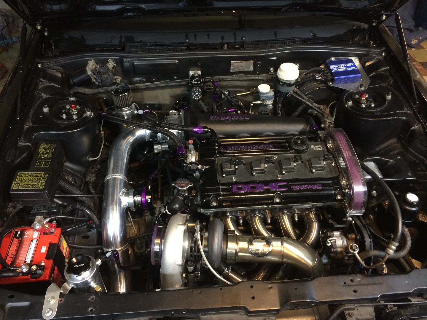

Spool with the 2.3 is amazing. So amazing, in fact, that the transmission decided to let go Sunday night. The car made a lot of torque, and it lasted me a couple years. So, I'll get the trans rebuilt, as soon as I get home from NZ, then when I get back from AUS I can put it back in.

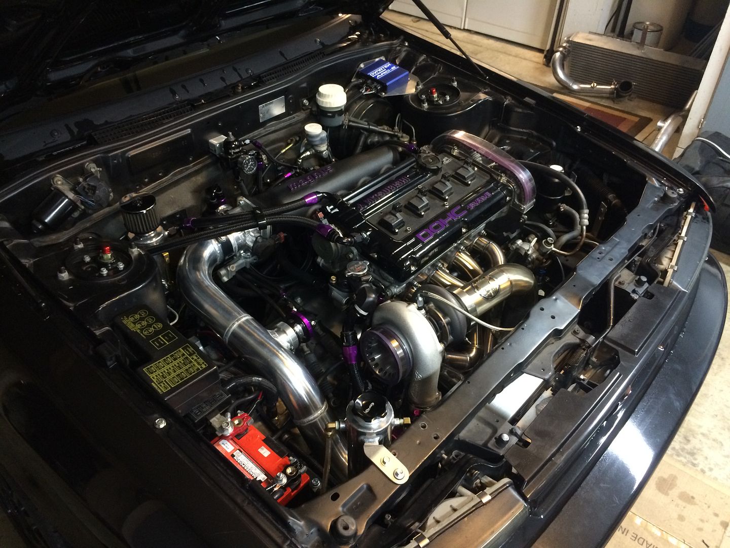

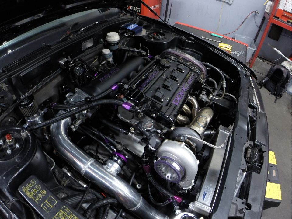

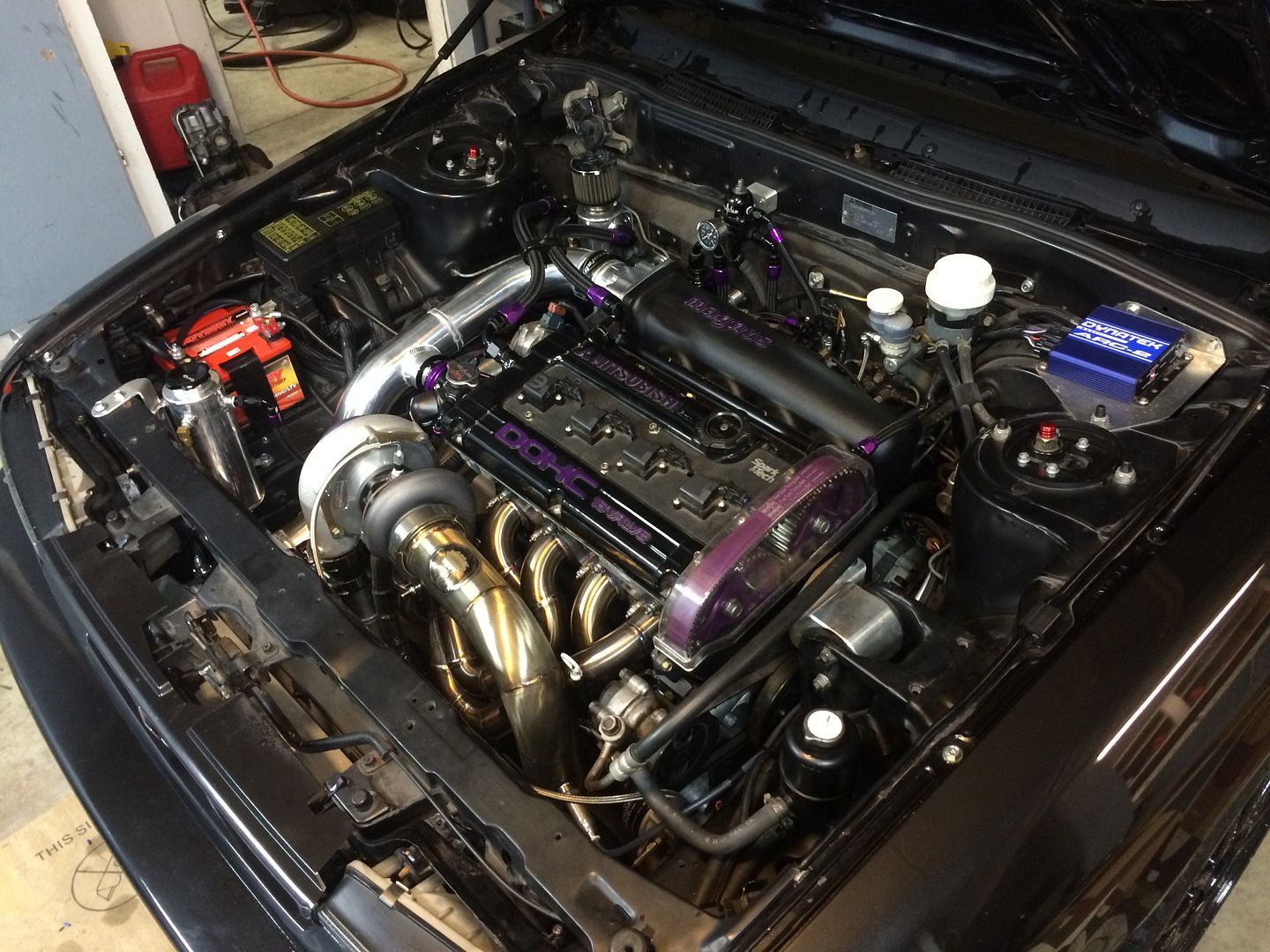

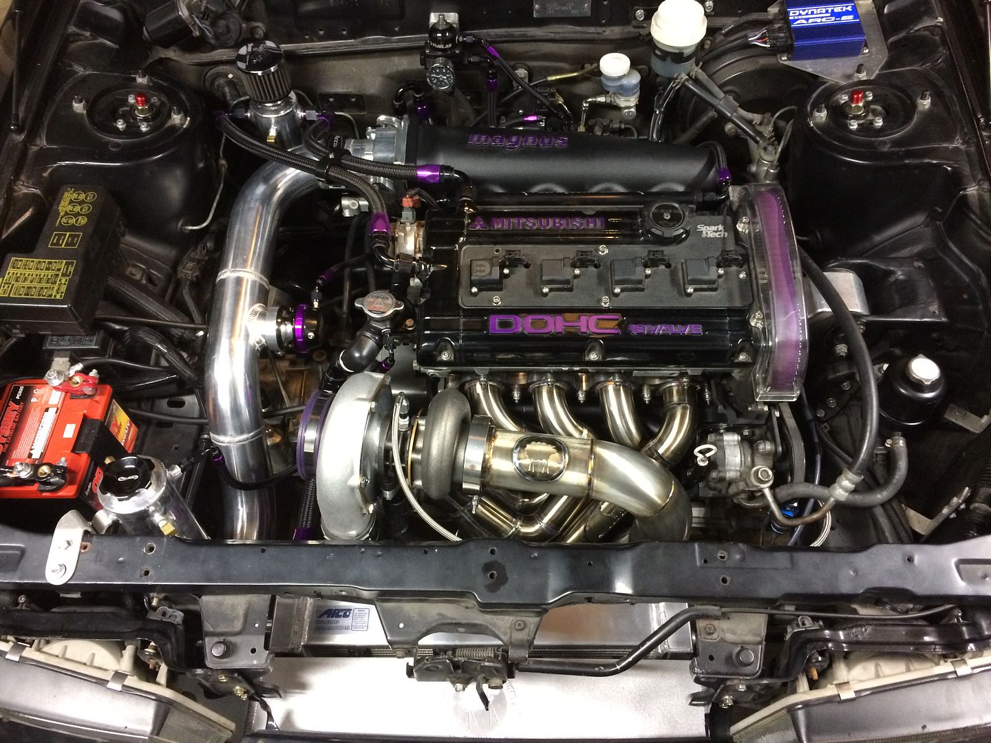

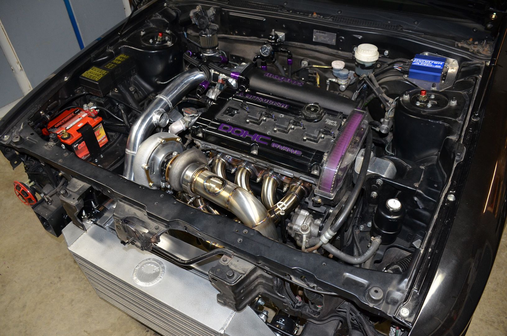

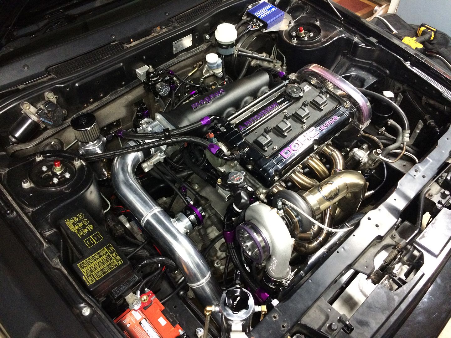

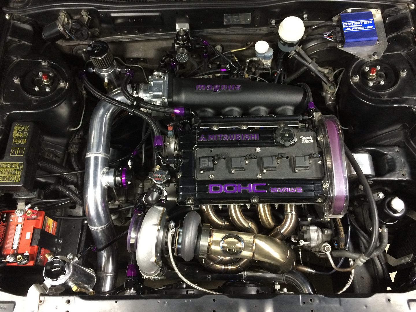

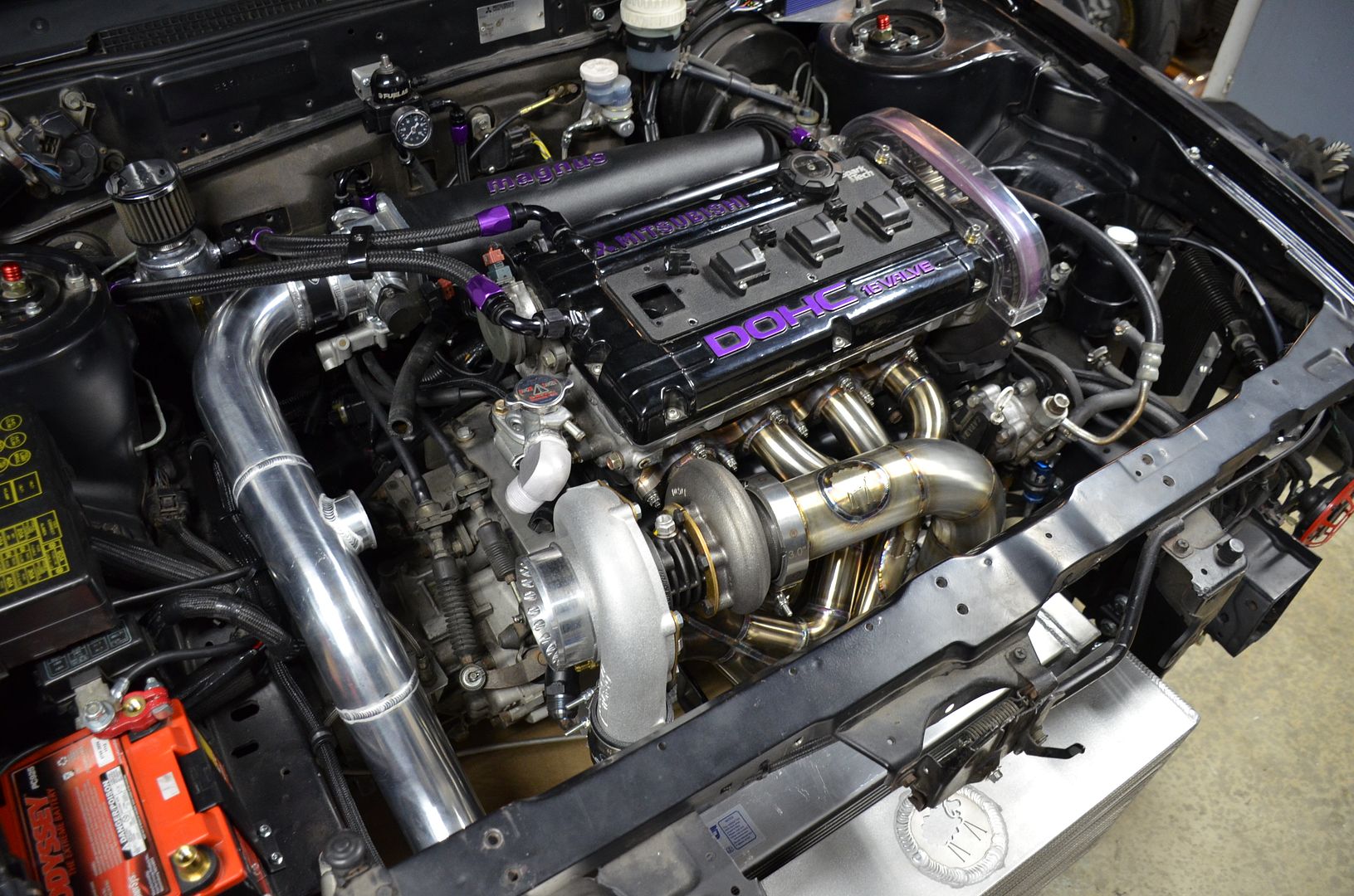

Onto the pictures! Still lots to do, but I'm happy for now. Also, disclaimer: the air filter is temporary. I have room for a cone filter and will put on on, just have to modify the coolant over flow a little first.

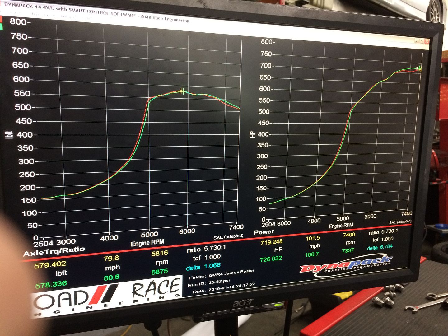

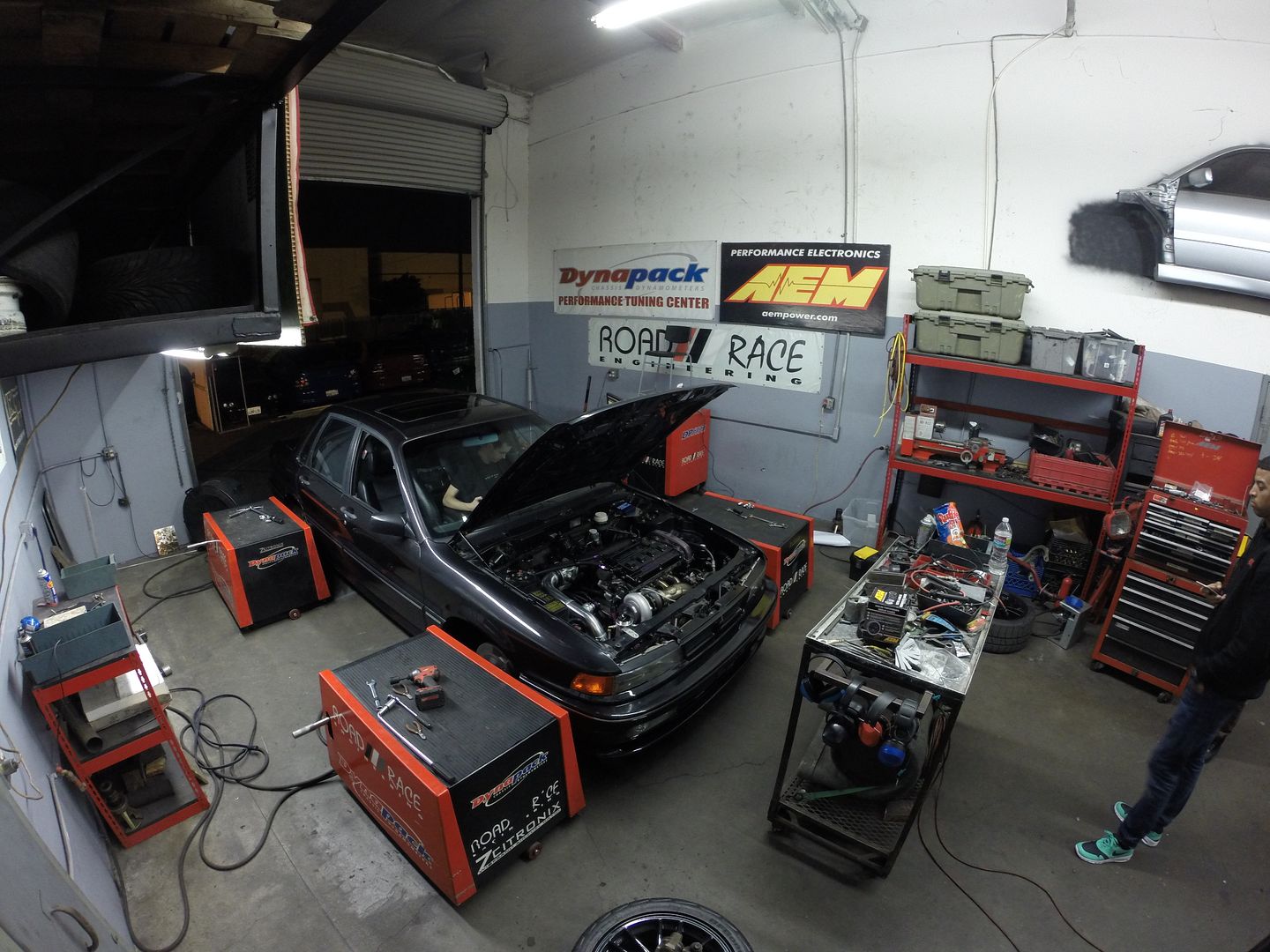

Dyno Pull video I made, on YouTube: High Horsepower Mitsubishi Galant VR-4 #674/1000 Dyno Video
Like I said, it'll make more power at higher boost if I put a 4" exhaust on or do one out of the bumper, but I like my full exhaust. And 730 is enough power for me, for now, lol. Maybe I'll do a full 4" exhaust someday.

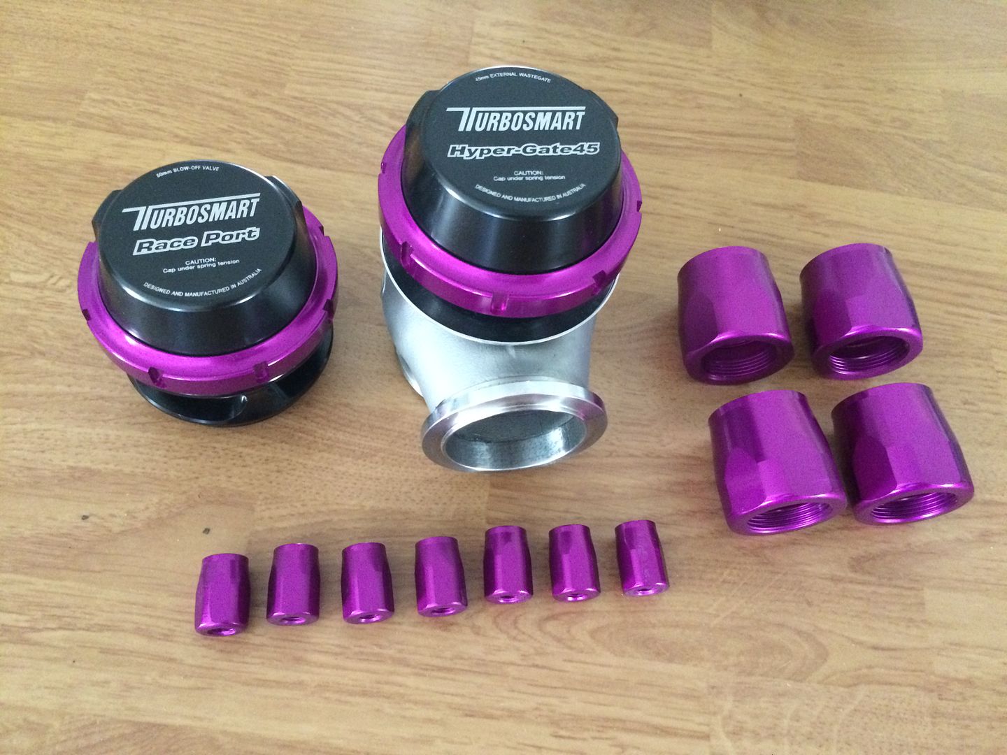

I had these anodized

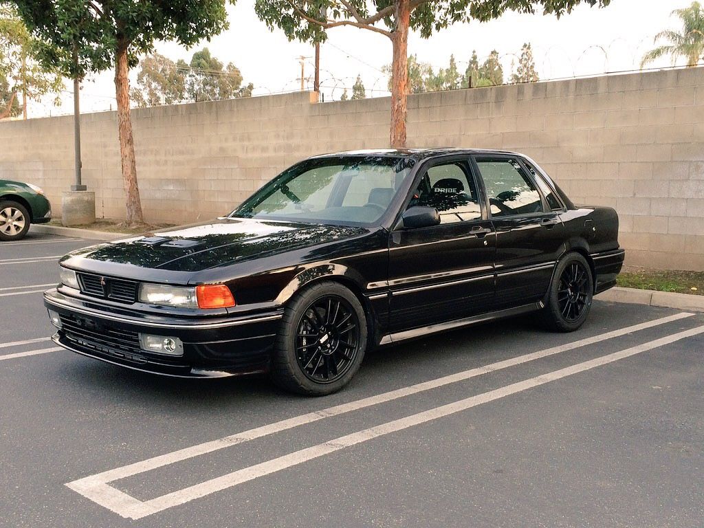

Absolutely beautiful work. Easily one of the top VR-4s on the board. Looks amazing and has the performance to match. Good stuff, James.

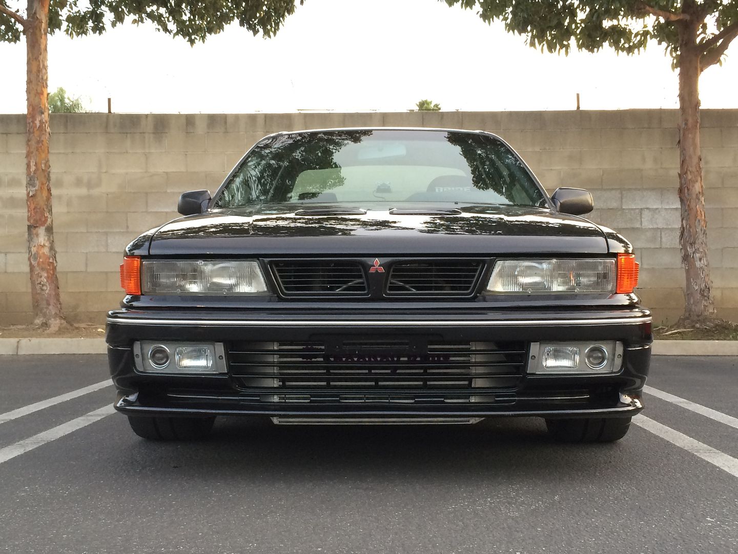

For serious James! Doin work! Big props for going wingless too, car looks amazing. I will say that powerband makes me cring but I would probably pee my pants when it did finally kick in. I'll race you if we both have to shift at 5k. /ubbthreads/images/graemlins/laugh.gif

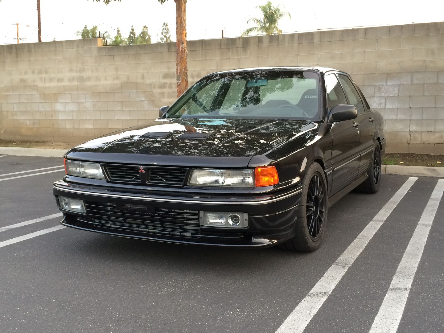

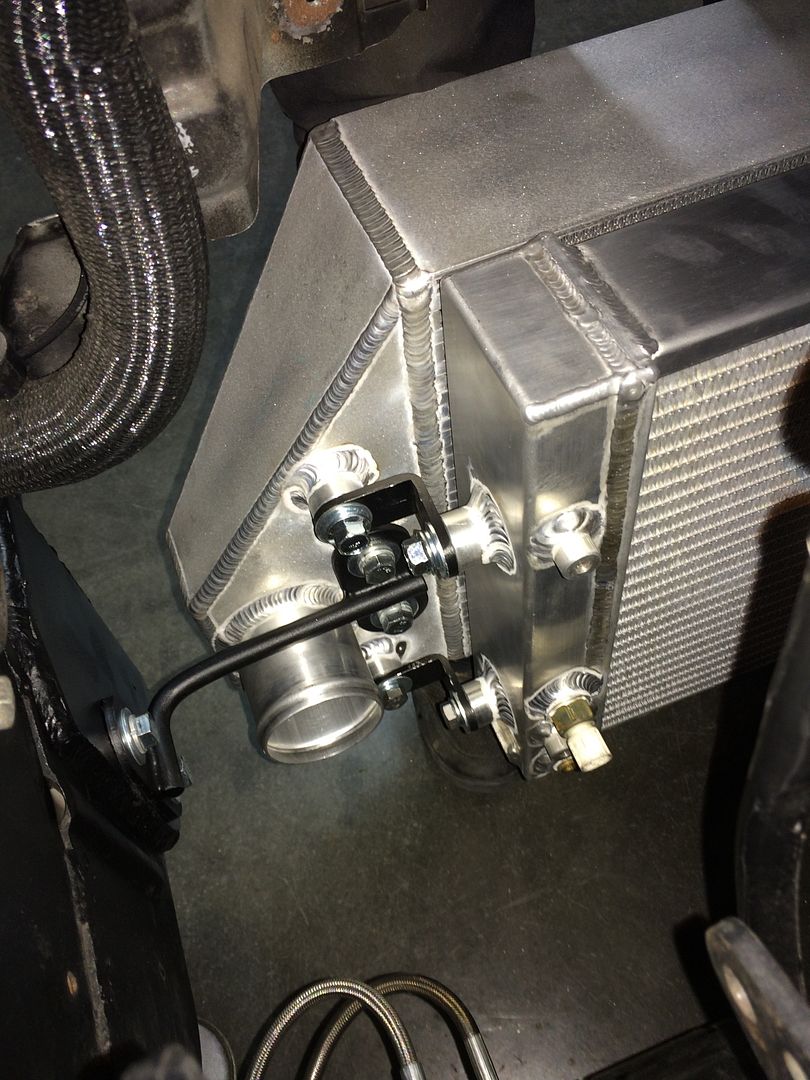

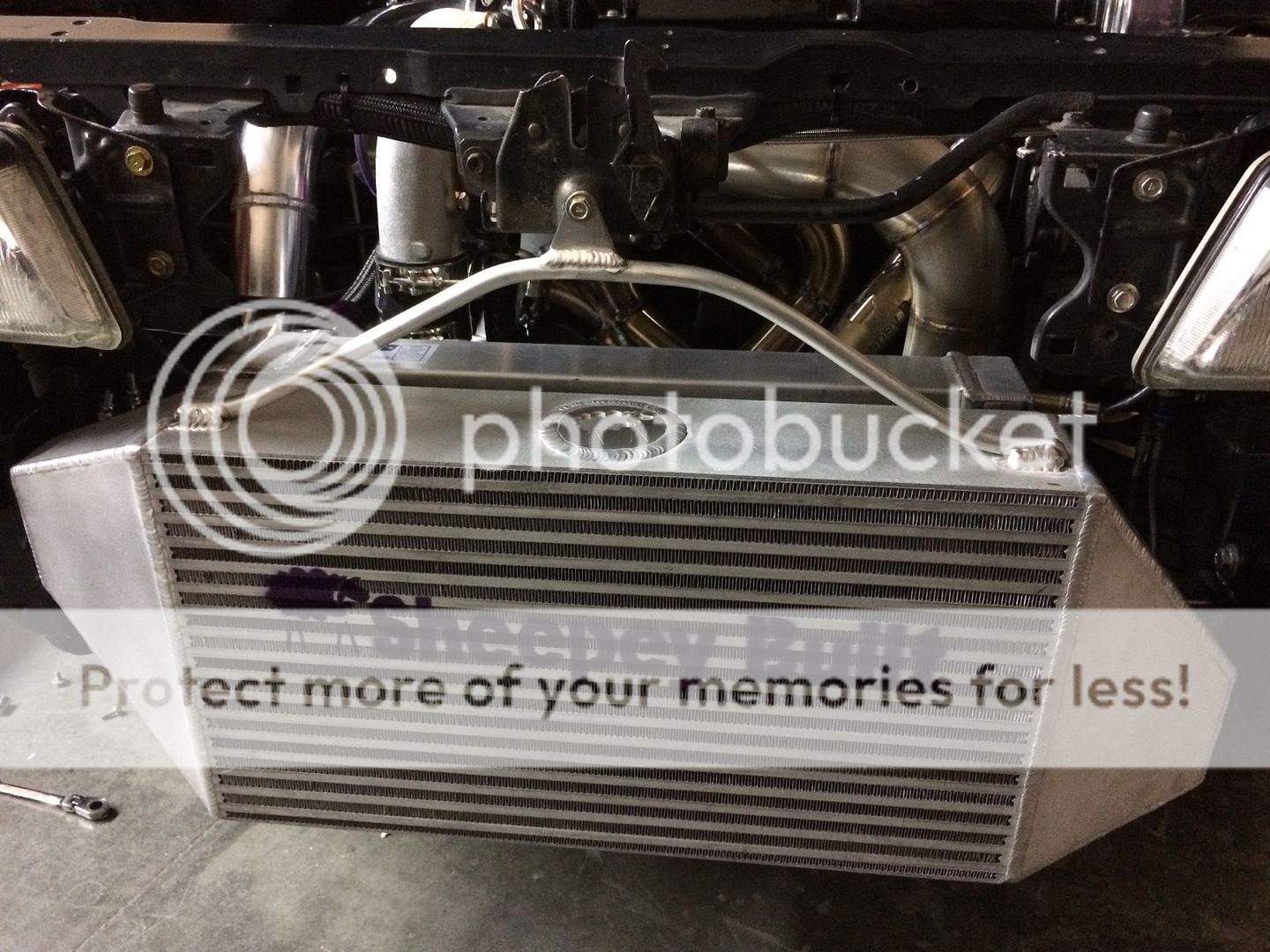

The level of detail on this car is amazing, very nicely done. although I think you should get a lip for the front bumper to hide the bottom of the intercooler sticking out.
Not a bad idea. You have to get all the way down on the ground to see it though, but I definitely am aware and extremely careful driving around.

also is that a smiley face welded on the bottom of the radiator?
Haha, yes. Charlie's artwork, lol.

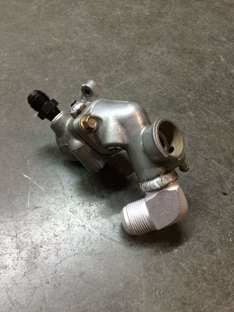

What's the cylinder pictured right with the hose coming out of the top?
strokin4dr
Aug 30, 2005
2,770
Savannah, GA
Looks like a 2g accumulator/restrictor. Was a fairly common addition for the twin disk crew from what I remember seeing. I always pulled them out of the 2g's haha.

Yeah it's a 2g accumulator, slightly slows the flow to the slave to help with engagement on twin disc's.

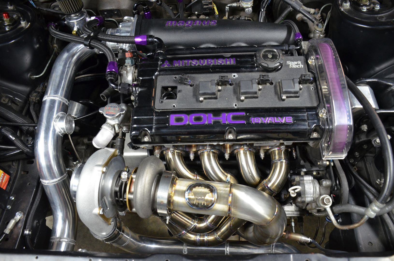

Looks awesome, getting hot down there /ubbthreads/images/graemlins/worthy.gif Should of ceramic coated that thing.
