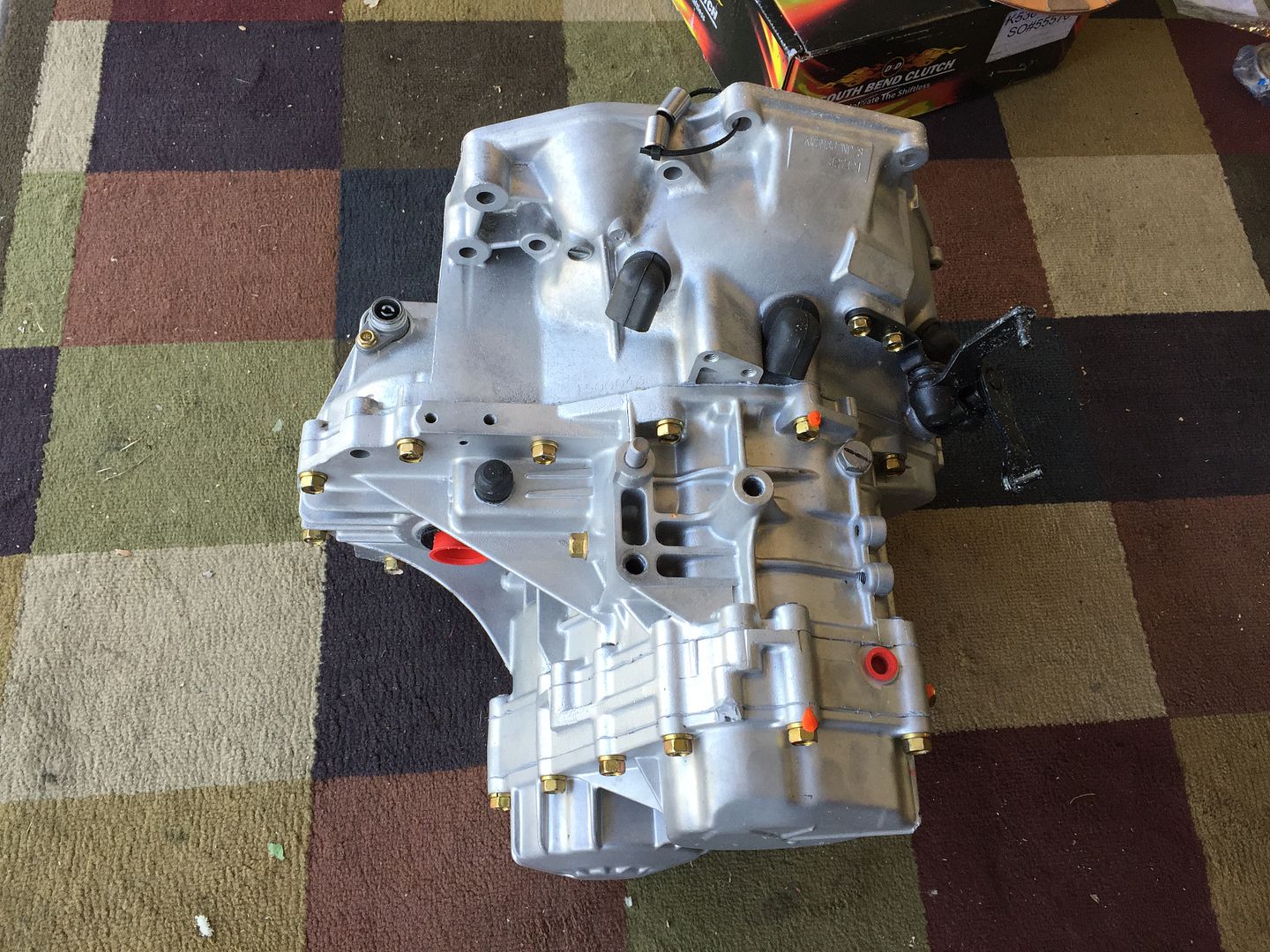

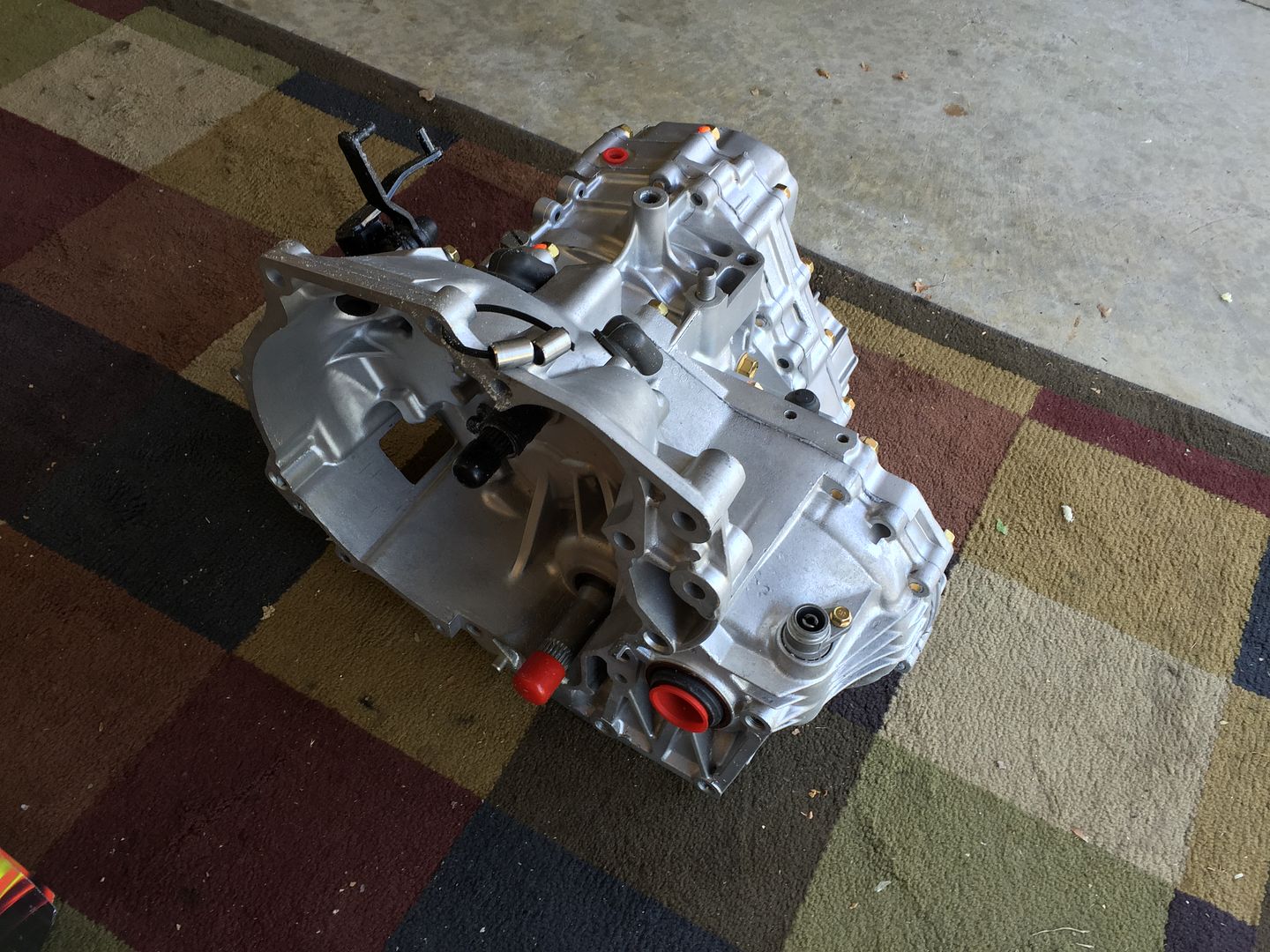

Lol, thanks guys. Looking forward to getting home and putting in the new trans and clutch.
LIV4PSI
Nov 24, 2011
1,774
O-H-I-O
Looks great as always James. It's awesome how quickly you get everything installed once you get back home.
What specifically failed on the last transmission?

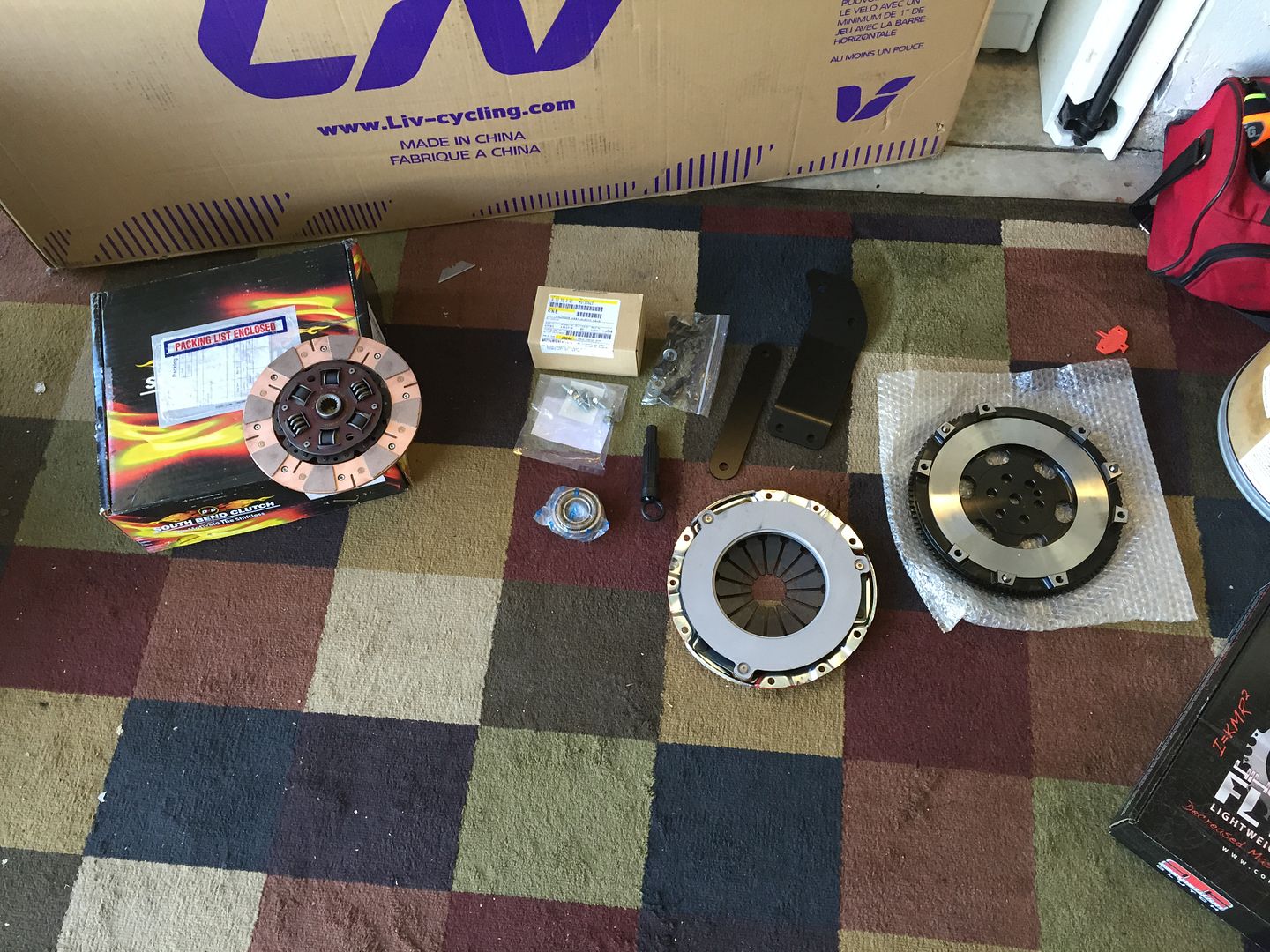

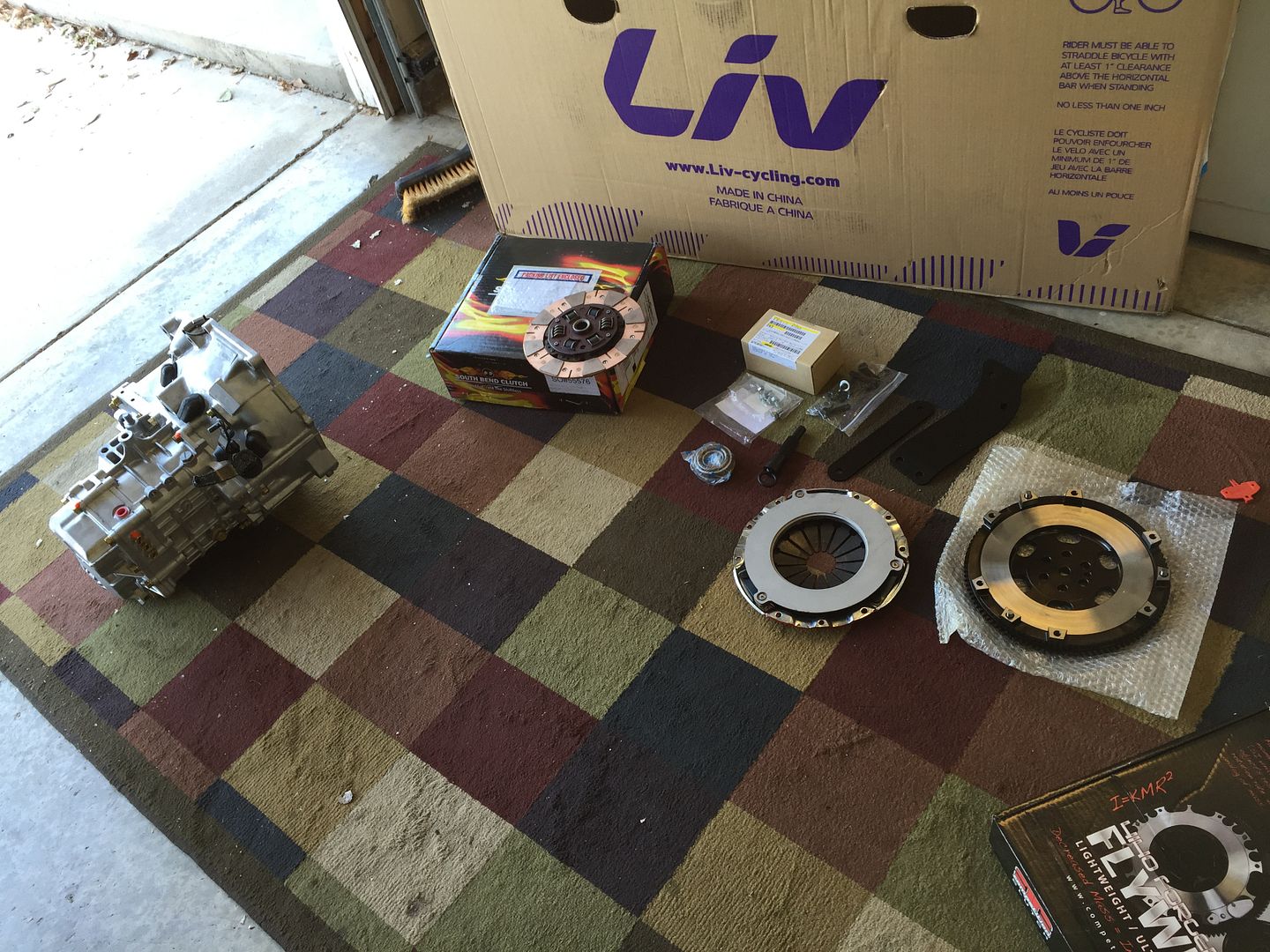

very curious as to the clutch also. looks like some competition clutch parts, flywheel forsure. didnt you have a twin disc in there before? your making quite a bit of power for a single disc (from my researching)...

Thanks guys. It's the South Bend SS-X PP with full face ceramic disc. click
From Jon at TRE:
"Obviously you twisted the input shaft in two but you also managed to include the following:
Strip about 10 teeth off the intermediate shaft and the center diff outer gear. The busted teeth managed to chip the teeth on 3rd and 4th gears."

thank you sir. i will be looking into that South Bend clutch some more. really trying to avoid a twin.

how does the pedal pressure feel on this new single disc clutch? I have my car going but have a weak clutch in it debating if i want to sell my twin and get a single set up. kinda scared to put the twin back in.

Not sure what your power goals are but I have one of these clutches for sale in the 550hp model. It's in the for sale section.
