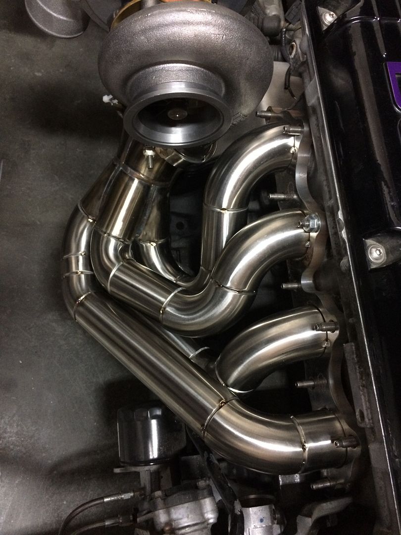

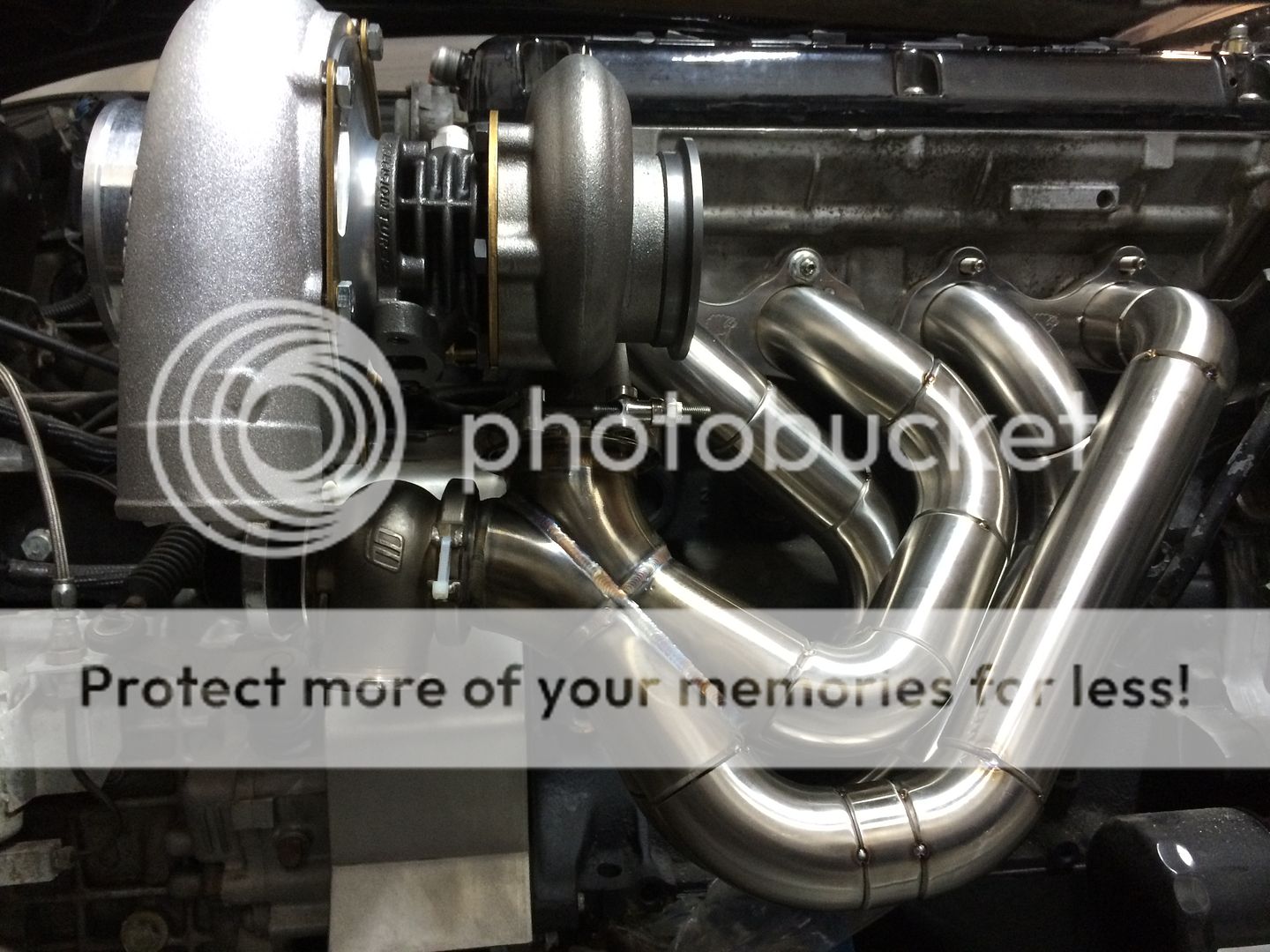

Well, after 5 months off the road my car is finally going back together. First off, some pictures of the new one off Sheepey Built top mount V-Band exhaust manifold tacked together. That will be finished tomorrow, and then we'll get going on a new 4" thick intercooler with 3" charge piping, among a few other things.

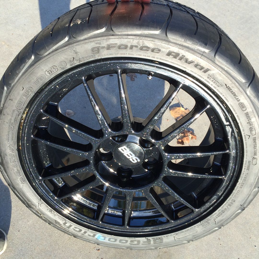

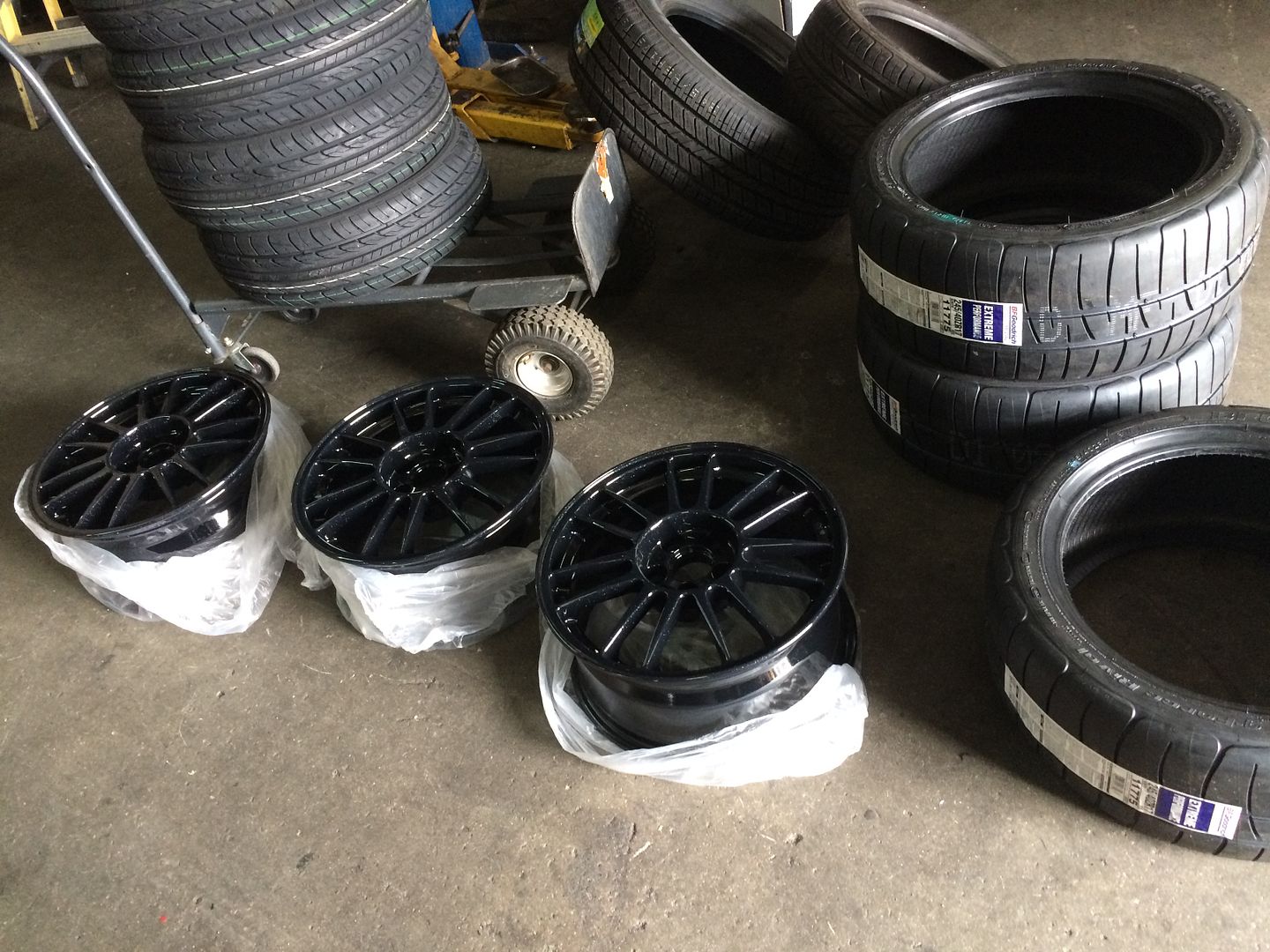

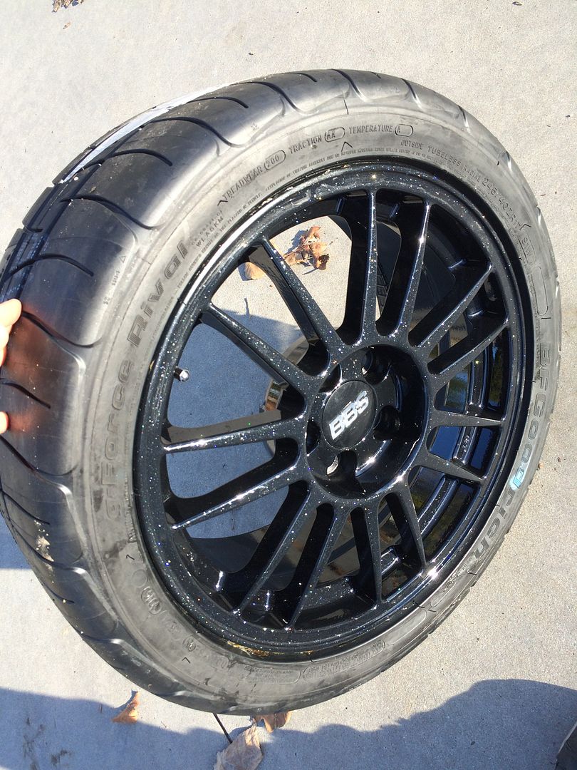

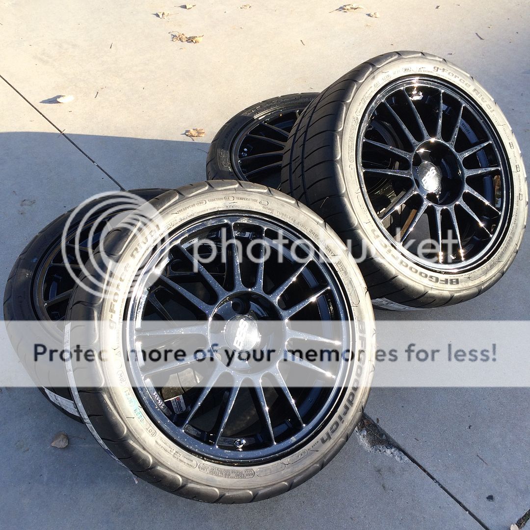

I also got some new 245/40/17 BFG Rival tires, and while I had the tires off I had my Evo MR BBS wheels powder coated metallic black. They look incredible in person, so happy with how they came out. The pictures don't really do them justice.

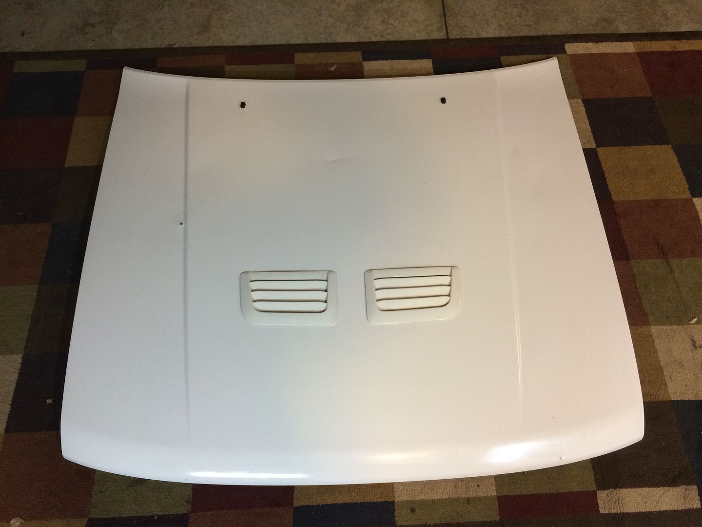

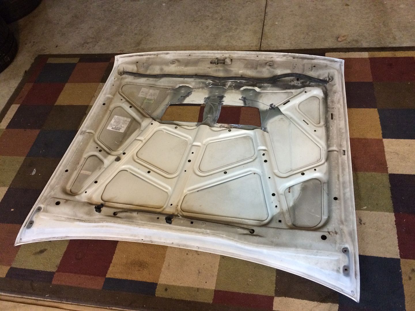

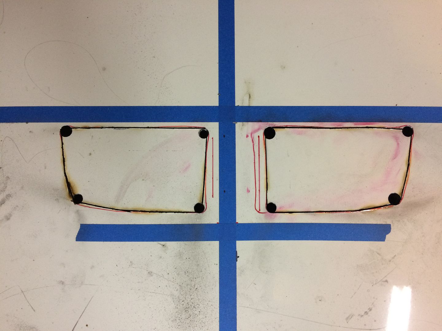

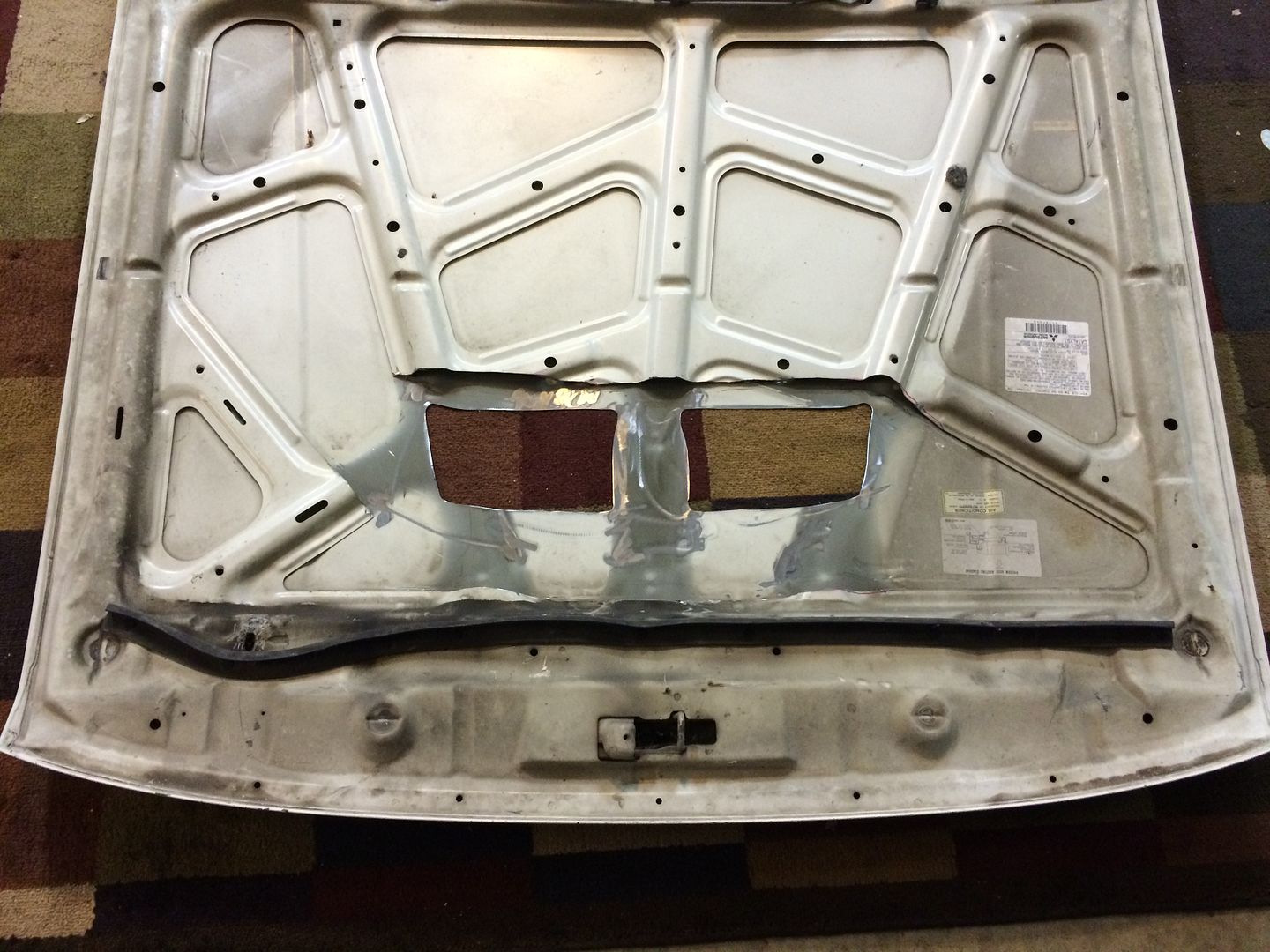

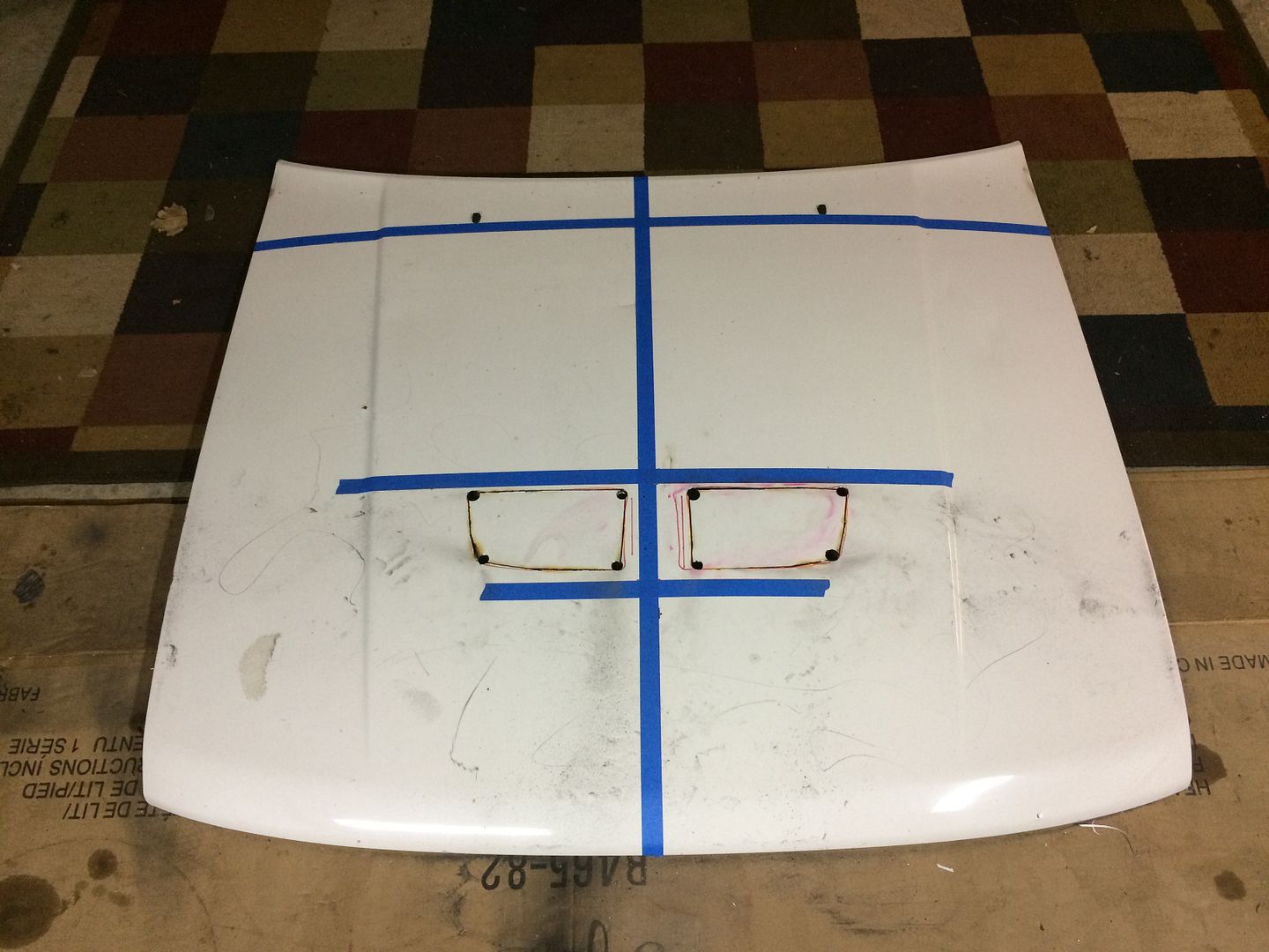

I also finally got around to cutting up the stock USDM GVR4 hood I have to install some JDM vents. I know it's not the same as a real JDM hood, but it'll do. Thank you Wookalar for the link to the measurements for factory placement. I had to make my own template, and extremely carefully cut the holes with a 4" cut off wheel. I got lucky and they came out absolutely perfect. I also cut out some of the under hood support so when the vents are installed it shouldn't look too bad underneath. I dropped the hood off at the paint shop yesterday, very excited to get it back.

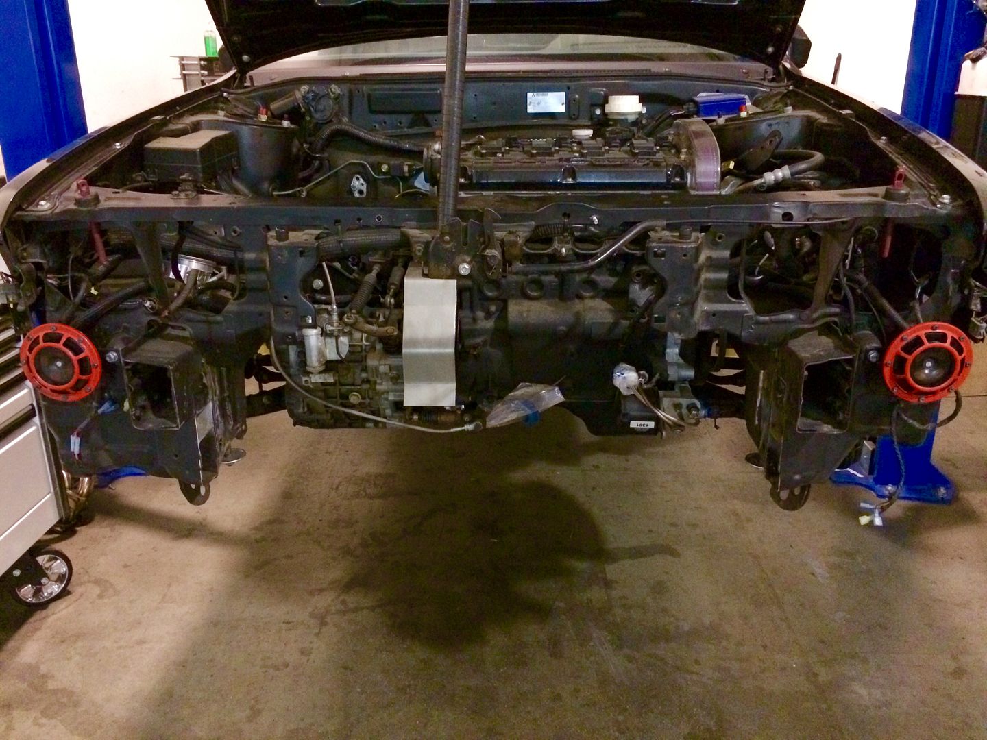

First off, I got bored and cut out the factory crossmember that the radiator mounts to. I'm welding 1/4" steel plate to the frame rails, then we're going to weld in a piece of 1.5"x1.5" .120 wall steel to replace it with, and mount the afco radiator and new intercooler to.
Wheels, absolutely love how they came out:
And here's some of me cutting up the hood:

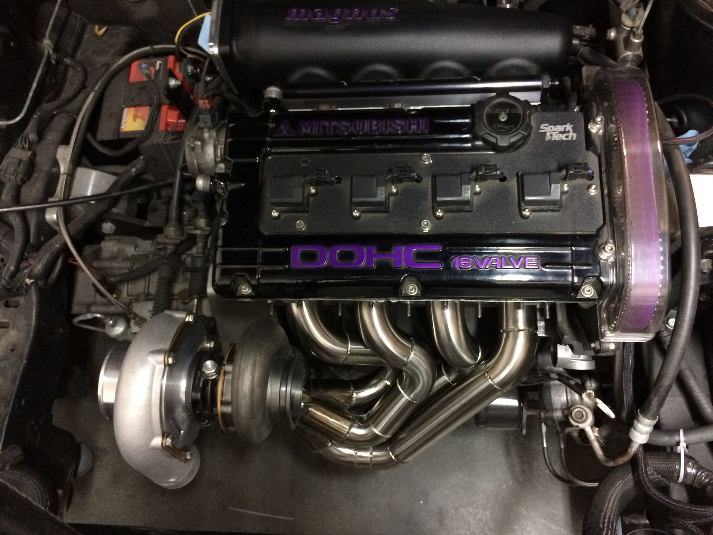

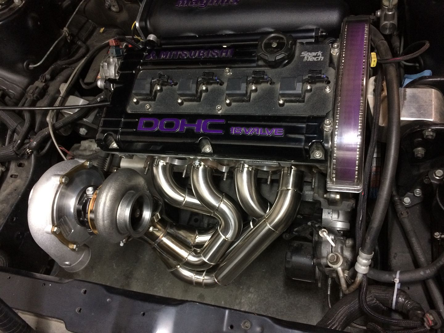

And here's my manifold, tacked together:

That manifold collector gave me a chubby. Very nice flow and welds.
And I think we all feel the same way Mark feels. /ubbthreads/images/graemlins/rofl.gif
Hey, how well will the oil drain clear your wastegate? Looks like it drains right on it from the angle of the pic.

Would it have been possible to just cut the surface of the hood and leave the ribs intact? I have never held one of those vents I don't know exactly how it mounts.
