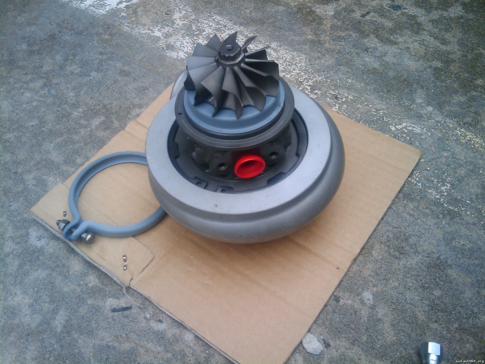

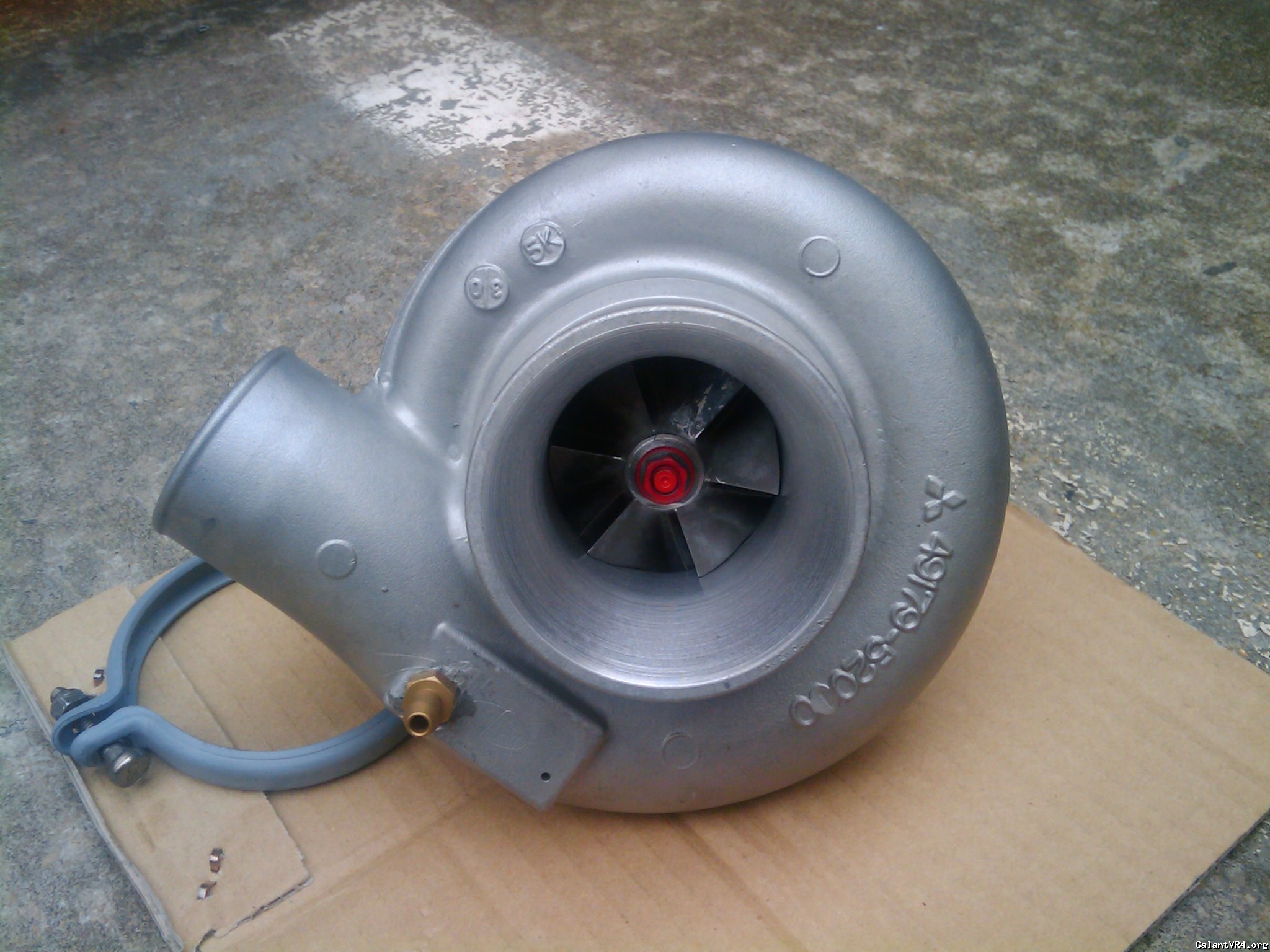

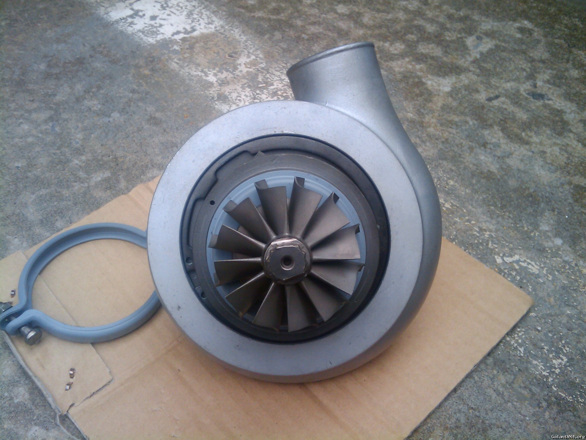

More than a month ago I noticed my FP Green had more play than it should. No smoke, no crazy noises (except this faint metal on metal clicking once in a while) so I decided to send it back to FP to have it rebuilt and while I was in there also went with some new hardware. I like to do stuff once so I don't have to bother every other day with crap.

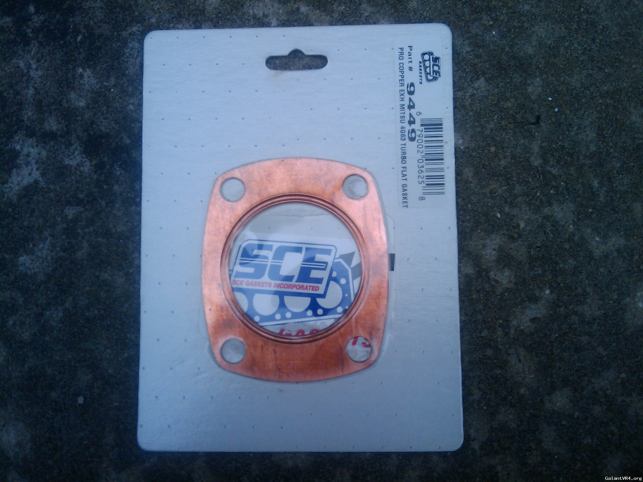

New SCE copper gasket from FFWD

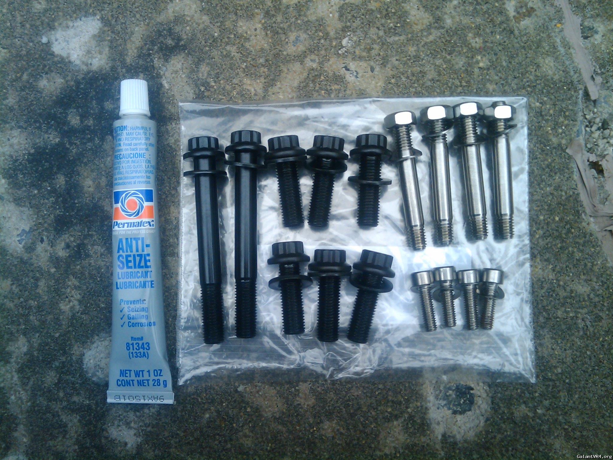

New ARP high grade 170000 psi alloy in a black oxide finish for turbo to manifold and o2 to exhaust housing also from FFWD. The stainless hardware is for the Tial wastegate.

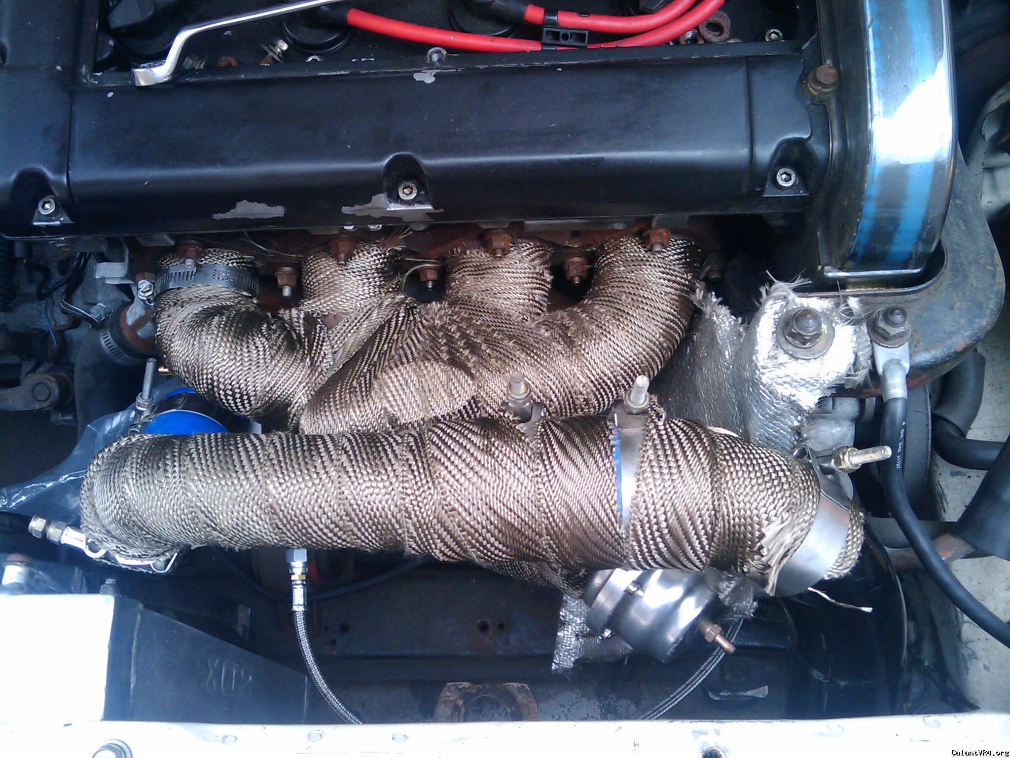

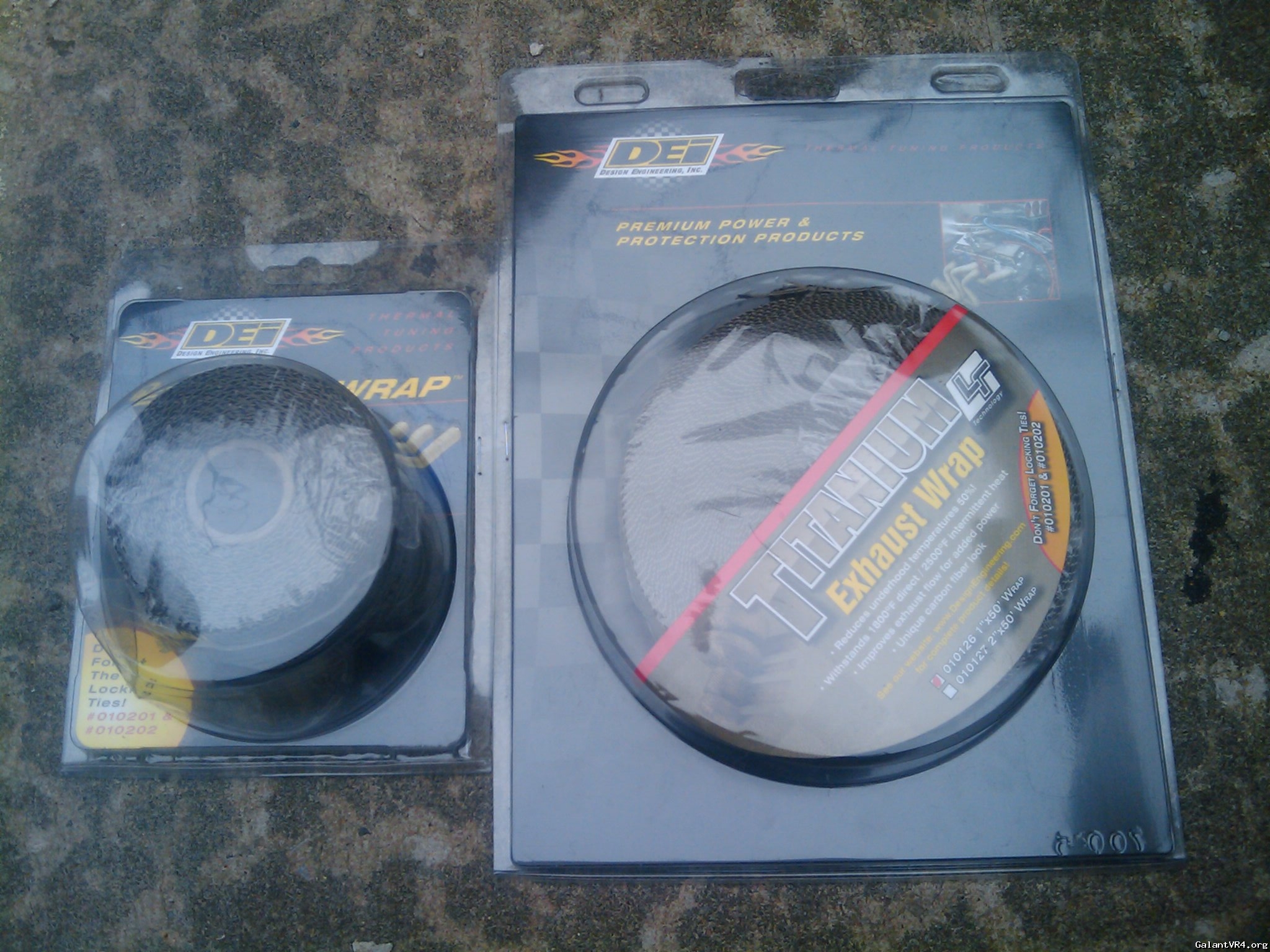

New DEI Tiatnium manifold wrap which is supposed to be better than the fiberglass one, but even if its not at least I didn't itch like crazy after putting it on /ubbthreads/images/graemlins/worthy.gif

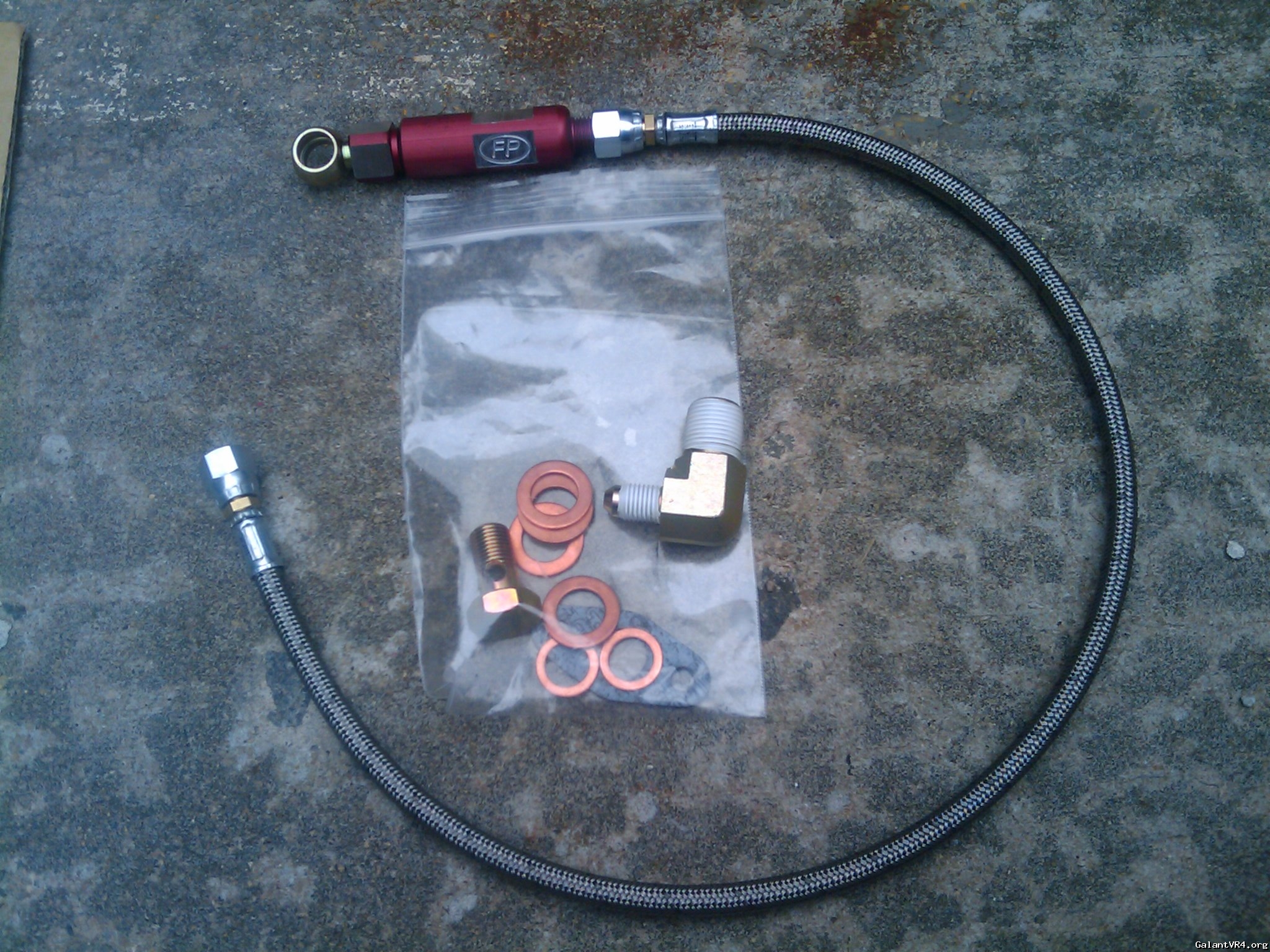

New -4AN braided stainless steel line from FP and their filter. My old line had a small spot where the stainless was shafing off.
Here's the bad boy after being rebuilt:

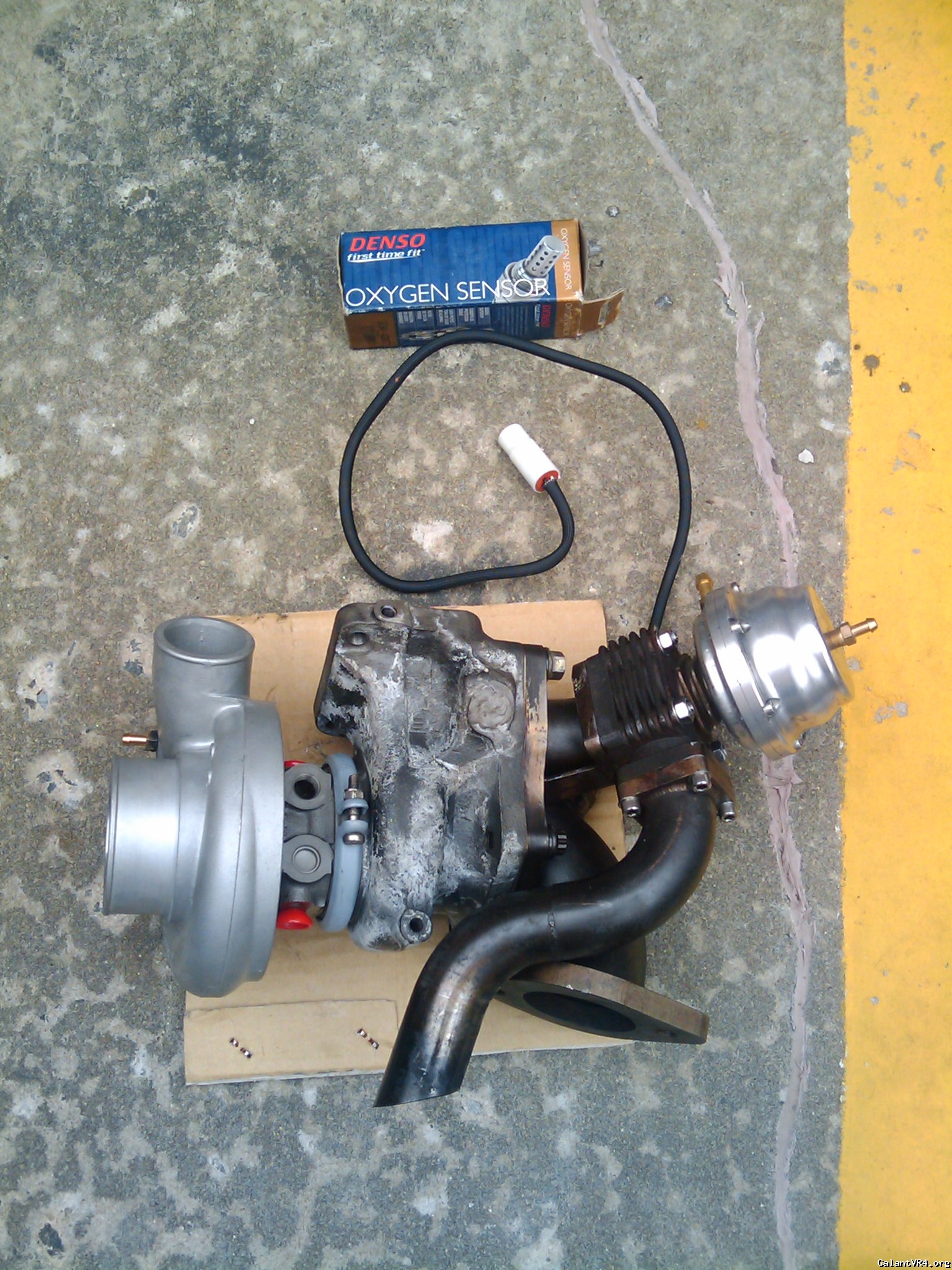

Turbo, o2 housing, wastegate and new o2 installed. The exhaust housing looks a bit funny from cleaning it with brake cleaner /ubbthreads/images/graemlins/dunno.gif
Everything in the car. This is my second time wrapping so I'm still practicing so please excuse the shitty job.

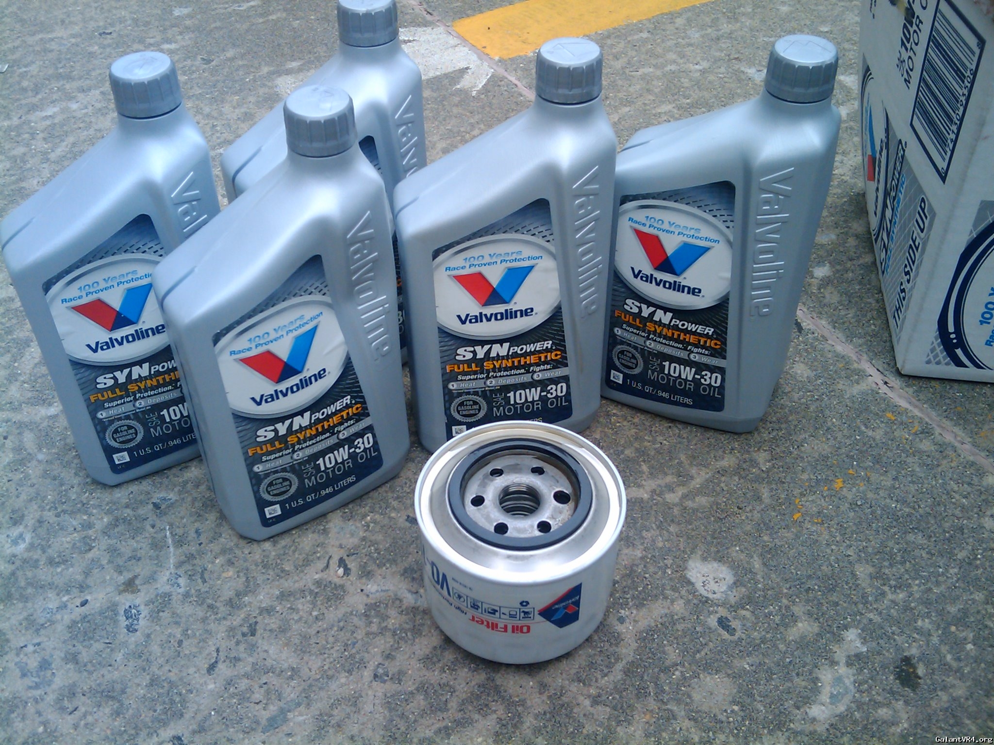

Fresh fluid/filter and she's ready to rock and roll:

Keep checking those arp's. I used copper anti seize and checked them after the first heat cycle, and they still broke.

Thanks. I usually check them again after few heat cycles. I also ran a tap and lubricant through the holes to make sure they're clean and not rust or anything is in there.

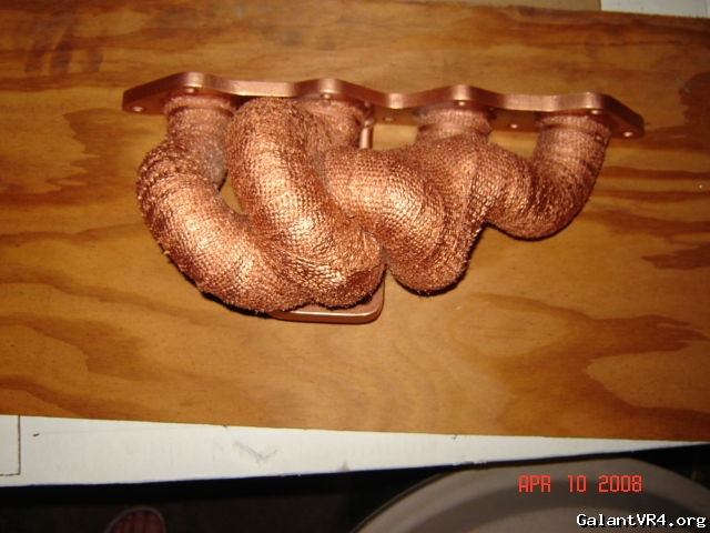

Next time you use exhaust wrap put it in a bucket of water and get it nice and wet. Makes it much easier to get it tight and keep it that way.
Brianawd
Apr 18, 2005
2,117
Portland OR,
When I did my DNP I wrapped it dry first like 3 or 4 times so that I could get the lengths right and the routing right. Then I put the wrap in water for the final wrap. I think it took me like 3-4hrs
This is how it turned out. Color should have been more bronze
iLLeffeKt vr-4
Jul 26, 2004
2,153
NYC
Yea I'll keep practicing with that wrap. I thought the fiberglass wrap was that you're supposed to get wet and not this one. Oh well, next time. Thanks for the advice guys.

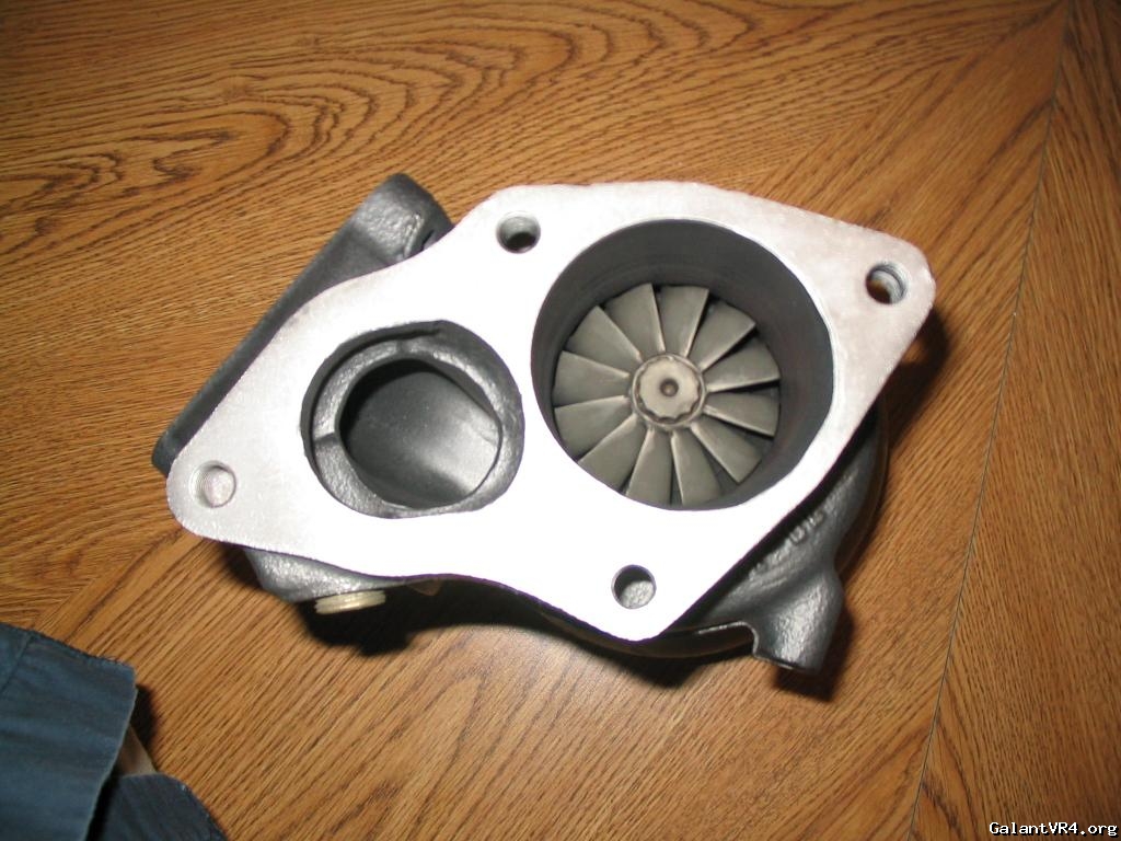

Dang, that rebuild made it look brand new. I wonder if sandblasting the exhaust would do the same.
Brian, that wrapping looks sweet!
11,993
Bead blasting the exhaust housing would make it look brand new.
This is my old FPgreen after glass beading:

The exhaust housing was bead blasted also and the whole turbo looked brand new. However I took the exhaust housing off and ported the wastegate hole some more and then I cleaned it in the parts cleaner and sprayed it with brake cleaner. So that's why it got that white residue on it, but I'm sure it burned off by now. lol
