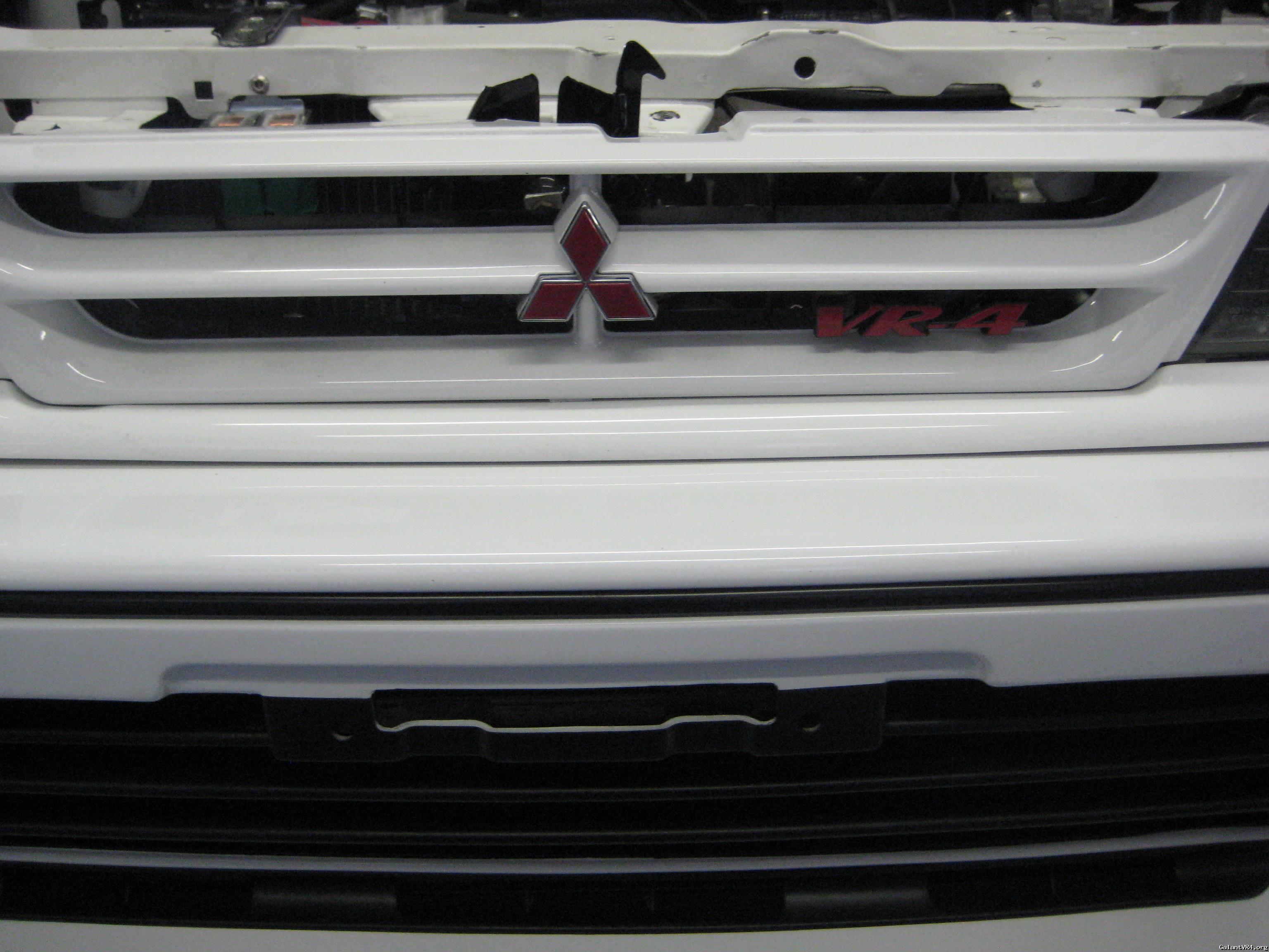

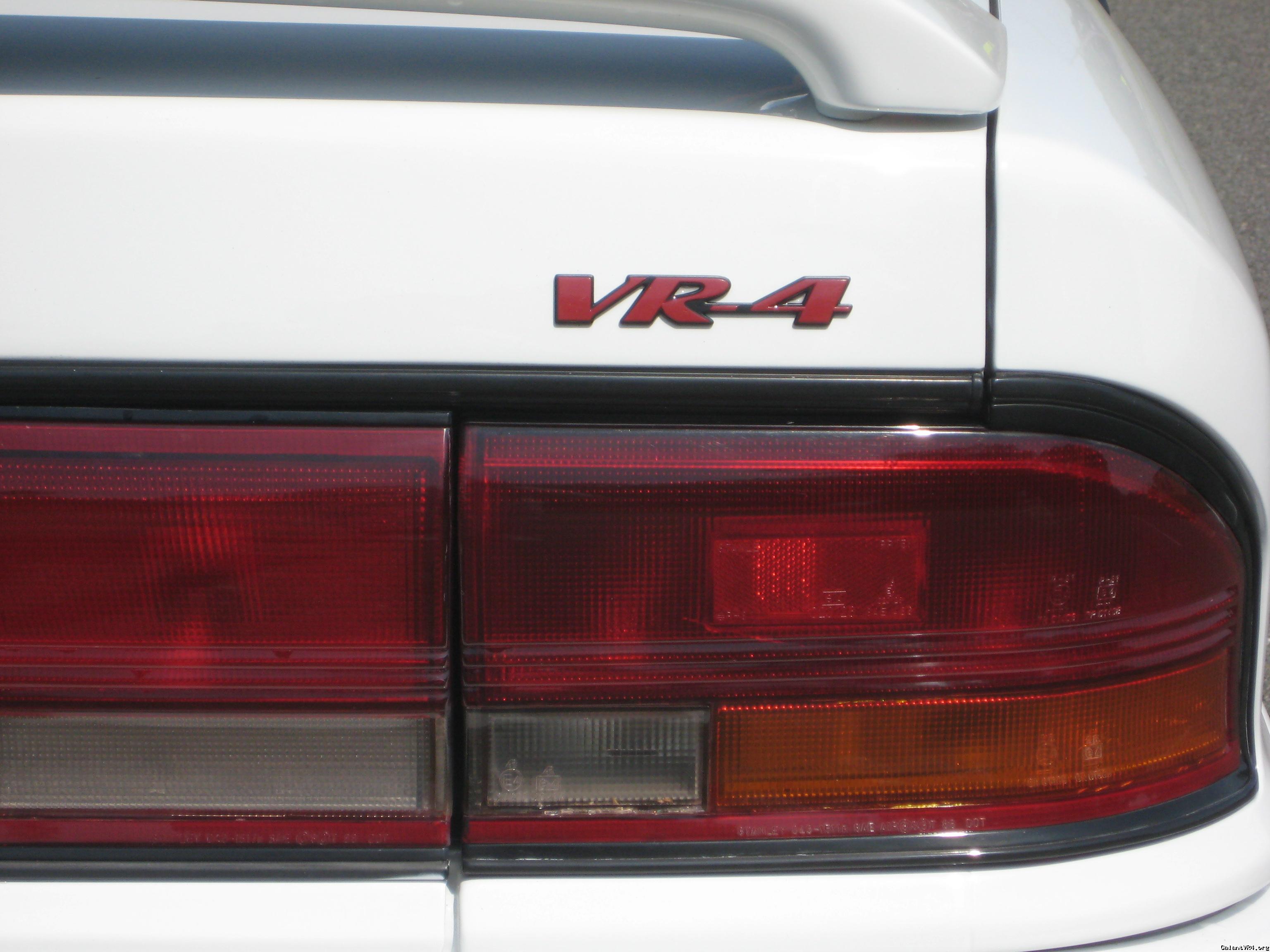

Mounted the "Legnum VR4" emblem symbol on the Eterna Grill

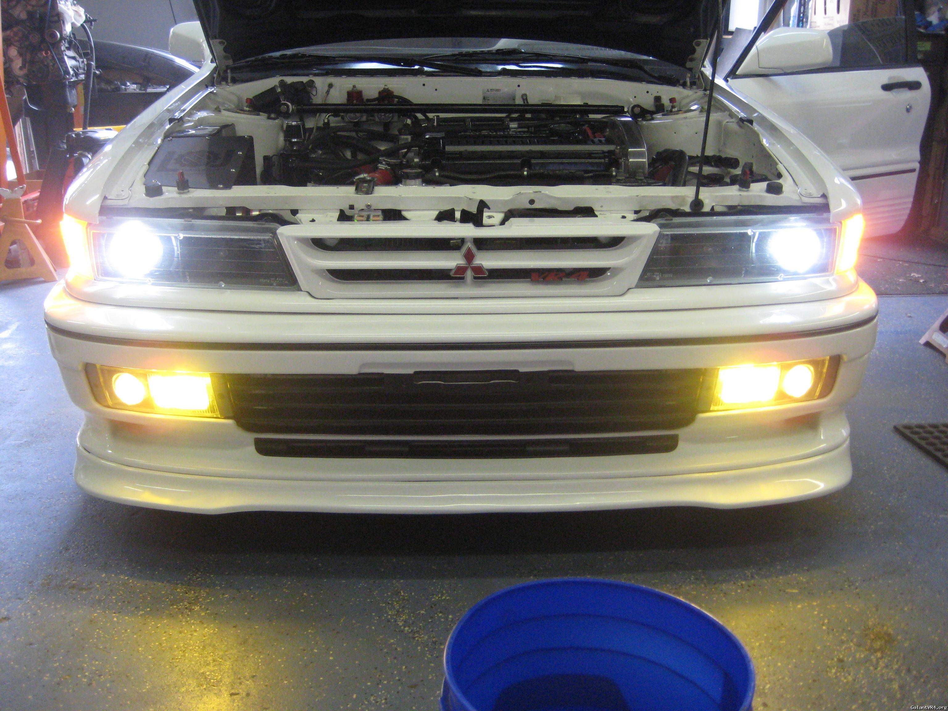

Got the HIDs and fogs wired up too. Still need to get the aiming adjusted, but it looks absolutely sick!!!

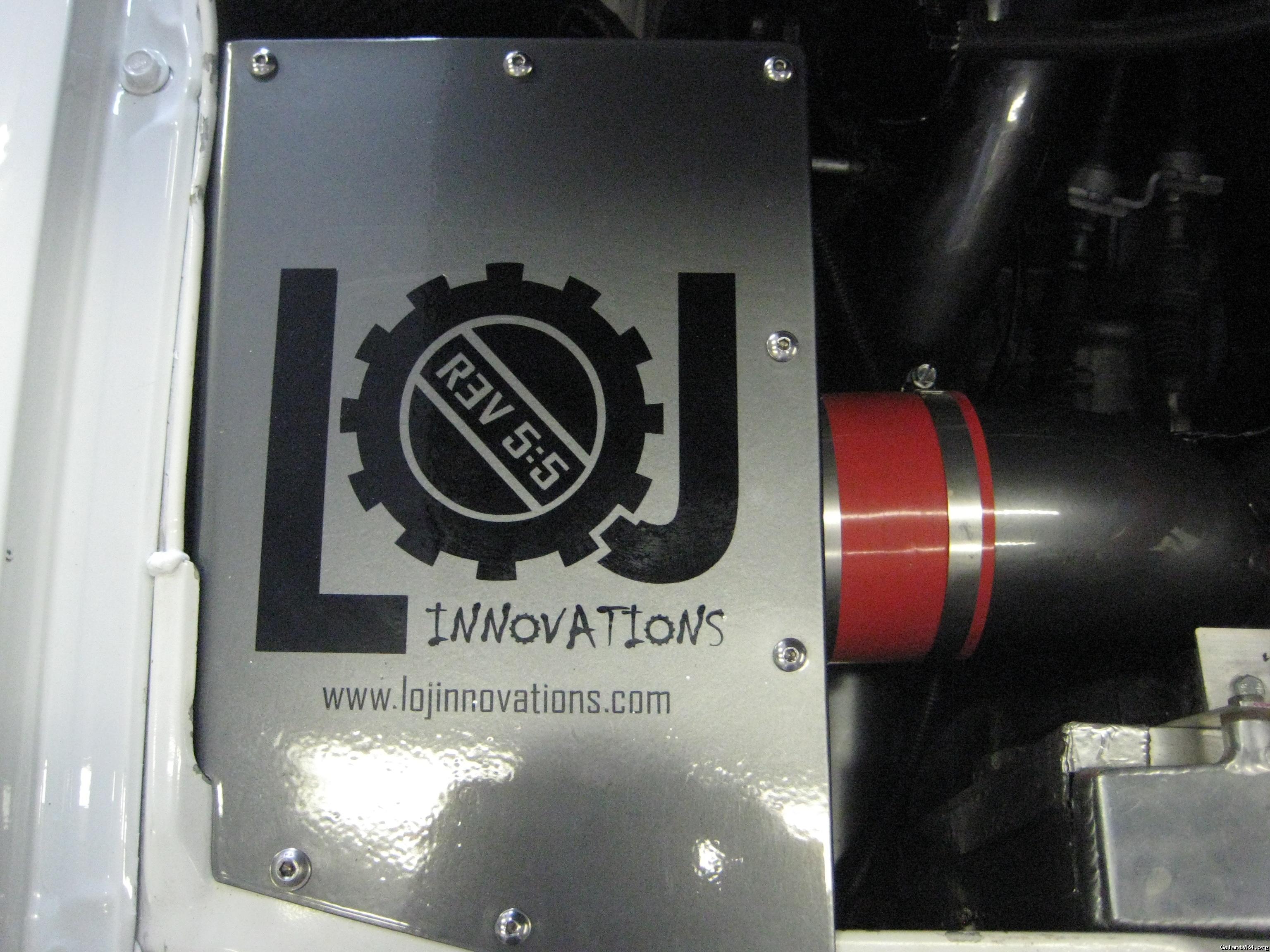

My buddy Steve who did all the fab work is starting a garage and I gave him the go-ahead to use his logo on the airbox

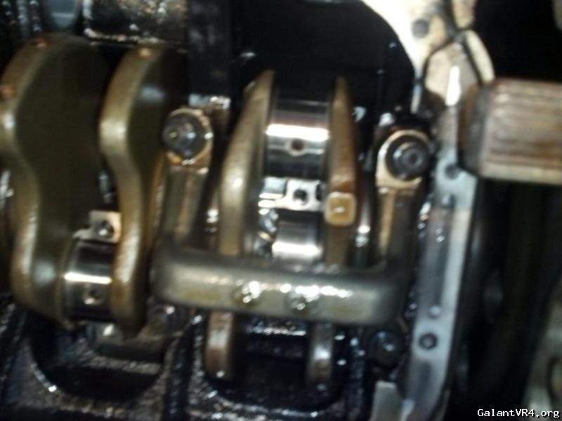

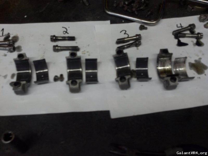

Ran into a significant problem in the last week. My buddy has been tuning the car for me in the past two weeks. Everything started out fine on wastegate pressure (~13 lbs) with strictly pump gas and was able to get a few miles on the car. The car seemed to pull great and no signs of knock. Started tuning the car using the race gas mix (secondary fuel pump switch over point at 13lbs) using V3, and the tune looked great. Car seemed be responding excellent to the setup and everything seemed perfect. Started the car on Friday and heard my worst nightmare.......rod knock.
I wonder which one it is.... /ubbthreads/images/graemlins/idea.gif
Luckily the crank journal seems perfectly fine and the oil pickup did it's job.
I'm sure people would advise against this, but I'm just ordering a set of bearings and throwing them in. I think we caught it early enough and haven't driven the car, so I don't believe it will be a problem with the new bearings. The shop that originally built the motor never gave me a spec sheet on the build. I don't think that they properly torqued the #4 rod bearing. I forget what bearings I used on the build (ACL or Clevite). The other ones appear to be perfrectly fine, but the coating on the #4 bearing is completely gone. Hope to have her back on the road by this weekend.

How are the mains? If the rods are crap might want to take the time to check those out also. Who knows maybe it wasn't knock that fried the bearings. How was the oil pressure? Do you have a real oil pressure guage?
dustyduff
Apr 19, 2009
429
Mantua, NJ
Noobsauce: You're 100% right that it may not have been knock that caused the bearing failure. All of the rod bearings were perfect except the #4 bearing, so the mains were not removed and inspected.
Unfortunately, I don't have an oil pressure gauge, however I will likely be picking one up in the near future. I doubt it was excessive oil pressure, but could have been lack of oil pressure since the #4 is the furthest from the pump. The fact that all of the other bearings are perfect, I'm thinking that it was likely installation error (i.e too tight/loose). I'm going to throw a new set of bearings in and pray for the best.
I have a spare built 2.3L motor with a spun bearing sitting in the garage that will be rebuilt while I drive the car for now (hoping it will last a few thousand miles or longer). Only time will tell if the assumption for installation error is correct.

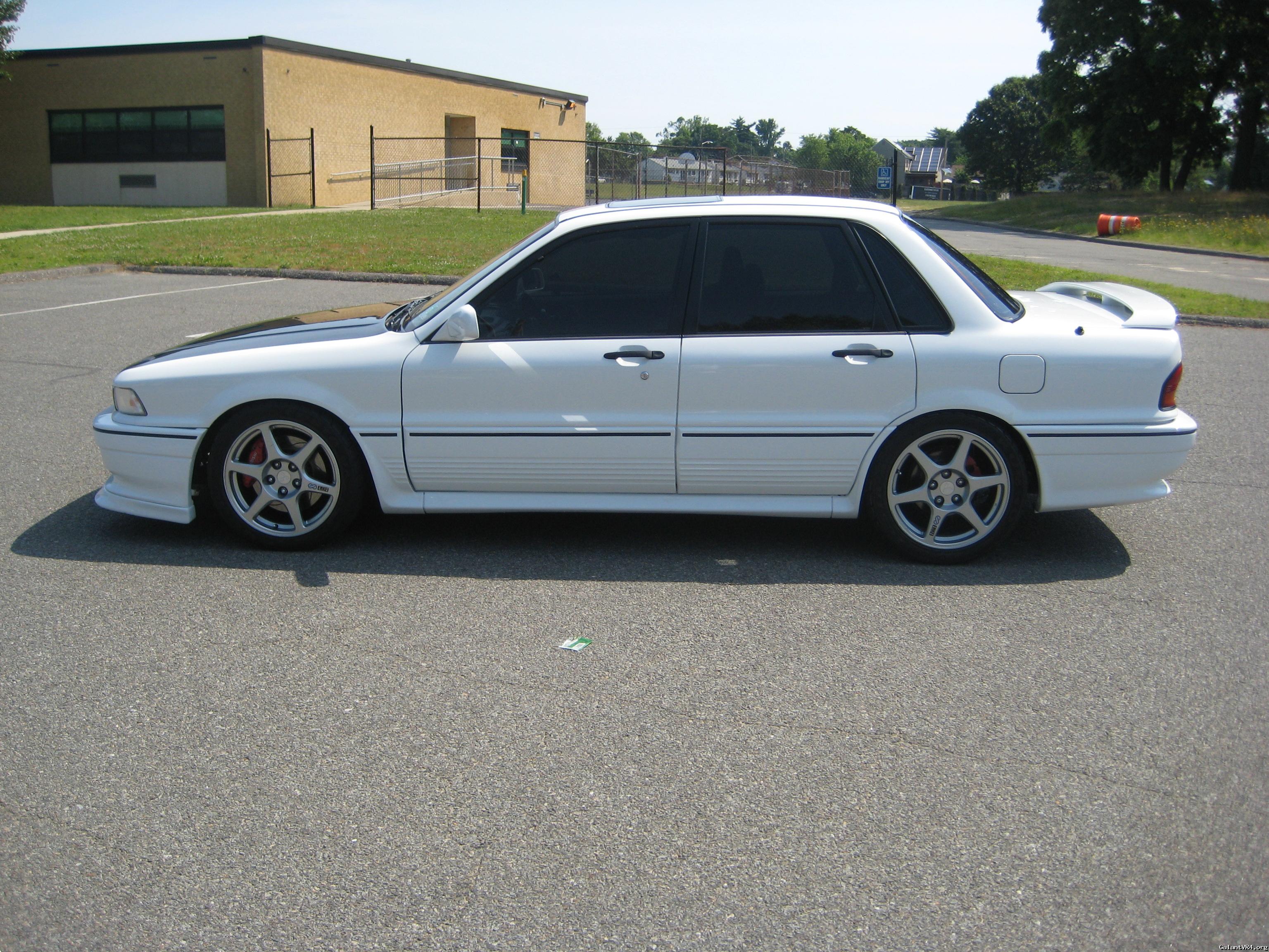

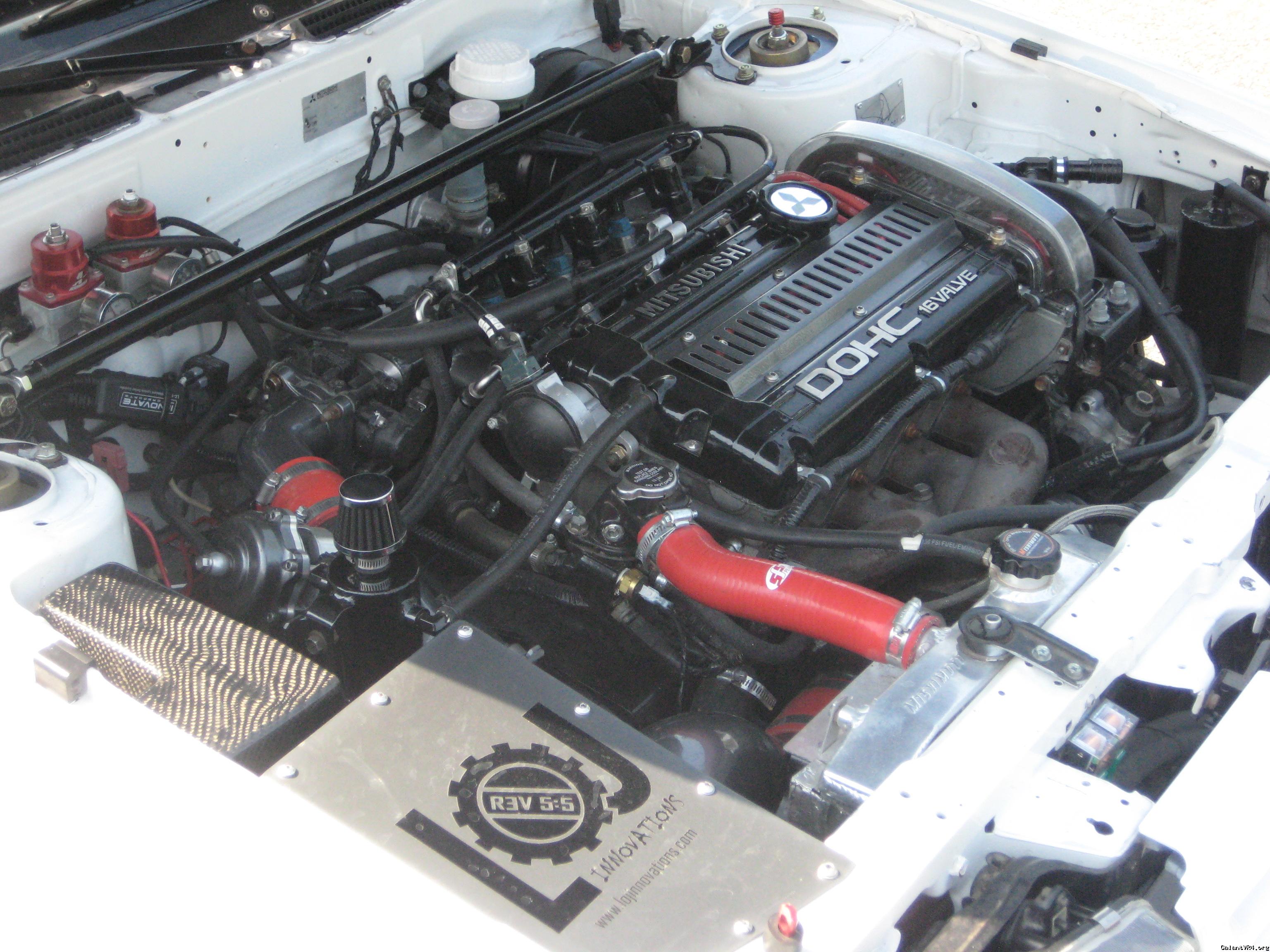

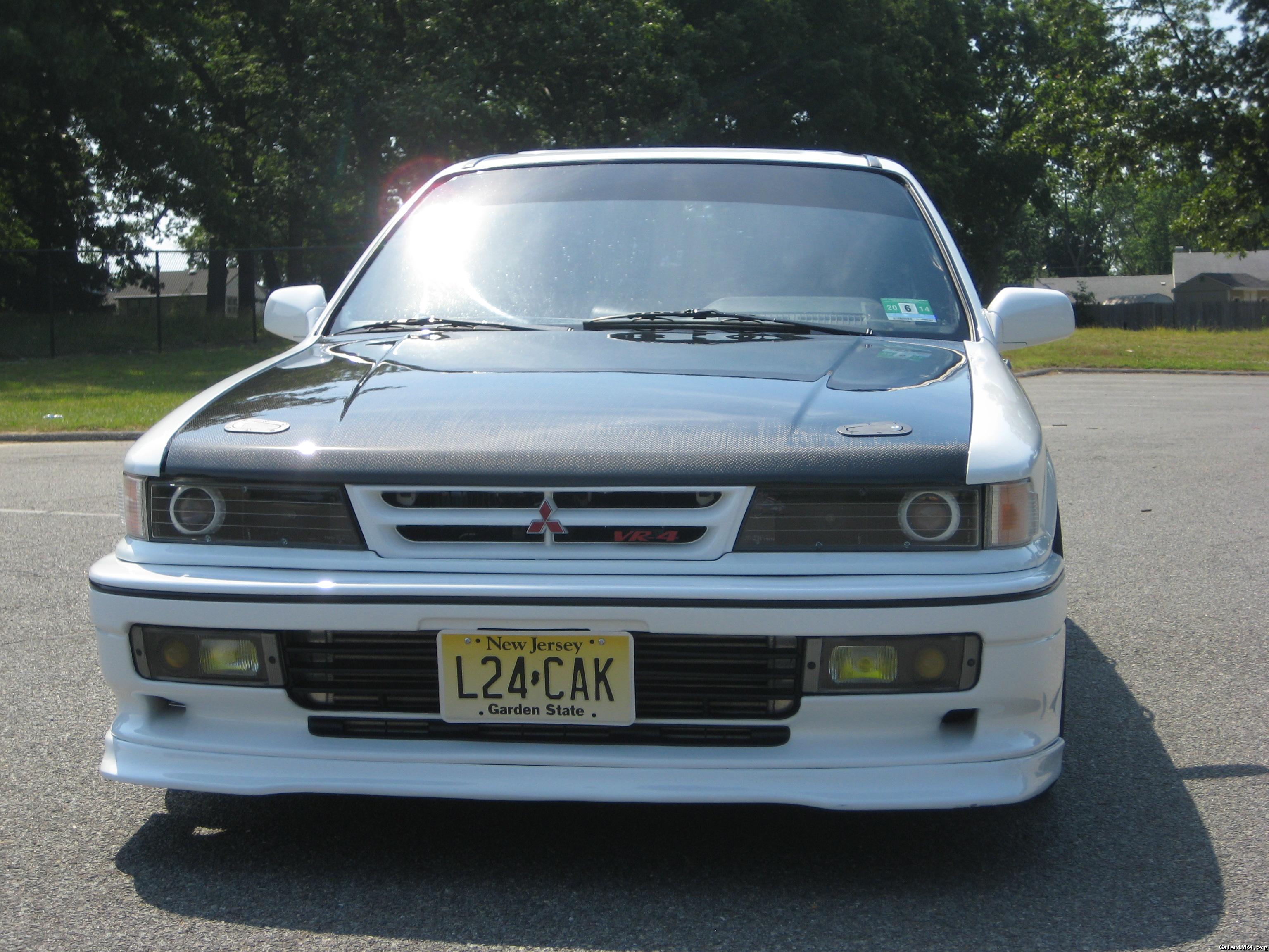

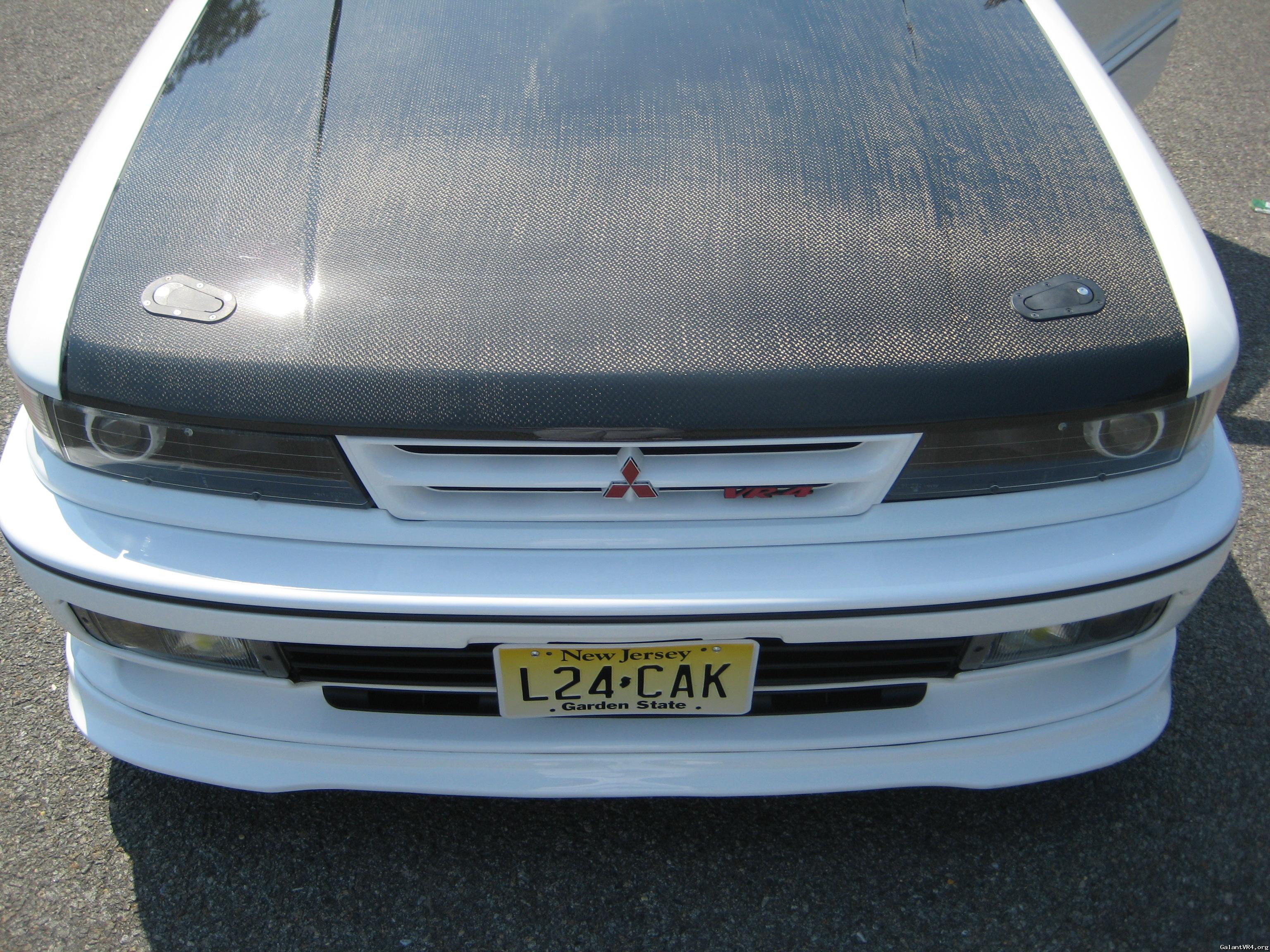

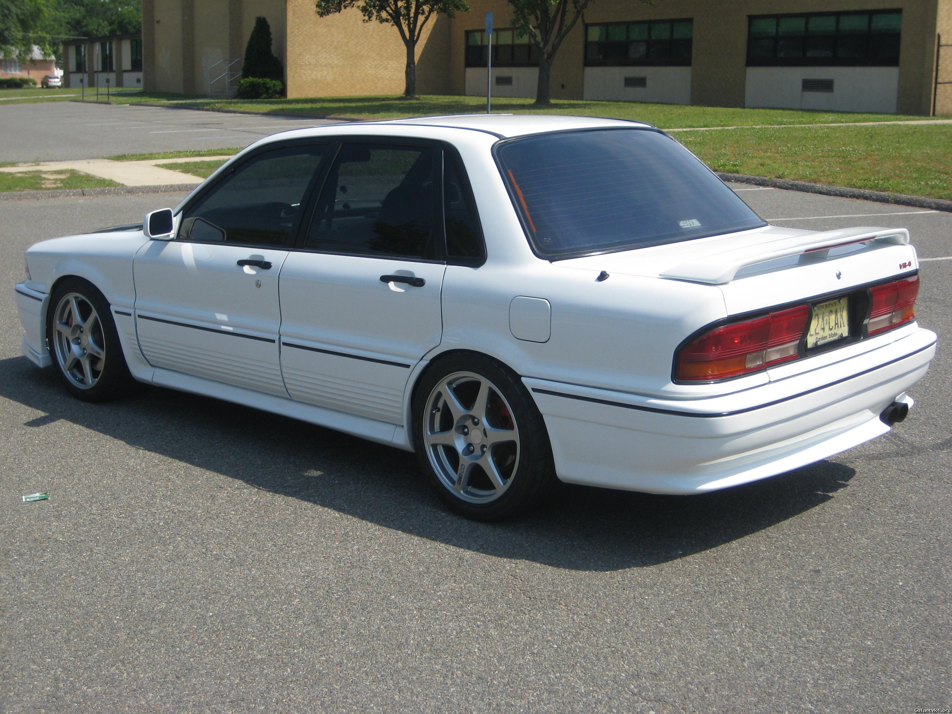

Well, the new bearings are holding up just fine so far. It was nice this morning, so I took her on a nice drive and give the car a wash. The only picture of the car complete is the one above from my cell phone above, so here are some better quality photos with a real camera. Hope you like pics, because I took a ton of them.
The headlights are aimed WAY too high and need to be adjusted, so no night time shots yet.

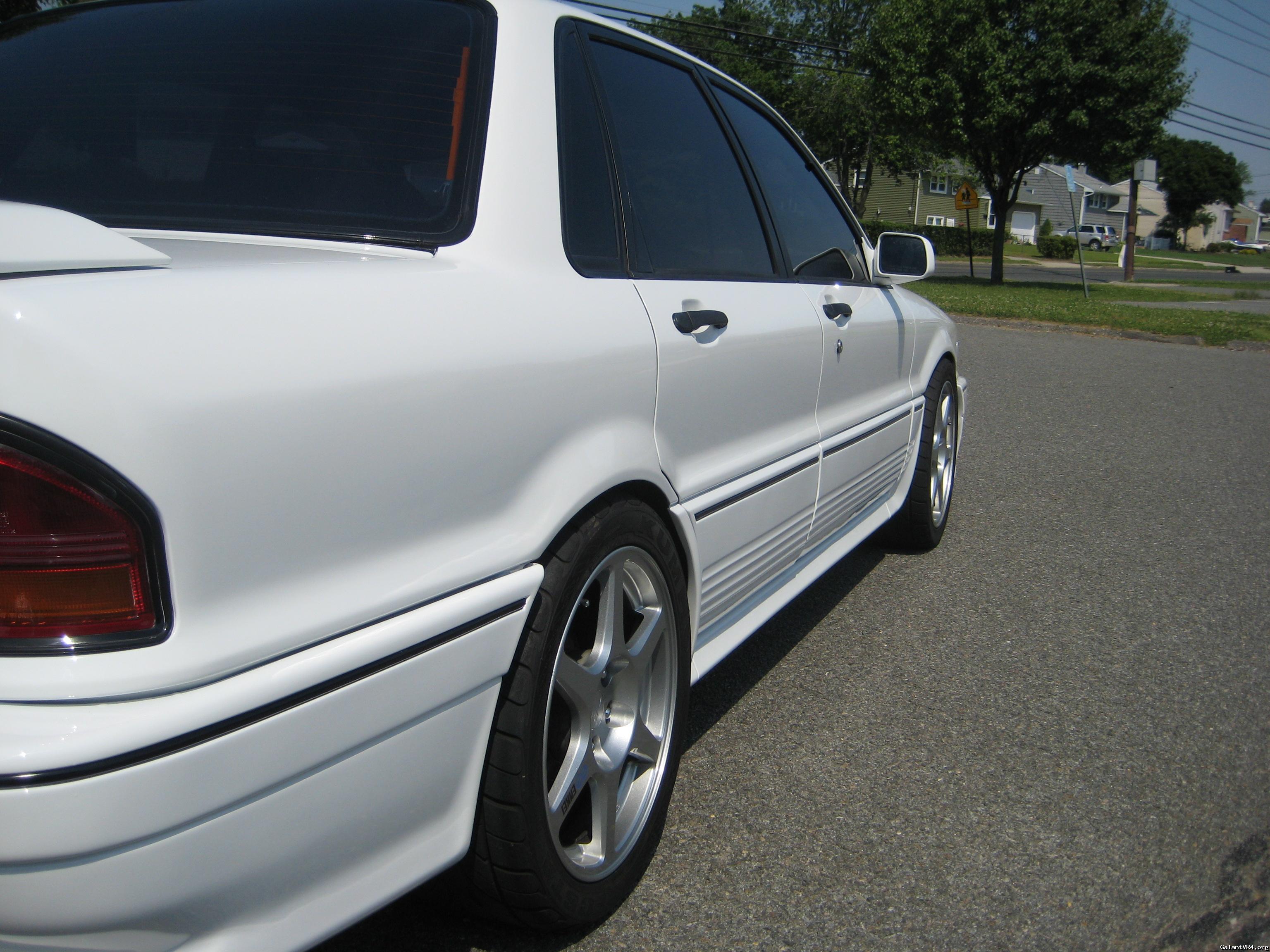

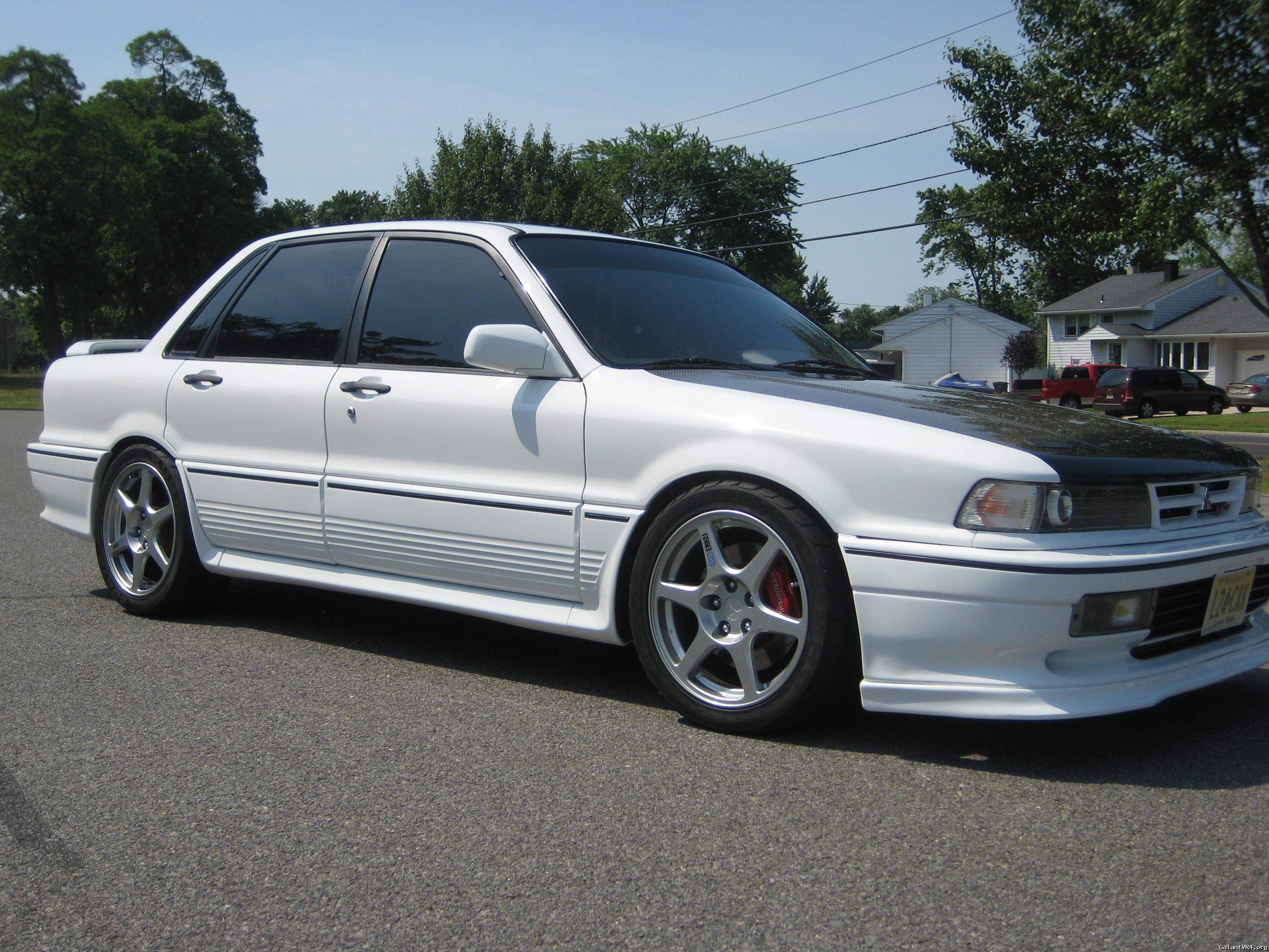

It must have been the weather this past weekend that inspired all these "photoshoots". I figured I'd post up some of the pictures that my co-worker/friend took of my car this past Friday after staring at Nelson's beautiful car the past few days. My buddy used a tripod and a higher resolution camera than the pics I took two months ago. I thought they came out really well.
The car has been driving perfectly fine since the bearing replacement. The car is still "relatively" quick on low boost (~13 lbs), but I've got a track day scheduled for October 1st and hopefully crank up the wick. The car tends to overheat on long trips due to the fact that my intercooler covers about 85% of that small 1/2 size civic radiator. I plan on replacing the radiator and getting the car tuned on pump/race gas mix which was my original plan.
The driving lights are also wired up and functional now as you'll see in some of the pics.
Engine bay pics will come after I detail and the interior pics will come after I get the headliner replaced in the next month. Enjoy for now!!!
