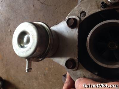

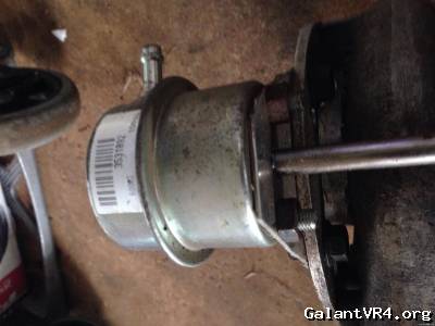

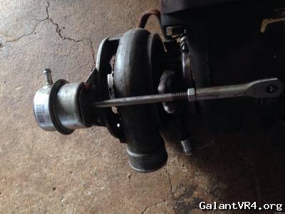

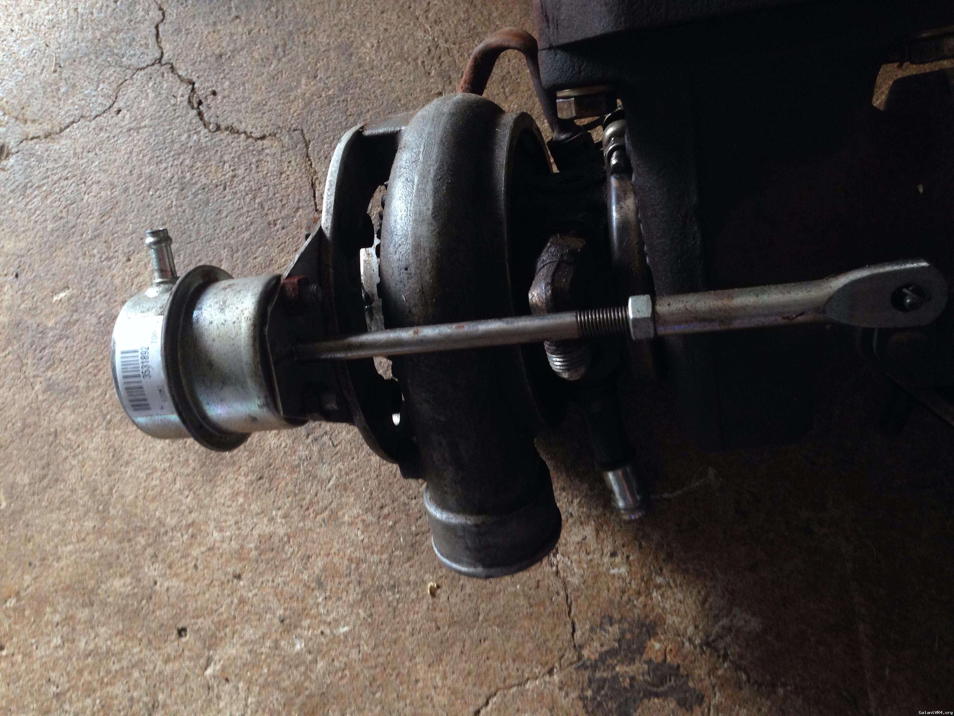

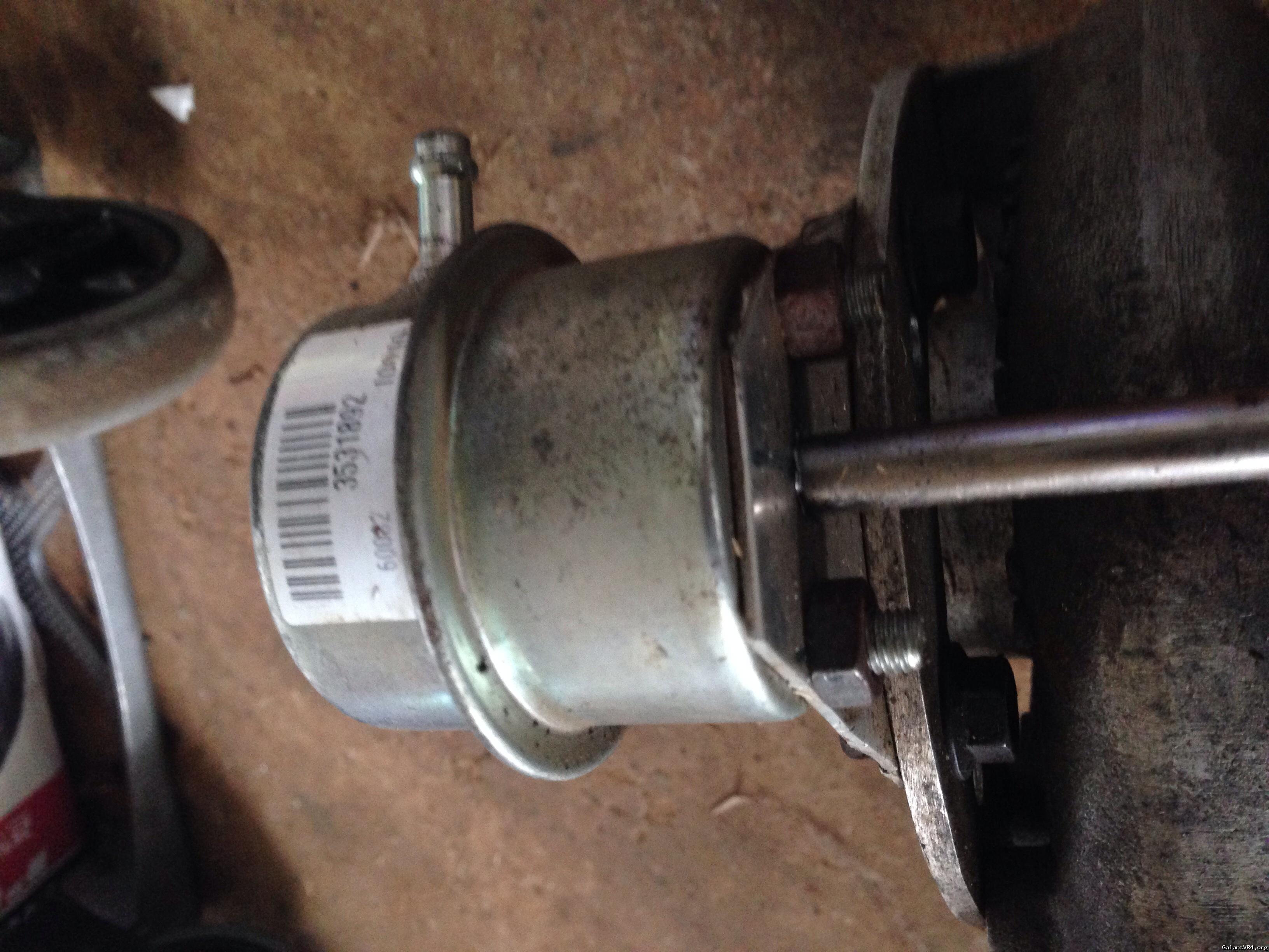

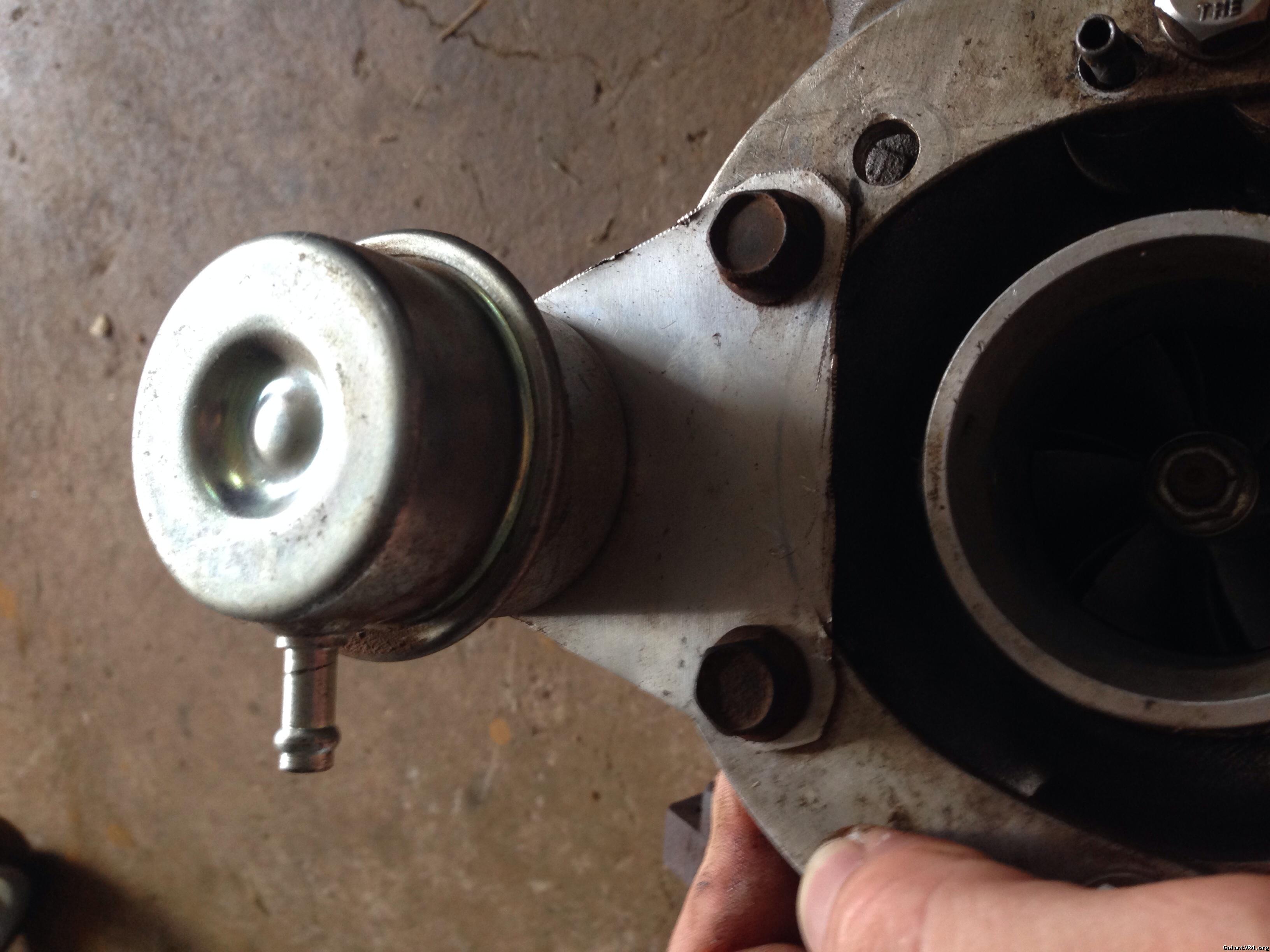

Ya you have to make bracket to make it fit the 16g. Took me a hole 10 min to make one for mine, hold ill post a pick. Its super easy and works amazing!! If you pm justin (jusMX141) Dsmtuners he usually has them for sale.
