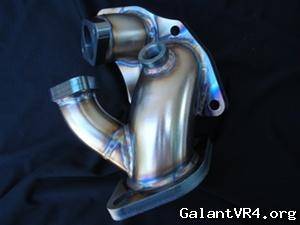

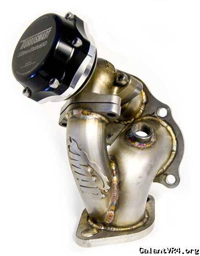

Here are pics of the housings in question:
MAP housing
Punishment housing

I have the punishment racing one and fits perfect. no complaints whatsoever.

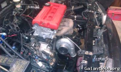

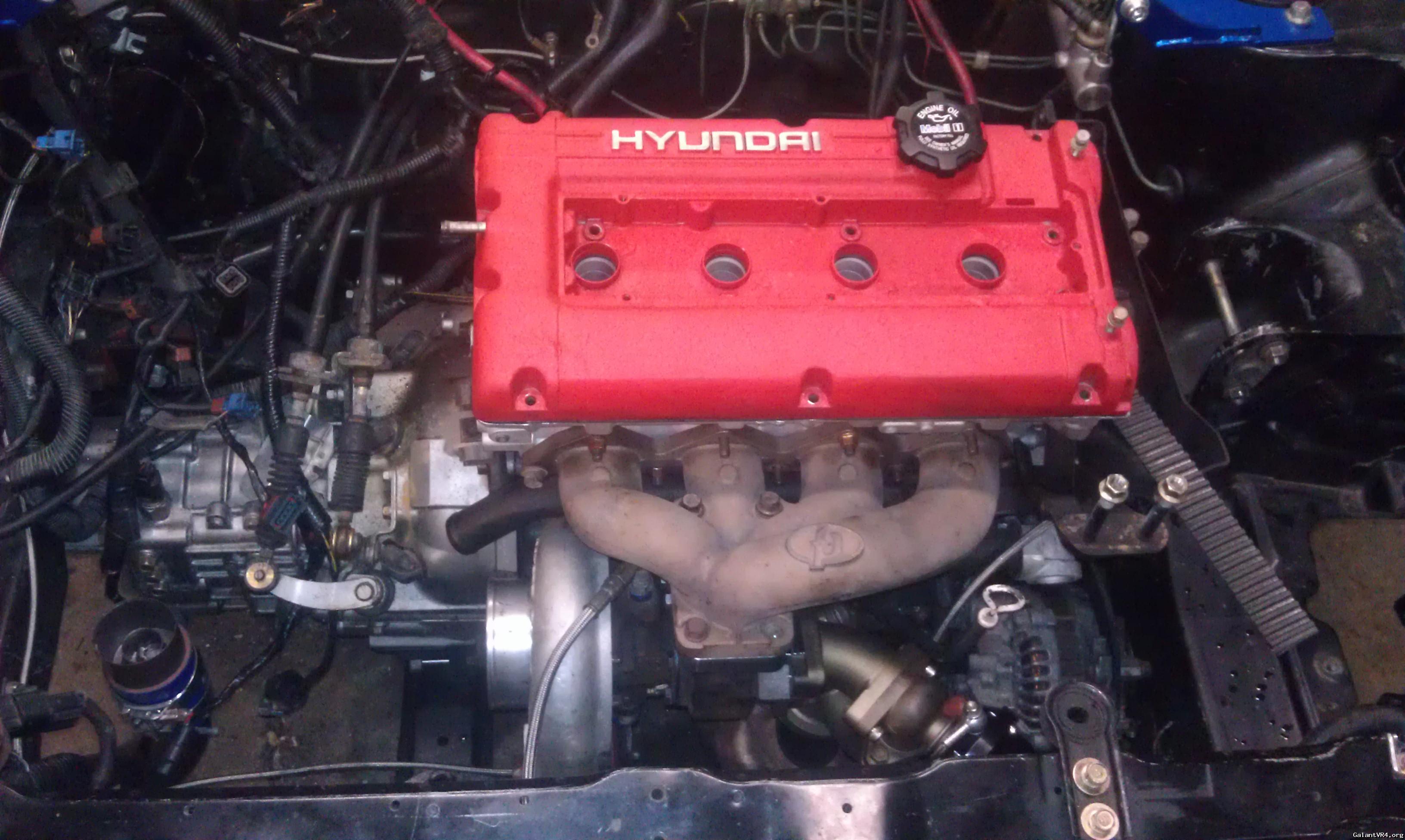

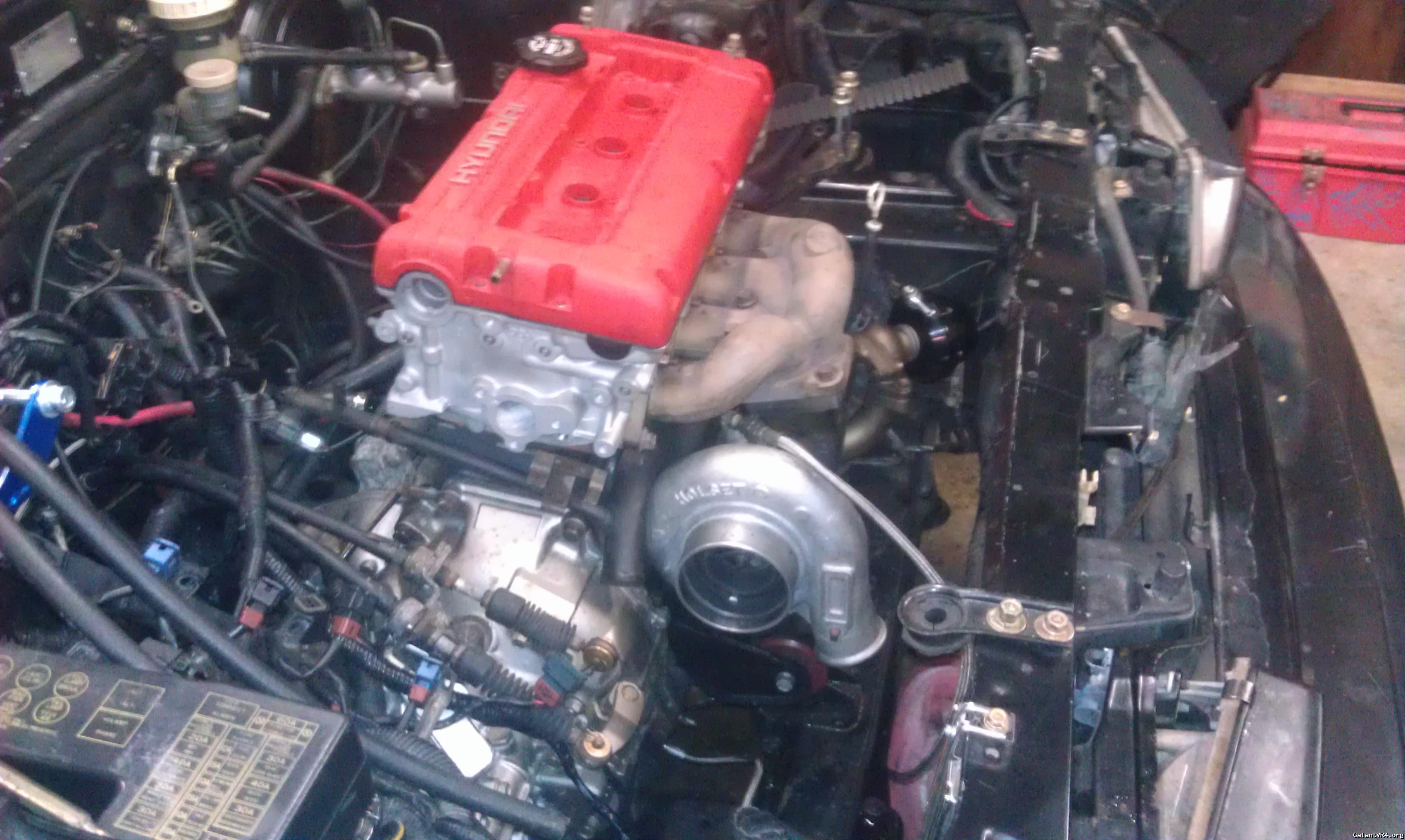

snohacking
Mar 16, 2010
233
Menomonee Falls, Wi
Its a no go with the stock vr4 radiator maybe a tucked stock 1g might work but I am just going to buy a afco one.
Hx35 with bep housing
Not the best pics but you should be able to see it will not fit.

^Which housing is that?

What I want to know now is which housing is posted above that doesn't fit.
And also, want to see pics of the MAP and punishment housings that supposedly fit. I hope one of them does!!
MellowVR4
Jul 25, 2009
1,662
Milwaukee, Wi
I believe its a punishment
